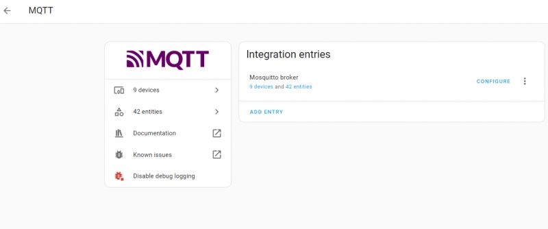

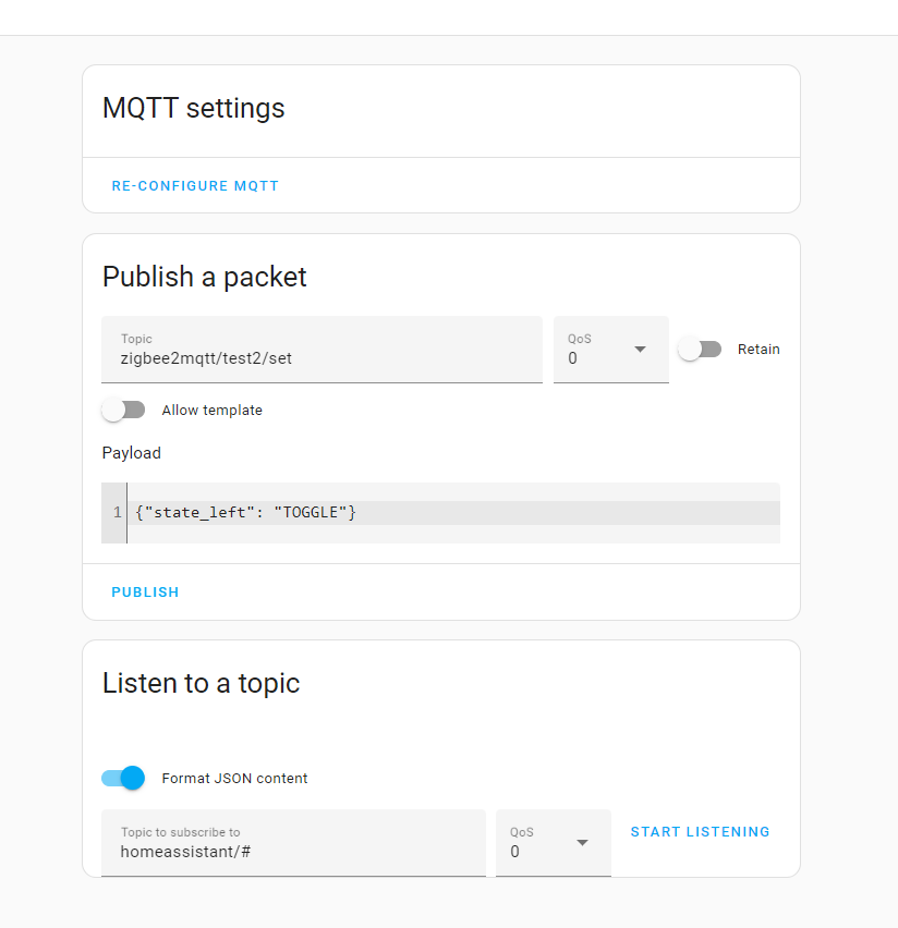

Here I will show the inner workings of MQTT-based HASS Discovery, a way for Home Assistant to automatically detect and configure devices. HASS Discovery only requires our device to be connected to the MQTT broker in HA. After that, our device can already be detected. In order for the discovery to take place, our device needs to publish a properly formatted text in JSON format to a specific subject from Discovery. This JSON contains information describing the entity, i.e. its type, name, icon, entity and the associated MQTT topics, among others, the topic for reading the value (listening) and the topic for setting the new value (from the HA).
These types of mechanisms are best presented in practice, so I suggest starting with practice. Let's try firing up some Discovery and take a look at what is being sent. Fortunately, there is a ready-made tool in Home Assistant to listen in on MQTT communications. It comes with Mosquitto broker integrations:
MQTT Integration Interface in Home Assistant .
Then we click Configure:
MQTT configuration screen with options for publishing and listening to topics. .
This brings us to the tool that allows us to publish packages and listen for publications.
Now it's time to listen to something.
Just a note - of course, I'm assuming that the user knows the basics of HA, MQTT, or JSON there.... The inner workings of Discovery are already a bit advanced, but also a worthy topic.
It's also worth looking at the HA documentation if you have questions.
So, Home Assistant Discovery by default is based on the subject homeassistant , we append a multi-level wildcard behind it, i.e. #, so that it listens to all matching subjects:
homeassistant/#

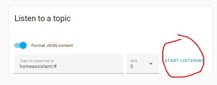

And then we click Start Listening:
Screenshot of Home Assistant's MQTT topic listening tool window. .

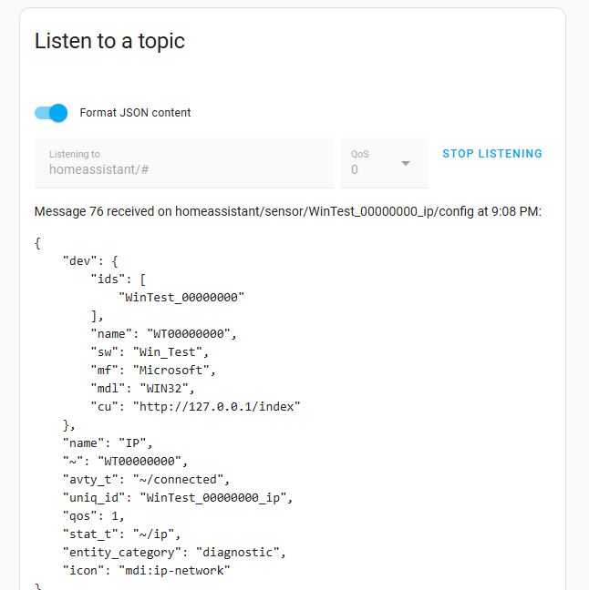

Let's start with the IP address. Topic (the so-called "mqtt topic"):
homeassistant/sensor/WinTest_00000000_ip/config
Content (so-called "mqtt payload"):
Here we have, in sequence:
- "dev" - section describing the device, its ID, name, software version (sw), manufacturer (mf), model (mdl), cu (panel URL)
- "name" - entity name, here "IP"
- "~" - abbreviation for the MQTT topic path, "WT00000000". This allows you to write ~/ip instead of the full "WT00000000/ip"
- "avty_t" - the topic for the availability status, "~/connected", i.e. "WT00000000/connected". On this topic, the device reports its presence.
- "uniq_id" - unique identifier of the entity in the HA, "WinTest_00000000_ip"
- "qos" - Quality of Service level for MQTT, here "1" (guaranteed to be delivered at least once)
- "stat_t" - the topic on which the entity value is published, "~/ip", i.e. "WT00000000/ip". Home Assistant here only listens for changes on this topic.
- "entity_category" - entity category, "diagnostic", i.e. HA treats this as diagnostic information
- "icon" - an icon in HA, "mdi:ip-network", which stands for the network icon from Material Design Icons (MDI)
It is worth noting that abbreviations are used here, making the JSON shorter and easier for the microcontroller to generate and publish.

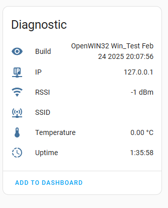

In a similar way, this whole section is created:
Diagnostic panel displaying information about the device, including version, IP address, RSSI, SSID, temperature, and uptime. .
Forgive the deficiencies in the screenshot, I was testing on the Simulator.

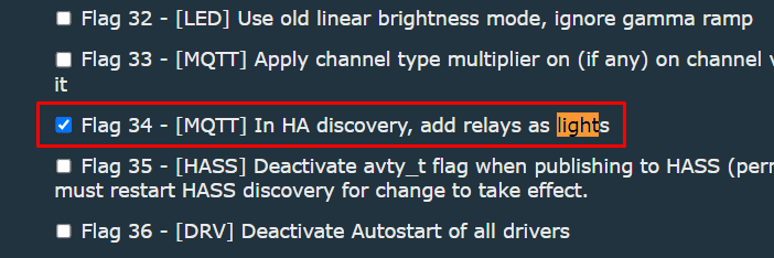

Now a curiosity. This is what relays look like, but what if we turn on light mode in the OBK? There is a flag for that:
Screenshot of MQTT flag configuration for HA Discovery .
Let's check. I have performed HASS Discovery again:
homeassistant/light/WinTest_00000000_light_2/config
So Home Assistant has lights and relay mode separately.... although you could probably just as well change the icon - but here it's also about the entity type itself, those "lights" after the slash in the publish subject.

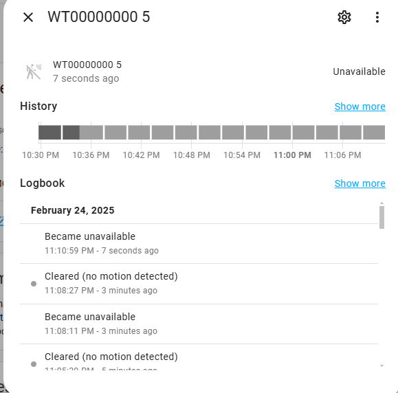

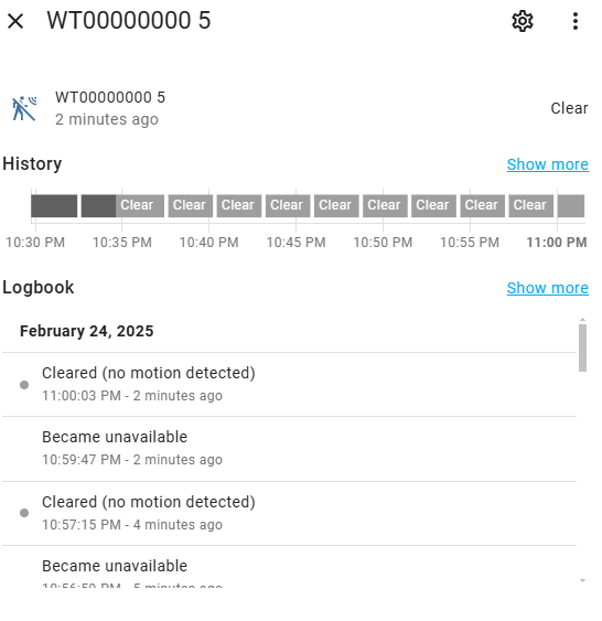

Movement.
homeassistant/binary_sensor/WinTest_00000000_binary_sensor_5/config
Here only the class is set - it is the class that provides the corresponding icon.
View of motion history for device WT00000000 5 in Home Assistant

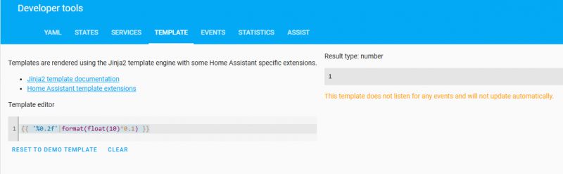

Now a more interesting thing - a temperature type, but divisible by 10. This comes from the fact that TuyaMCU operates on integers and this type of value is used there. Topic:
homeassistant/sensor/WinTest_00000000_temperature_7/config
This is where a new field appears - 'val_tpl'. This is short for "value_template", which means value template. It defines how the value ("value") is formatted before being displayed. You can conveniently test these templates in Developer Tools -> Templates, but about that another time:
Screenshot of Home Assistant developer tools showing the template editor. .

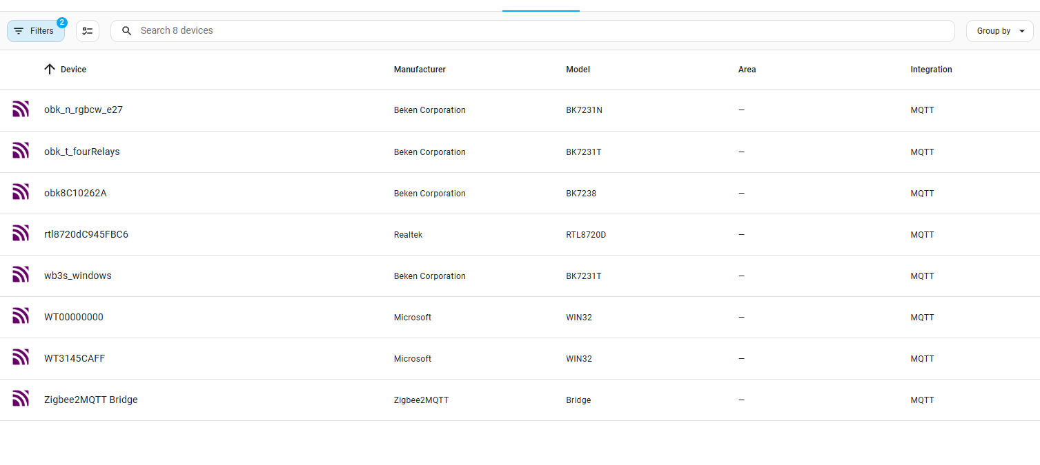

Now you know more or less how it works that the Home Assistant is able to detect devices on its own. This way, they do not have to be manually added to configuration.yaml. Home Assistant Discovery relies on the device itself publishing information about its entities separately in JSON format under the subject subordinate to "homeassistant/". These JSONs describe their parameters as well as subjects, values, types, icons and entities, and even templates for processing the values on receipt. Home Assistant parses this JSON and then creates the entities and devices itself in MQTT devices. For example:
List of devices connected via MQTT in Home Assistant. Home Assistant device control panel with device info, controls, sensors, and logbook. Screenshot from Home Assistant platform showing device status. .

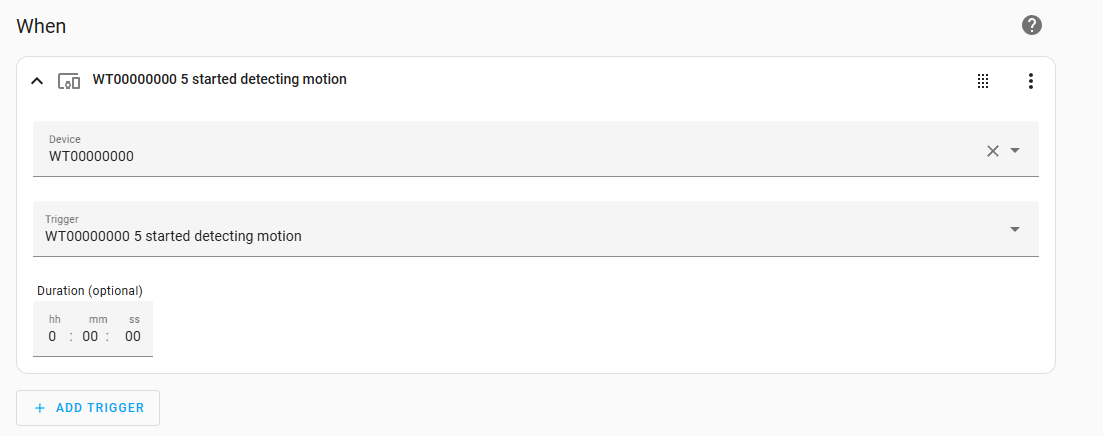

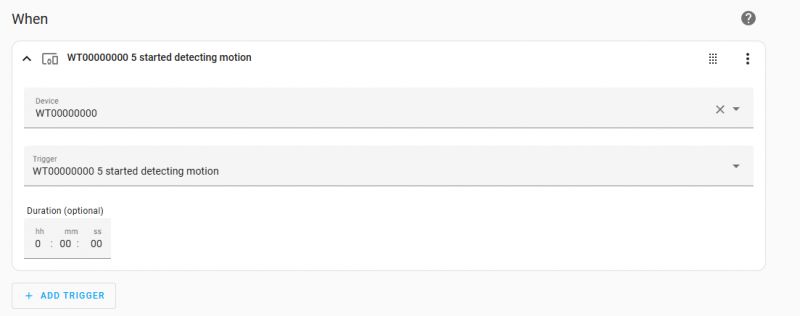

And you can already create automations from these:
Configuration of a motion detection trigger in Home Assistant. .

krzbor 25 Feb 2025 19:54
@pkaczmarek2 - on the Controls tab you have the switches. 1 and 2 look normal, while 3 and 4 are flashing. I've managed to solve the mystery of why this is happening - I'm curious to see if you've managed... [Read more]
p.kaczmarek2 25 Feb 2025 21:29
This problem has come up on the forum in the context of OBK. Users have reported that there are flashes (as it sounds like) when the HA restarts, and only when the OBK publishes its state do they turn... [Read more]
krzbor 25 Feb 2025 21:44
I have discovered why this happens. In the beginning there are lightning bolts. In order for them to turn into a normal toggle - and they turn automatically and we have no control over it - there must... [Read more]
p.kaczmarek2 25 Feb 2025 21:51
What do you mean by "exist" in the context of "state_topic"? From what we have tested with users, we have flashed in OBK until OBK publishes its state under "state_topic". To put it another way: 1.... [Read more]
krzbor 25 Feb 2025 22:09
"Exist" in the sense that some "xxx/yyyy" cannot be given. In other words, it is exactly as you describe - the HA must receive the state via the "state_topic" message and does not settle for the mere declaration... [Read more]
