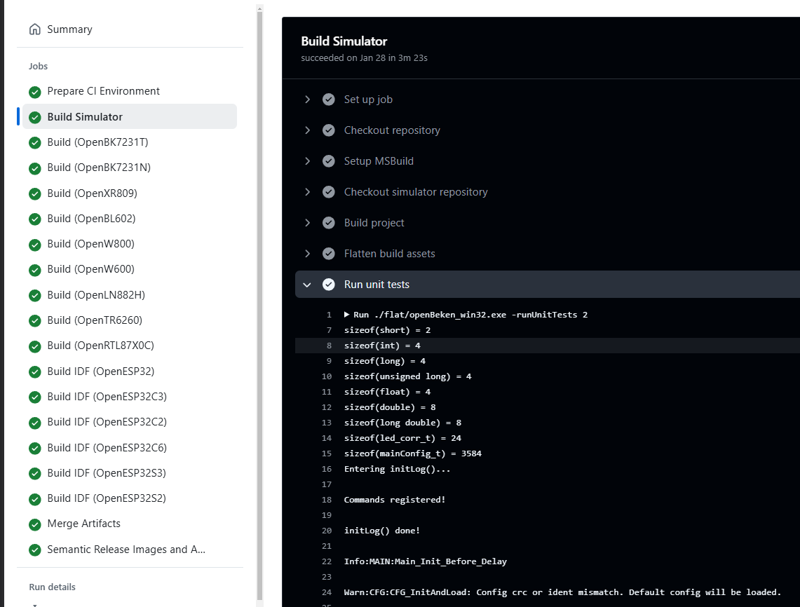

Currently they are run on Github on each build:
Screenshot showing results of a software build simulation.
More precisely, OBK Simulator is built for Windows platform on each commit and then it's used to run the tests:

    - name: Run unit tests
      run: |
        ./flat/openBeken_win32.exe -runUnitTests 2

To be more specific, the ./flat/openBeken_win32.exe -runUnitTests 2 line is responsible for starting them on Github machine. Then return value is checked to see whether all tests have succeded.
Those self tests are basically simulating a use case scenario, for example, setting up a LED, and then they check externally is the use case result as expected.
For instance, if we set two PWM pins, we expect CW control to show up and we expect Dimmer command to work. We expect certain things to be published when light state changes, we can test it as well. So, we simulate setting of two PWM pins, then we run some commands, and check if result is as expected (for example, are output PWM values as expected for correct CW control).

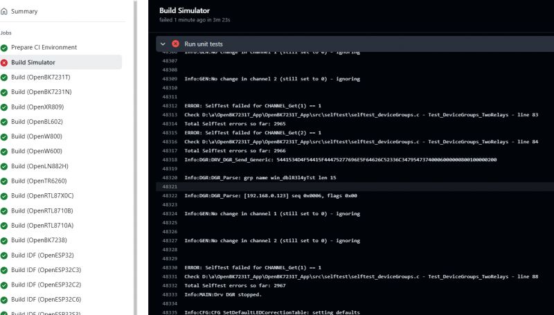

So now let's make a demonstration. We'll consider a hypothetical scenario where someone breaks some function by accident, for example, the channel set.
I modified CHANNEL_Set_Ex to always set value to 0:
Screenshot shows a GitHub pull request for merging a branch in the openshwprojects project.
Then I commited changes to Github.
Let's see what happens.
It's building, so we wait a moment...
Task list in progress on a version control platform with status information.
And then we get:
Dashboard showing the status of task checks in a build system.
As you can see, many self tests have failed. They expect channels to work, so they recognized that something is wrong:
Computer screen from a CI/CD panel showing various build and test job statuses, with one error.
