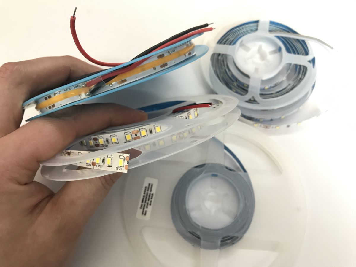

The base of the kit is just the LED strip, preferably for 12V, of course I mean 12V DC (12v DC). There are commercially available strips for other voltages, but it seems to me that these are less practical and versatile, especially as the whole idea is to power this strip from different power sources. In addition to the power supply voltage, there are a few more things to look at when buying one, such as:
- power consumption per metre - this also depends on the type of LEDs and their density; based on this, we will then select a power supply unit
- colour of light - here we rather choose between different white temperatures; for the home, warm white (approx. 2700-3000K) or neutral (4000-4500K) is best; cold white (6000K and above) may be too 'office-like'. I would rather not consider RGB colours here at all
- protective (IP) layer - if the strip is to be installed in areas exposed to dust or moisture (e.g. bathrooms, kitchens, balconies), it is worth choosing a variant with a silicone layer or with an IP65 and higher protection class
- easy to cut and solder - some strips have clear cut point markings and properly routed soldering pads, which makes it very easy to adjust the length and join the segments.
The photo shows the LED strips I have in stock at the moment, as you can see there are various types and shades, there is something to suit everyone:
Various 12V LED strip reels held in a hand, showing different types and light shades. .
The strip is mounted in a convenient place, the strip should be covered with adhesive tape on the underside, but I will discuss mounting in detail in another topic.

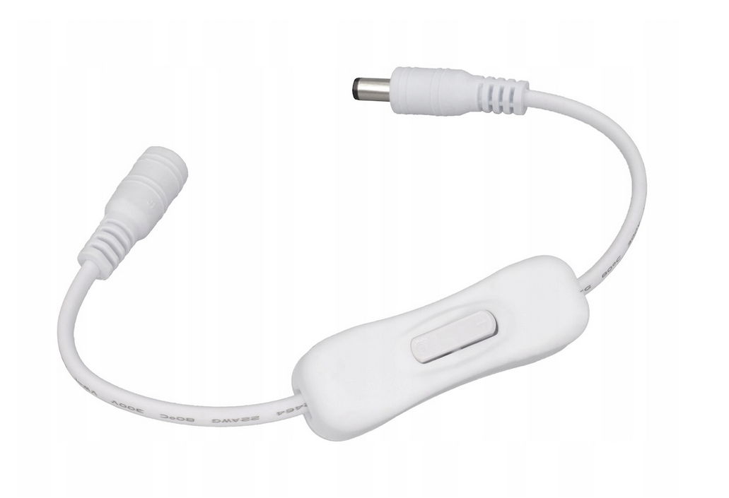

The whole point of the game is to be able to easily switch the belt to another power supply if necessary. It just so happens, that a solution to this problem already exists - many products for LED strips are based on a 2.1/5.5mm DC Jack connector:
White cable switch with DC Jack 2.1/5.5 mm connectors for LED strip. .
This type of switch is purchasable for about PLN5 in our country, and it is also possible to take it apart and use the wires with the connectors in other ways, such as soldering them to the LED strip. I myself also have quite a collection of sockets and plugs collected over the years for this purpose too:

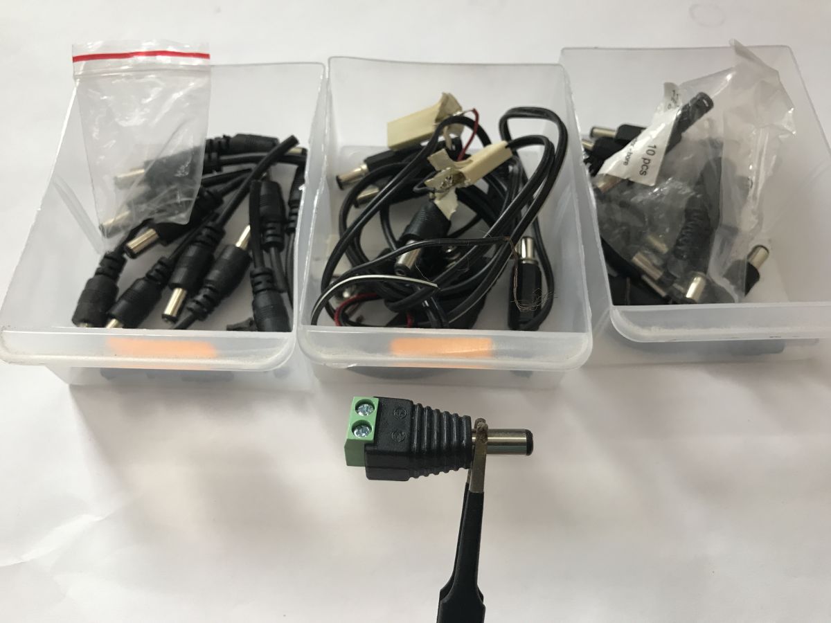

Three containers with various DC Jack connectors and a screw terminal adapter held by pliers in the foreground. .
I also really like the DC jack to screw terminal plug/socket converter shown here. Small and useful. If necessary, you can quickly switch the belt to another power supply or, well, to an emergency power supply, e.g. from a powerbank or battery.

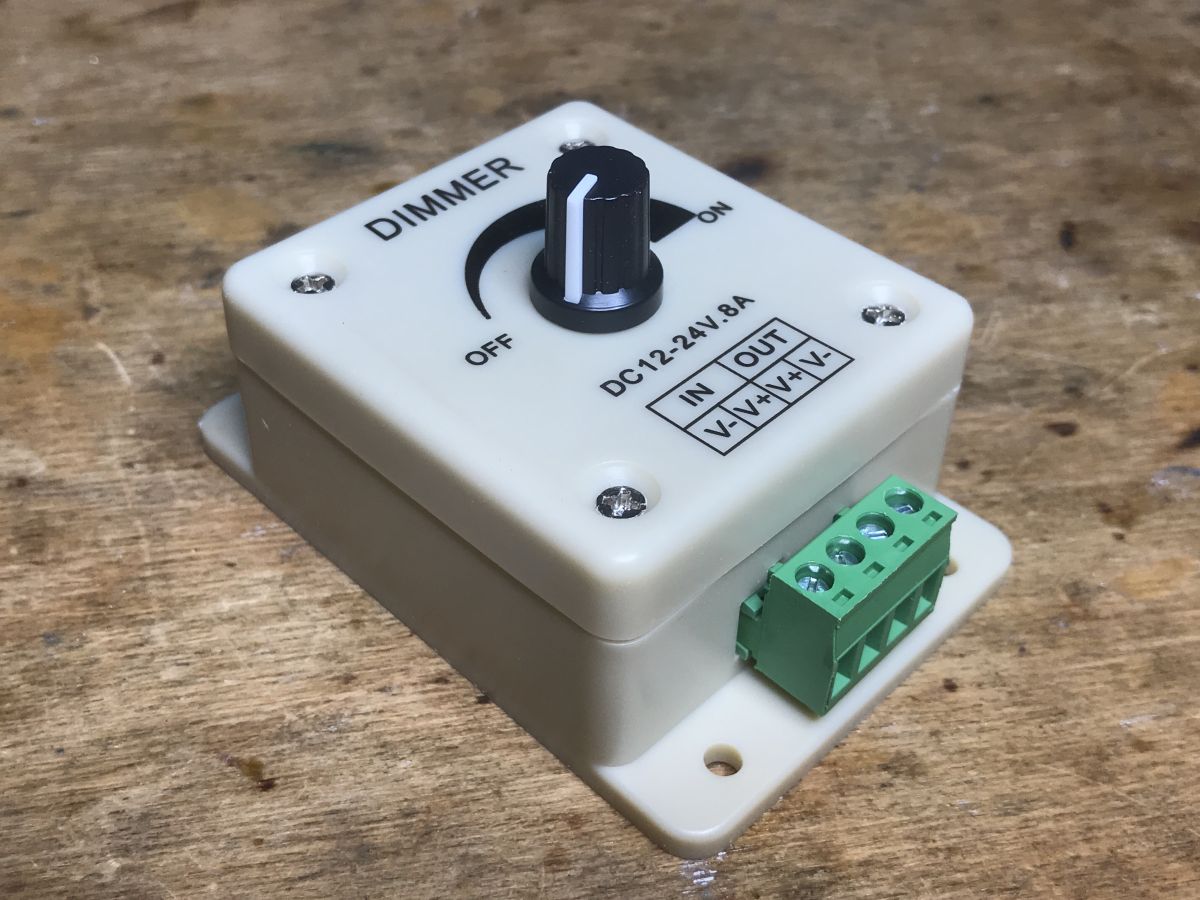

A simple dimmer module will be used here to control the lighting level. Such a dimmer plugs into the 12V line, between the power supply and the strip, and adjusts its brightness via PWM (pulse width modulation). I described the simplest dimmer in the topic about Bowi 002066 12V 8A .
Manual LED dimmer in a plastic enclosure with a knob and screw terminals, placed on a workbench. .
Dimmers with WiFi or remote control are also popular, for example such as the one from Tuya , but I go on the assumption that the basis of purchase is the buttons. If such a dimmer doesn't have buttons and can only be controlled from WiFi/remote/remote, then it's useless, and you need to either change the firmware and add buttons , or choose another model.

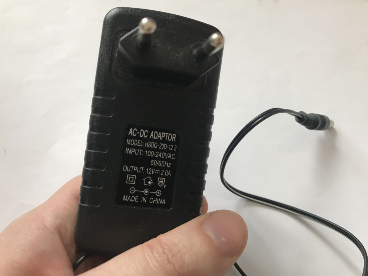

The power supply converts the mains voltage (230V AC) into a low DC voltage of 12V for the LED strip. The power supply should be selected for the specific kit, more specifically the current capacity of the power supply must be greater than what our entire kit will draw, preferably with a considerable safety margin. For example, if we bought 3 metres of a 9W/m LED strip, we need at least 3*9W, 27W, and in practice I would give a 40W power supply (the power at the input of the power supply does not take into account the losses on the power supply itself, plus the market is flooded with low quality, heating power supplies, and it would be better not to run them for long at the edge of their specification). A small LED strip can be powered from a smaller, universal 12V DC power supply:
AC-DC power adapter 12V 2A with DC Jack plug held in a hand. .

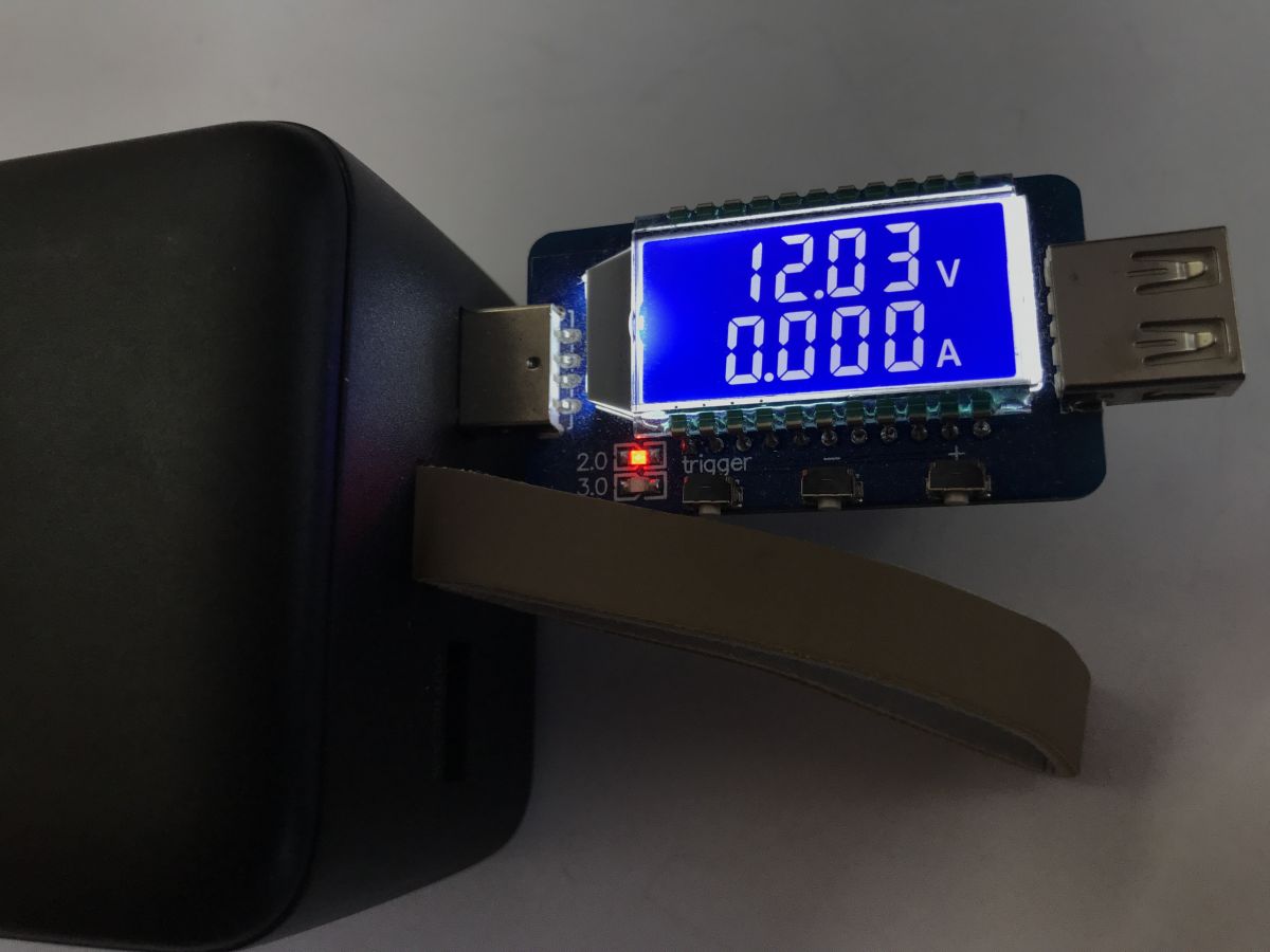

Now let's consider emergency power supply. To start with, the simplest option - a powerbank. A powerbank normally offers a DC voltage of 5V, but for some time now it has become popular to use a USB connector to provide a higher voltage to speed up the charging of devices. Among other things, this is made possible by the QC, or quick charge, standard. In this way, it is possible to draw 12V DC from the powerbank, which is the voltage we need.
Powerbank connected to a voltage meter displaying 12.03V and 0.000A. .

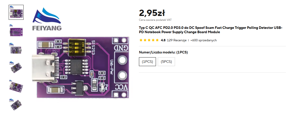

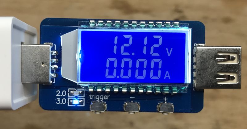

However, we will need a small module - the so-called QC trigger. It is this that plugs into the USB port from the powerbank and tells it that we want a voltage not of 5V, but of 12V. Such a module is very cheap, you can buy it for a few zlotys. Set the voltage using the DIP switches. Connect it to the powerbank, wake up the powerbank with a button if necessary and you are done:
QC/PD USB Type-C trigger module on a purple PCB, featuring a USB-C socket, DIP switches, and power output terminals. .
If you want more control and a display showing the voltage, then you can also use the QC Trigger tool with buttons. I have described it in more detail here: Minitest: QC 2.0 3.0 charger tester/trigger i.e. 12V with USB .
QC tester with blue LCD display showing 12.12 V and 0.000 A, connected to a charger via USB port. .
Before using a powerbank in this way, it is also customary to check its current capacity. Just like with a power supply - the powerbank must be able to deliver at least as much current as our belt will want to draw. Look for information on the current capacity of our model in the manual or on its case. An overloaded powerbank will simply switch off, but this can also be dealt with - simply reduce the brightness level with a dimmer and thus reduce the current draw.

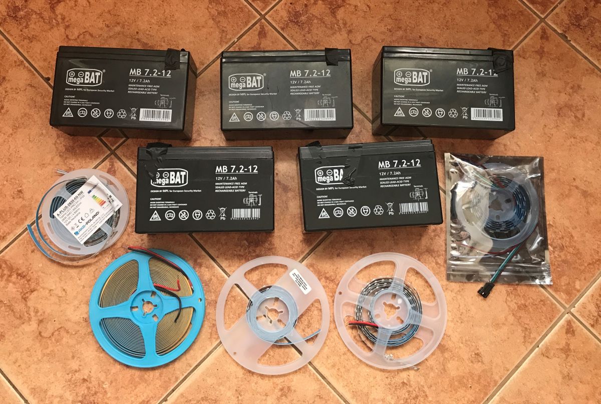

Power supply from battery .

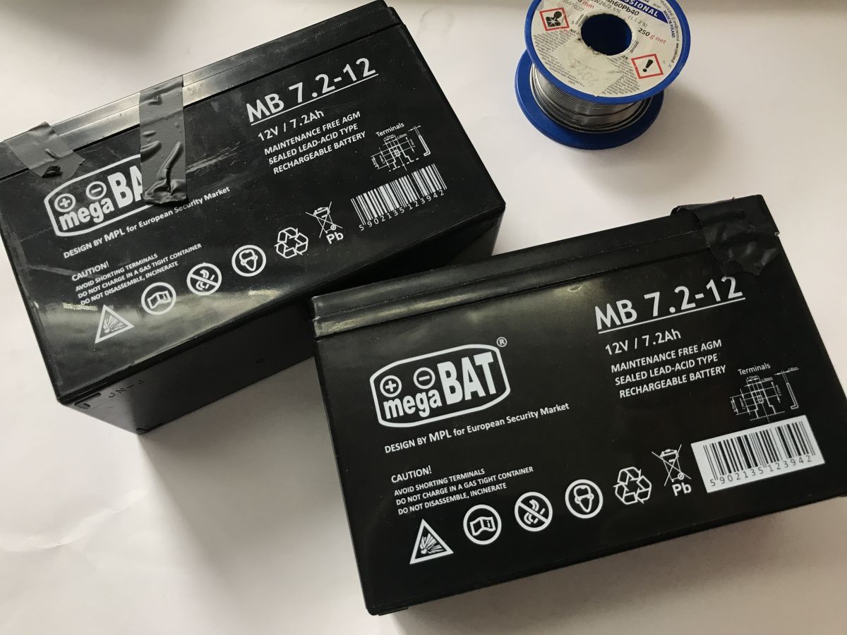

This type of LED strip can also be powered directly from a battery with a nominal voltage of 12V. In practice, the voltage of the battery is not constant, but fluctuates depending on how charged it is - typically ranging from around 11V (when discharged) to as much as 14V (when fully charged and charging). Our LED strip is at 12V, so inevitably when the battery is full a slightly higher current will flow through it, resulting in it being brighter, hotter and potentially shortening the life of the LEDs, but this is not a problem in an emergency situation. You can always 'help' the LEDs a little by changing the dimmer setting or possibly give a couple of 1N4007 rectifier diodes in series to lower the voltage.
Two black 12V 7.2Ah gel batteries from MegaBAT and a spool of soldering tin on a white background. .

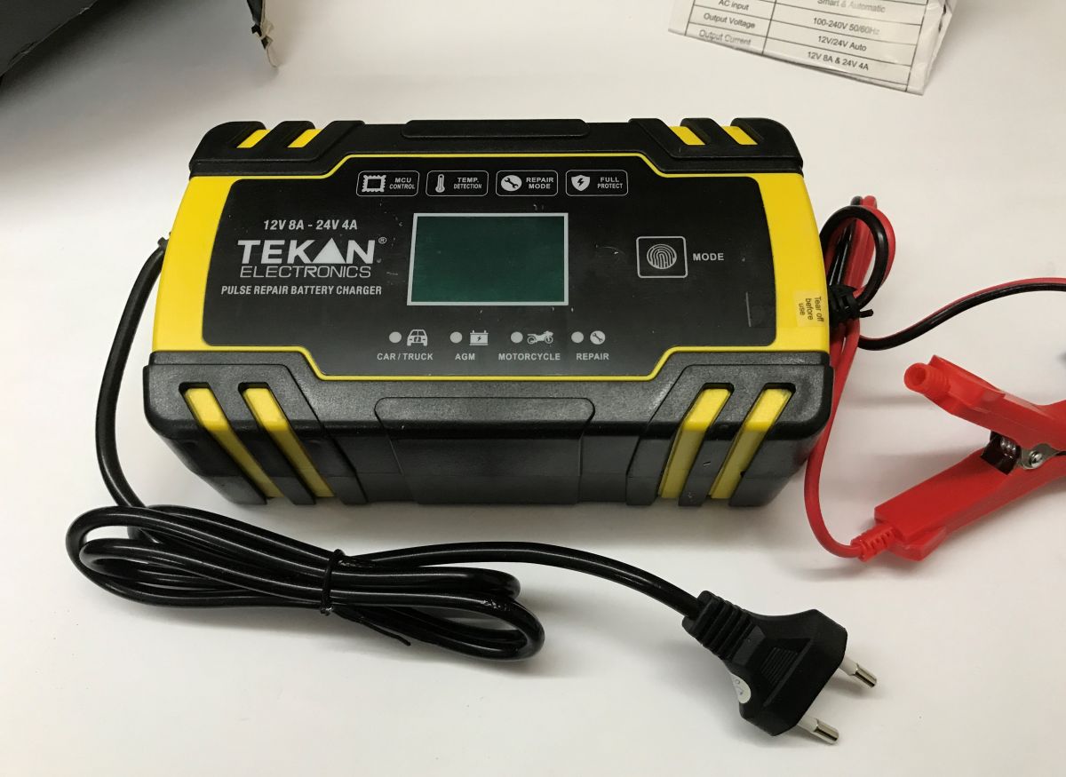

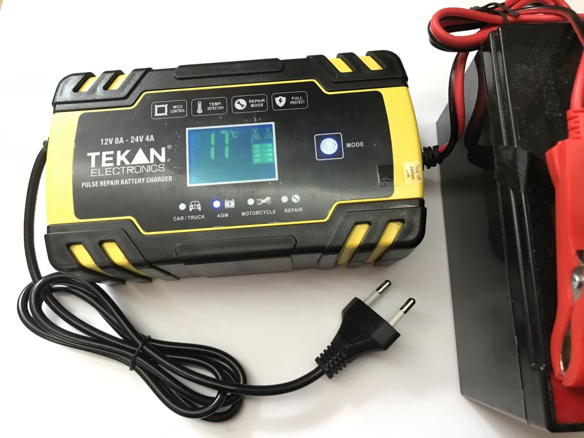

You need a rectifier to charge such a battery, but that is a bit beyond this topic:
TEKAN ELECTRONICS battery charger with display, cables, and power plug, partially visible battery. TEKAN Electronics battery charger with LCD display, power cord, and battery clamps. .
The cable itself from the battery (terminals and jack plug) is worth preparing in advance.

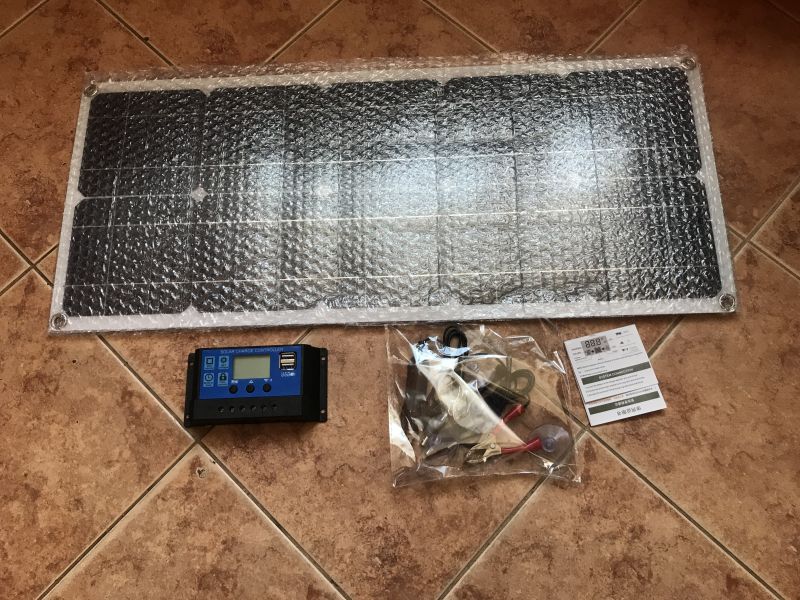

Power from battery (charged from photovoltaics) .
With a battery already in place, you can go one step further and add a tiny solar panel along with a charge controller. I have been testing just such a solution for a few years now, and I have to say that even the "100W" version (in practice 25W) combined with a couple of small batteries makes it possible to run LED lights at night and charge mobile devices on the allotment during the day, as I described in more detail in
separate topic 66x28cm "100W" panel from China .
Solar kit: photovoltaic panel in bubble wrap, charge controller, accessories, and manual on the floor. .
Such a solution already allows, among other things, the regular use of lighting, as long as the sun recharges the set during the day, and phones can also be charged this way, but that's for another thread.... (then you need to have in turn a 12V -> 5V inverter).

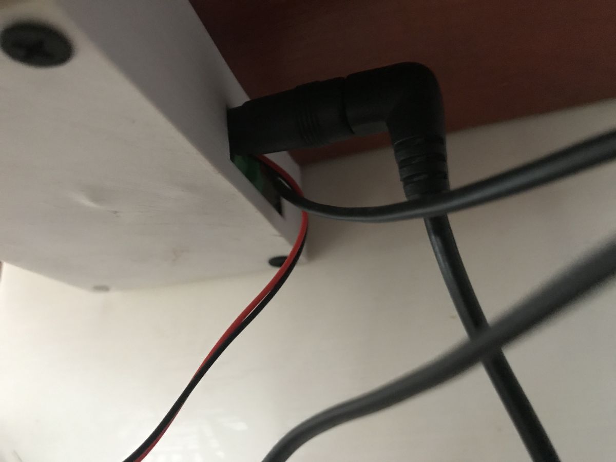

I use the approach shown here in practice and in a variety of places, which I can even show, although my LED strip connection is not rather aesthetically pleasing, it is actually a temporary solution that has been made permanent. Pictured is my DIY dimmer with push buttons and WiFi control and my other dimmer (push button only) from the kitchen:
