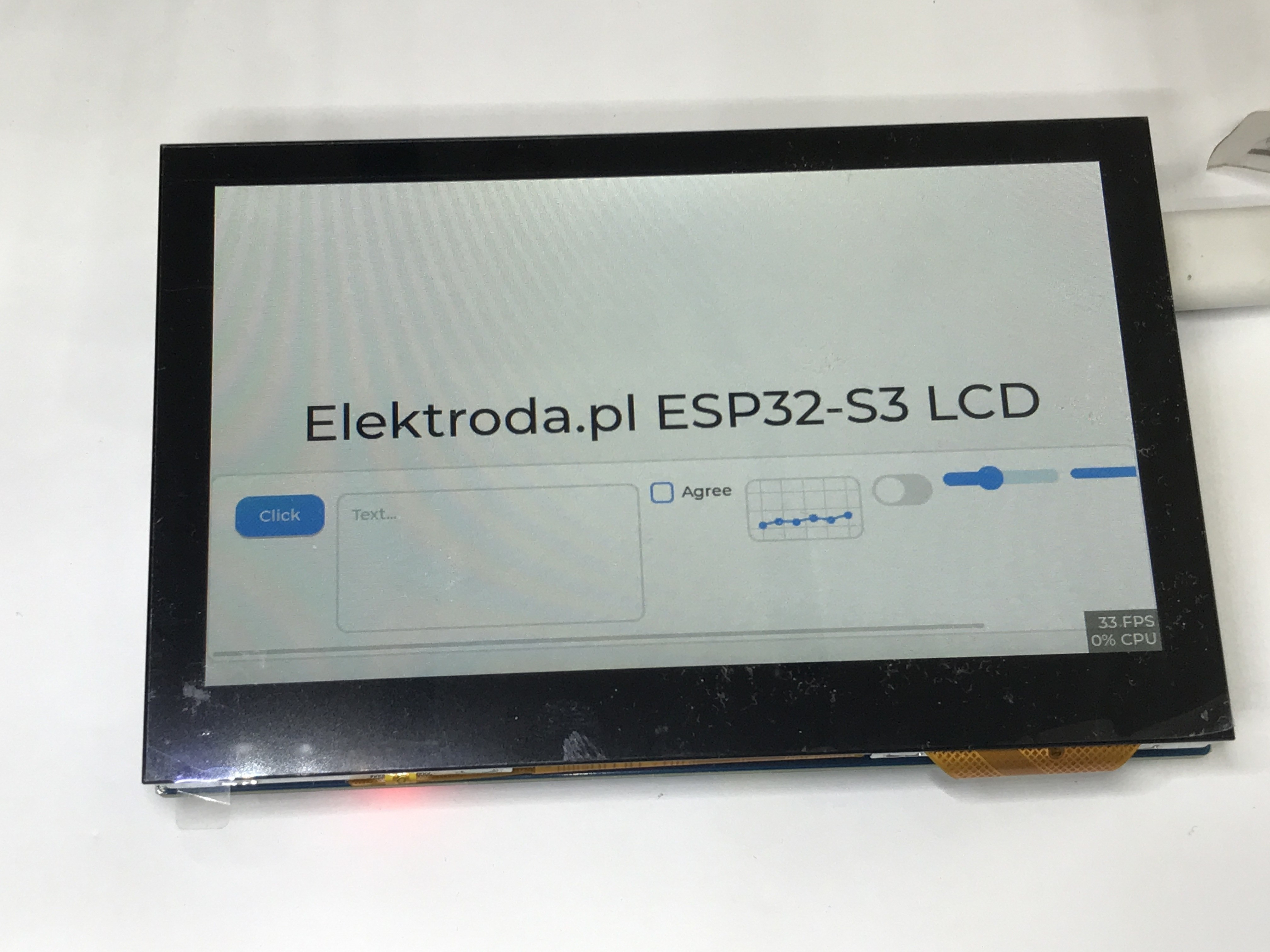

The solution turned out to be editing the BOARD_CUSTOM.json file - changing the default_16MB.csv partition table to default_8MB.csv, I also changed the Flash size in the upload section.
I have prepared simple example code for this, which sequentially creates different types of components within a single template:
Code: C / C++
The above code creates successively:
- a label (lv_label) with text in large font, centred on the screen
- a container/template (lv_obj) with a flexible horizontal layout (LV_FLEX_FLOW_ROW) and spacing between elements
- button with 'Click' label
- text box (lv_textarea) with hint text "Text..."
- checkbox (lv_checkbox) with the text "Agree"
- line chart (lv_chart) with sample data
- switch (lv_switch)
- slider (lv_slider) with a range of 0-100 and a set value of 40
- progress bar (lv_bar) with a set value of 70
- a dropdown menu (lv_dropdown) with three options to choose from
Result:
Basically, that's it - you can programme.
