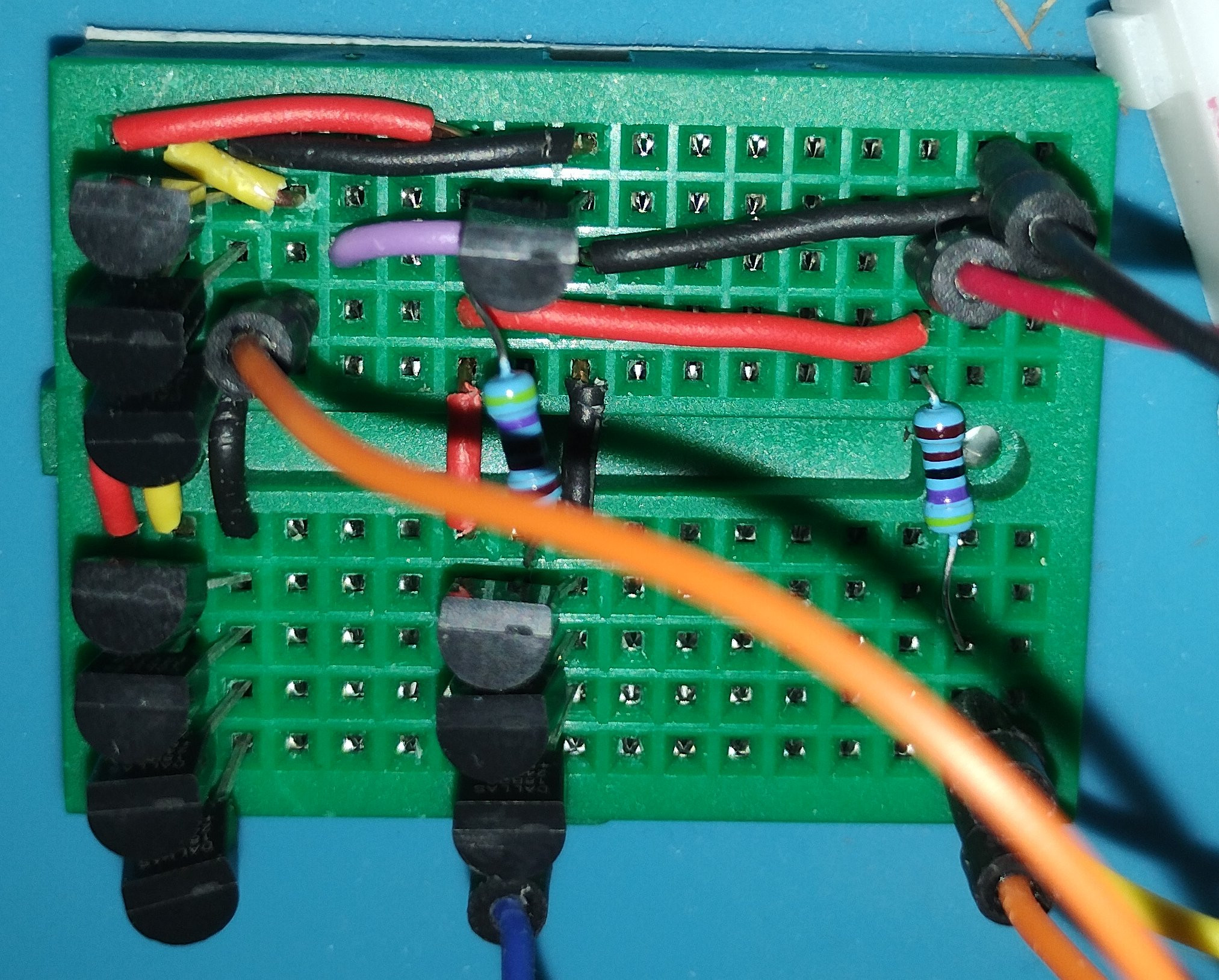

Maybe you want an idea of how my setup looks like? I made a small "testing breadboard" that will provide two "buses" with 7 and 3 sensors, and one "single" sensor. The 7 and single sensors are meant to be used exclusively; they share the 4.7kΩ resistor (thanks to git user "rpv-tomsk" - see PR PR #1579 - using "HAL_PIN_Setup_Input_Pullup" it might also work without an external pullup).
