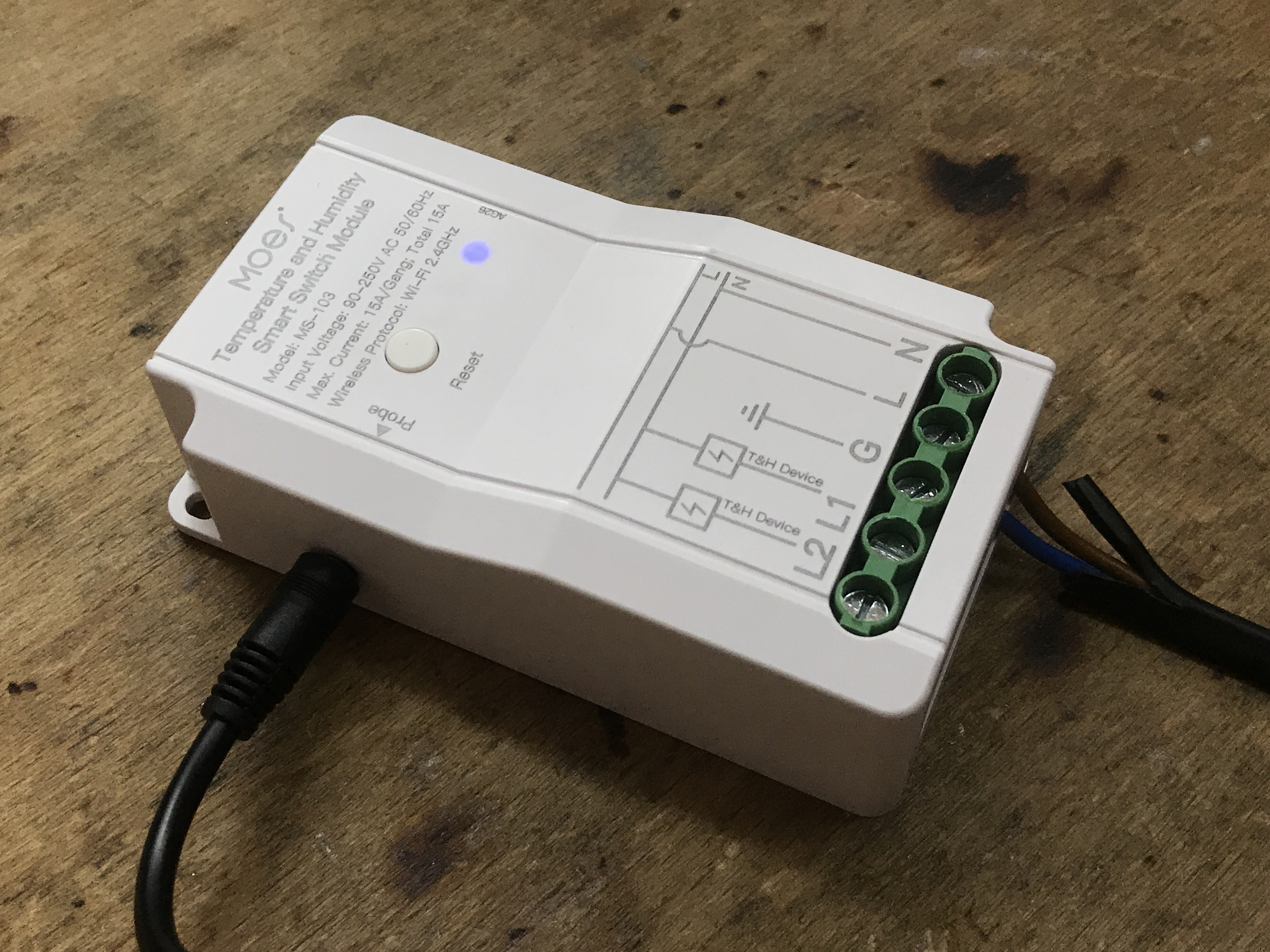

The Moes MS-103 programmable dual relay with temperature sensor allows you to control two receivers depending on the current temperature. It can also be controlled via WiFi. Here I will introduce its pairing with the Tuya app, discuss the possibilities of the app and then present an alternative way, i.e. changing the firmware (cut from the cloud) and connecting to the Home Assistant.
The whole thing is available to buy for around PLN100 and comes in two versions - DS18B20 (waterproof temperature sensor) and AMS (temperature and humidity sensor):

Connected and assembled device:

Inside of the unit .
The whole unit is held together only by hooks. The PCB inside is marked NH-TH16-V1.1:
The device is realised using the WB3S module, the BK7231T. The probe uses a headphone connector.
The relays inside are 932-5VDC-SL-AH-G. They are controlled by a voltage of 5V. In the photo you can also see the LDO 3.3V powering the WiFi module.
A 10R/1W fuse resistor protects the input and a varistor is also present.
The power supply is provided by LP3667. I associate it with the POWR316D. It is a flyback boost converter controller.
