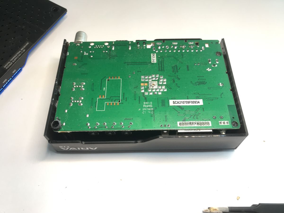

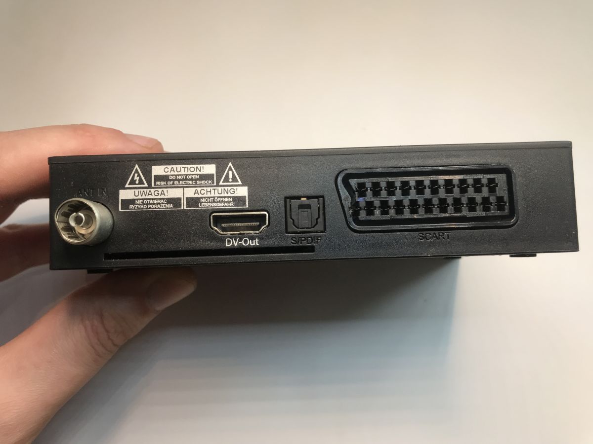

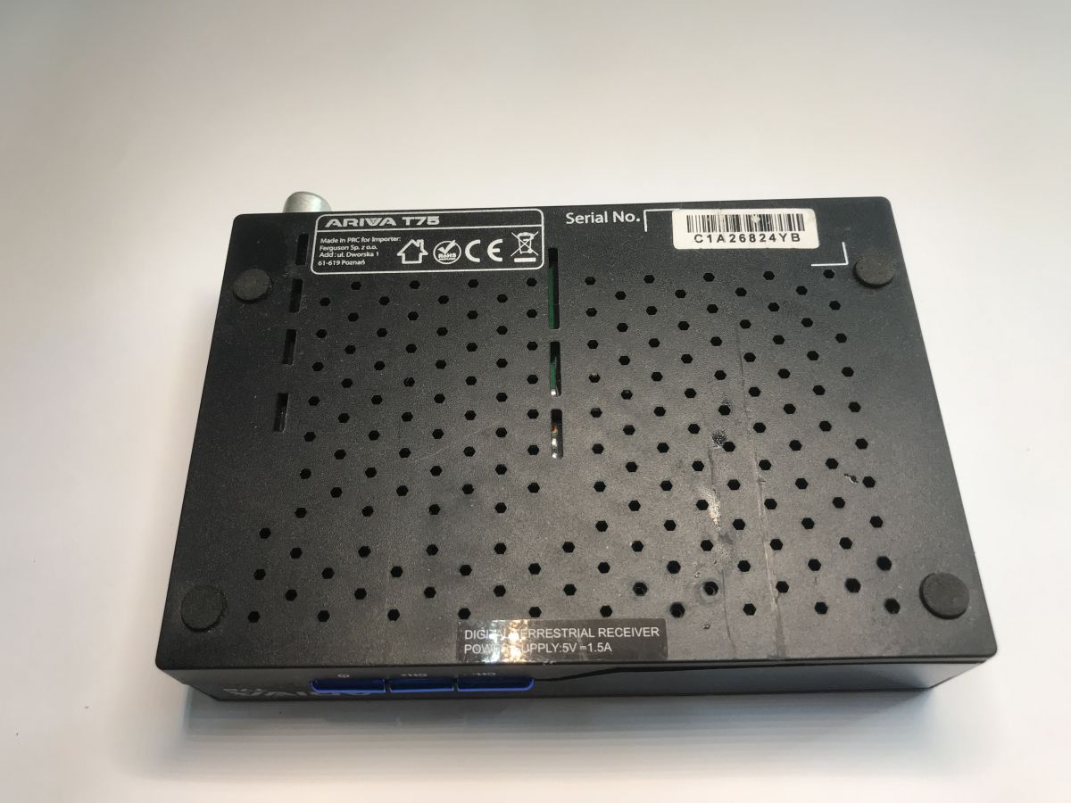

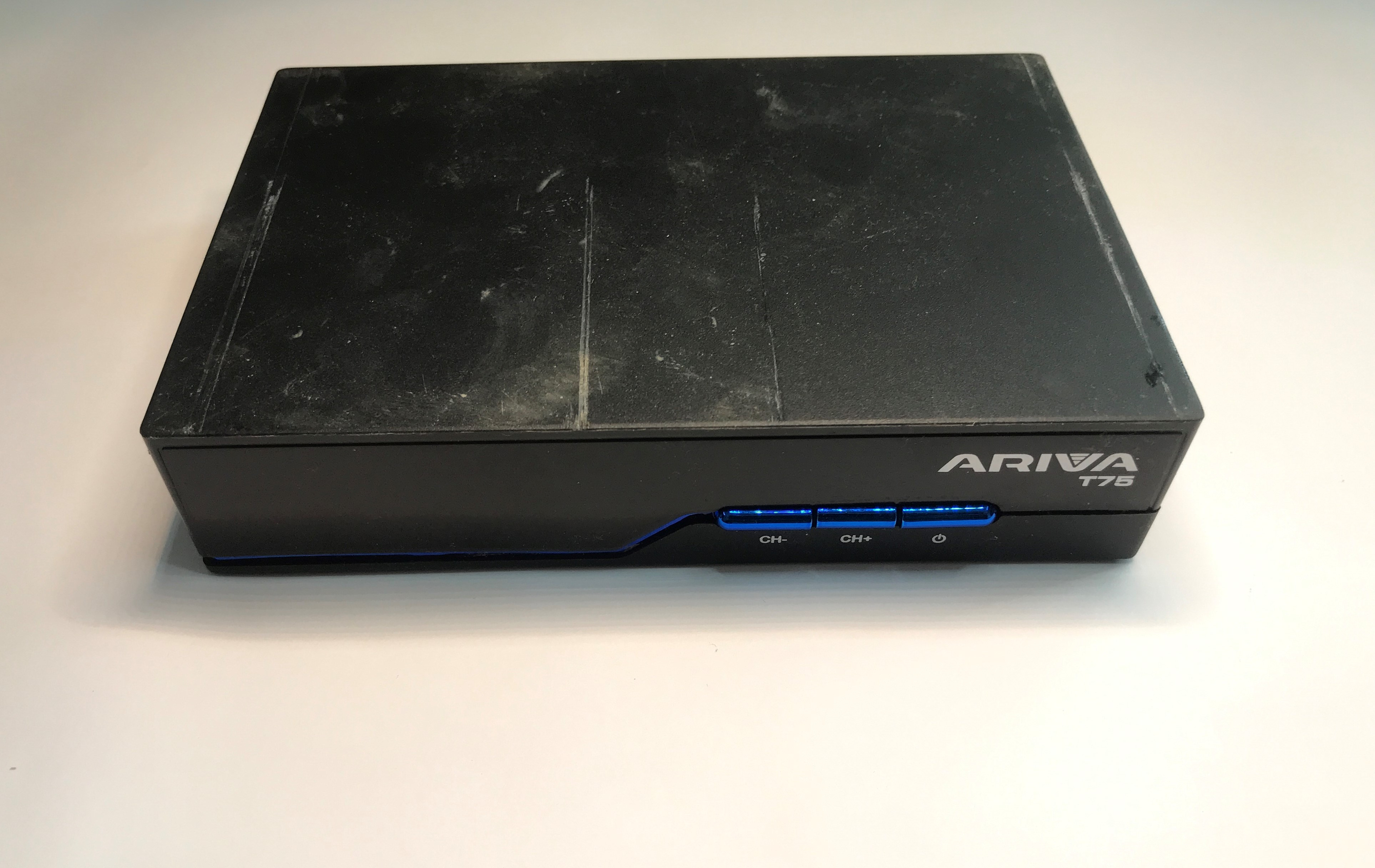

I'd like to invite you to a brief analysis of another piece of television equipment. This time I received a slightly newer, but again decomposed device. Ariva T75 without power supply and remote control - this decoder has already been shown on our forum . From the outside, the whole thing appears quite minimalist, but what else besides HDMI does a typical user need?

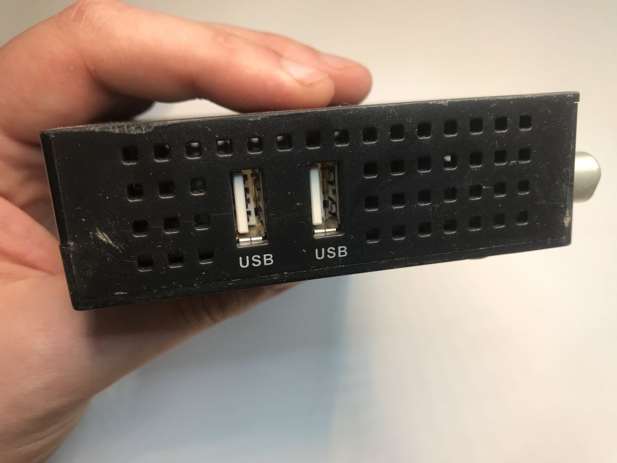

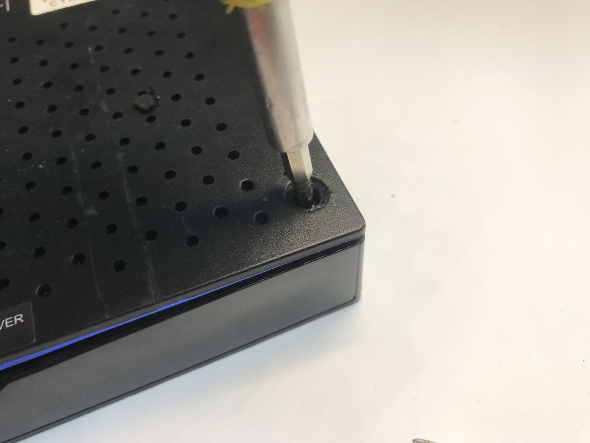

Virtually no one uses such USB ports for storage devices in my area. Time to look inside - the screws are under the feet:

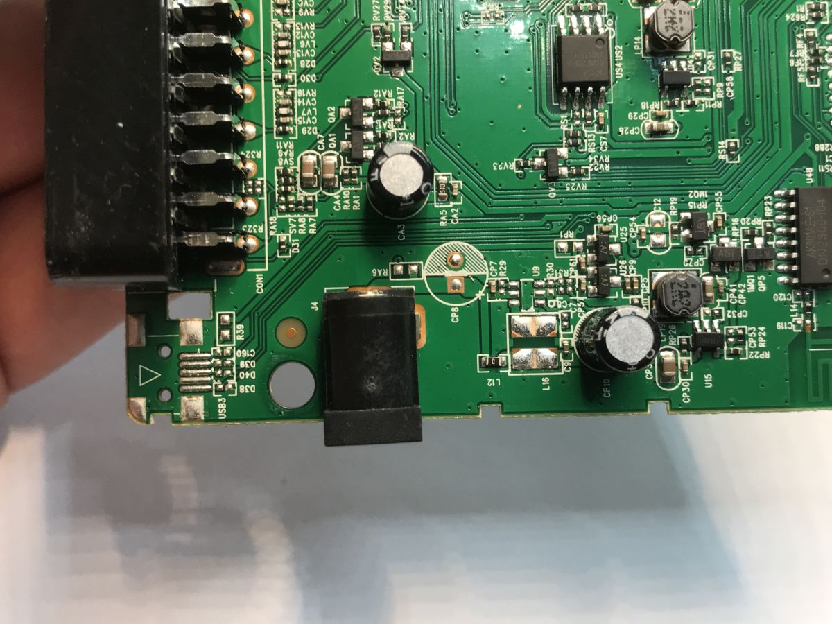

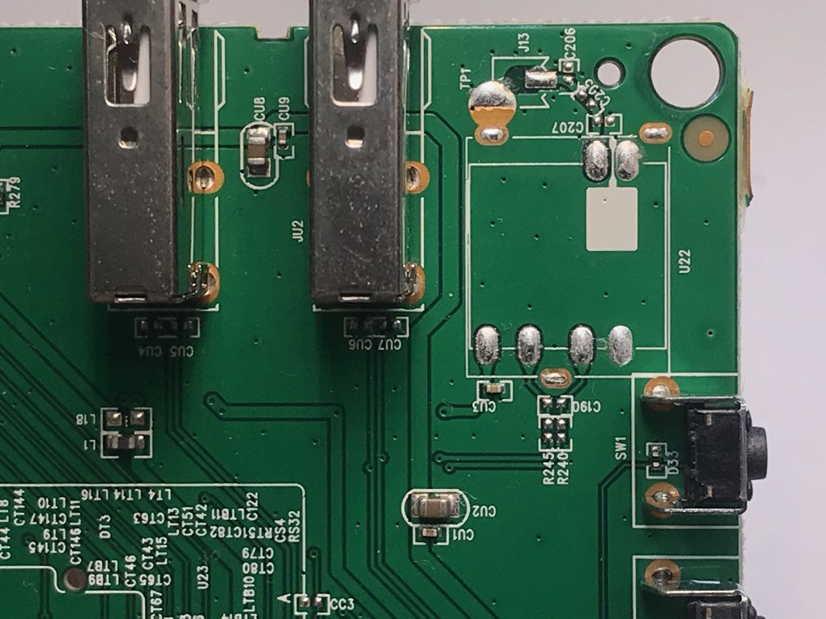

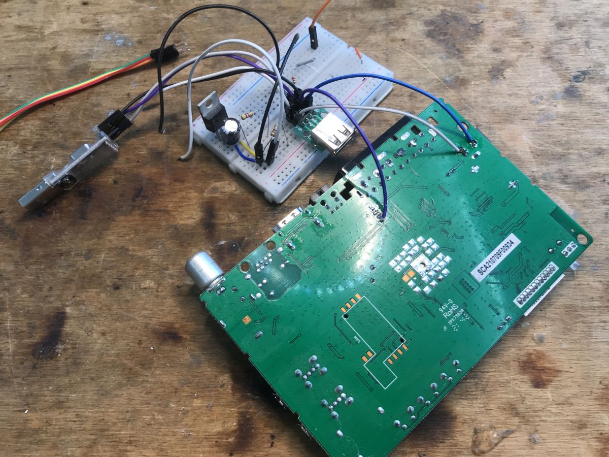

The PCB is one - the power supply is external. I was interested in this footprint of some module on the bottom, anyone know what it is from?

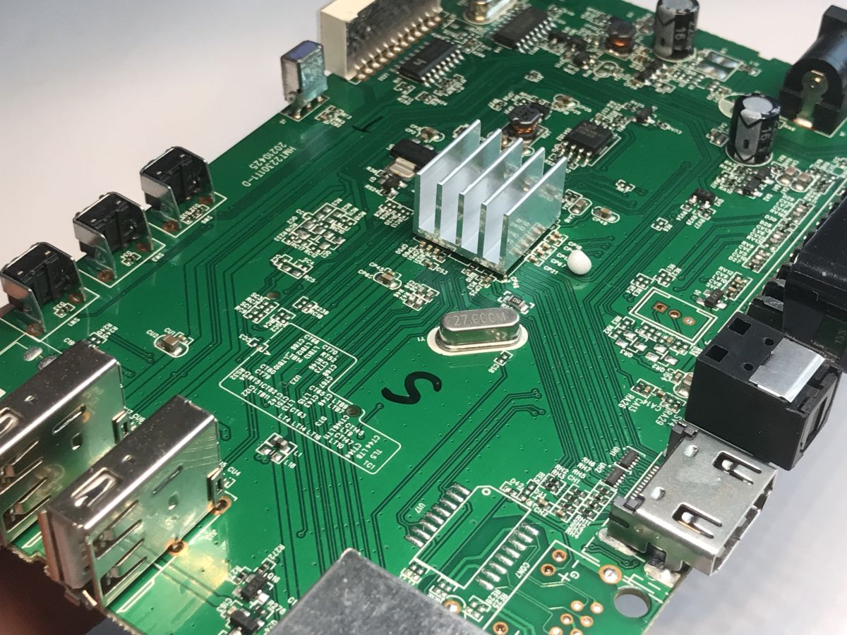

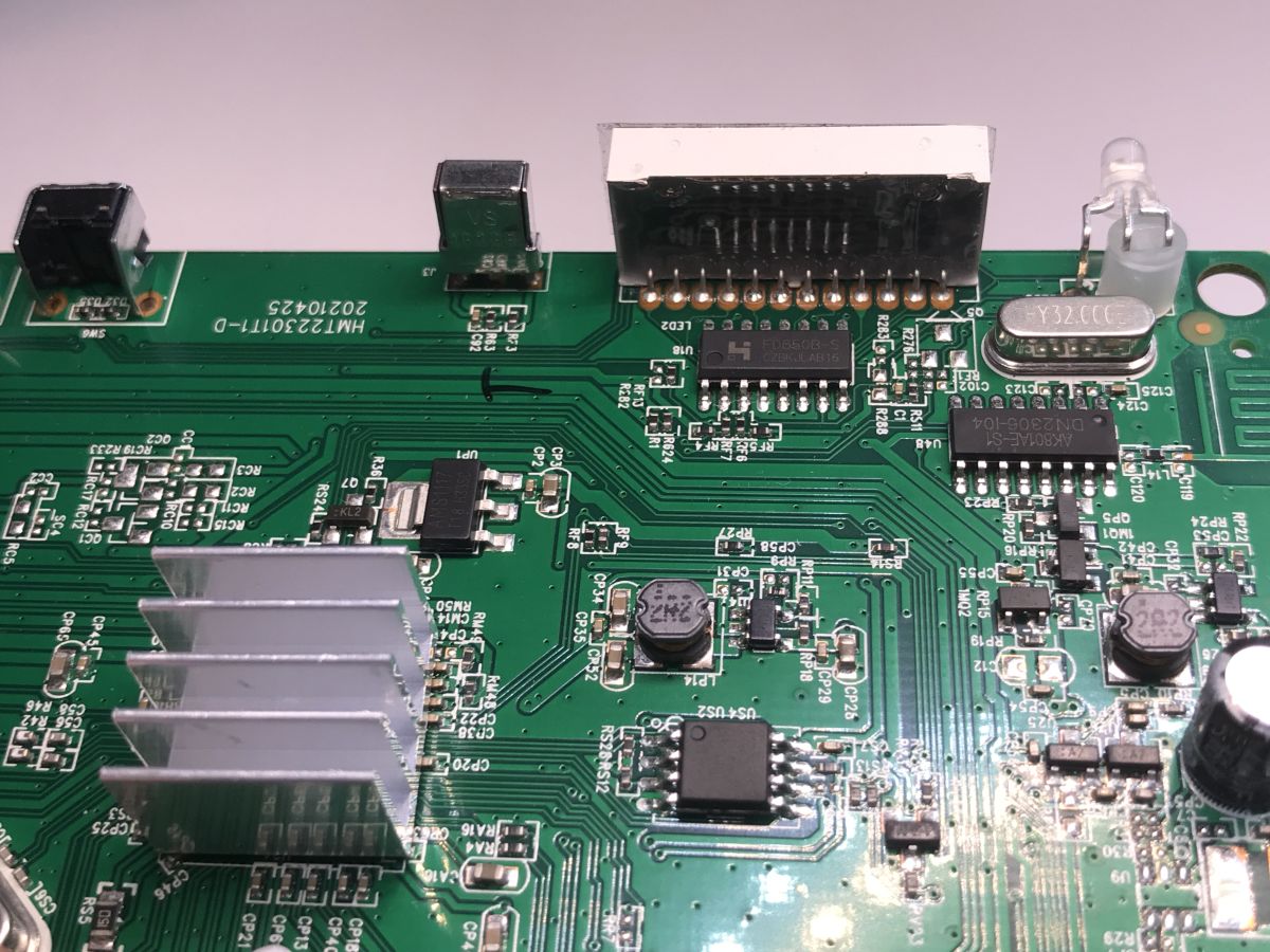

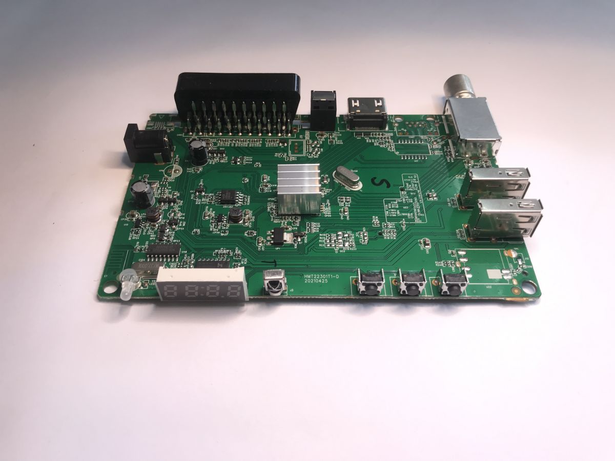

The PCB designation is HMT22301T1-D 20210425 Four year old hardware. Apart from this you can already see the standard sections:
- inverters (voltages for memory and processor)
- processor and next to it the Flash memory
- display, buttons and their controller, probably with SPI or I2C interface
- RF tuner
In the power section I see traces of an option with a Micro USB connector. Interesting that there is no reverse polarity protection diode, in older equipment I sometimes see it.

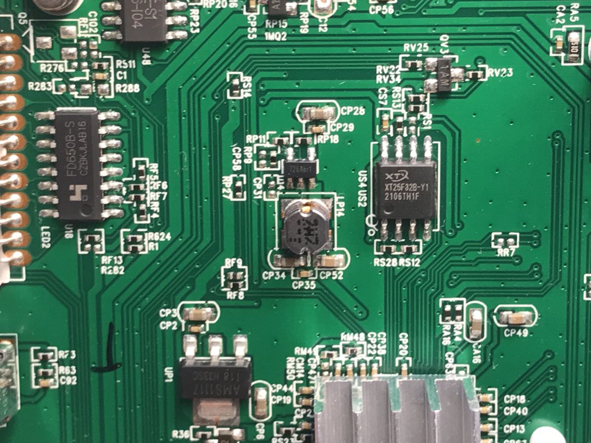

With the display it is fairly typical. The controller is an FD650B. From what I recall it is the same as the HD2015, so I have already discussed it:
We are running the HD2015 display/button controller after reverse engineering, comparison with TM1637itd .

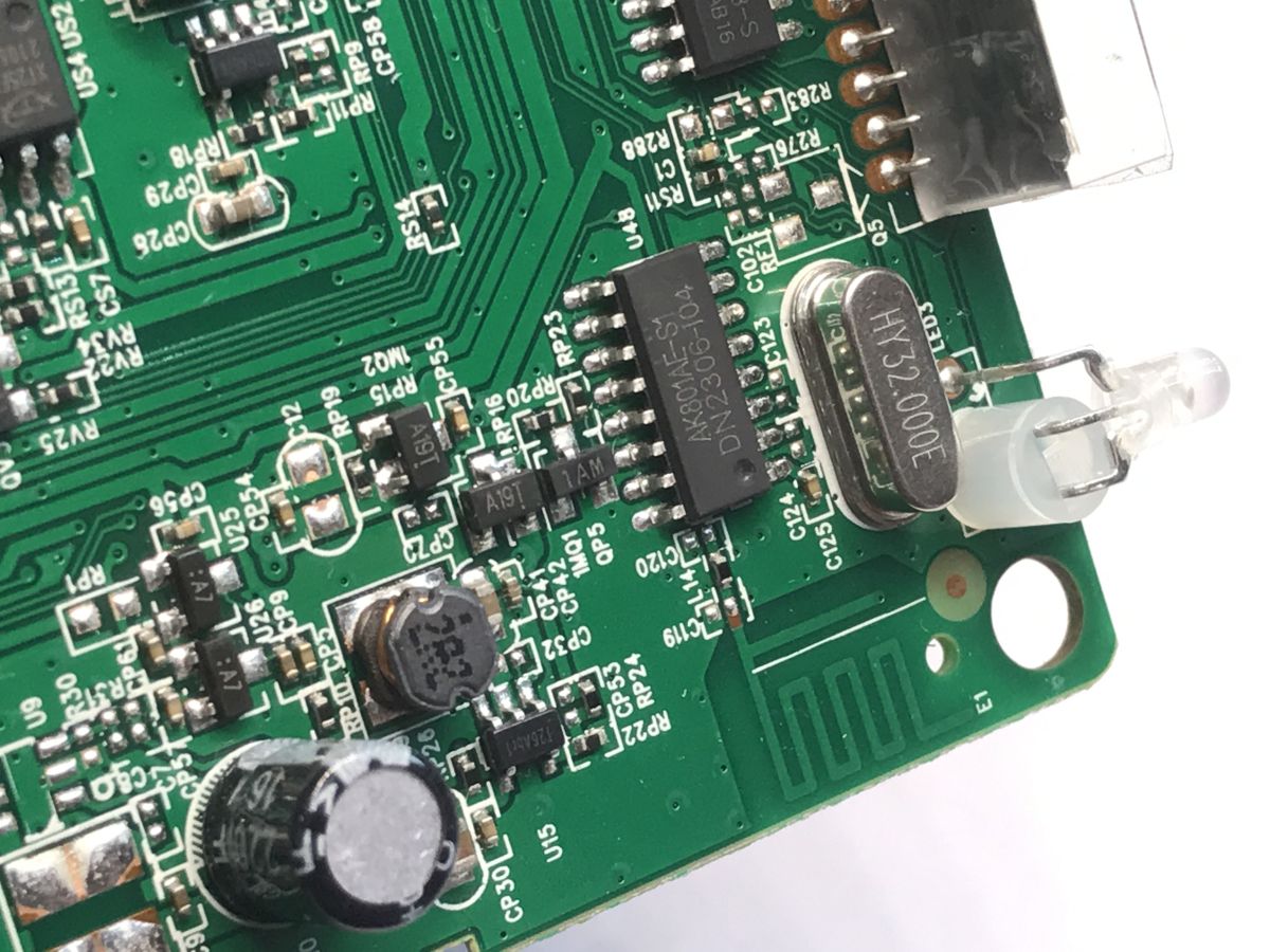

Next to it is more interesting - an AK801AE-S1 DN2306-104 with an antenna. It looks like an RF circuit. I haven't seen this one before.
I didn't have to look long for the explanation to this puzzle - it's a Bluetooth chip:
Next we have the aforementioned Flash memory, here as much as 4MB. This could come in handy and after scrapping the tuner:
Additional Flash memory for measurements for free? Communication protocol, write, read, erase .

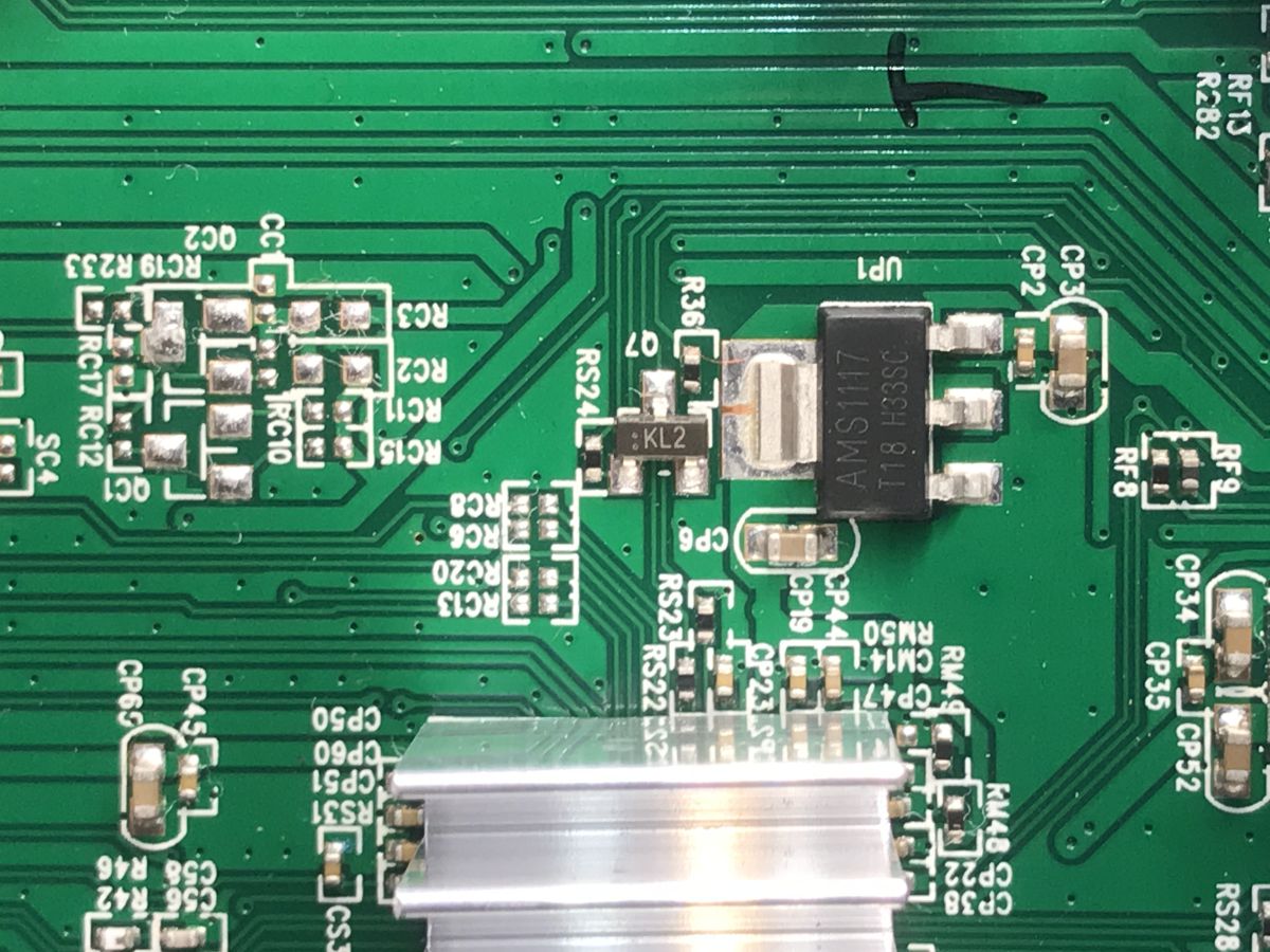

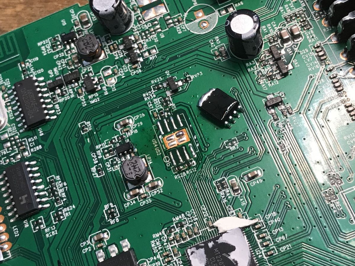

Next up is an element I often see in tuners like this, but it always puzzles me - if we have step down converters, why the extra 1.8V LDO AMS1117?

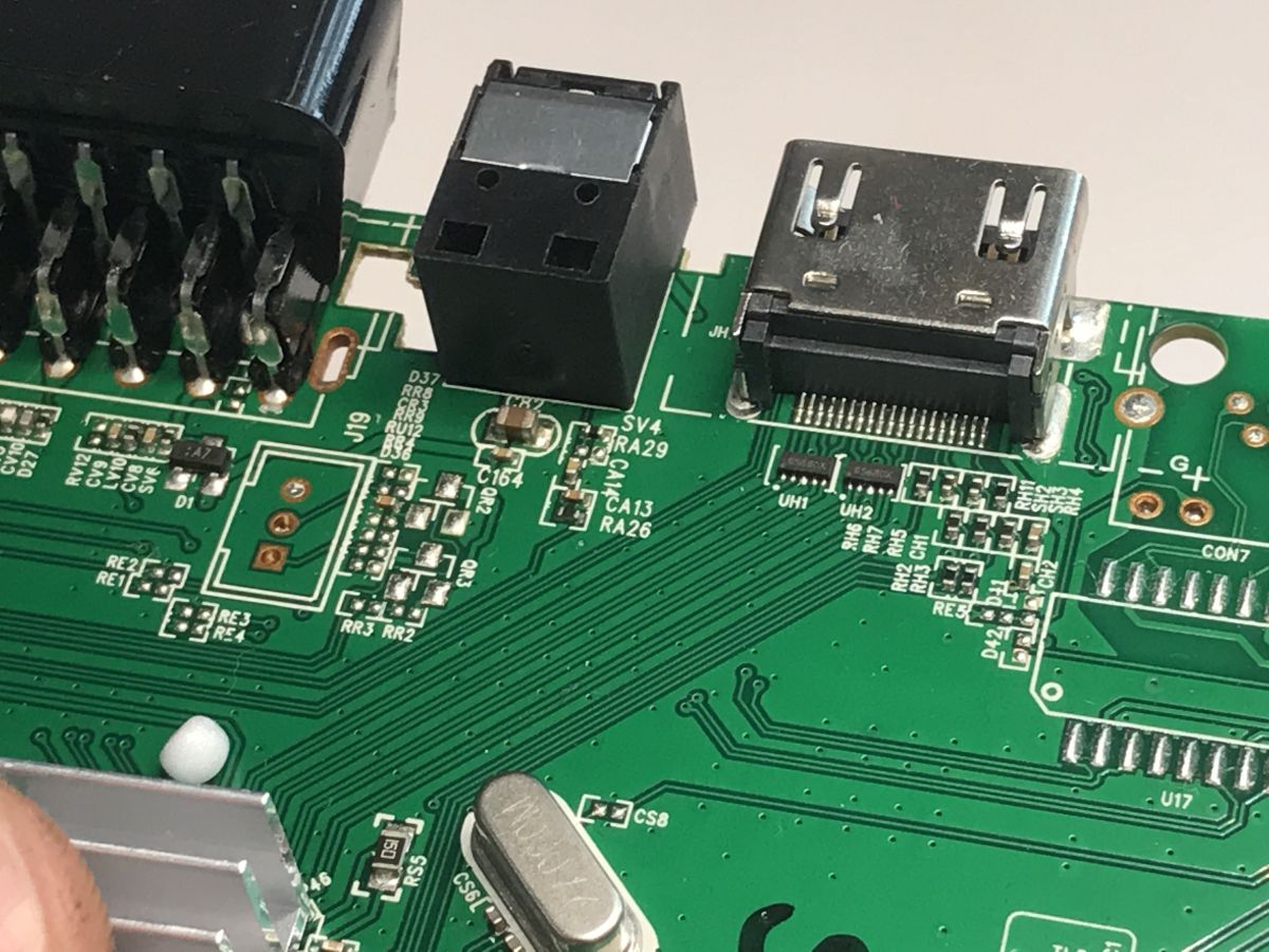

A view of the board - who recognises the CON7 connector? You can also see a potential three-pin connector on the UART in the background.
That CON7 looks like an Ethernet connector to me, those LEDs give that away too, and U17 looks like a signal transformer.
HDMI is only connected to the CPU via the components marked UH - probably some sort of filters.

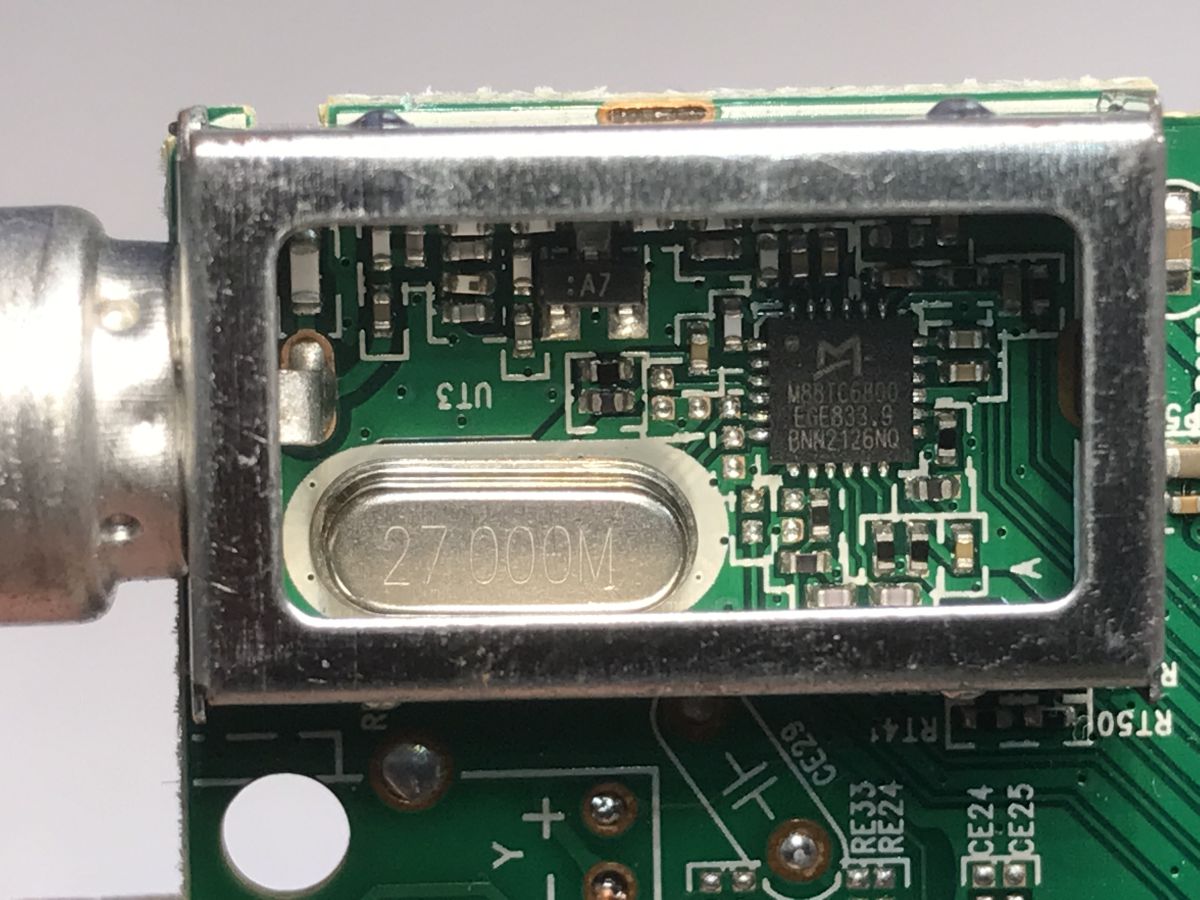

The signal reception is implemented here on, as far as I can see, an M88TC68000:

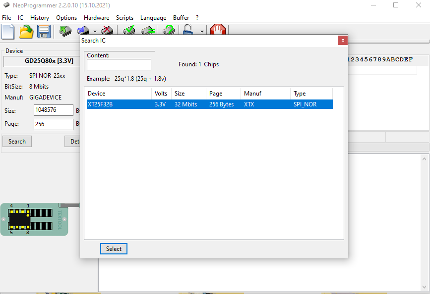

I also dumped the device memory using the CH341 programmer:
I found interesting messages in my memory - for example "Error cannot boot from media", or "com_bootloader". The firmware was compiled on 21 January 2021.
A copy of the firmware:
https://github.com/openshwprojects/FlashDumps/commit/7fe724b994f5305930d48bb1606fd2d22eec8c30
Feel free to download and experiment - who will find more information in this dump?

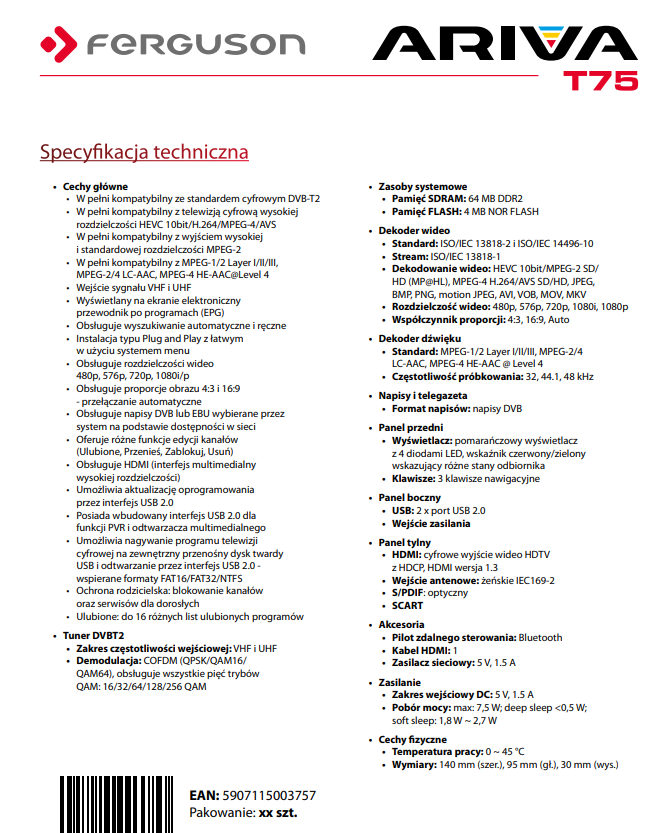

PS: Device specification from the topic:

https://obrazki.elektroda.pl/2522182800_1752663330_thumb.jpg . This footprint is probably for the smardcard reader https://obrazki.elektroda.pl/1337392600_1752663388_thumb.jpg [Read more]
