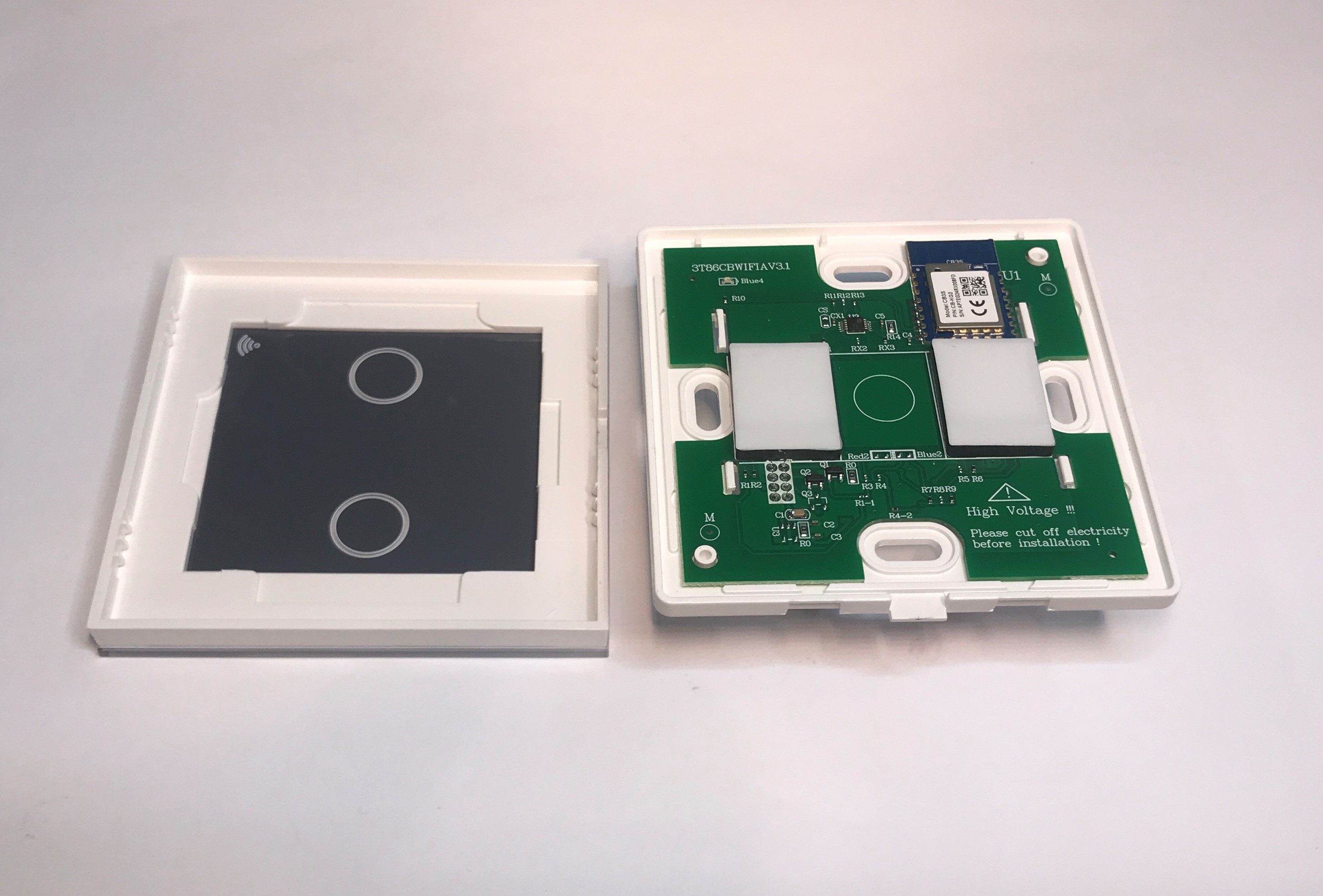

Which silent light switch for the Home Assistant? Here is another product compatible with our Polish open source IoT software - ATLO-TB2-TUYA. This time without the relays. I will present here the double version, i.e. with two buttons, although you can get the same thing in a single or triple version. The price of the product is around PLN50 - depending on the number of buttons. You can get it cheaper by importing from China. This particular switch does not require a neutral wire to work. Let's start with the contents of the kit:

Let's get straight to the inside of the product. The front panel is removable.
Disassembled touch light switch with CB3S module and two-button front panel Interior of ATLO-TB2-TUYA double touch light switch with WiFi module
Designation: 3T86CBWIFIAV3.1
The whole is based on the CB3S module:

You can immediately see that there are no relays here, so there will be no characteristic clicking.
Interior of the ATLO-TB2-TUYA dual touch switch with visible electronics .

In summary , this product is distinguished by the absence of the characteristic click when switching. Just right for people who find it annoying or distracting, although someone else might say it's a downside because there is no 'beep' to tell you the circuit has been closed. Just whether such a 'signal' is needed? Rather, turning on a light is sufficient - as long as there is no problem with the bulb.
Changing the firmware was again very easy, there was no need to desolder the CB3S, and our flasher discovered the hardware configuration itself, so we didn't have to guess the GPIO.
The front panel of the device is also quite OK, with no disfiguring prints or unnecessary logos.
