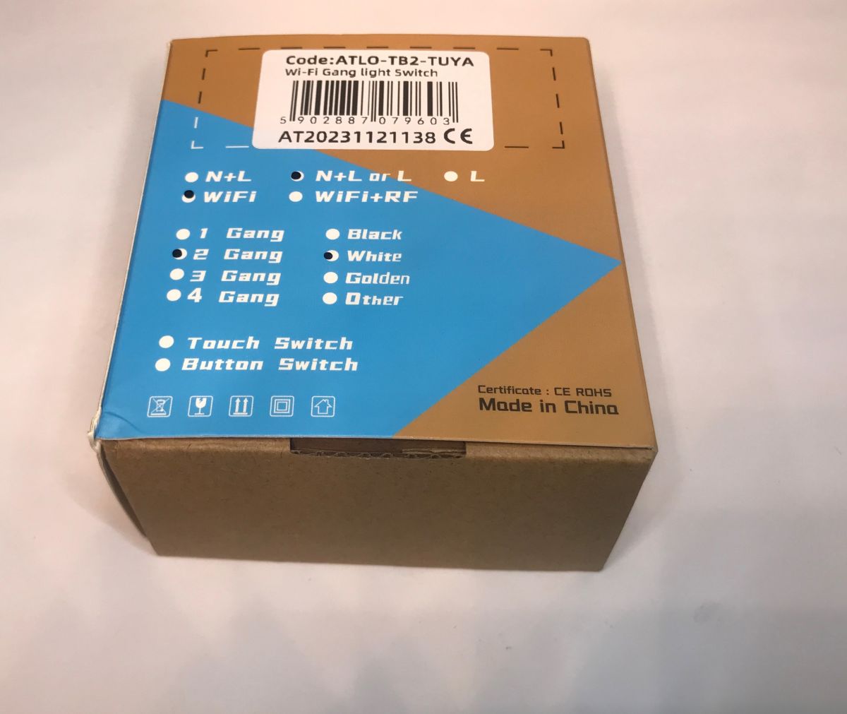

    Which silent light switch for the Home Assistant? Here is another product compatible with our Polish open source IoT software - ATLO-TB2-TUYA. This time without the relays. I will present here the double version, i.e. with two buttons, although you can get the same thing in a single or triple version. The price of the product is around PLN50 - depending on the number of buttons. You can get it cheaper by importing from China. This particular switch does not require a neutral wire to work. Let's start with the contents of the kit:
    WiFi Wall Switch product box with graphic and smartphone on the lid Box of ATLO-TB2-TUYA light switch with printed configuration options .

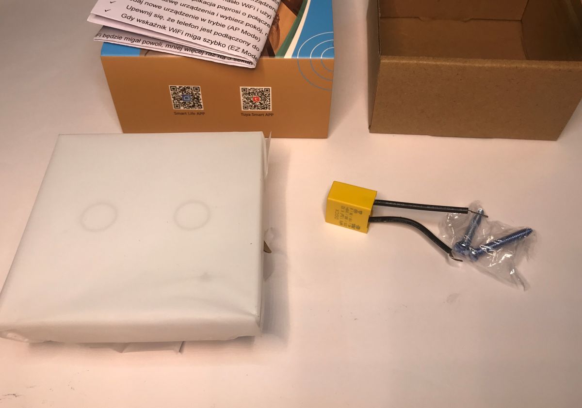

    Included is a capacitor, counteracts the glowing of the LEDs, also necessary for operation without neutral wire.

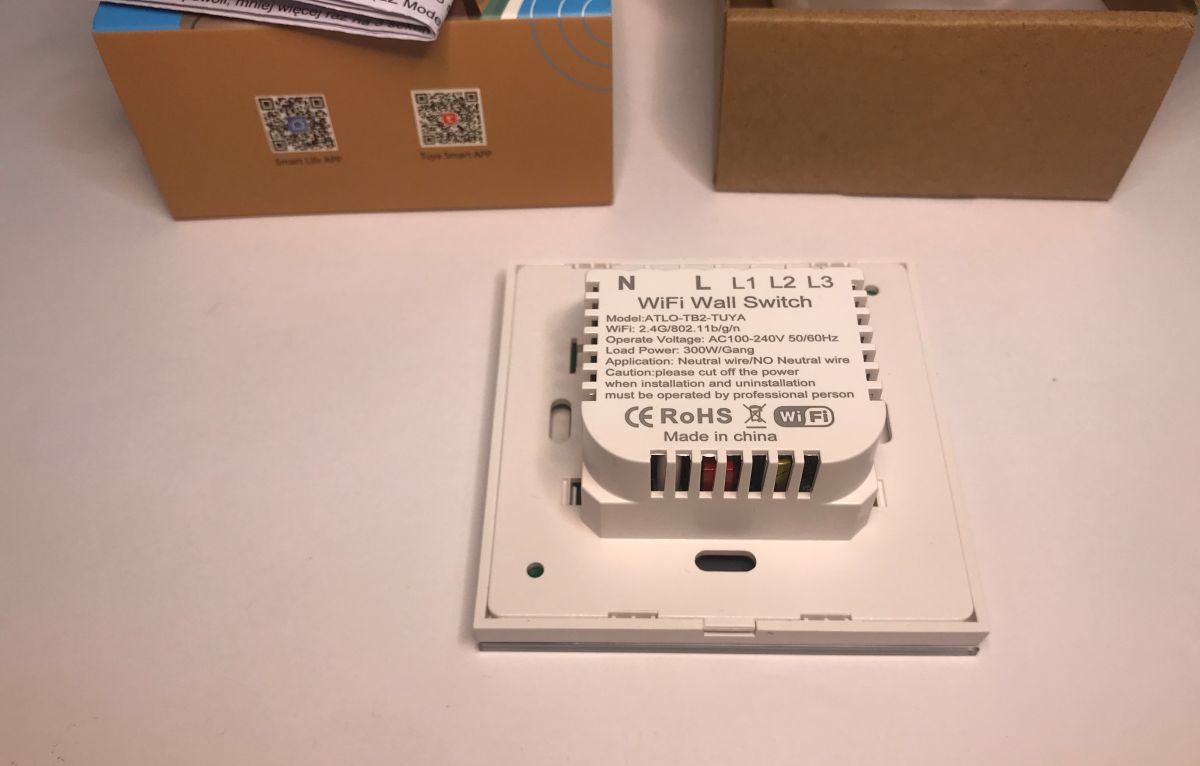

    ATLO-TB2-TUYA switch set with capacitor and mounting screws Rear view of ATLO-TB2-TUYA WiFi light switch with labeled connectors .
    We also get two screws for mounting to the box.

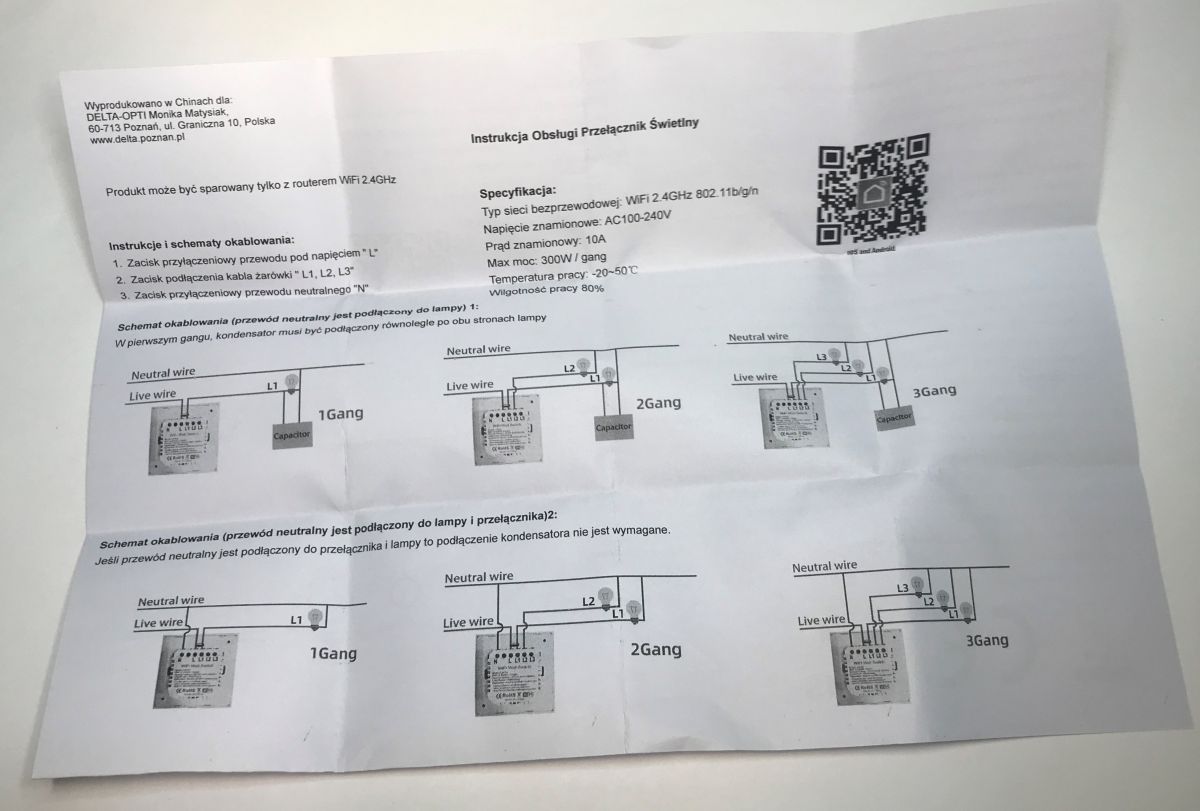

    Installation and pairing instructions from Tuya:
    Installation manual and wiring diagram for ATLO-TB2-TUYA switch Installation and pairing guide for ATLO-TB2-TUYA switch with Tuya Smart app. .

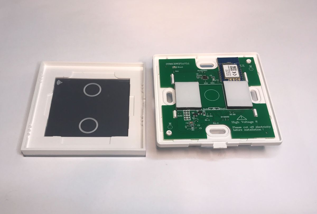

    Let's get straight to the inside of the product. The front panel is removable.
    Disassembled touch light switch with CB3S module and two-button front panel Interior of ATLO-TB2-TUYA double touch light switch with WiFi module

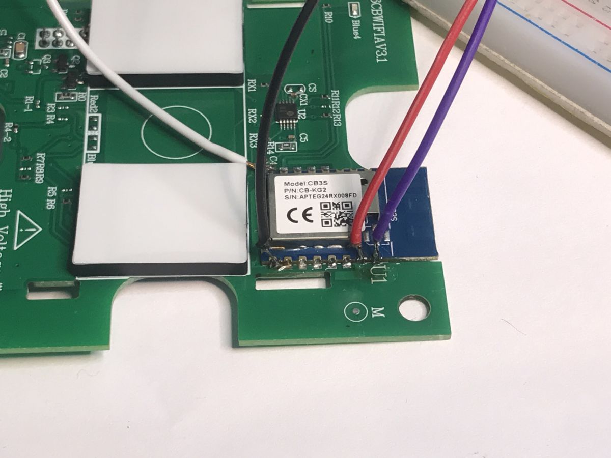

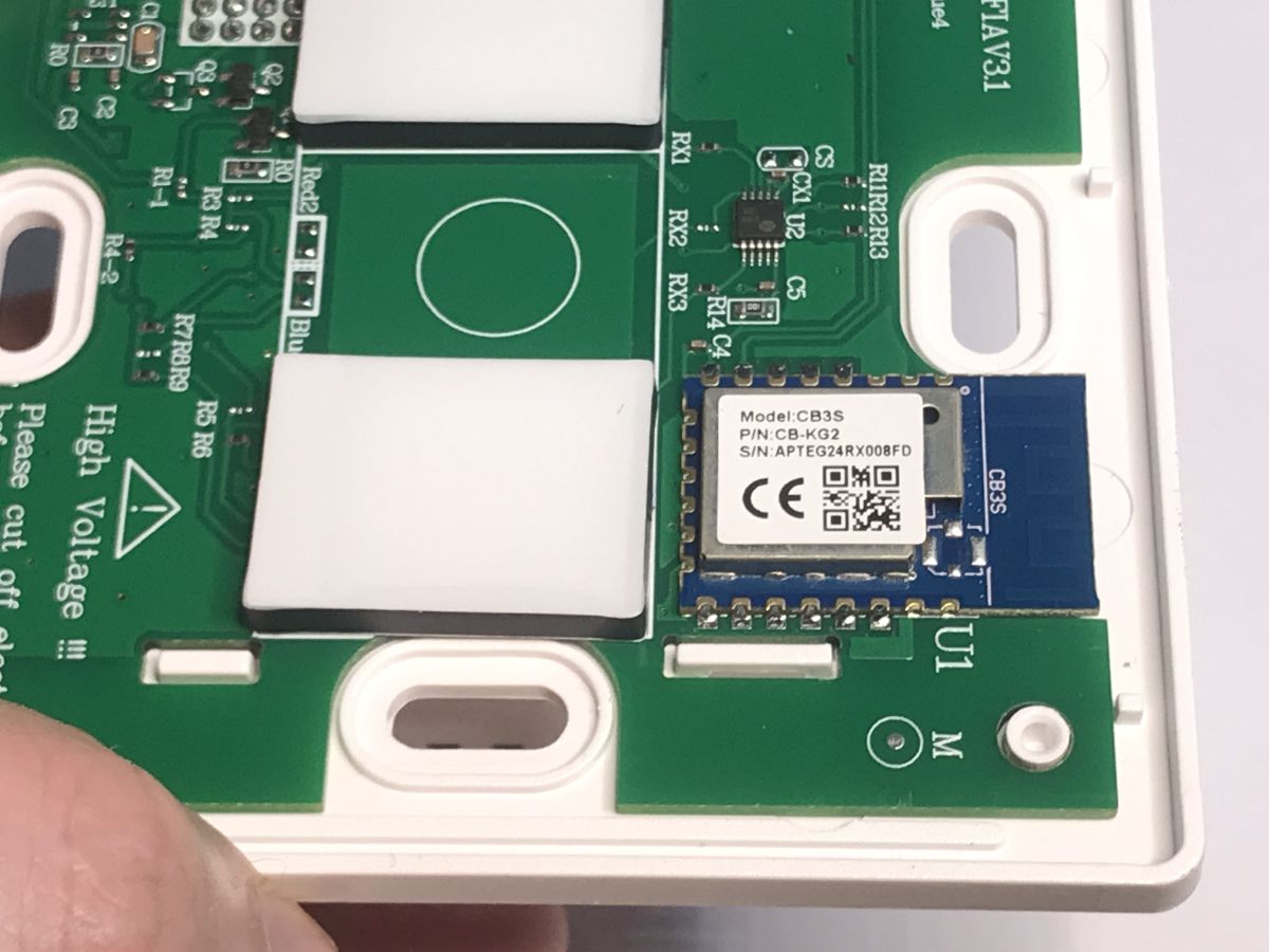

    The whole is based on the CB3S module:
    CB3S module mounted on control PCB in ATLO-TB2-TUYA wall switch .

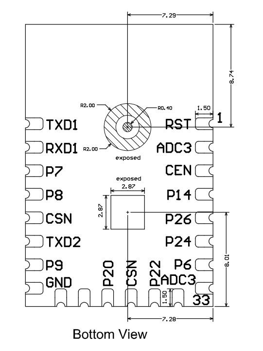

    Then we will change its software. Bottom view:
    Bottom view diagram of CB3S module with labeled pins and exact dimensions .

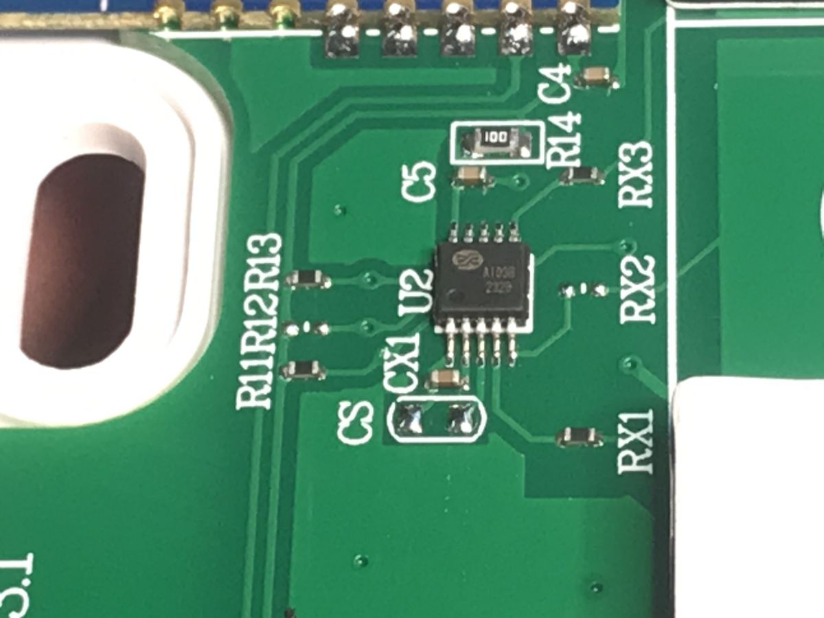

    That little chip on the board is not the TuyaMCU - it's a touch button controller.
    Close-up of A1038 chip on green PCB with RX and CS labels around it .

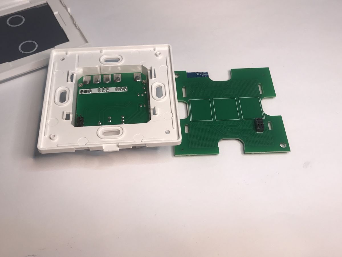

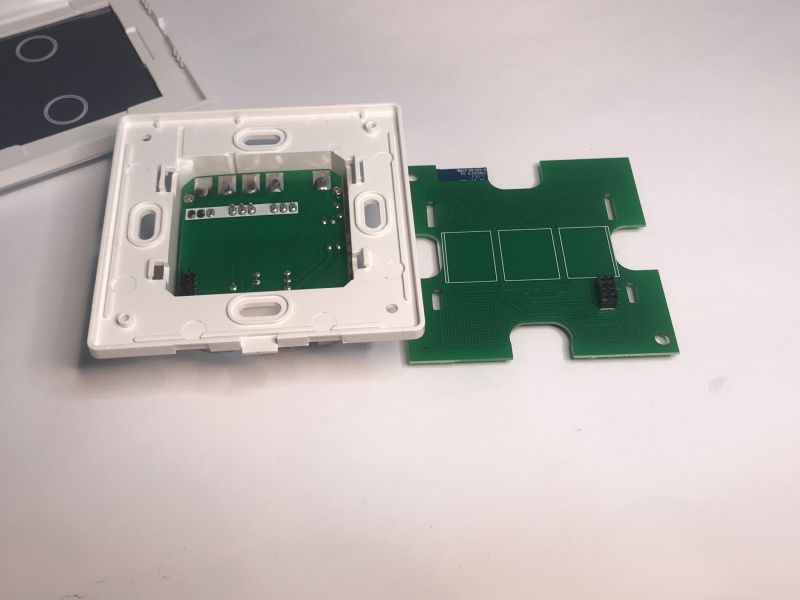

    Let's check the second board out of curiosity.
    PCBs of disassembled ATLO-TB2-TUYA touch light switch lying separately .

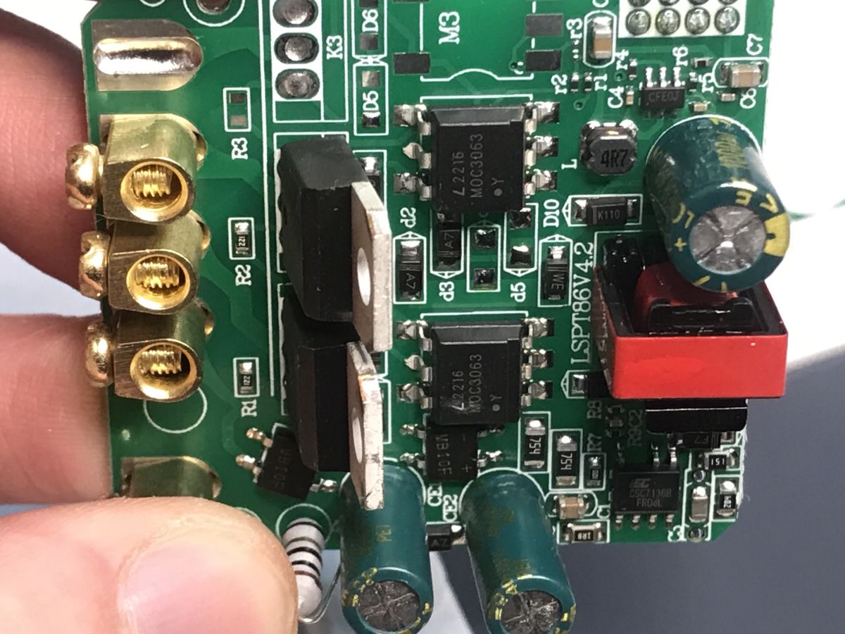

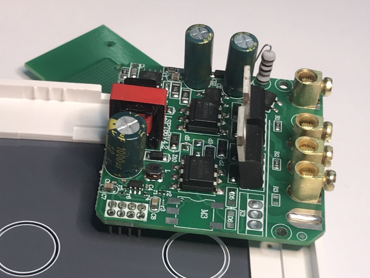

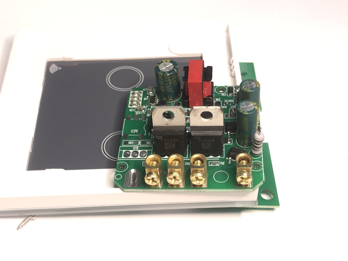

    You can immediately see that there are no relays here, so there will be no characteristic clicking.
    Interior of the ATLO-TB2-TUYA dual touch switch with visible electronics .

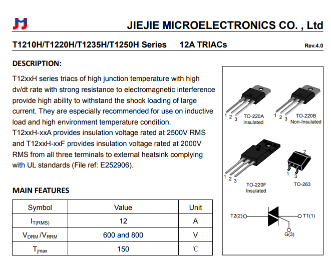

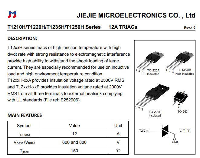

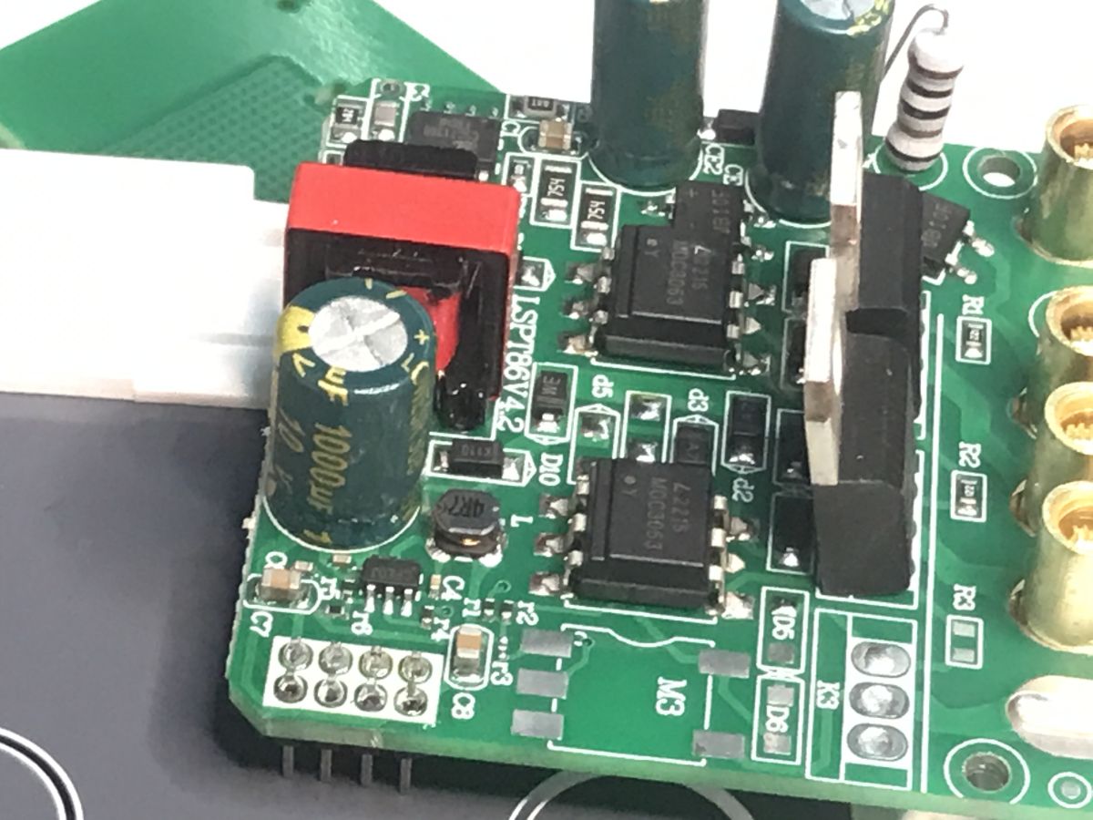

    The T1220H 800B is a triac with a current of up to 12A:
    Excerpt from JIEJIE T1220H triac datasheet with specs and package diagrams .

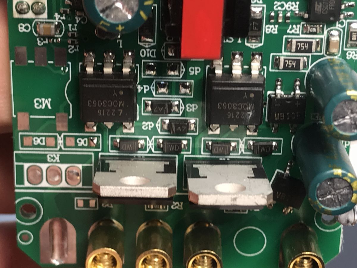

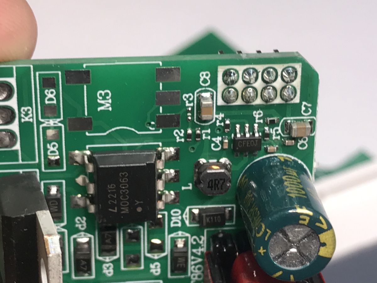

    Each of the triacs is separately controlled by a MOC3053 optotriac.
    Triac control module with capacitor and MOC3053 on ATLO-TB2-TUYA PCB .
    There is room on the board for a third pair:
    Control board of ATLO-TB2-TUYA touch switch with visible components .

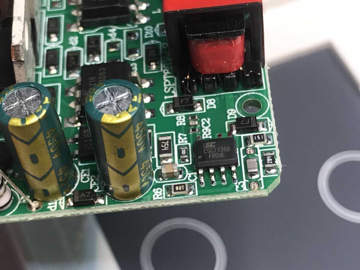

    In addition there is a CSC7136B based power supply on the board.
    Close-up of PCB with two capacitors and power IC labeled CSC7136B .
    Some additional photos:
    Close-up of ATLO-TB2-TUYA PCB with visible triacs and capacitors Close-up of PCB with capacitor, triac, and MOC3053 optotriac chip Close-up of PCB with capacitor, MOC3063 optotriac, and labeled components. Close-up of PCB with T1220H triacs and MOC3053 optotriacs .

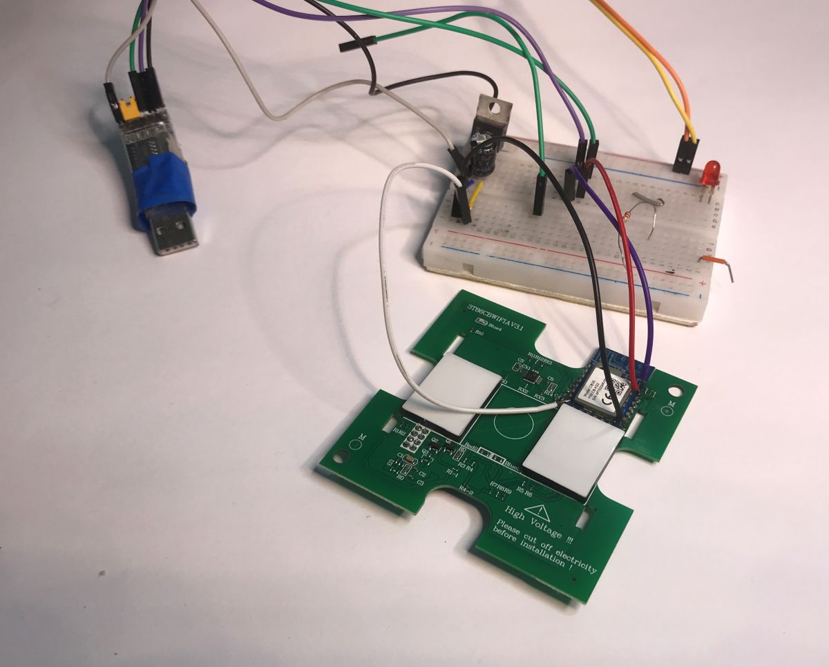

    You need four cables - ground, 3.3V and RX and TX.
    Close-up of CB3S module connected with four wires on ATLO-TB2-TUYA PCB .
    The whole circuit (USB to UART converter with an additional 3.3V LDO on the contact board):
    ATLO-TB2-TUYA switch board connected to breadboard and USB-UART adapter .

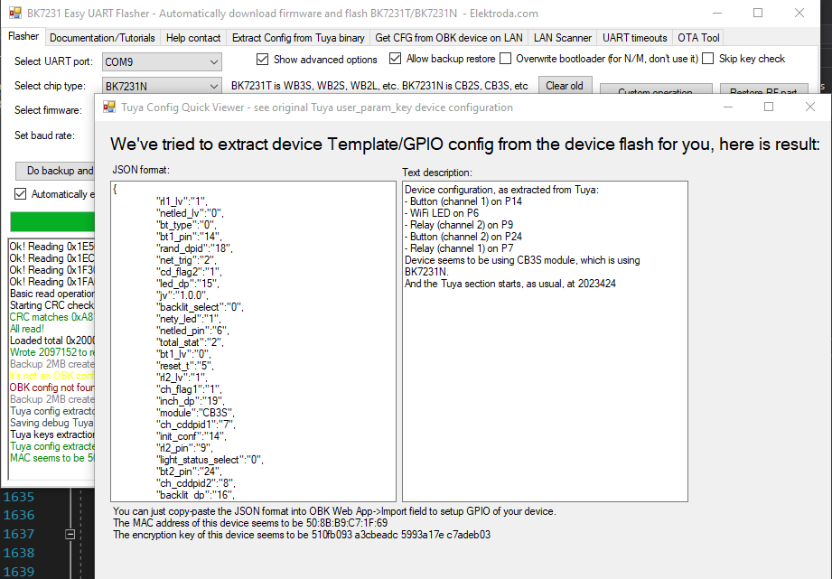

    First we read the firmware. Flasher correctly discovers the configuration:
    Screenshot of BK7231 GUI Flash Tool showing GPIO config extracted from CB3S module .
    JSON Tuya:
    Verbal description:
    Device seems to be using CB3S module, which is BK7231N chip.
    - Relay (channel 1) on P7
    - Relay (channel 2) on P9
    - WiFi LED on P6
    - Button (channel 1) on P14
    - Button (channel 2) on P24
    OBK template:
    Import template:
    Import template.
    Pairing with HA:
    Import.
