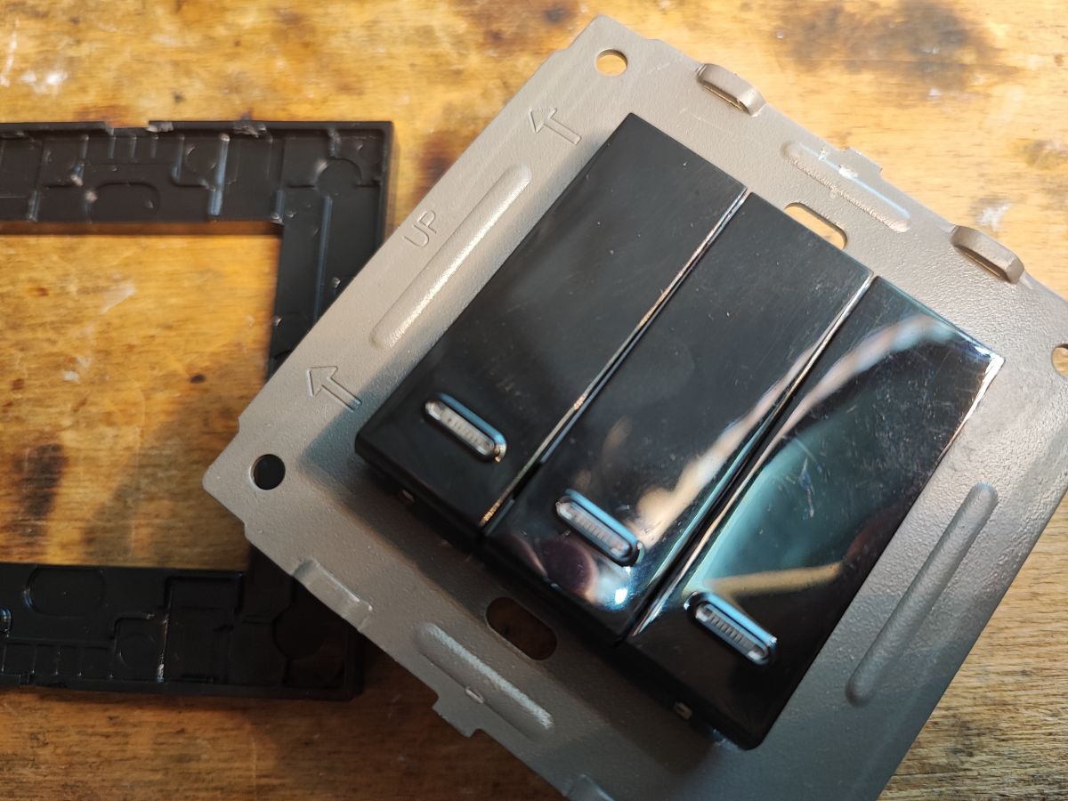

  • Black, double light switch with green LED indicators on the buttons. .
    I have been looking for something like this for a long time - here is a 'smart' light switch that is not touch-sensitive. Instead, it offers classic "clicking" buttons based on microswitches. In addition, the whole thing is based on a module from BK7231, which means you can change the software and fire this switch 100% locally, or even pair it with Home Assistant.
    The switch range shown here includes single, double and triple versions. They are available in two colours. They can be searched by model name: Milfra TB11, TB12 or TB13. If it changes, you can look visually by the pictures, because this product just stands out a bit.

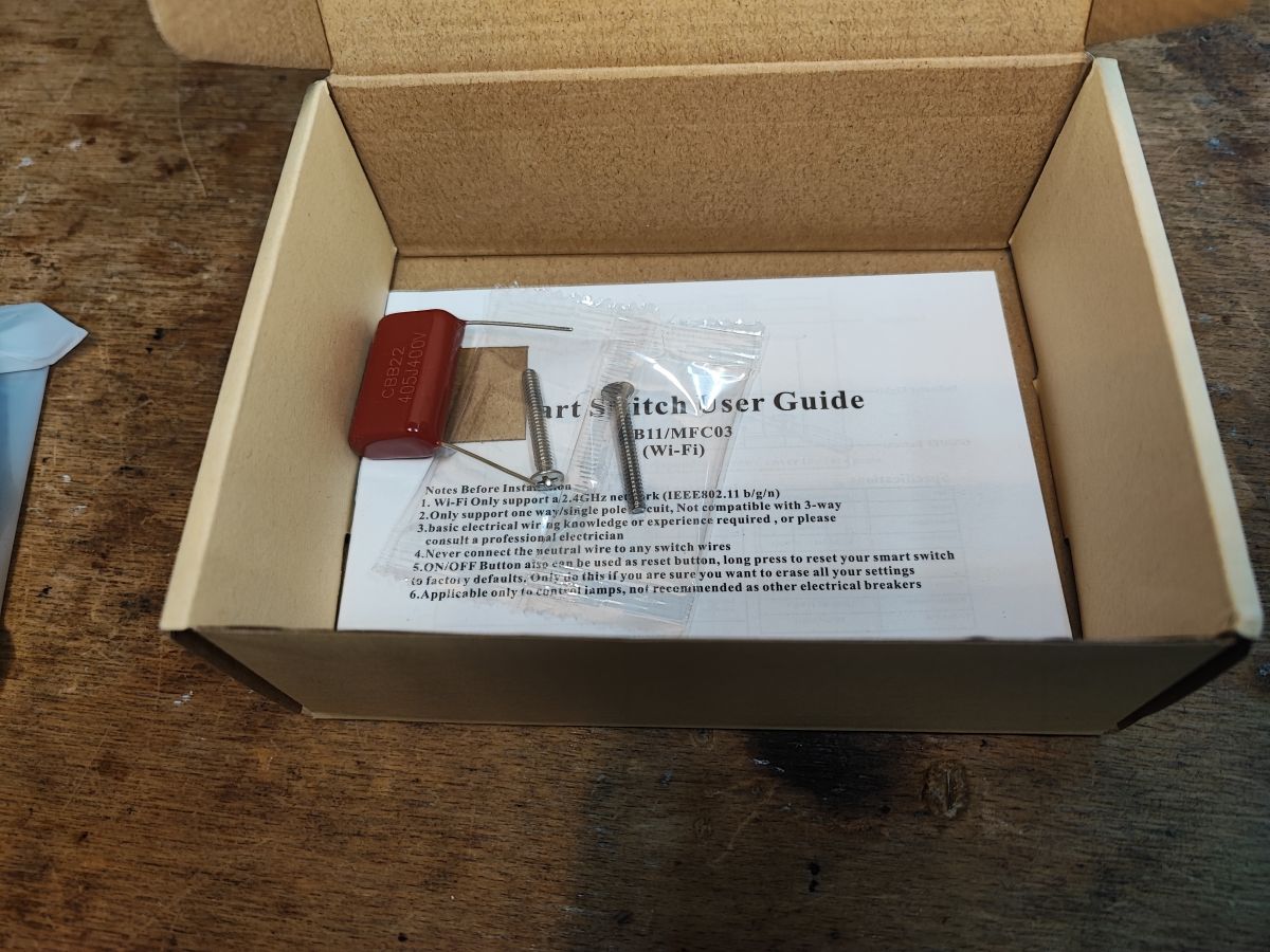

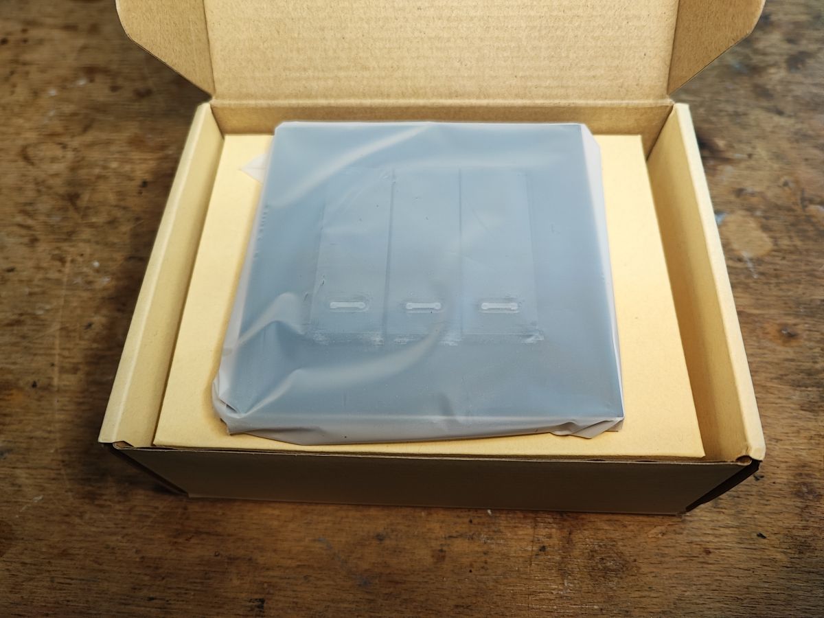

    We receive a box like this:
    Packaging of a smart light switch with classic buttons. Back of the smart wall switch box with product information. Smart light switch with buttons in a box .
    There is also a capacitor and mounting screws inside.

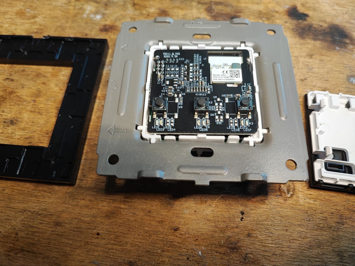

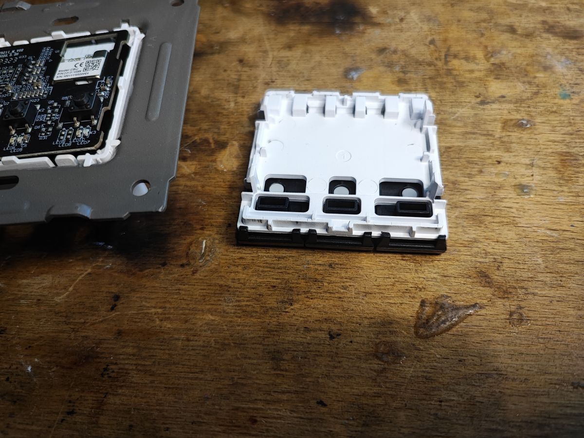

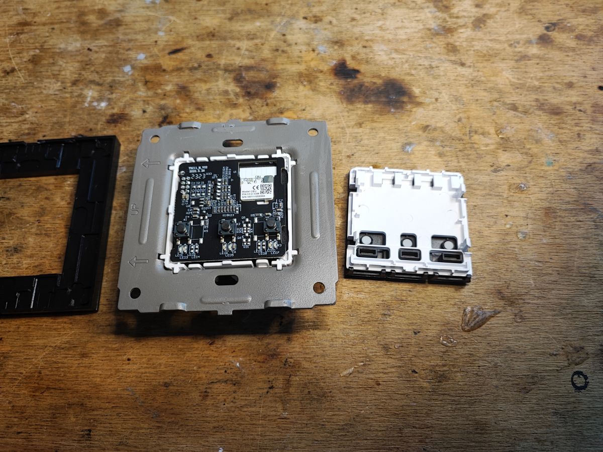

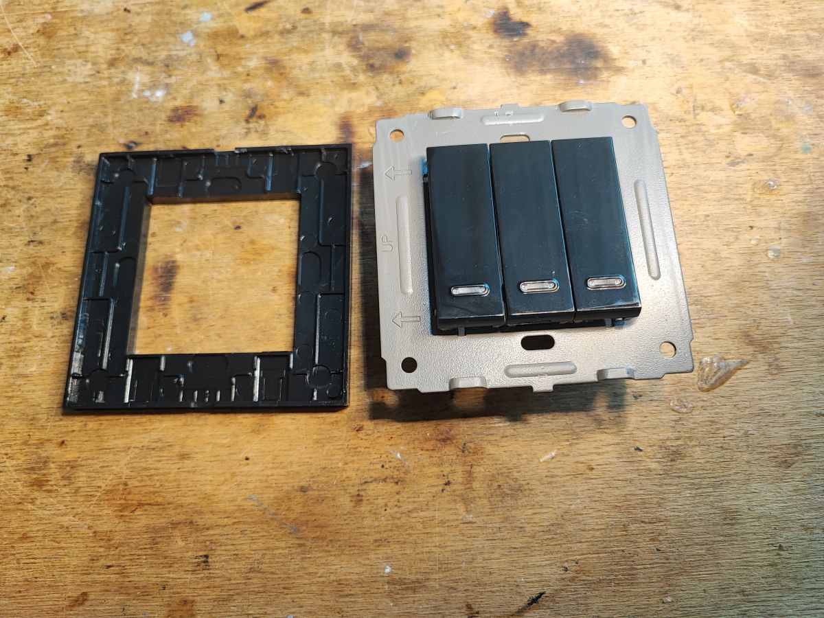

    We remove the frame and then the front:
    Double light switch and removable frame on a wooden surface. Three-segment smart light switch with classic buttons. View of the interior of a smart light switch featuring microswitches. .

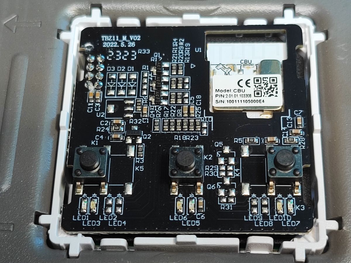

    Three beautiful microswitches, a rare sight in this type of product. I also see a Wi-Fi module...
    Disassembled light switch with visible PCB. Interior of a light switch with three microswitches on a black PCB mounted in a metal frame. Interior of Milfra TB13 smart light switch with three microswitch buttons and CBU module. .
    Interestingly, the PCB provides for two button spacings.

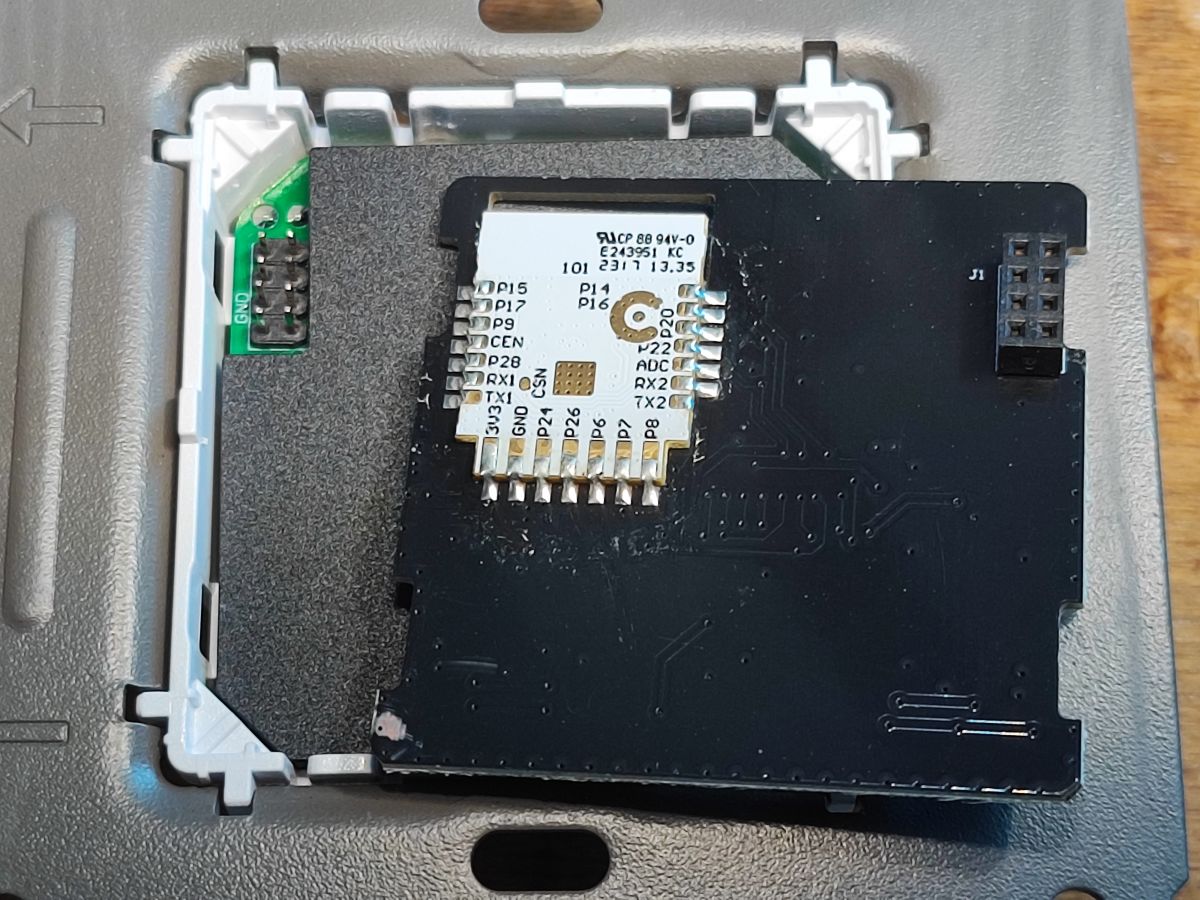

    However, let's focus on the Wi-Fi, there's a CBU inside, the BK7231N:

    Looking further afield - I can't see anything significant on the other side of the PCB:
    Electronic module in Milfra TB13 light switch .

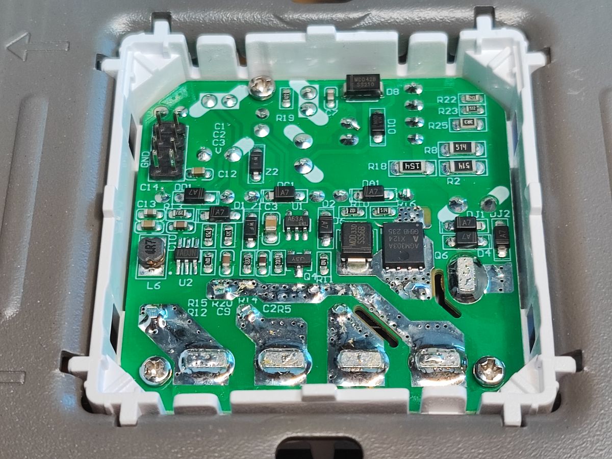

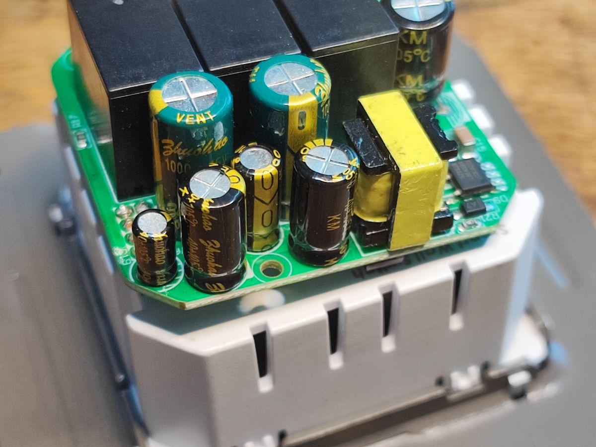

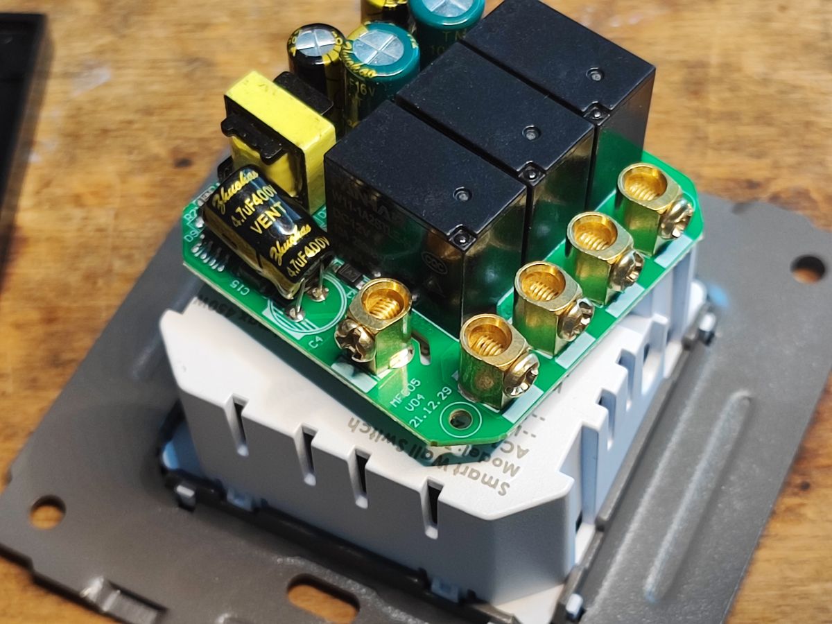

    What's left is the board with the relays and power supply:
    Interior of a light switch with an electronic PCB and components. Interior of a smart light switch with visible electronic components .

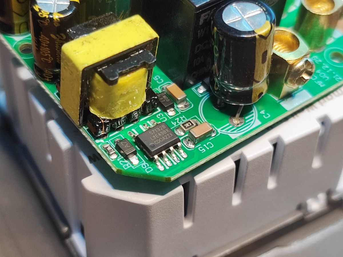

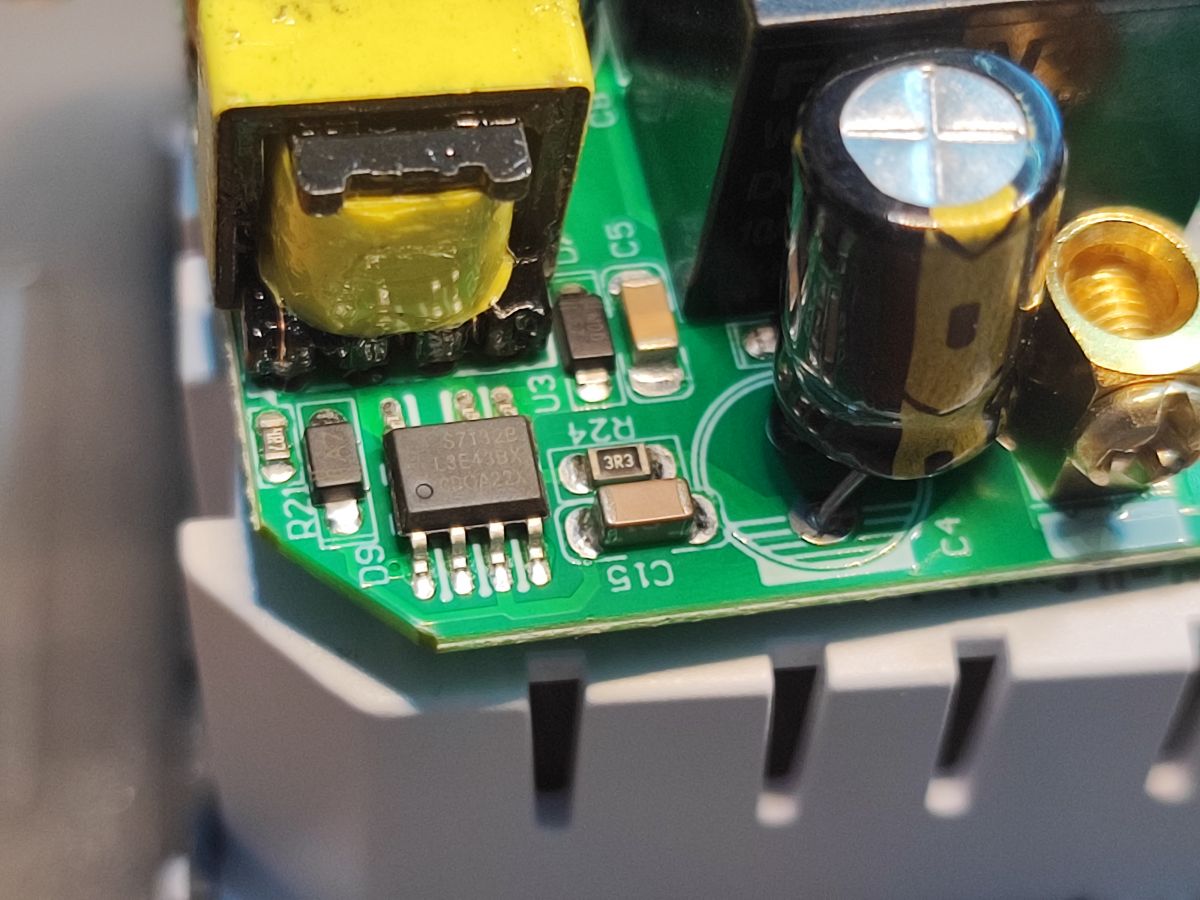

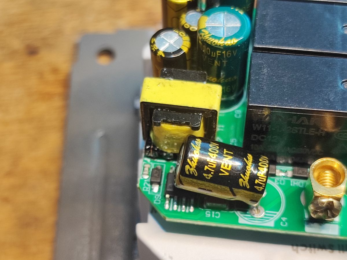

    There is no LDO AMS1117-3.3 V here. This U2 circuit next to coil L6 is probably a step down providing 3.3 V instead of an LDO. Its designation is ADJN. In addition to this, I see an interesting AGM303A, which appears to be a fairly powerful surface-mount MOSFET transistor. He is probably used for no-neutral operation.
    Close-up of a circuit board with electronic components, including capacitors and a relay. Close-up of components inside the Milfra smart wall switch. Close-up of a circuit board with electronic components of the converter module. .

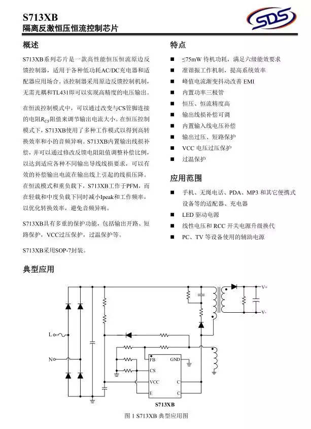

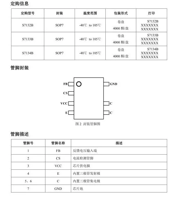

    At the top of the board you can also see the S7132B inverter controller, this time it is not an unisolated step down, but probably a flyback nonetheless:
    Technical specification of S7132B chip in tabular format .
    Technical documentation of the S713XB chip. .
    I also noticed the rather large capacitance of the electrolytic capacitors on board. This is probably because this device can operate in no-neutral mode:
    Close-up of a circuit board with electronic components.

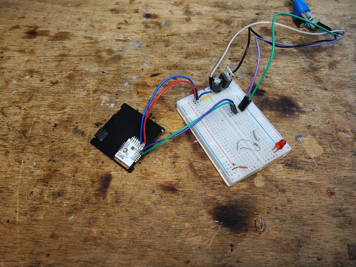

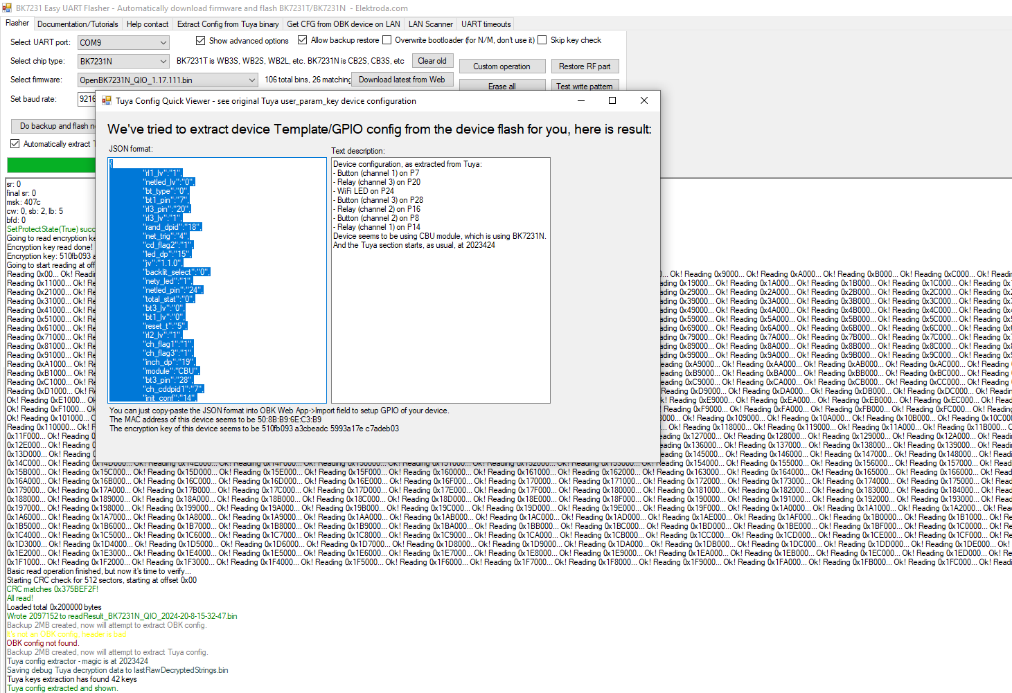

    Programming .
    You need to solder the four wires to the CBU pins, according to the flasher's instructions:
    You can also follow our video:
    In my case it worked out like this:
    Electronic module on a breadboard with wires on a wooden background.
    Flasher correctly recognises the configurations:
    Application window showing GPIO configuration of a device based on Tuya software, with a list of pins and functions. .
    Batch copy:
    https://github.com/openshwprojects/FlashDumps/commit/1ec19ea303fd436fc4dd2e0bbe9764e3b3054fab
    JSON Tuya:
    Verbal description:
    - Button (channel 1) on P7
    - Relay (channel 3) on P20
    - WiFi LED on P24
    - Button (channel 3) on P28
    - Relay (channel 2) on P16
    - Button (channel 2) on P8
    - Relay (channel 1) on P14
    Device seems to be using CBU module, which is using BK7231N.

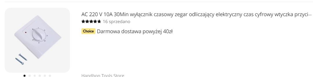

    I also prefer mechanical solutions. I have a mechanical timer connected to a ladder radiator. Very hard to buy, only from Aliexpres and with a Chinese tip. Unfortunately I can't find it any more. It is very easy to set and you don't even have to look at it.
    Electronic timer switch with hourly setting. .
    Mechanical timer switch with a dial and mounting screws. .
  • #3 21388611
    Posts: 14760
    Rate: 12887
  • #4 21388632
    kloszi
    Level 21  
    Posts: 547
    Help: 34
    Rate: 89
    It's not a matter of setting a fixed time, just turning on the heater when I have wet towels for about 30 minutes.

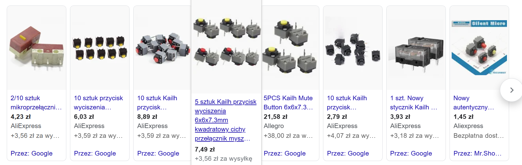

    I have radio switches at home bought on Ali that have a similar design in terms of switching to this one. Unfortunately these microswitches are not very durable. After a while the switch doesn't always 'catch' that a key has been pressed. This is quite annoying. This is one issue. The other is the issue of its 'hardness' when pressed. Some other switches would be better so that, firstly, the switch is quieter and, secondly, its travel when pressed is as if "cushioned". I don't know how to explain it better ;) .
  • Silent microswitch replacement suggested for quieter button clicks
    #6 21391972
    Posts: 14760
    Rate: 12887
    @kloszi maybe in that case you need to search under the keyword mechanical timer.... I'll check later and if I find something interesting I'll order it for testing.
    @speedy9 For me the audible response that you managed to press is a plus, worse if it seriously doesn't catch. On the other hand, I know about the problem of too loud buttons, because I repaired a mouse and gave there a regular microswitch once.... AND you can also buy a "quiet"/"silent" version:
    Screenshot showing various micro switches and buttons available on shopping platforms. .
    You might want to consider ordering those and doing a replacement.

    @p.kaczmarek2 I found this: https://www.aliexpress.com/item/1005005531678111.html With silicone. An interesting thing. I'll have to test it out.
    For me, the audible response that it has been successfully pressed is a plus
    For me, a response in the form of "the light is on/off" ;) is enough.
