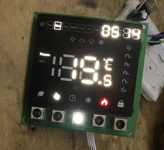

Thermostat with LED panel showing temperature, weekday icons, and control status .
I will present here a surface-mounted thermostat with LCD, external sensor and WiFi-based wireless control. The product shown here is compatible with the Tuya app and has a 5+2/6+1 programming function that allows you to set up to 6 different temperature settings for each day of the week and an additional setting for the weekend.
I will also include its communication analysis in the theme, which will allow me to change its firmware and upload OpenBeken so that it can be cloud free and connected to Home Assistant.
We bought the thermostat for PLN140. Let's start with the contents of the kit.

Interior of the device .
The device is built like a typical WiFi controlled light switch. We remove the front panel.
Disassembled WiFi thermostat with visible electronics and temperature probe. Close-up of thermostat PCB showing SC92F8547P and DS1302Z integrated circuits .
You can already see some of the electronics, but here, however, there is an additional plastic component inside. More needs to be removed.
Close-up side view of disassembled thermostat with visible casing layers Opened wall thermostat with visible LED panel and screw connectors .
It appears that there is no LCD here after all. The screen is based on LEDs. The seller has provided information that is not true.
Thermostat PCB ME82H-WIFIMBLED-V1.3 with WiFi module and backup battery .
The main PCB is marked ME82H-WIFIMBLED-V1.3 The device is based on the WiFi WBR3 module , a chip from Realtek. In addition to the WiFi module, we also have an additional microcontroller which takes care of all the logic of the device, and a timer chip real DS1302Z with a quartz clock resonator and power supply backup for times of power loss. This allows the device to resume programming even if it loses power completely and WiFi is not available to retrieve time from the Internet with the NTP service.
WBR3 WiFi module mounted on green PCB with circuit traces and electronic components Close-up of PCB showing SC92F8547P and DS1302Z chips with connector Close-up of a PCB with SC92F8547P and AMS1117 components Close-up of a PCB with WBR3 WiFi module and SOC SC92F8547P microcontroller .
The main MCU is the SOC SC92F8547P. It communicates with the WiFi module via the TuyaMCU protocol:
TuyaMCU protocol - communication between microcontroller and WiFi module .
This means that it will be useful to capture packets on the UART line right away. This will allow us to determine the dpIDs (identifiers) of the variables that determine the operation of the thermostat.
