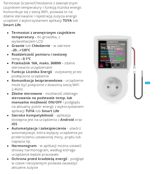

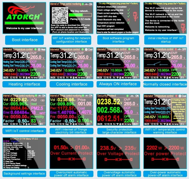

    I waited a long time for delivery, but it was worth it. Let's quote its functionality and specifications from one of the Polish sellers:

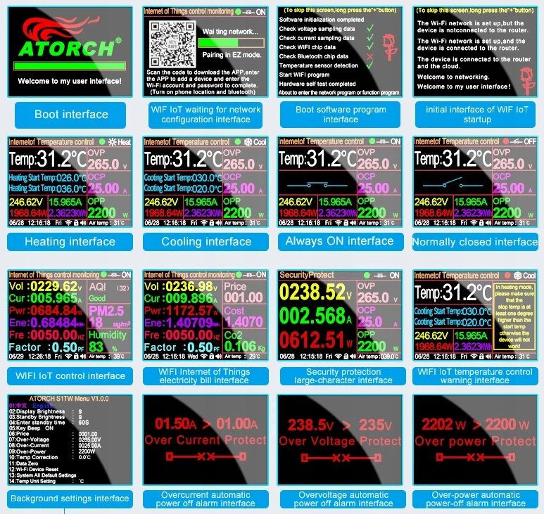

    Thermostat with temperature sensor and energy meter function on a specification background. .
    Plug-in energy meter with an LCD display, controlled via a mobile app. .
    S1TW-FR device with a large LCD screen and a smartphone app. .
    S1TW-FR energy meter LCD screen with various interfaces and configuration options. .

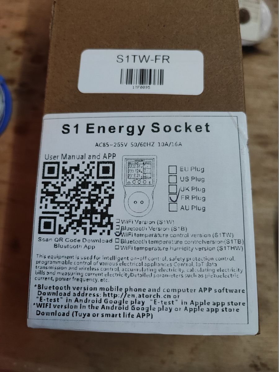

    Packaging and signage, including QR code for application:
    S1TW-FR device packaging with visible QR code for the app. .

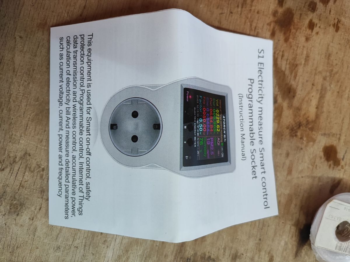

    Included is a manual, which will undoubtedly come in handy here:
    Instruction manual for the S1 plug-in energy meter with socket and LCD screen. .
    However, I will not transcribe it here, the pictures should suffice:
    Instruction manual for S1 plug-in energy meter with LCD screen. .

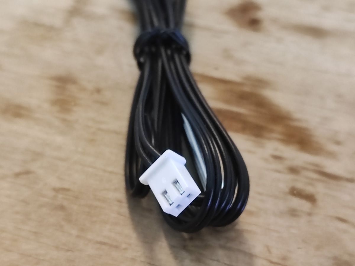

    There is also a temperature sensor:
    Black cable with a white connector, lying on a wooden surface. .

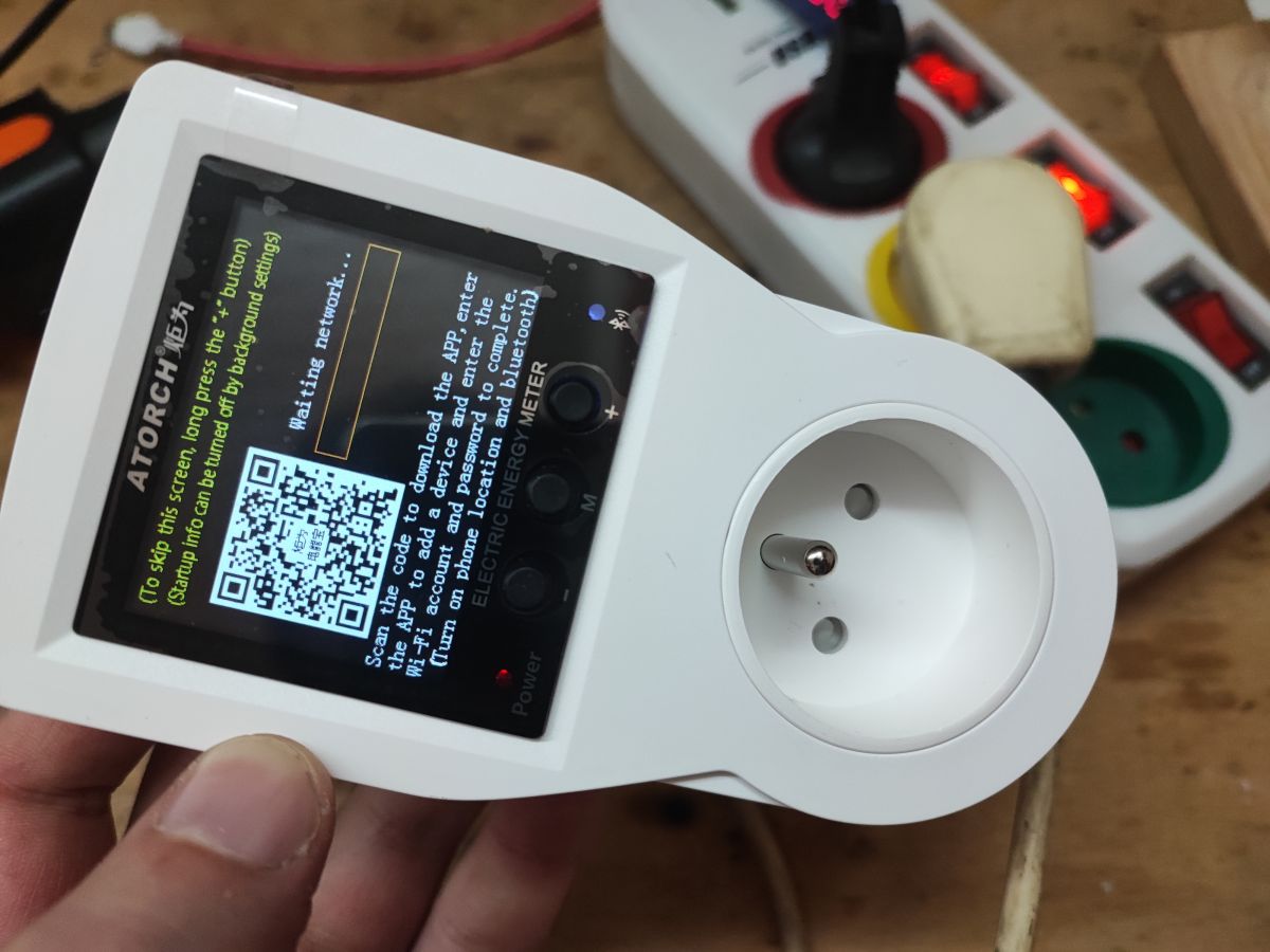

    And then there's the socket itself, with a large and easy-to-read LCD:
    Plug-in energy meter S1TW-FR with a clear LCD screen. .

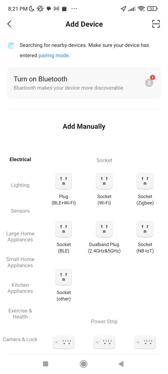

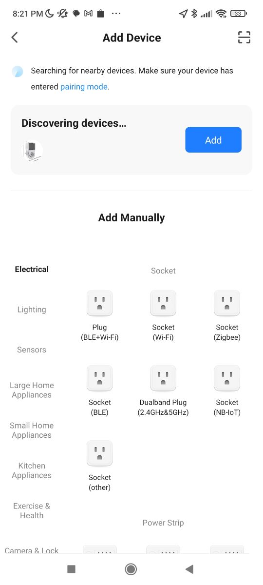

    Pairing with Tuya is very simple, but Bluetooth must be enabled first:
    Device addition screen with various socket options available. .

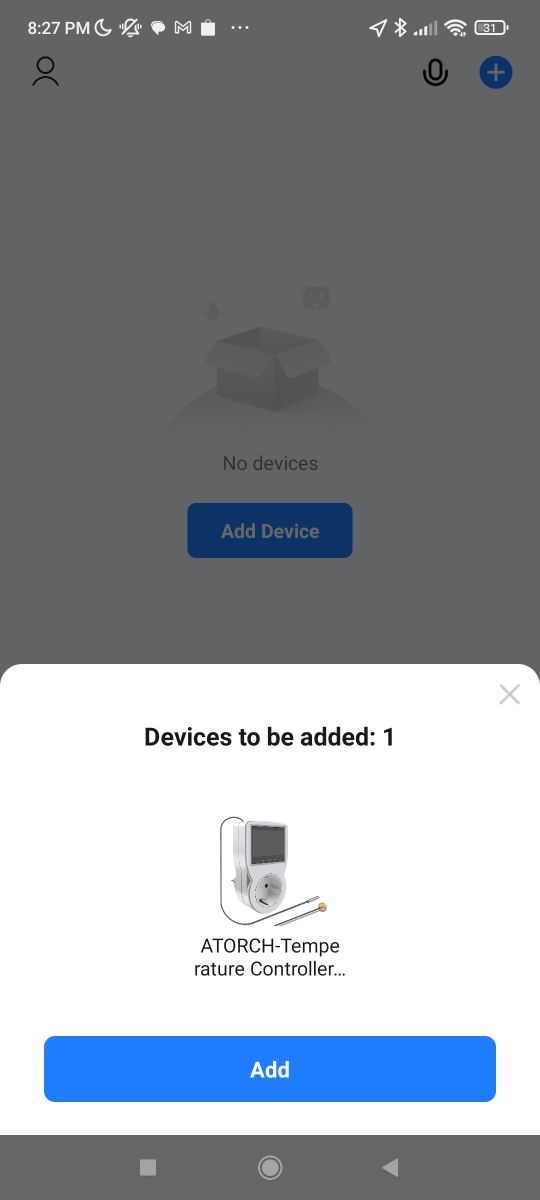

    After this, the phone will detect the new device itself:
    App screen for adding a new device with various socket and sensor options. .
    App screen with ATORCH Temperature Controller being added. .

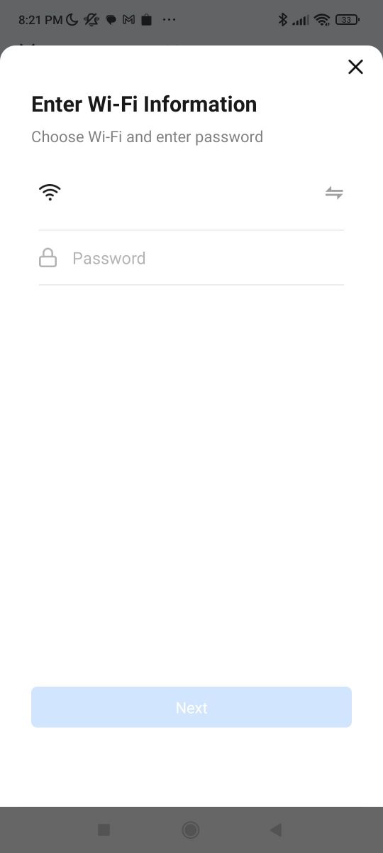

    We provide the details of our WiFi, necessarily 2.4GHz:
    Mobile app screen displaying Wi-Fi login panel. .

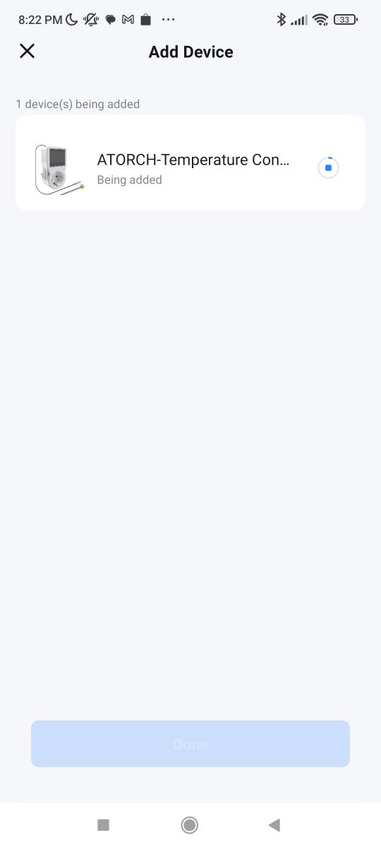

    Once confirmed, pairing will begin:
    Pairing screen with S1TW-FR ATORCH device and temperature probe. .

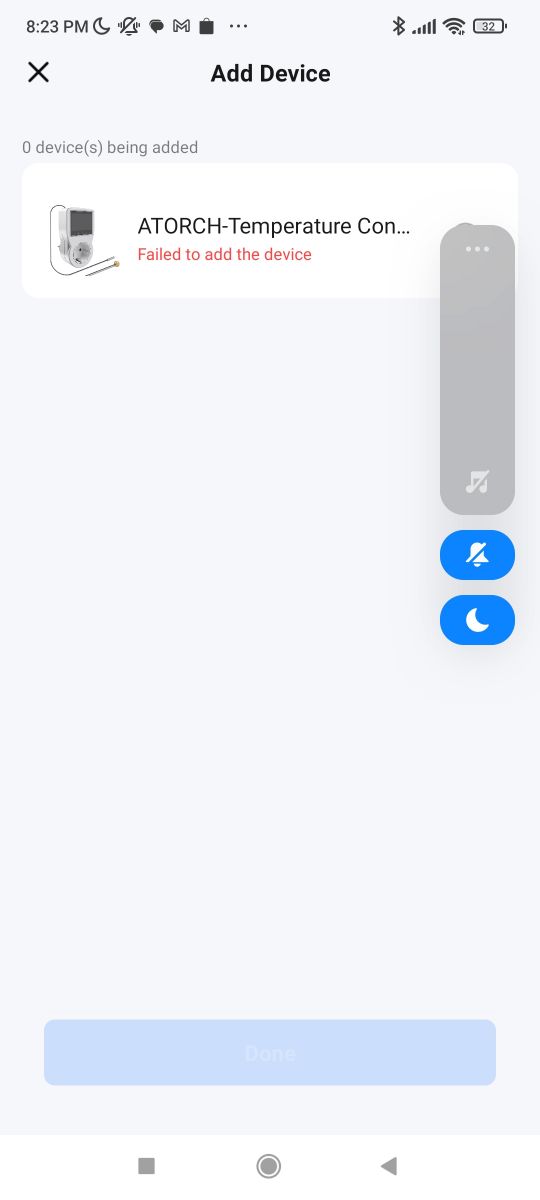

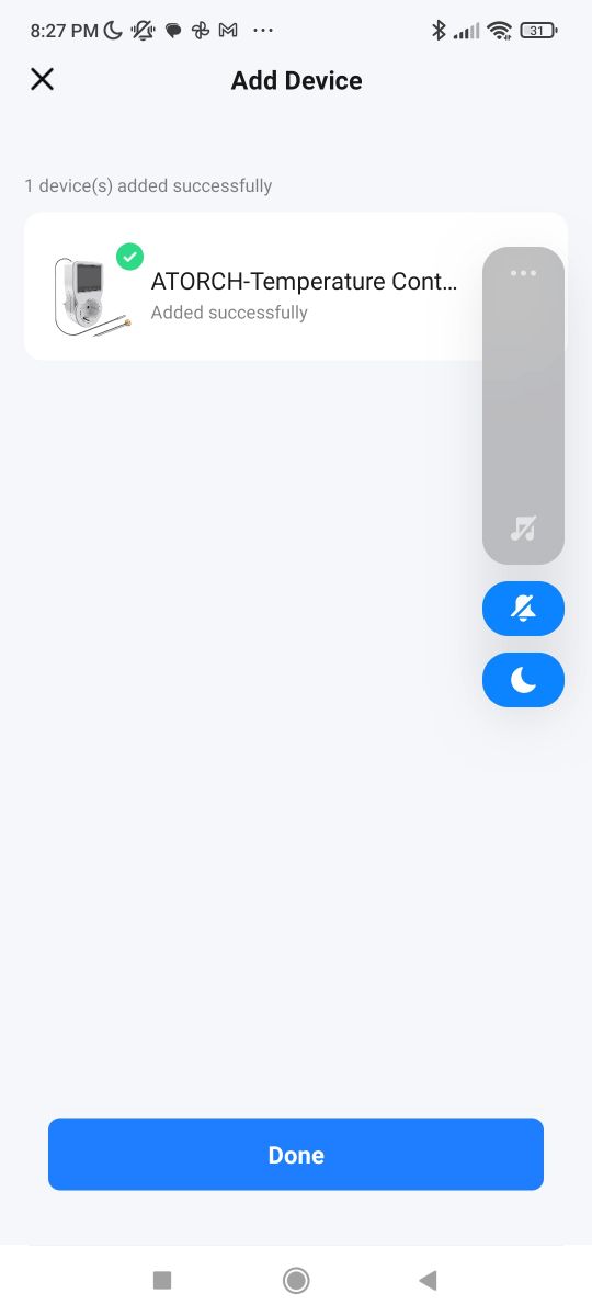

    In my case, however, two attempts were required:
    App screen showing error in adding ATORCH-Temperature Controller device. .
    Add device screen with successfully added ATORCH-Temperature Control. .

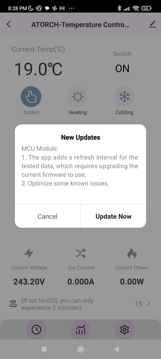

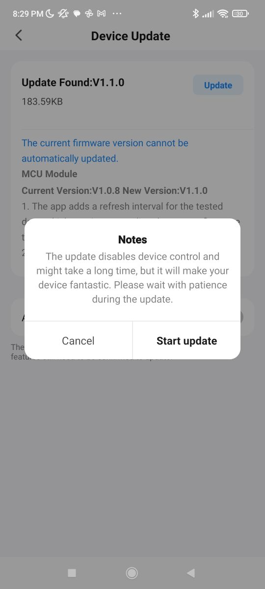

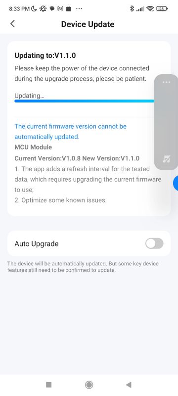

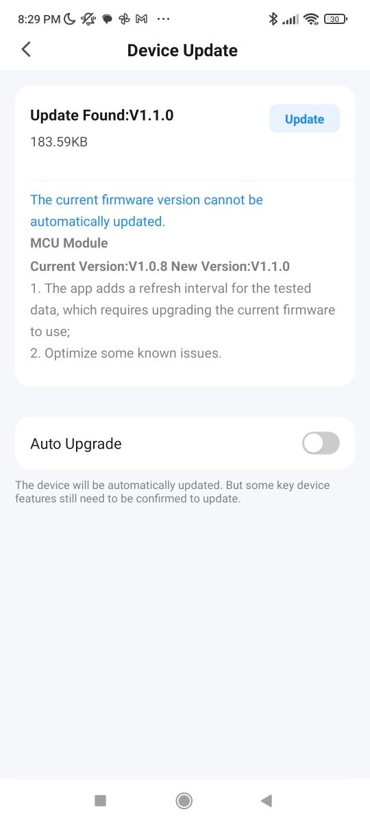

    The application also prompts us for an update, which I have allowed:
    Device firmware update screen on a smartphone. Device update screen with warning message.

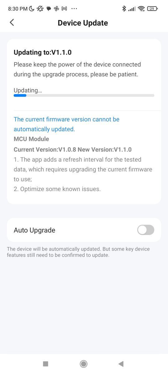

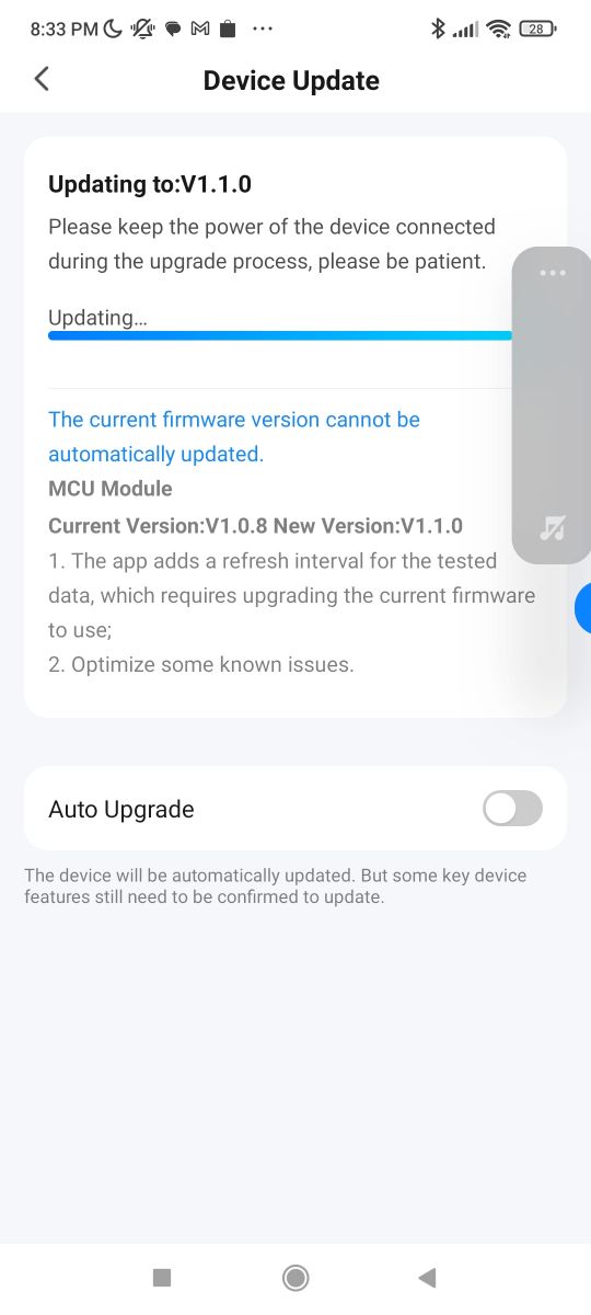

    By the way, the lack of update enabled by default is a plus here in my opinion. Who would want a socket to become unresponsive when least expected?
    Device firmware update screen with auto-update toggle. Device update for S1TW-FR to version V1.1.0

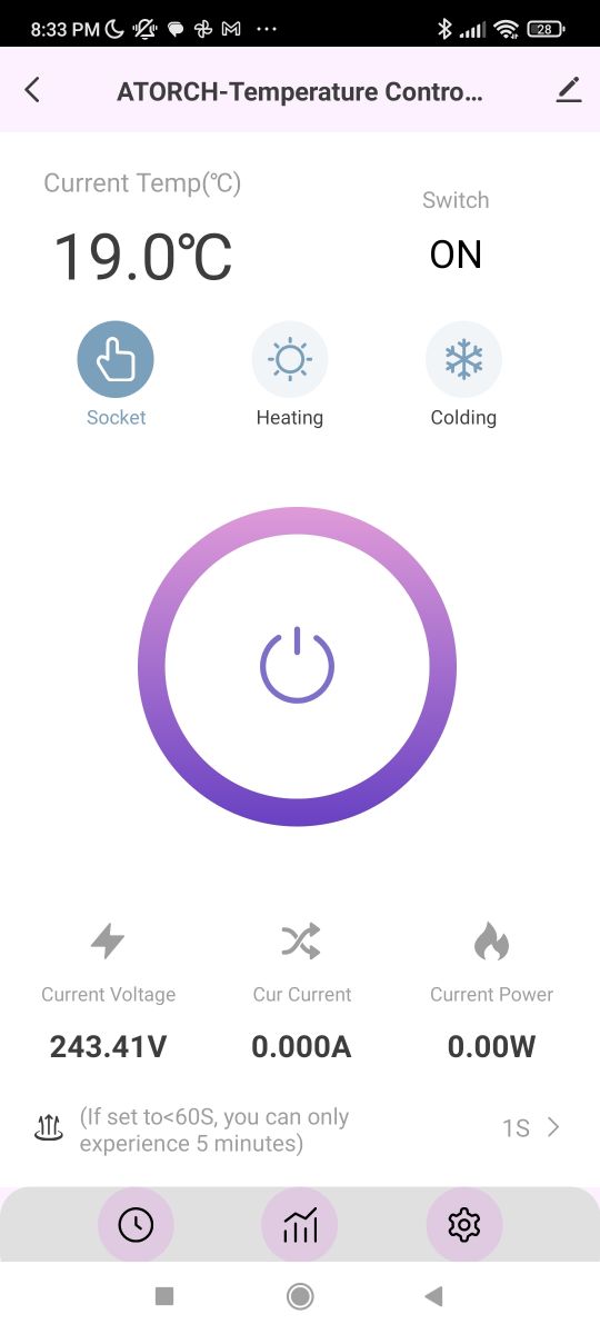

    The update was successful, here is the expected panel:

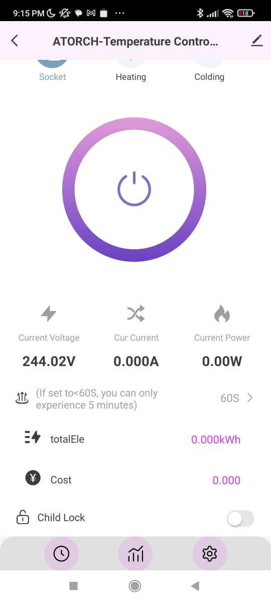

    Application interface for controlling the S1TW-FR plug-in energy meter with an LCD display. .

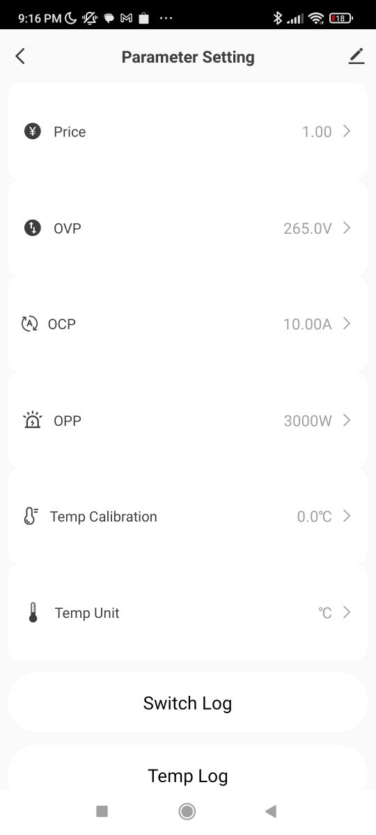

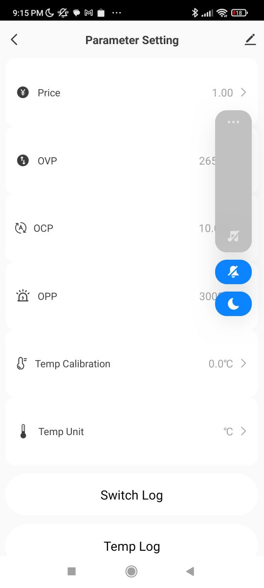

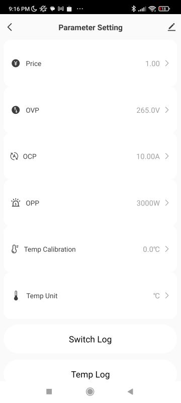

    The panel displays electricity and temperature information, as well as the operating mode. In the settings, the OPP (power limit), OVP (voltage limit), OCP (current limit) instructions mentioned can be configured:
    Parameter settings interface in the plug-in energy meter app. .

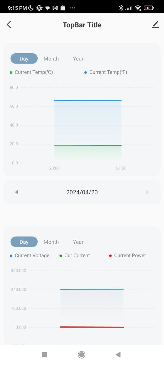

    Graphs are available for the collected data, together with a breakdown by day, month and year:
    Mobile application screen for the S1TW-FR energy meter with parameter charts. .
    After scrolling down, we have further options such as counting the cost of energy used (the price per kWh can also be set) and child lock (disables the device's physical panel):
    Tuya app screen for energy meter with control functions. .

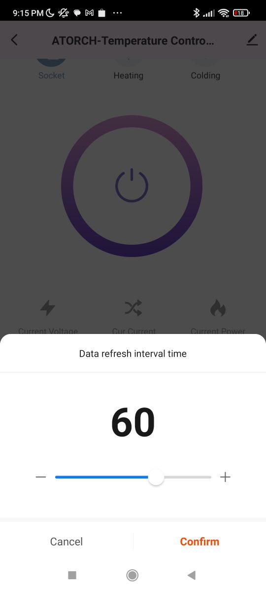

    We can also change the refresh rate of the application data - up to 1 second:
    Screenshot of the ATORCH app with a slider set to adjust the data refresh interval to 60 seconds. .

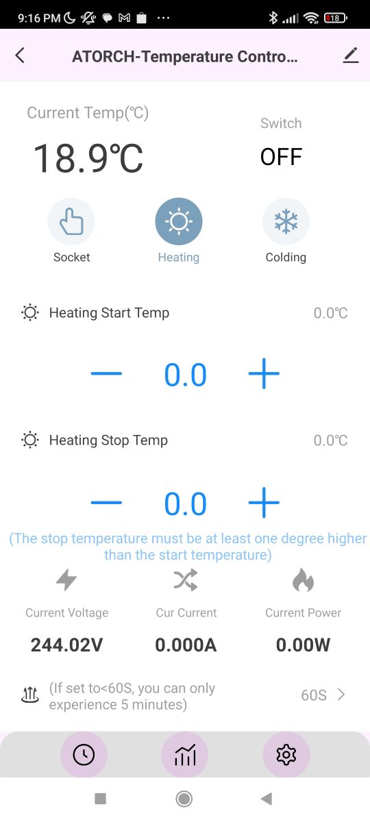

    In the settings we can also configure the temperatures, separate for heating and cooling mode (although the relay is one...):
    ATORCH app screen displaying temperature measurements and device controls. .
    The temperature unit can be changed, calibration is also available:
    Screenshot of parameter settings in the app for managing a smart plug. .

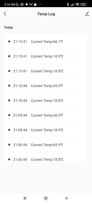

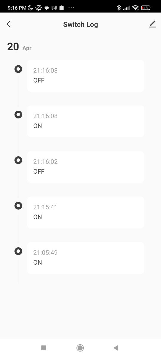

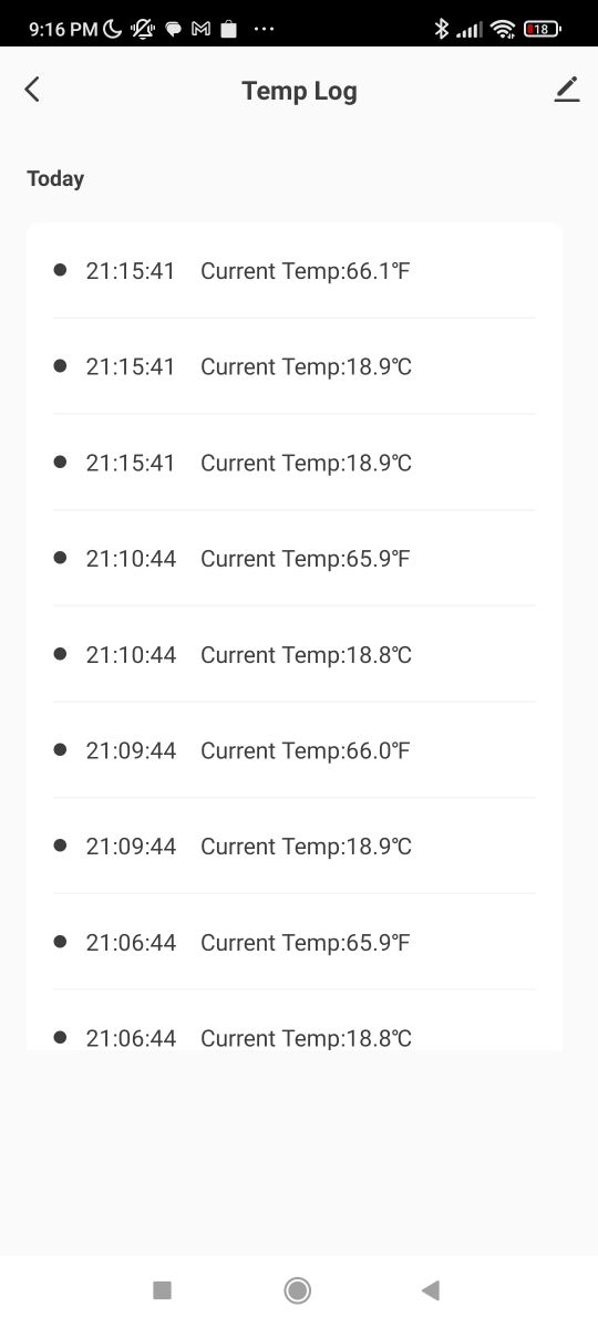

    We also have event histories:
    App screen showing the switch log. Daily temperature logs from a mobile app.

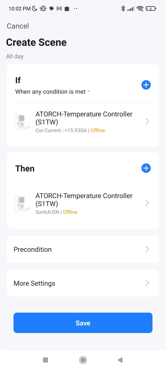

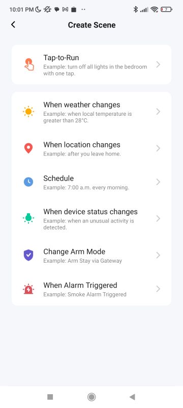

    Scenes, event triggering and external control .

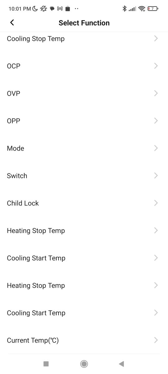

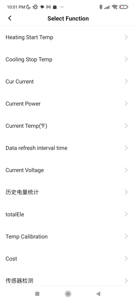

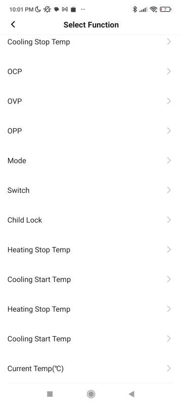

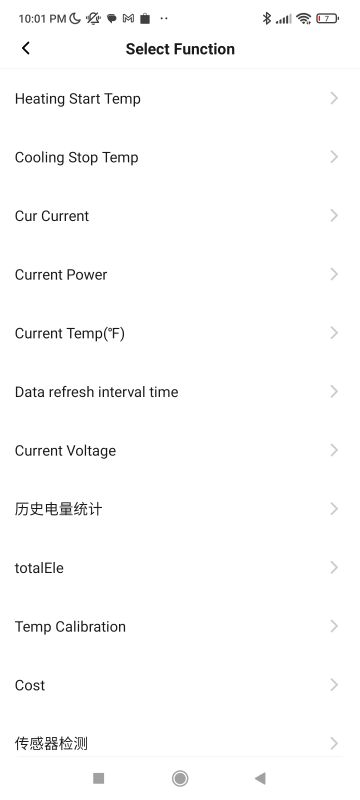

    Here I have no complaints either. Virtually everything that makes sense (and even the less sensible variables) can trigger events/scenarios here, as well as be controlled by scenarios. The only shortcoming is one Chinese parameter name that I did not ultimately decipher:
    Function selection menu in the Tuya app on a smartphone. Screenshot showing a list of functions in a mobile app. App screen for creating scenes for a smart socket. .

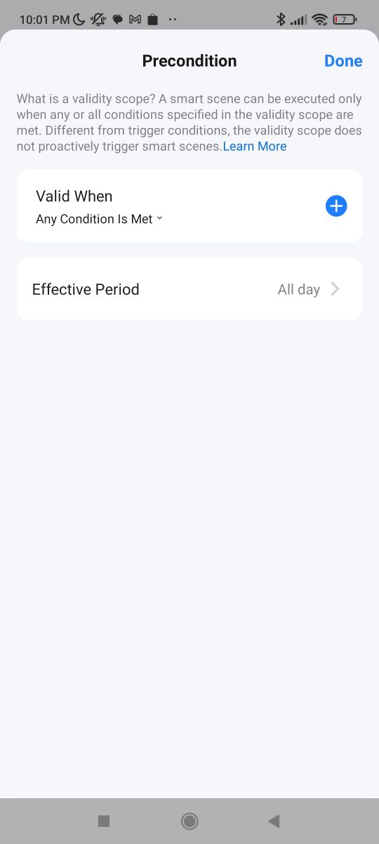

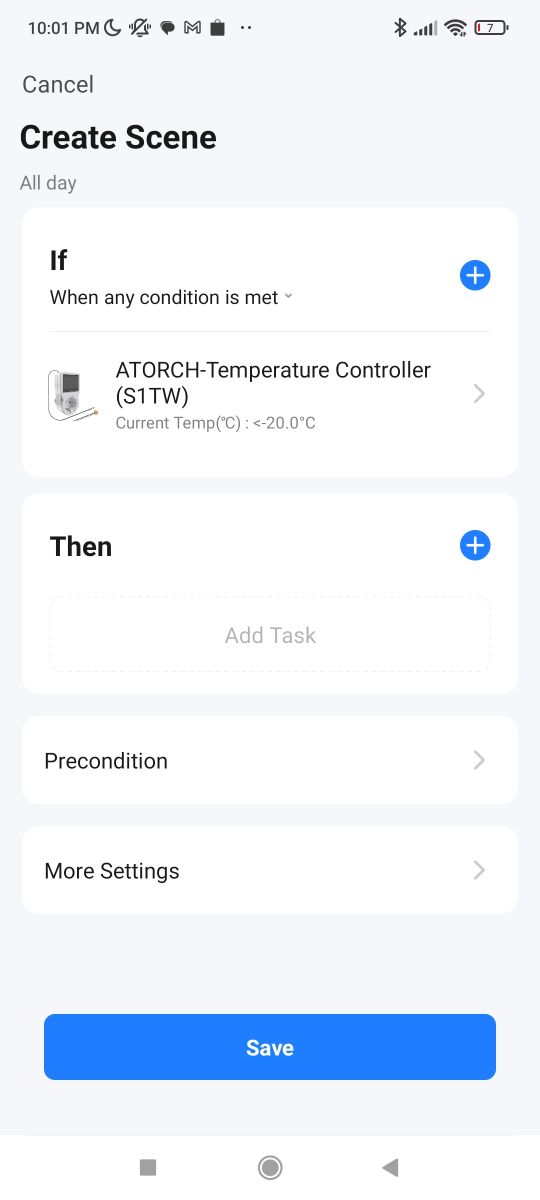

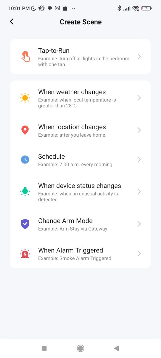

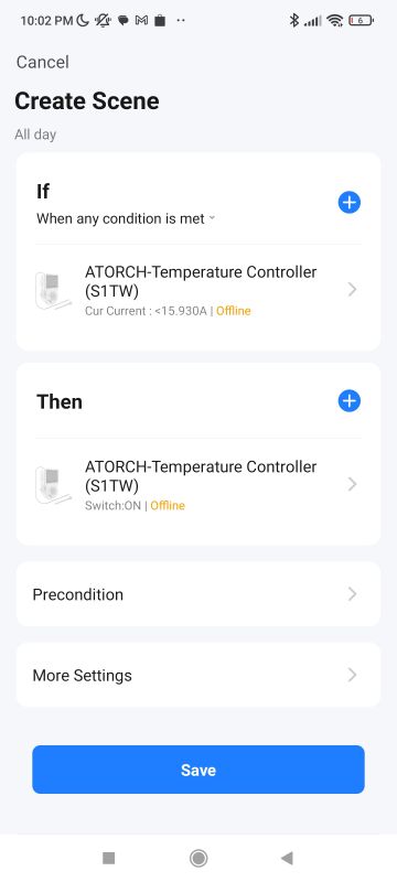

    This is what an example scene creation looks like - here we have a trigger, a condition and an effect:
    Screenshot showing scene creation in the Tuya app. App screen showing precondition settings for a smart scene. App screen for scene creation in the ATORCH S1TW temperature controller .
