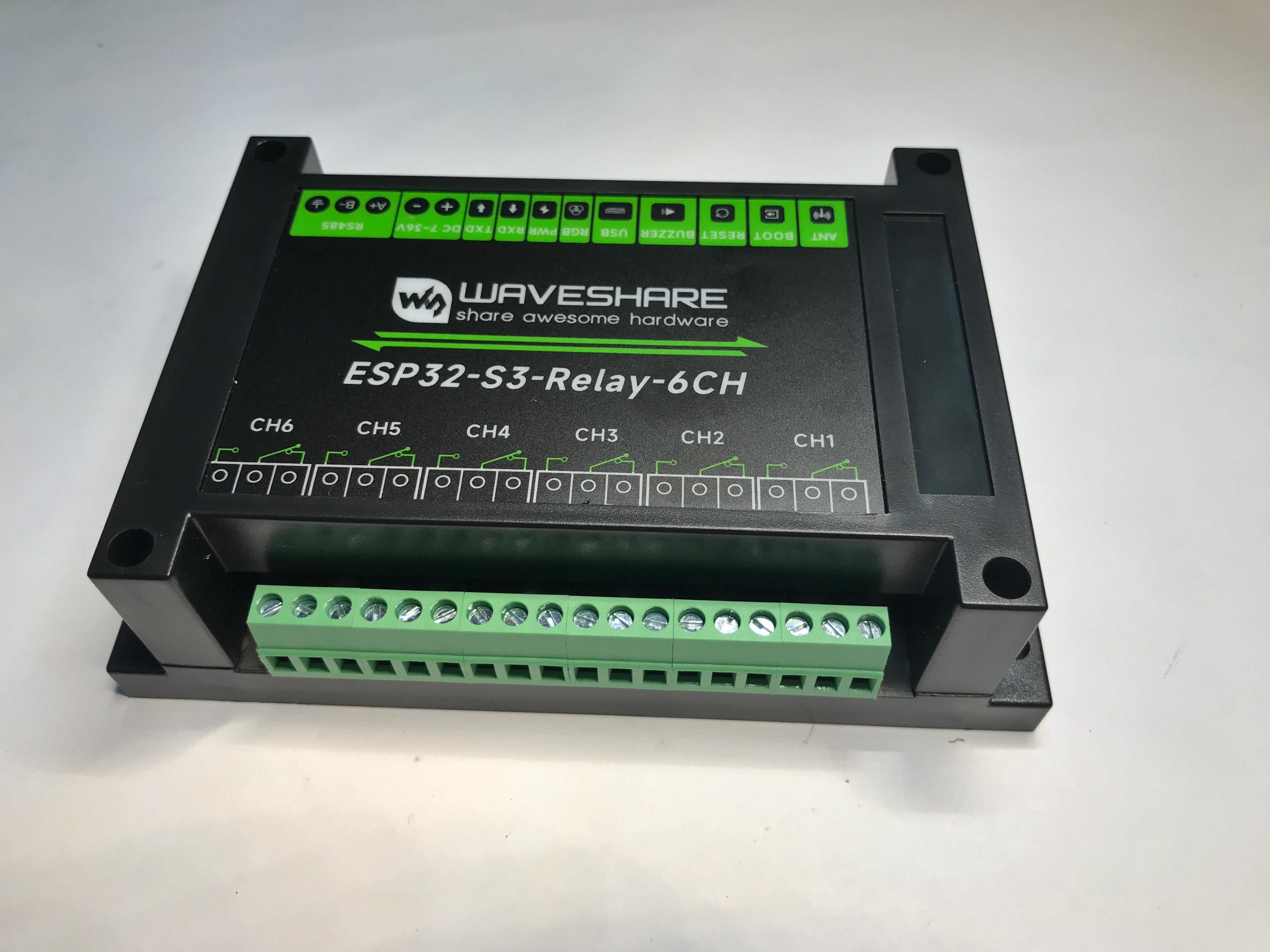

Waveshare ESP32-S3-Relay-6CH relay module with six green terminal channels
Waveshare ESP32-S3-Relay-6CH is an industrial-grade relay control module based on ESP32-S3 WiFi & BT module. It features RS485 connectivity, on-board USB to UART converter, six relays connected via PC817 optocouplers, a single WS2812B diode (for status display), onboard GPIO connector compatible with Raspberry Pi Pico Hats and can run on up to 36V thanks to the built-in XL1509-ADJE1 step down converter.
Unboxing
Let's see what's in the box. It seems that antenna and small screwdriver are included.
Waveshare ESP32-S3-Relay-6CH controller with ports and connectors in a box
The module is fully encased and all IO terminals are labeled. Relays are on the front side, each has three terminals (both normally open and closed):
On the rear side, you have antenna connector, boot and reset buttons, buzzer, USB connector, RGB diode, status LEDs, power terminal and RS485.

This is not needed for flashing and usage, but it's always interesting to check how things are made. You can unscrew the cover with the screwdriver that is included in the set.
ESP32-S3 module with 6 relays and green terminal blocks
The device is made mostly out of surface mount components. There are two extra 2.54mm pin headers inside, which can be used to route out GPIO. They are compatible with Raspberry Pi Pico Hats.
ESP32-S3 board with relay module and green terminal connectors
