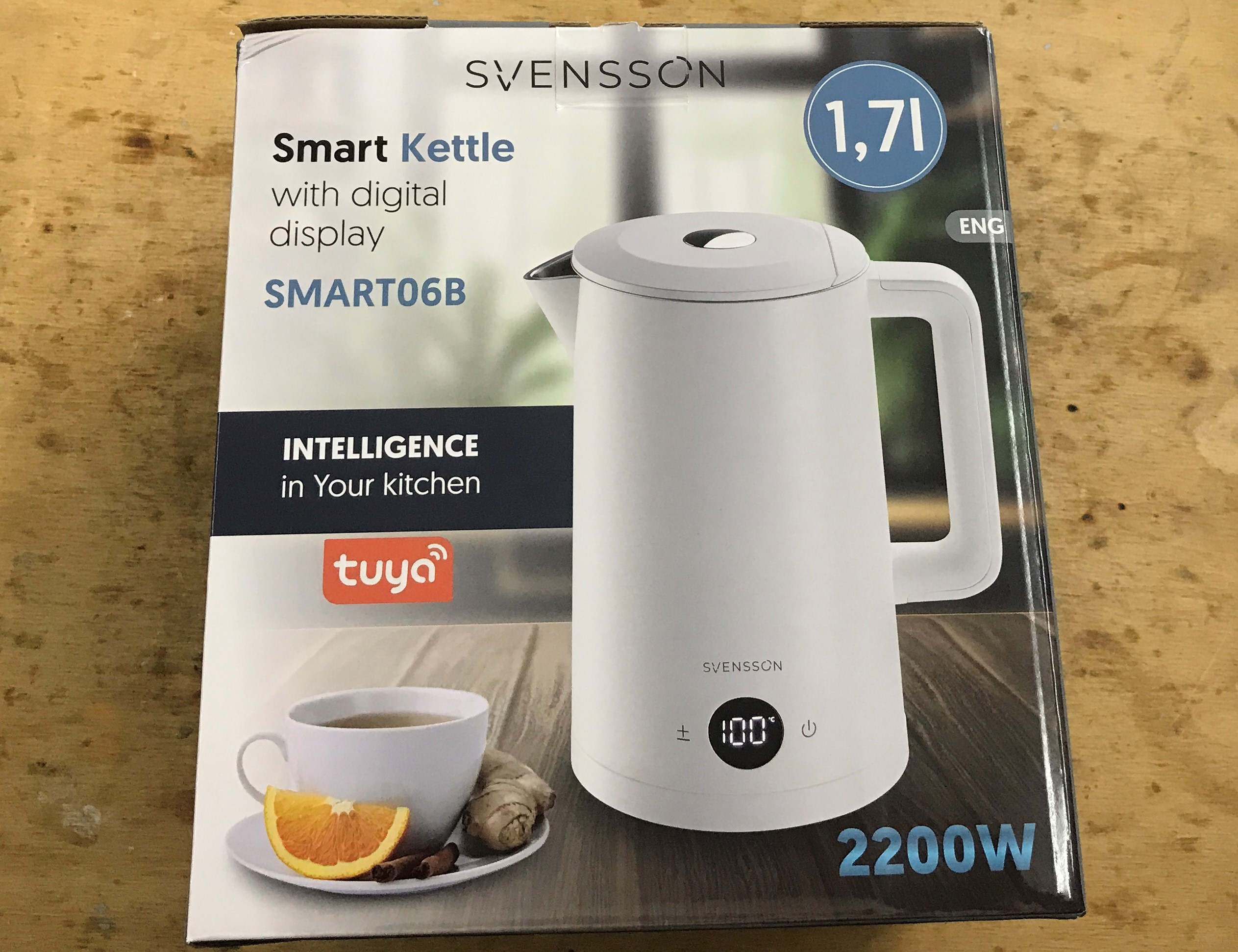

Ever wondered what a remote control for an electric kettle could offer us? The SMART06B has just such a control - all thanks to its built-in Wi-Fi module and compatibility with the Tuya mobile app. Here, I'll try to check it out and showcase it, including the centre of the device. Does such a product make sense? Let's find out!
We bought the SMART06B for PLN150, although we may have overpaid because we ordered from a local importer. An ordinary electric kettle can be bought for a few dozen zlotys, so here we are paying about a hundred extra for.... Exactly, for what?
The first thing that catches the eye is the temperature selection. That's already something. Let's check out the contents of the kit.
