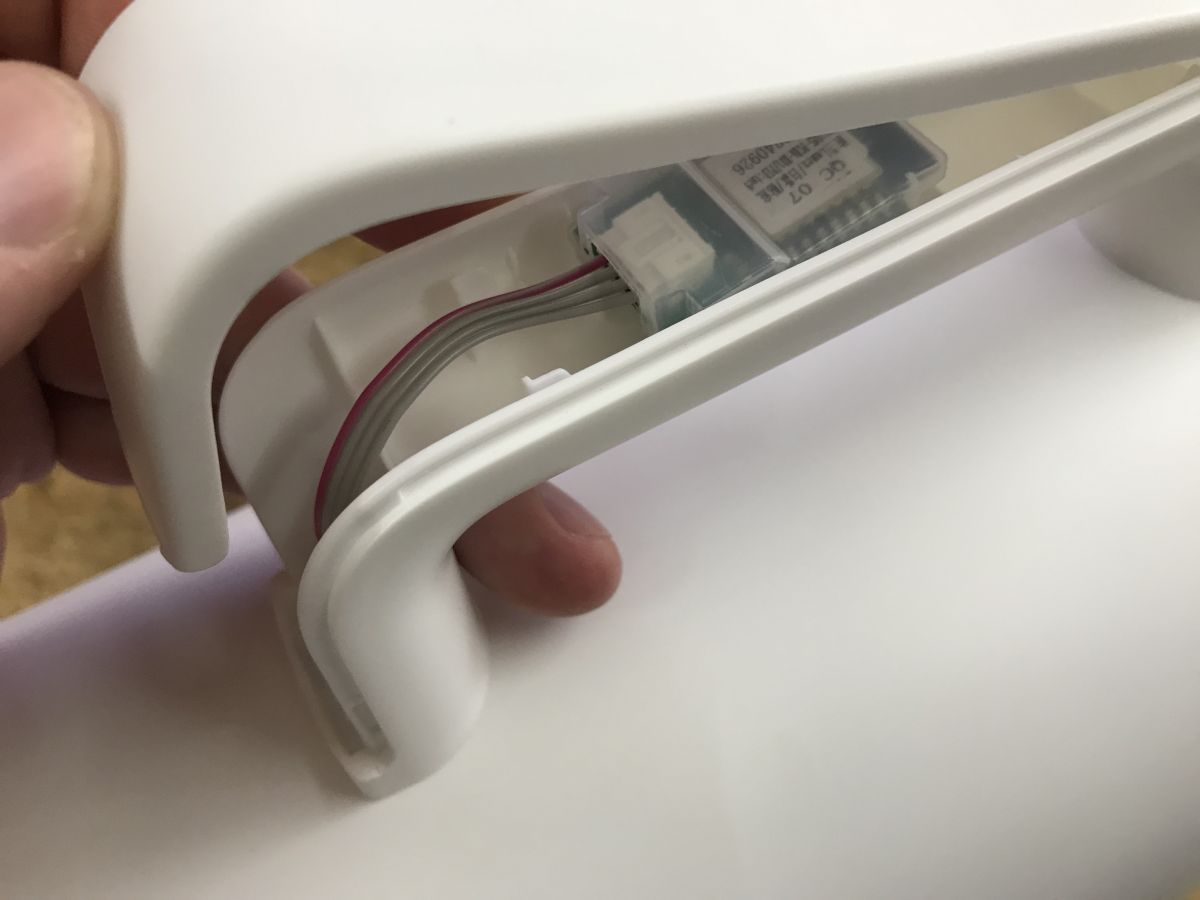

    The WBR3 Wi-Fi module is hidden in the handle:
    WBR3 Wi-Fi module inside the handle of the SMART06B electric kettle .

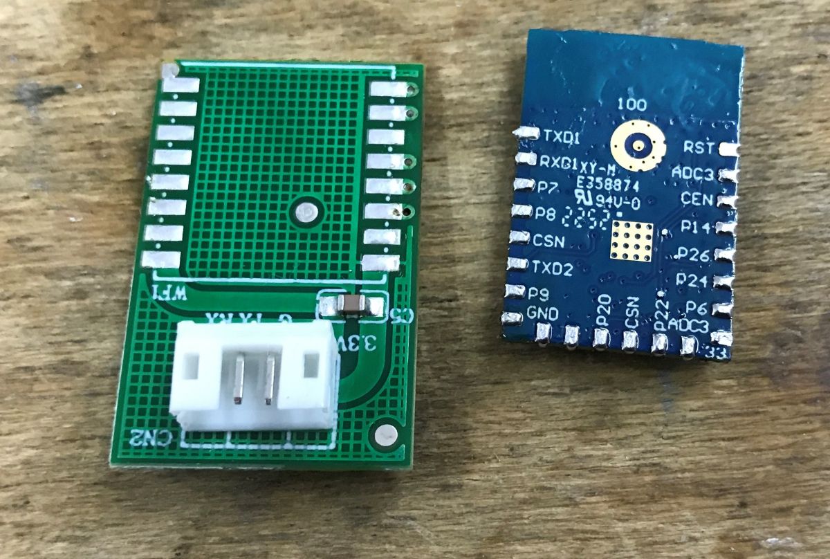

    It needs to be unsoldered from the base, as the programming pads are on its underside:
    Wi-Fi WBR3 module next to adapter board with labeled programming pins .
    Programming by topic: WBR2, WBR3, WBRU, W701-VA2-CG pinout, datasheet, flashing for Home Assistant .

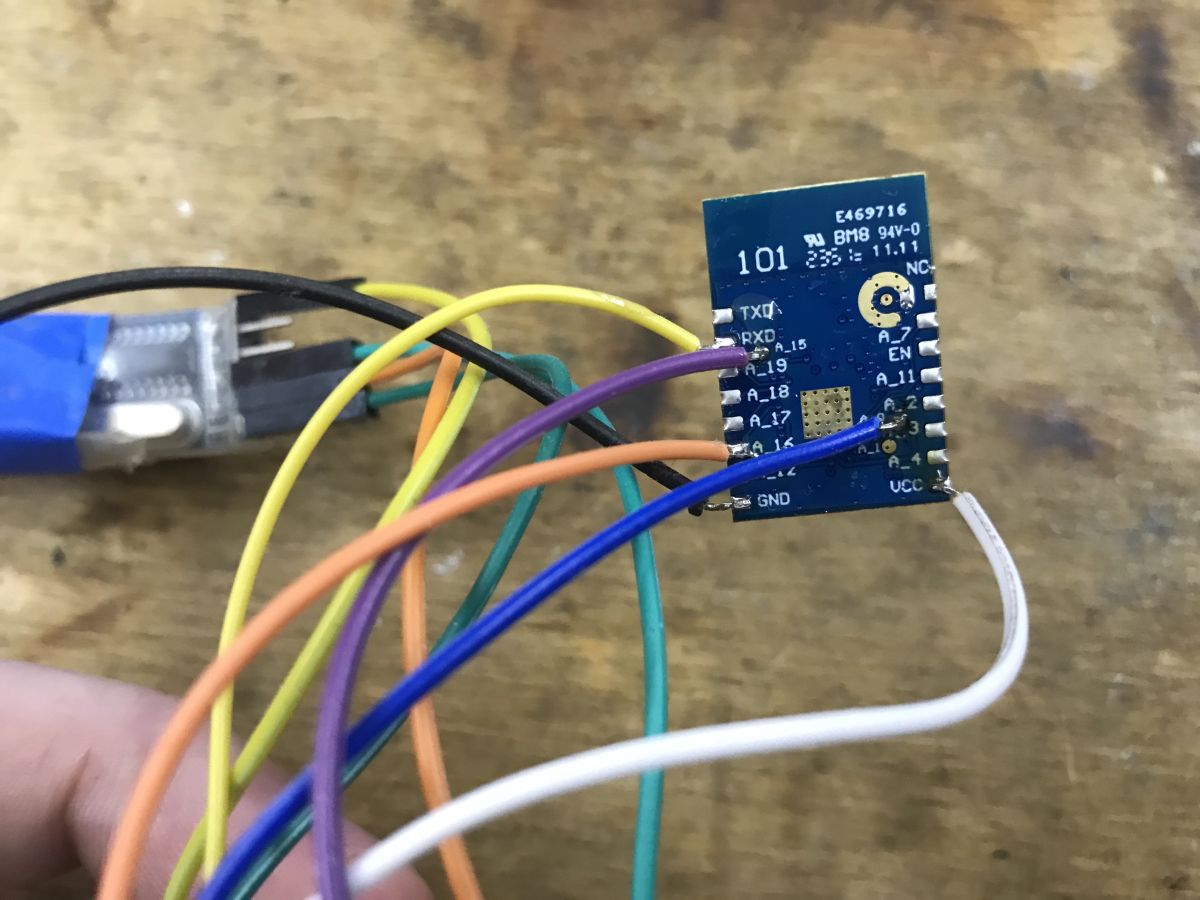

    Upload the OBK - even if there is a different Wi-Fi module inside, everything should already be supported: https://github.com/openshwprojects/OpenBK7231T_App
    Wi-Fi module WBR3 connected to USB programmer with wires on a wooden work surface .

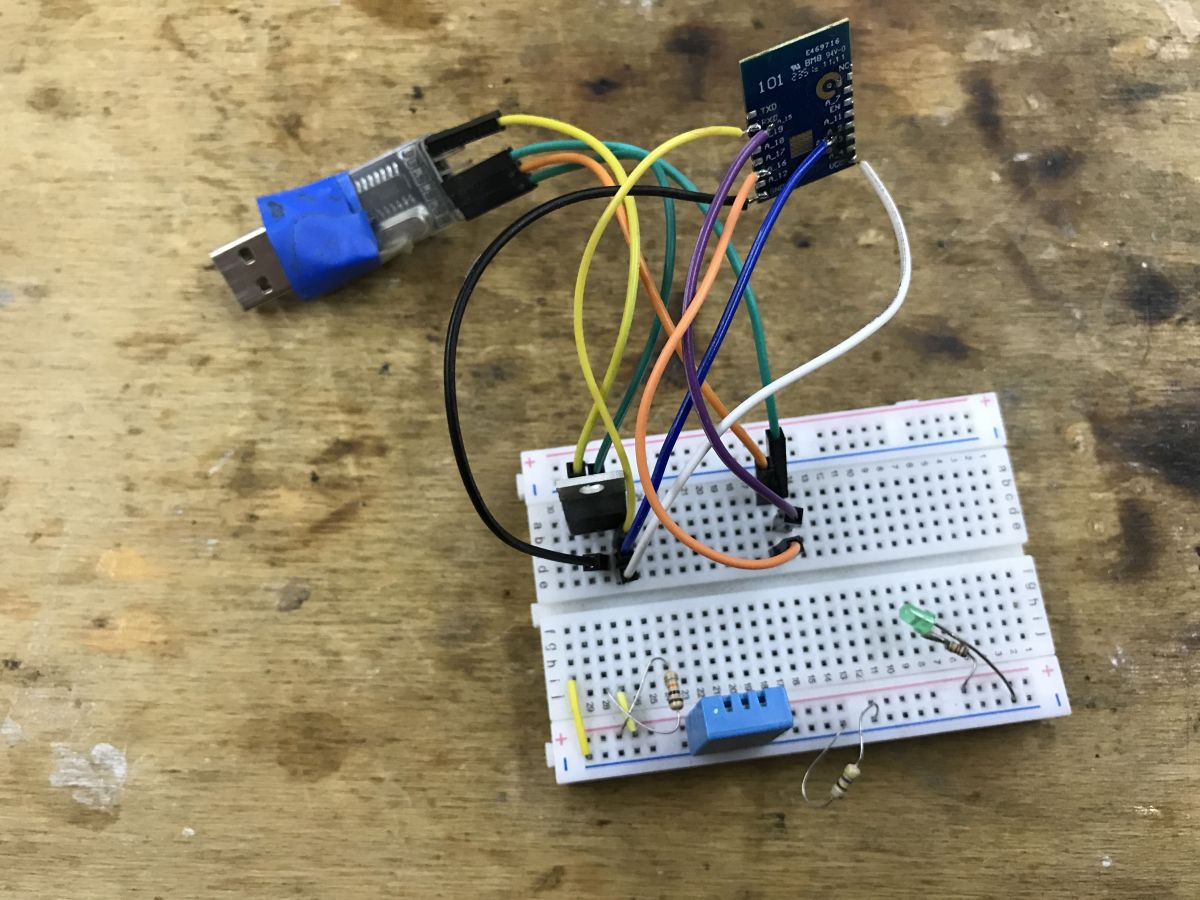

    The whole thing of course needs to be properly powered - I use an external 3.3V LDO:
    CB3S module connected on breadboard with USB-TTL adapter and jumper wires .
    NOTE - for convenience the further part is realised on my board with CB3S, but programmatically it comes out the same - both modules are supported by OBK.

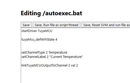

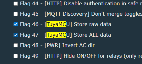

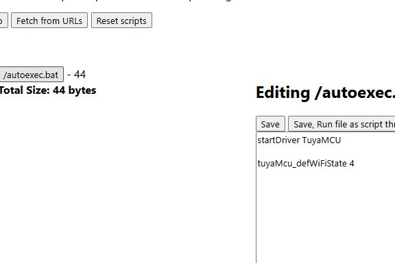

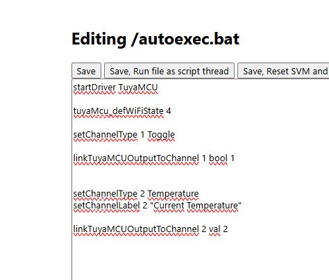

    I started by enabling the variable save flags and a simple autoexec.bat starting the driver:
    autoexec.bat script editor with TuyaMCU commands in a web interface Checked Flag 46 and 47 options for TuyaMCU data logging in a web interface .

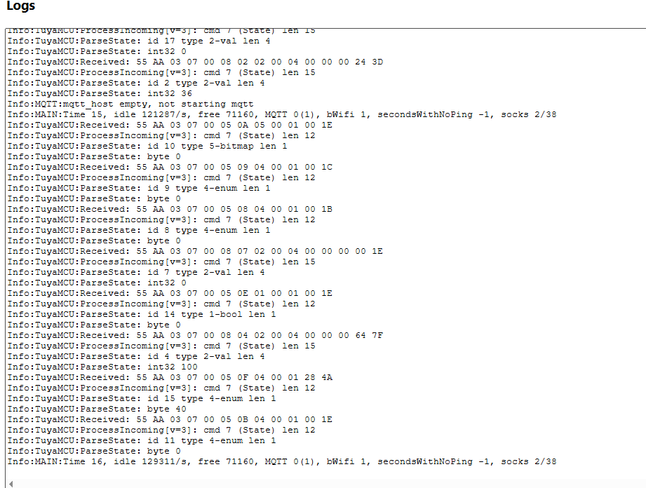

    After the reboot, the packets have already started to appear in the log:
    Displayed TuyaMCU logs showing communication packets and state data .

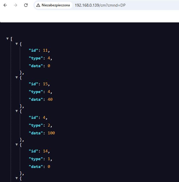

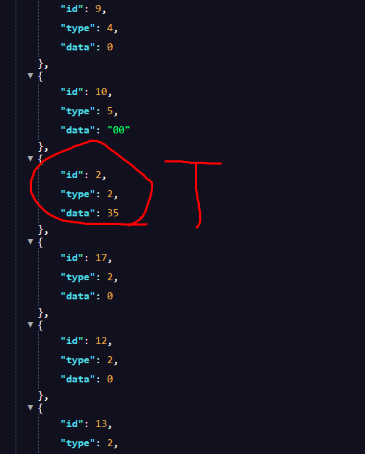

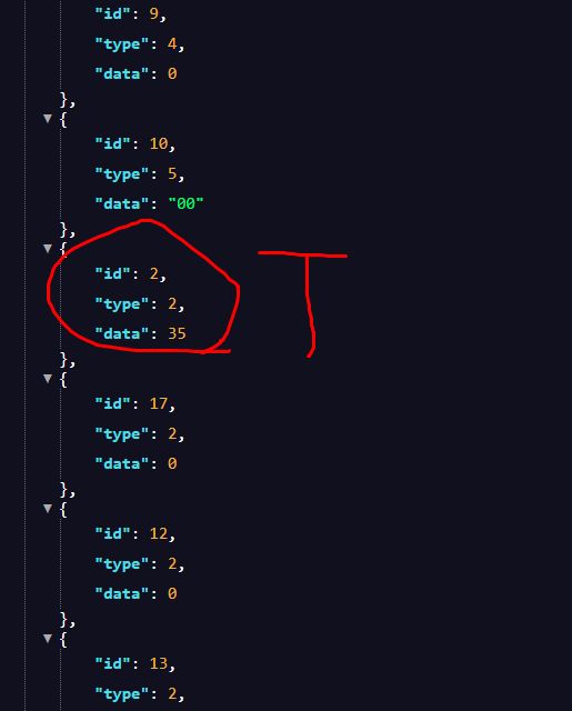

    DP command correctly returned their values in JSON format:
    JSON data from TuyaMCU shown in a web browser on black background JSON data snippet with entry id: 2, indicating temperature value 35, circled in red .

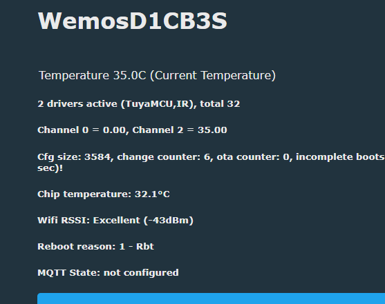

    I managed to find the current temperature there (read-only) - this is the same value as on the screen.

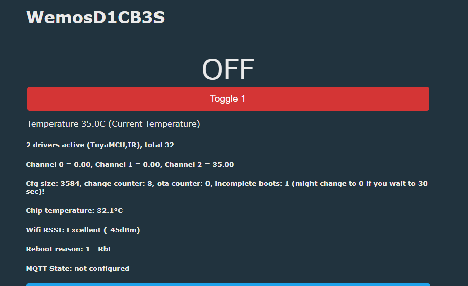

    I therefore entered its mapping into the configuration:
    WemosD1CB3S interface showing current temperature and diagnostic data Screenshot of editor with autoexec.bat script configuring TuyaMCU .

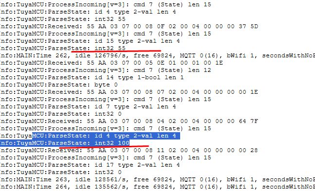

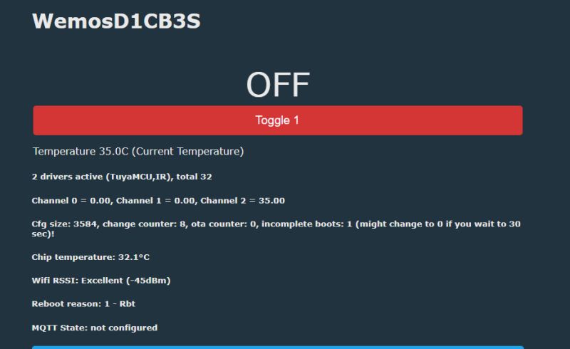

    In a similar way I found the relay state - this also gives us control, it is not a read-only variable. The type of the variable is boolean - zero or one.
    WemosD1CB3S control panel showing temperature and Wi-Fi status Screenshot of editor showing autoexec.bat script for TuyaMCU configuration .

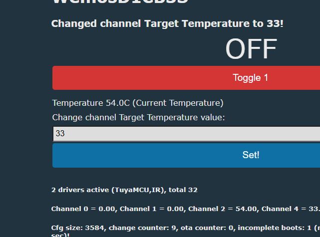

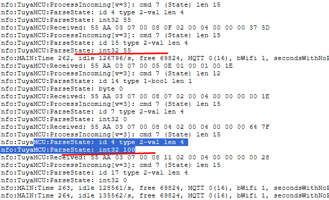

    I found the target temperature in the same way - for it I chose the form of the entry field.
    OBK interface showing current and target temperature with relay control button TuyaMCU logs showing DP data, with highlighted field indicating target temperature value .

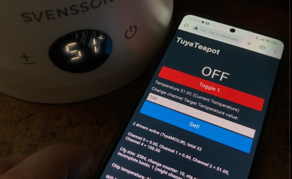

    The whole thing appears to be working:

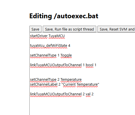

    Final autoexec.bat:
    startDriver TuyaMCU
    tuyaMcu_defWiFiState 4
    setChannelType 1 Toggle
    setChannelType 2 Temperature
    setChannelLabel 2 "Current Temperature"
    setChannelType 4 TextField
    setChannelLabel 4 "Target Temperature"
    linkTuyaMCUOutputToChannel 4 val 4

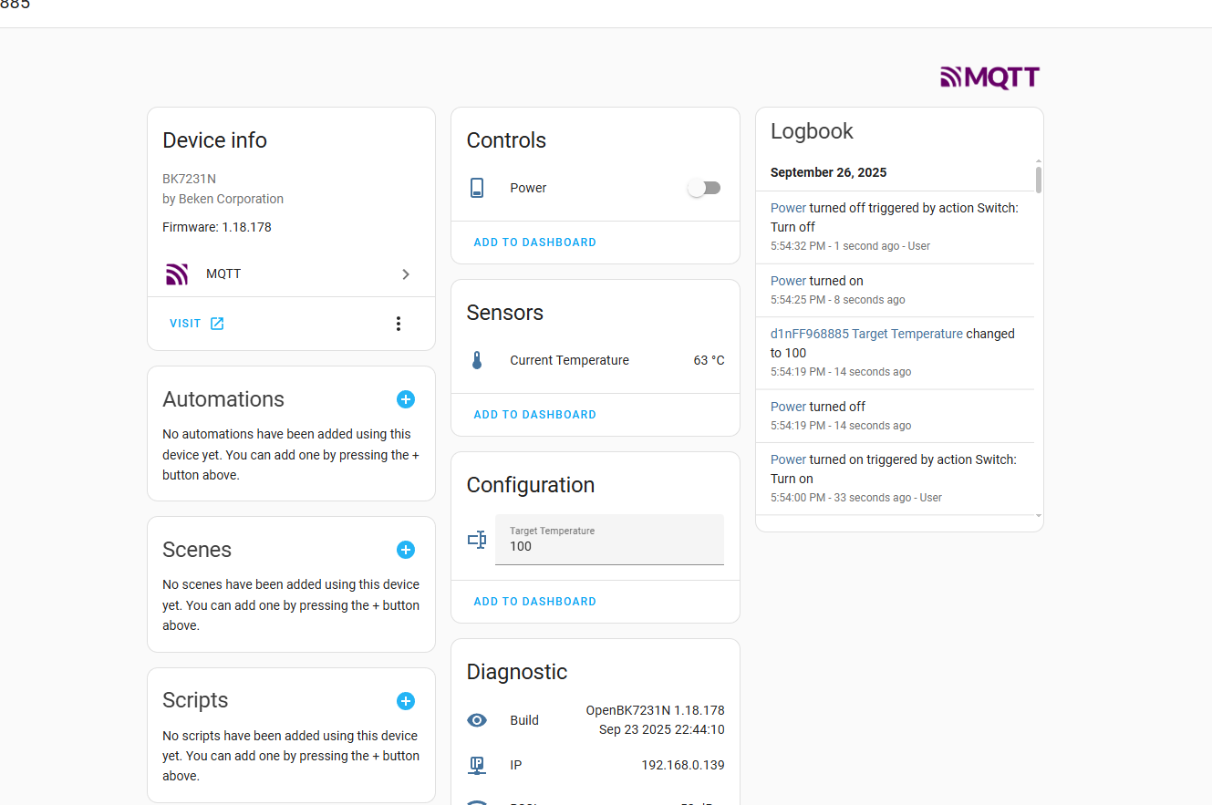

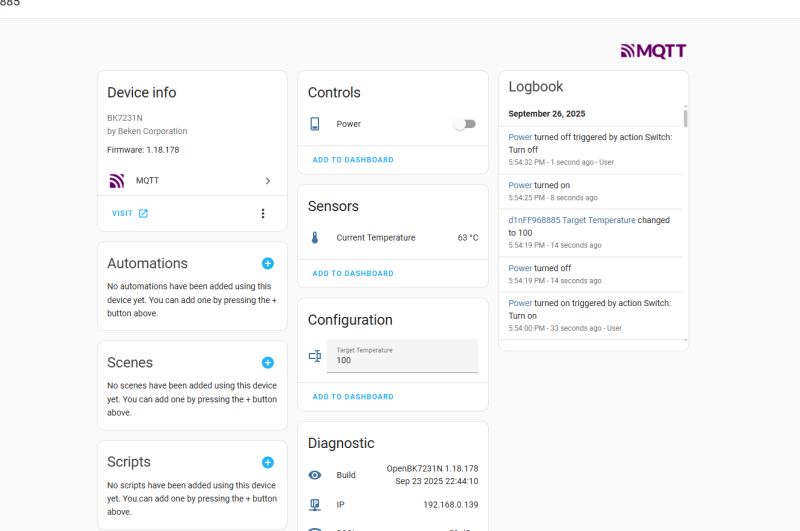

    You can now pair with the Home Assistant:
    HA panel:
    Home Assistant panel showing kettle with OpenBK7231N firmware integration .

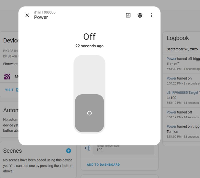

    Relay control available:
    Device control panel in Home Assistant with power switch set to Off .

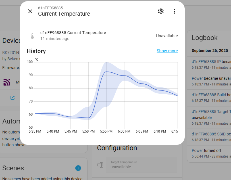

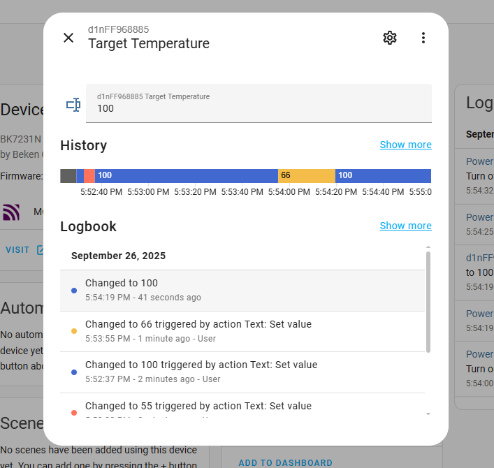

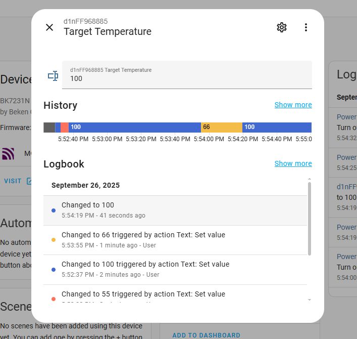

    We also have a temperature history (current and target):
    History of kettle target temperature changes in Home Assistant panel Kettle temperature graph showing rise to around 95°C, followed by a drop .
    Basically all the basic functions work - and now the more advanced ones can be realised on automations with Home Assistant.
