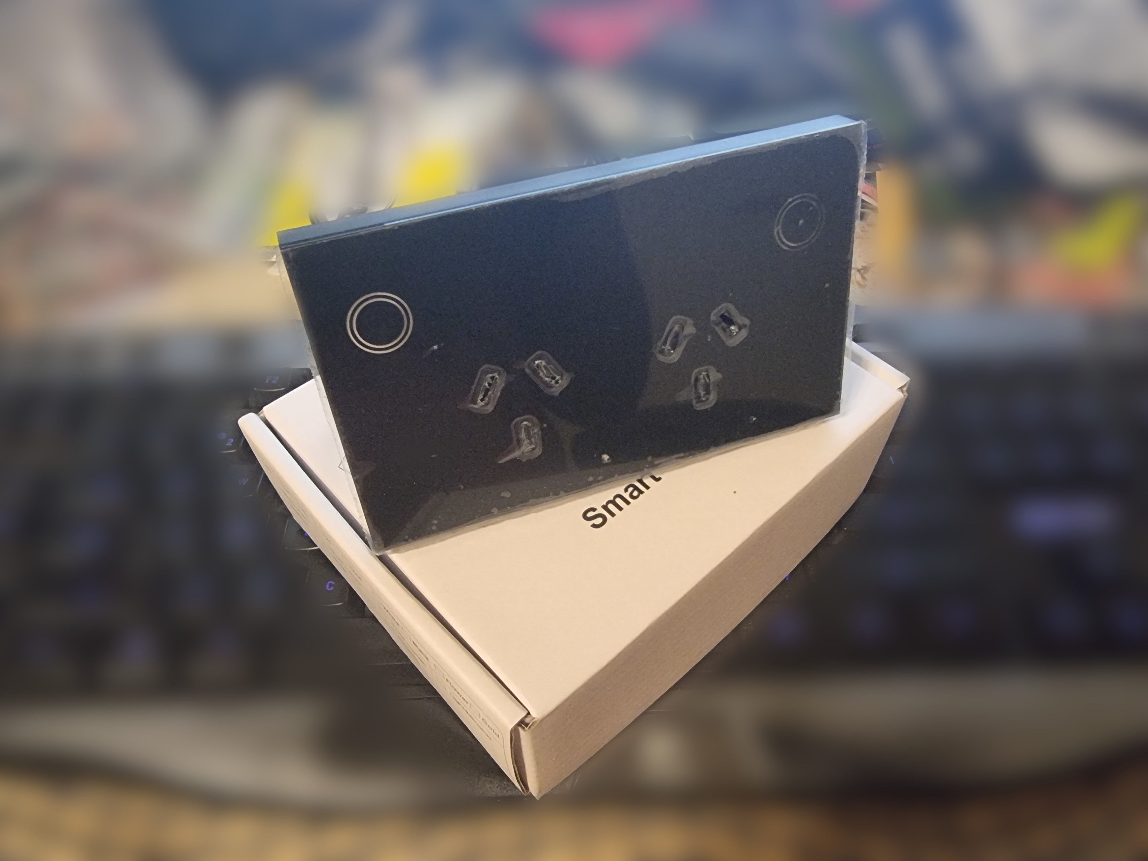

  • The Makegood MG-AUWF01 “Touch WiFi Wall Socket” Revision 1.2-211019 was converted from stock firmware to OpenBeken on BK7231T/WB3S hardware.
  • Flashing used the BK7231 Easy UART Flasher under Linux with mono, a clone Arduino UNO held in reset as the USB-to-TTL bridge.
  • A consistent 460800 baud rate worked, and after the first unit the rest took less than 5 minutes each.
  • OpenBeken was configured with LED_n, Rel, Btn, BL0937CF1/CF, and BL0937SEL pins, startup channels set to -1, and Flag 6 enabled for instant touch.
  • OpenBeken pin numbers map to the Beken chip, so the board had to be traced by names, and the original LED colors were reversed.
Glass touch panel with black surface resting on a white Smart Switch box. Rear label of MG-AUWF01 touch WiFi wall socket showing wire labels and specs. White box labeled “Smart Switch” with a drawing of a touch switch panel White box for smart touch switch with configuration options chart on the side
I had previously bought a set of these around 2020 because they contained an ESP-12F with Tasmota support. later I bought some more, but they changed the chip used in them. Thankfully I've found people have been making a similar firmware for this board as well. There's no guide for this particular device however, but I can use this as an opportunity to contribute something!
I had only used tuya-convert before, so this was a bit of a learning curve, but actually doing the modification was not difficult once you've figured it out. once i'd done one of them, the rest took less than 5 minutes each.
Here's what i ended up doing for most of them. initially I soldered all four wires (VCC/GND/TX/RX), but later I used cheap probes for the power (could do wire wrapping instead), and just held the TX/RX by hand (no soldering!). Using a clone Arduino UNO held in reset in place of a USB to TTL serial adapter. I used the BK7231 Easy UART Flasher tool, running it under linux using mono. A baud rate of 460800 was consistent for me. I simply held the serial wires in place, clicked the read/write button in the flasher tool, then plugged in the VCC pin to the Arduino.
