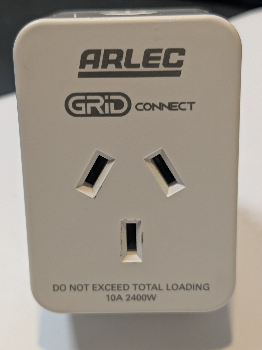

This was for an Arlec Grid Connect (from Bunnings) - PC191HA Series 3
Arlec Grid Connect smart plug, front view with logo and three outlet slots.
Label on Arlec smart plug PC191HA Series 3 showing model, electrical ratings, and logos.
