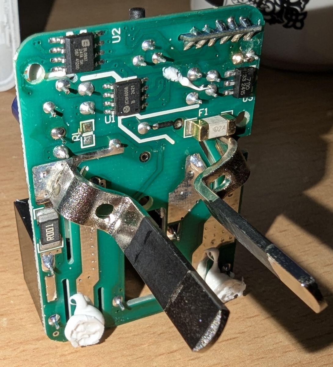

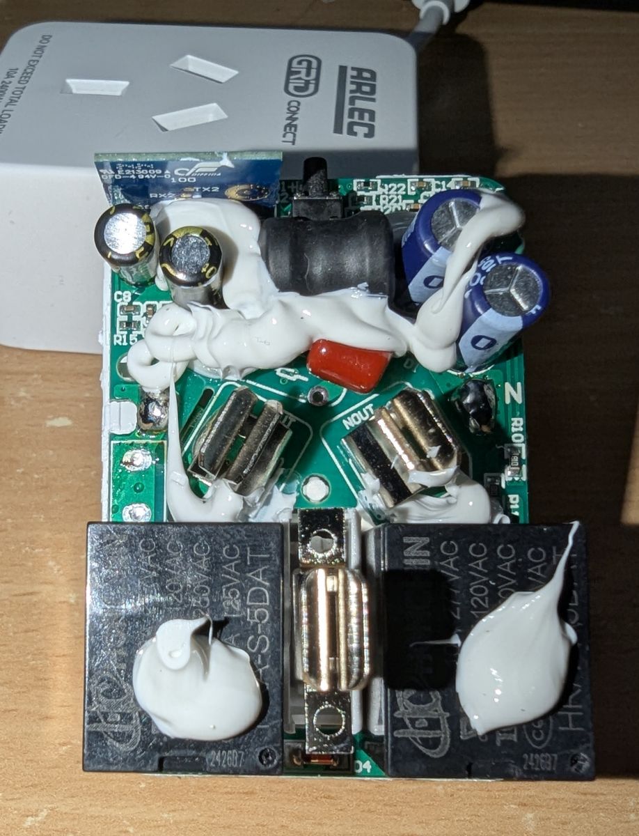

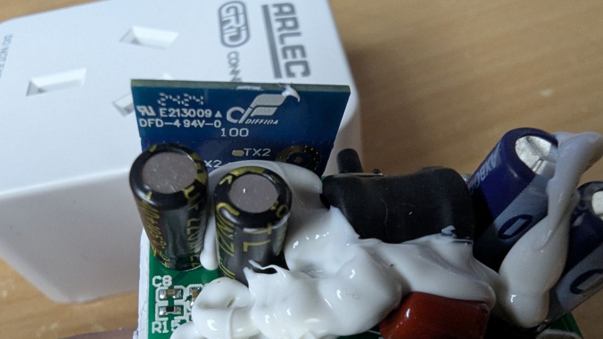

    It appears we now have another revision to the Arlec PC191HA Plug-in socket with energy metering. For reference here are the links to the teardown for Series 1 and Series 2.
    Some pictures of the outside:
    Packaging of Arlec PC191HA-4 Series 3 4-pack with smart power adaptors Exterior of the Arlec PC191HA Series 3 plug-in socket with energy meter.
    Pictures of the inside:

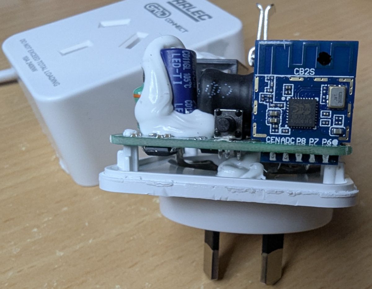

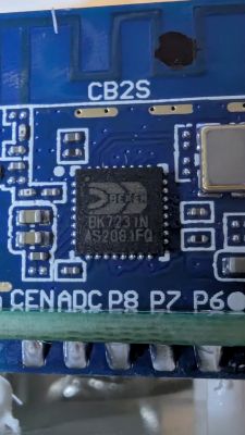

    Inside view of the Arlec PC191HA socket with components covered in silicone. Dismantled Arlec PC191HA socket showing CB2S module and integrated circuit. Close-up of the interior of an Arlec PC191HA socket showing capacitors and a silicone protective coating. Close-up of CB2S module with BK7231N label on a blue printed circuit board. Image of the interior of the Arlec PC191HA plug socket showing electronic components.
    It appears like a slightly more compact layout with dabs of silicone around the components I assume to improve robustness.

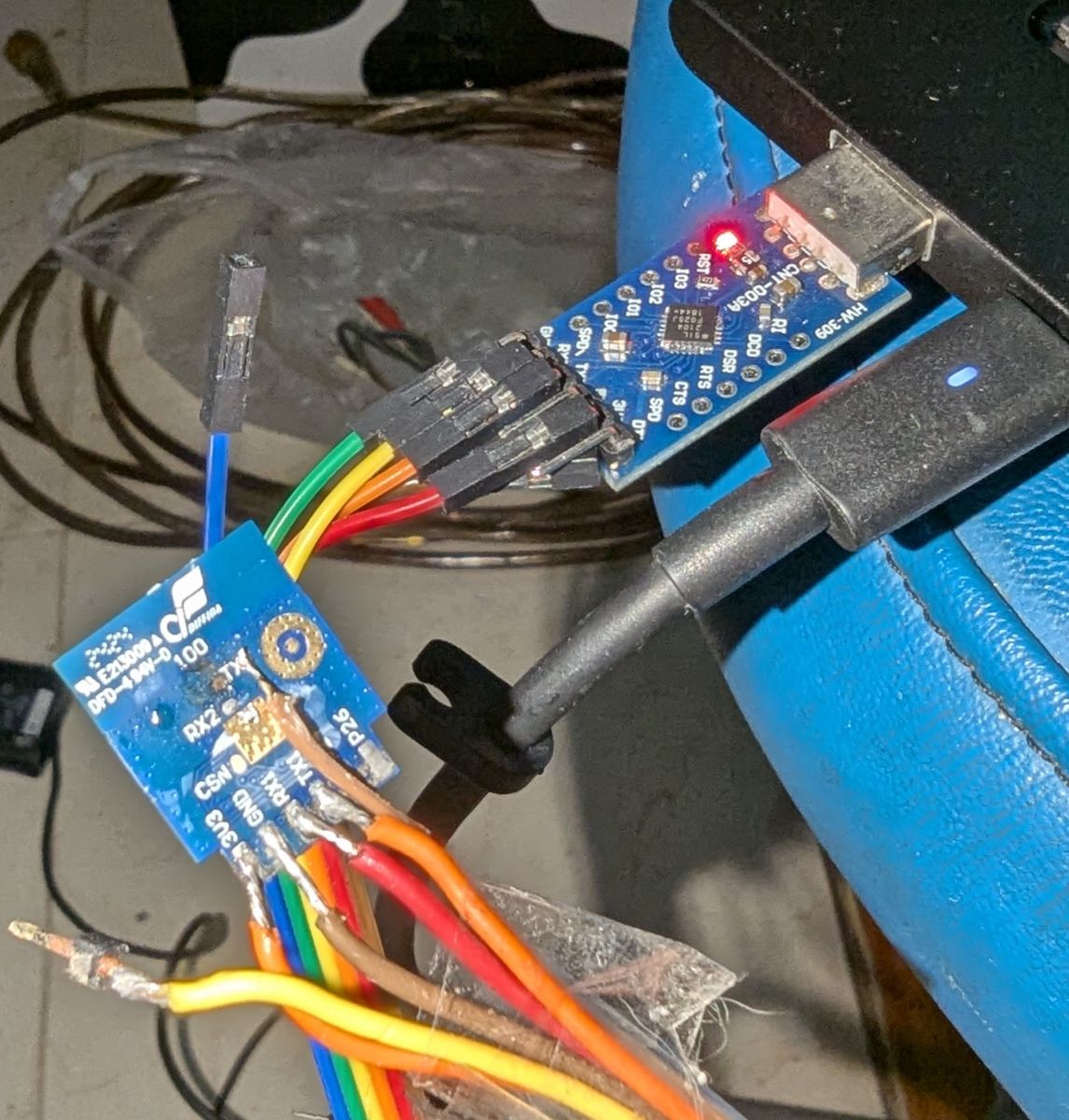

    The Tuya firmware version I saw when connecting it to the SmartLife app was 1.1.17 which apparently is a patched version preventing CloudCutter from flashing. I tried one of the profiles with no success.
    So I de-soldered the module for flashing the old fashioned way.
    Connected electronic device with colored wires and a USB module during soldering.
    Device configuration, as extracted from Tuya (using Easy UART Flasher):
    - BL0937 SEL on P24
    - Button (channel 1) on P11
    - LED (channel 1) on P26
    - BL0937 VI on P6
    - WiFi LED on P10
    - BL0937 ELE on P7
    - Relay (channel 1) on P8
    Device seems to be using CB2S module, which is using BK7231N.
    Config in json format:
