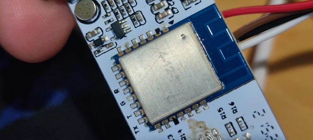

Identifying and Reflashing Unknown BK Chip from Arlec Grid Connect Smart Corner Light
cybercorey 1293 3
  • Unable to enter flashing mode on BK chip
    #1 20693869
    cybercorey
    Trying to identifiy this chip to reflash/replace it.
    Electronic circuit with a Wi-Fi module on a printed circuit board showing visible pins and electronic components.
    Project is from bunnings NZ here: https://www.bunnings.co.nz/arlec-grid-connect...m-white-corner-light-with-sound-sync_p0317966
    I managed to connect to TX/RX pins to pull log but unable to dump or put into flashing mode (tried BK7321 easy UART flasher)
    This is the log i was able to pull (using esp-flasher)

    Hello, maybe it's the same pinout as in this topic?
    https://www.elektroda.com/rtvforum/topic3985978.html
    I had to desolder that module with hot air to check.
    Can you check with multimeter where are VDD and GND pins and mark them on the photo?
    Would you be able to remove this chip with hot air to verify the silkscreen pad markings?
    https://www.youtube.com/watch?v=VrF9eBJ7TUY

    Posts: 14771
    Rate: 12914
    For now, you can just check GND and VDD "fingerprints" with multimeter. This should give us a basic idea whether the GPIO layout may match the one from the topic I linked.
