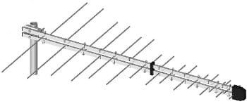

    Hey I have this question. I am currently testing various antennas for SDR RTL. I found a logarithmic-periodic antenna I bought some time ago. The antenna almost new bought from Dipol store It turned out to be a disappointment. I wonder if converting it to a polywave dipole with different arm lengths but joined together. into one antenna . And positioning it vertically, is there a chance for reasonable reception ? I live in an apartment building but located the highest in my town. Having a 2-story attic. And the polywave dipole I made works quite well.
    And I will immediately ask
    In connection with the dimensions of my attic. I am wondering what to choose, having a choice. Large antennas but placed under the roof and rather normal on the roof.
    Digression
    Once due to several broadband antennas placed in the attic Piorum blew a hole in the roof 2 times in the same place. Fortunately, the neighbors changed and the new ones do not know about these adventures :) Log-periodic antenna mounted on a vertical pole. .

    On google find logarithmic antenna calculator
  • #1589 20723809
    Tommy82
    Posts: 12141
    Help: 455
    Rate: 1074
    @waniah
    But she is directional. I once hooked up to a TV logarithmic dump 1090 and it even picked up something but narrowly. Do you have a specific target or generally for listening because if the latter it's pointless.

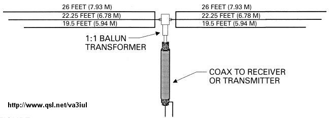

    For listening I use a set of dipoles of different lengths, properly trimmed for specific frequency ranges. I found on the web some diagrams of dipoles combined into a set. For now I am experimenting.
    Electrical diagram showing an antenna dipole array with a 1:1 balun. Diagram of a dipole array with varying element lengths.
