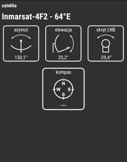

    Librus
    Posts: 7
    don_viking can you tell from what satellite position (from which satellite) you are feeding SDR and JAERO?
    From the lists that I found on the net, I do not see a satellite to Europe - maybe I was looking wrong.
    As for quartz in cheap SDRs, they are quartz in small housings - the same as in radio remote controls. I've played around with it, and often the older quarks are more stable. I also used generators. The problem is the heat released by IC.

    don_viking
    Level 21  
    Posts: 562
    Help: 14
    Rate: 136
    There are several satellites, but I listened to Alphasat I-XL the most.
    How to use RTL-SDR on a cheap USB DVB-T tuner for HF and 64–1700 MHz? How to use RTL-SDR on a cheap USB DVB-T tuner for HF and 64–1700 MHz? How to use RTL-SDR on a cheap USB DVB-T tuner for HF and 64–1700 MHz? How to use RTL-SDR on a cheap USB DVB-T tuner for HF and 64–1700 MHz? How to use RTL-SDR on a cheap USB DVB-T tuner for HF and 64–1700 MHz? How to use RTL-SDR on a cheap USB DVB-T tuner for HF and 64–1700 MHz?
