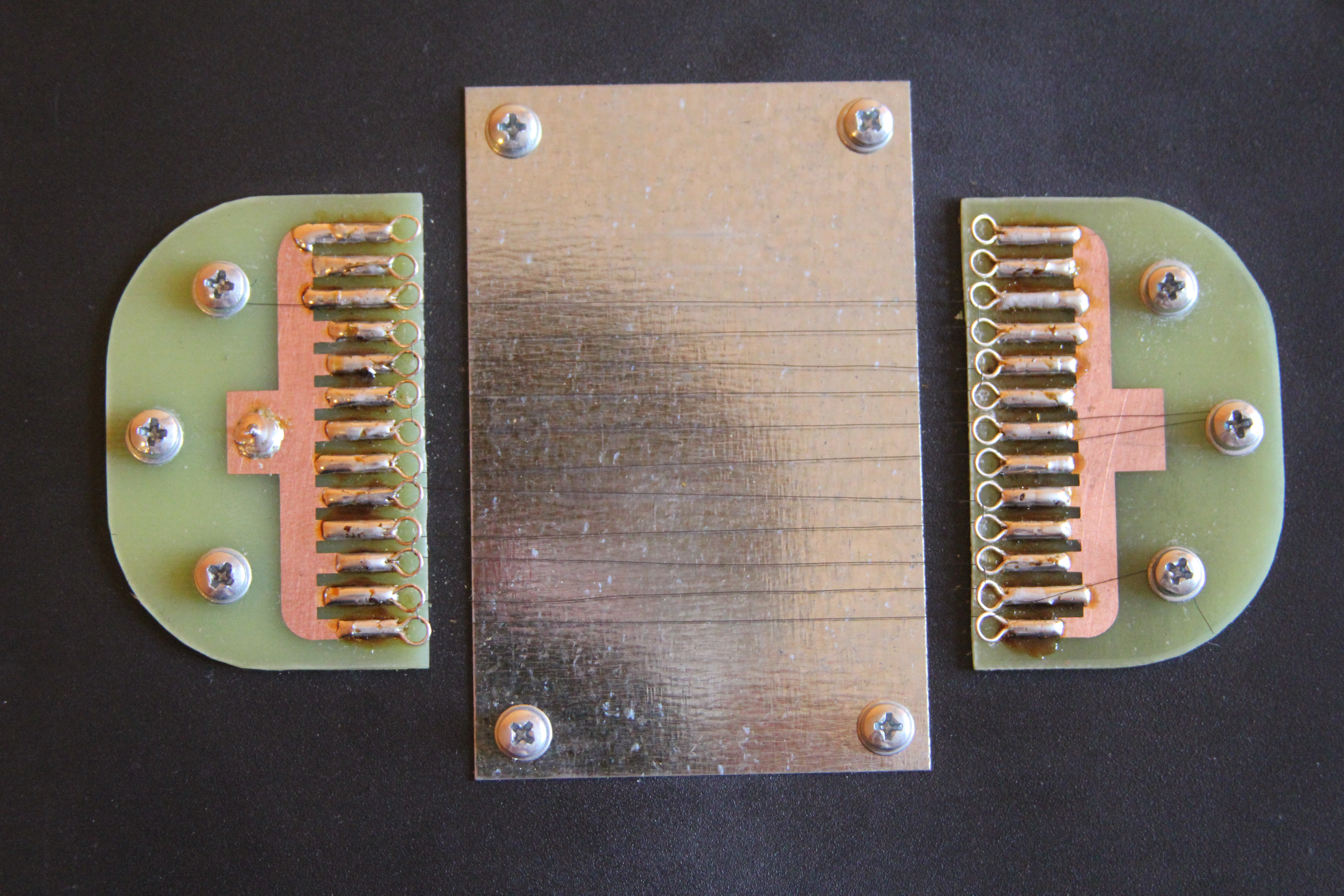

    During detector operation, high voltage (slightly below breakdown voltage) is applied to the electrodes. The active area of the detector is in close proximity to the wire electrodes. Alpha particles passing through such an area cause the formation of a sufficiently large amount of free charges for an avalanche (electric) breakdown to occur. As a result, the alpha particle in the detector leaves a trace in the form of audible and visible sparks to the naked eye.
    Construction
    1) HV power supply - electronic part
    Necessarily regulated, giving about 4-5kV output. The current efficiency of the power supply should be large enough to be able to maintain the current resulting from a corona discharge. In the design of my power supply I used a CCFL converter (on the ~ 1kV output) on the input, which I placed an adjustable voltage stabilizer (LM317). The voltage output from the inverter is further increased by a four-stage voltage multiplier. The whole is powered by 12V. The design with a linear stabilizer is simple but terribly coarse. A fairly large 0.6A current flows through the stabilizer, so you must give a radiator. A much better idea is to use a lowering impulse stabilizer. The diodes working in the voltage multiplier cooperating with the CCFL converter should be fairly fast and withstand high back-up voltages (at least 1.5kV). I used the "GP02-20" diode.
    2) Detector
    When it comes to the design of the detector, the key is the thickness of the wires. They should be very thin otherwise the device will not work at all. In my construction I used tungsten wires with a diameter of ~ 0.1mm. An important factor is also the smoothness of the structure, no wire bends or scratches on the sheet. This greatly facilitates voltage regulation.

    When you apply the source to the side (in the plane of the wires), does alpha particles have enough energy to leave a row of sparks as a trace of the passage of the particle?

    Unfortunately not. This is probably because the detector has a strong electric field and the particle is quickly "pulled" to the negative electrode.

    A very interesting idea. I have a question about where tungsten wire. Can you use 0.17mm acupuncture needles instead? And another question about the WN power supply, will the author provide the diagram.

    The diameter of my tungsten wire is in the range [0.05mm, 0.10mm]. As you can see, this wire works correctly. I also checked wires with 0.25mm diameter (E1 string of an acoustic guitar) and 0.20mm (steel), but both did not work. I do not know if a wire of such thickness as yours will be suitable. It is quite possible that it will work. This has to be checked experimentally :) Some time ago I found this thread on the triode: link . There is a link to the Polish manufacturer's website and the prices of such wires are described. Wires do not necessarily have to be tungsten. You can even use copper wires drawn from thin cables just like the author of this project: link

    @ dpieciak5 And what is the problem, the more that the detection currents are really big here. Every system from the Geiger counter, even the simplest one, described on the Forum will pass the exam here.
    The conclusion is also from the operation of this detector that for dinner with a Russian (Russian) you should go with an electric mosquito pack. The polonium isotope Po204 is a strong emitter of alpha particles :D

Quick 3-step voltage-tuning procedure
  1. Start at 3 kV with source in place. 2. Increase voltage until random corona just appears, then back off 5 %. 3. Insert 1 MΩ resistor and verify single, clear sparks only. Repeat after electrode cleaning.
