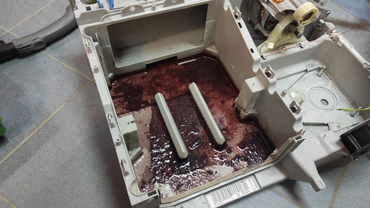

    drboczek wrote:
    let`s see if I can cheat fate,
    I doubt it, because you won`t be able to reach the entire surface under the exchanger. The last one I made (7 years) looked like this:
    Rusty and dirty washing machine housing with detergent residues at the bottom.
    drboczek wrote:
    And here`s the dilemma again because my wife doesn`t use powders, she only uses capsules and I think that thanks to this we have a fairly clean interior of the drum.
