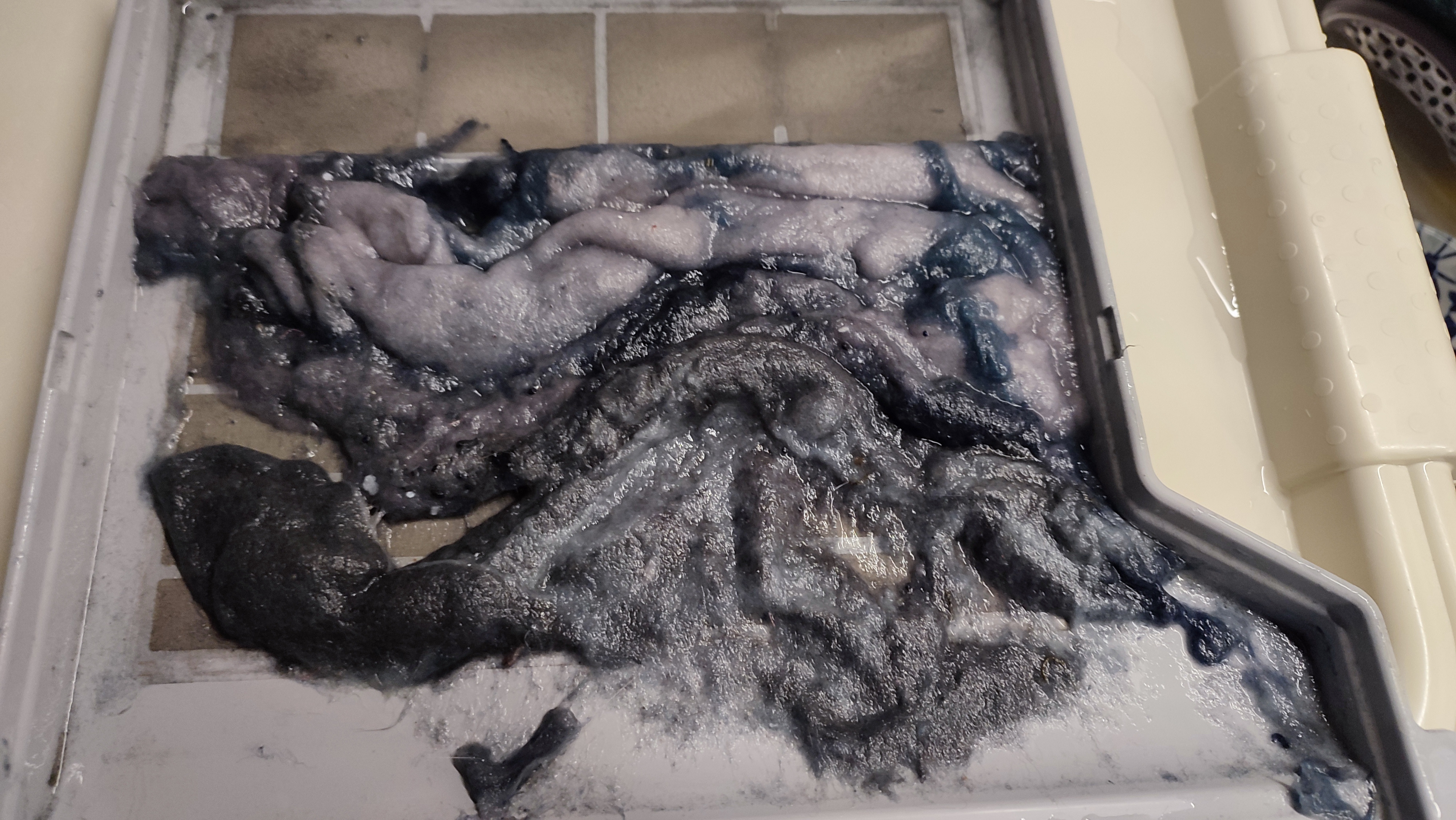

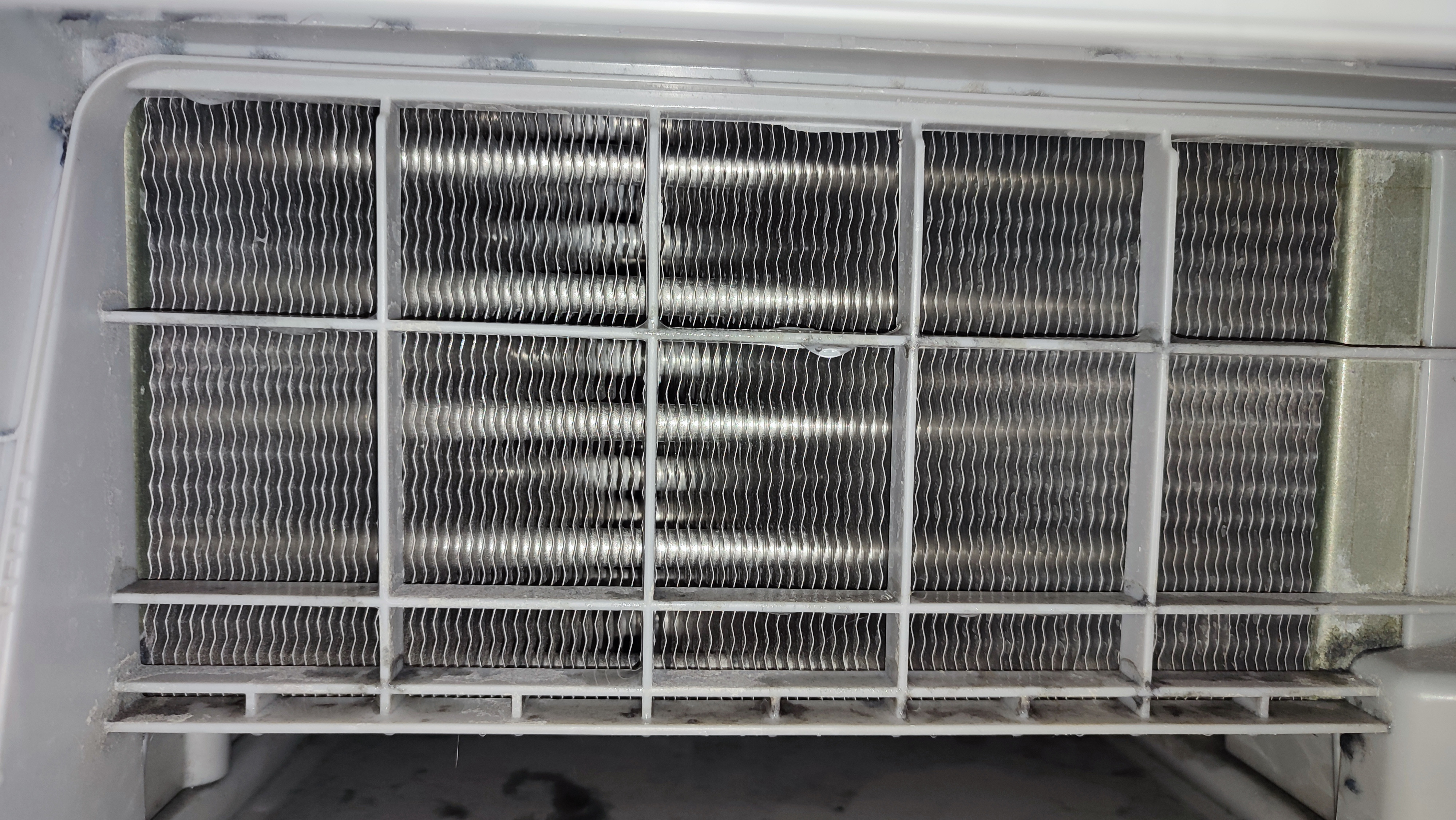

    mrice wrote:
    To assess this factually, we need photos of the condenser and evaporator from the front, from the back and above, and with good lighting. Additionally, please write how often the dryer is used.
    Of course, the photo can be taken without disassembling it. Well, this is the place that gets dirty first in every dryer. The rest of the element in the inspection camera looks the same. There are only drops of water on the ribs. The dryer is used like in every home to dry everything washed. The next photo shows lint, which in this condition will not dust the device.
    And at this point, I'm sorry, but there's nothing else to talk about. We don't know anything about the condition of the condenser, and I've had cases where the evaporator was clogged and the condenser was clogged. And what's interesting, it most often occurred during self-celebrations.

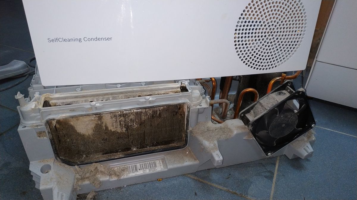

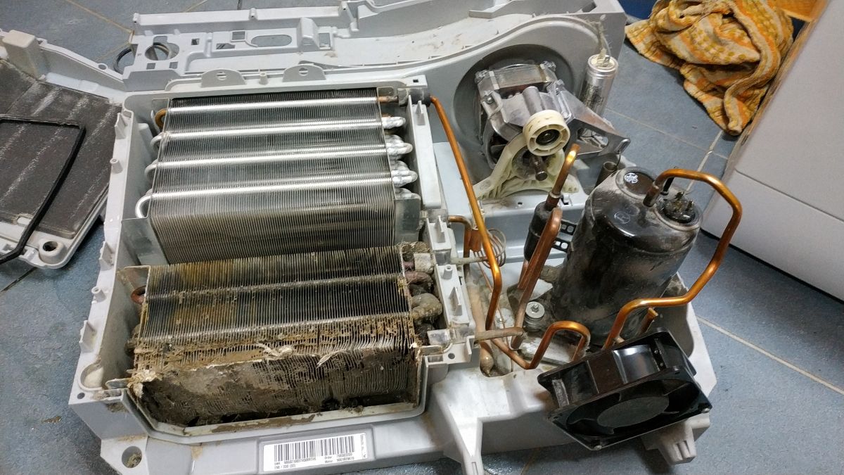

    Borutka wrote:
    Of course, the condition is to rinse the filter after each drying.
    And this is the basic key to success.
    And that's the bottom line, but it's more of a curiosity, because this condition is not a rule, but one of the Bosch pumps with a self-cleaning system was cleaned after a year and a half of intensive use:
    Dirty condenser with a SelfCleaning system after intensive use. Dirty condenser from a washing machine with a self-cleaning system after intensive use. Worn cooling system with visible dirt buildup.

    >>20835875
    Regarding the photos. From my modest experience, to disassemble the dryer like in the photos, you need at least 1 hour of practice, and for my skills, 2-3 hours. The same amount of time to assemble it

    mrice wrote:
    I assume that if there are no (simply no) lumps at the beginning of the road, it can only get better. Perhaps other items are rinsed as well. I can assess the amount of fluff after rinsing by visually examining the water from the condensate tank. The water is quite clean and you can see the suspension when held up to the light, which indicates effective wet filtration. I don't think this filtration was present in the previous self-cleaning system. Moreover, it is not known how the rinsing process was carried out during the dryer operation in the previous system. If any fluff remains on the evaporator after work, it is known that the snowball effect will continue and the water jet will never rinse it away.
    mrice wrote:
    one of the Bosch pumps with a self-cleaning system when it was cleaned after a year and a half of intensive use:
    Well... any device can be hacked. In addition to total neglect, the photos also show cleaning with a hammer ;)
    The hole for the "flush" is visible in the first photo above the exchanger, but to make it clear, because you have a different model, give me the entire E-number of your machine, I will look in the papers and we will see.
    As I mentioned, she had a hard life, and this condition was achieved in a year and a half. The mentioned cleaning with a hammer was previously performed by a dealer or his foreman, this device was from beyond our western border.
