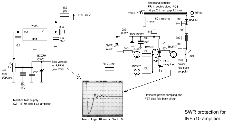

    The 5V6 zener diode is a protection that the voltage on the IRF520 gate does not exceed this value and does not fulfill any other function in this case.

    The problem with the schema deficiency is that the MOS-FET
    it works linearly in a narrow range of gate polarization.
    * 4.674 gate polarization [V] +/- 1.2%
    * stabilized voltage 5.1 - 5.6 [V] and to the voltage divider
    the above key conditions were not met in the system.
    The point linearity is floating.
    MOS-FET transistors, unlike Bipolar ones, work with voltage.
    voltage should not exceed in total Ugs 10 (15 *) [V]

    Suggested Gate Source voltage (Ugs) max 4.7 [V] at Uds 12 [V]
    What voltage do you have in your solution on the gate?
    With FQP13N06, PA M0RZF constructions (see IRF510)

    Few of the above-mentioned designs are better than the IRF510, you may be tempted to say that they are worse.
    As replacements? you can experiment to re-establish the dynamic parameters of the systems. Well, you have to recount the RLC circuits. taking into account the dynamic parameters of the substitutes.
