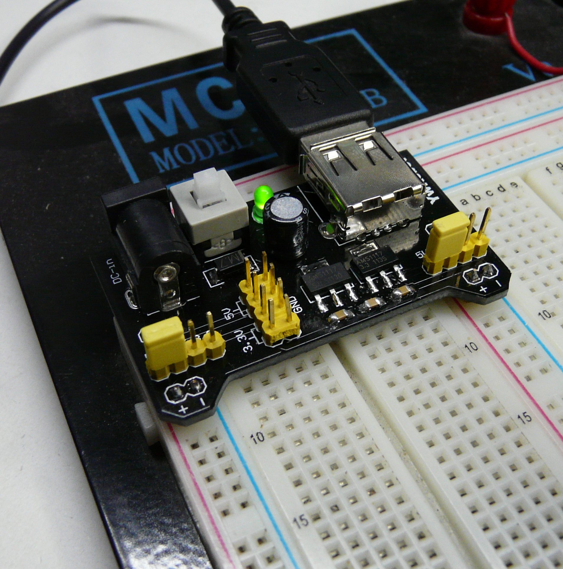

    I have tried powering the circuit from a module like the one below. On the internet many people have successfully powered their ESP8266 with this. I tried with 100nF and 220uF capacitors added - no result. Using a Pololu u1v10f3 inverter connected to a 1A power supply did not help either.

  • #6 15579383
    madejpm
    Posts: 13
    The ESP can pull a relatively high amount of current when booting, in excess of 200mA in a peak, and the contact board and cables can have a definite resistance (for power cables) and on the ESP itself in a peak the voltage can drop below the minimum. So test the voltage as close to the ESP as possible and make sure it's not too low.
    By the way, from my observations, before the peak comes, the ESP spits out 2-3 lines of normal boot messages.
    P.S. IMHO this is the ESP's biggest problem, the biggest current draw is right after power up and we have no power over that!
  • #7 15593027
    kamkov
    Posts: 36
    Everything was ok with the voltage, but there were none of those messages you mentioned.
    I bought a second such chip and everything is fine with the same power supply. It's just that I have a defective piece.
