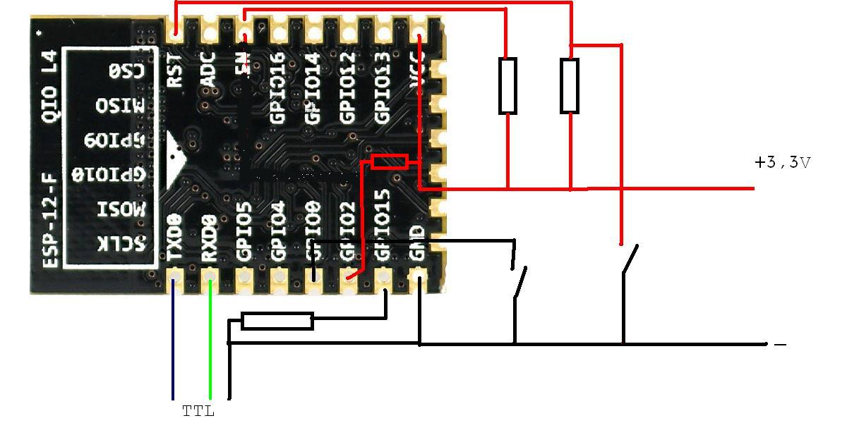

    According to the specifications I connect:
    GND - GND
    VCC - VCC (3.3v)
    RST - HIGH
    EN - HIGH
    GPIO15 - LOW
    GPIO0 - LOW
    GPIO2 - HIGH
    TX - RX
    RX - TX
    pull-ups done via 10k resistors, additional voltage source added and a capacitor on the power line close to the module.
    I'm trying to communicate by sending both end of line characters and I've checked on probably all possible speeds but every time it looks the same - on the converter (ftdi232) the led indicates sending data but the return is no longer visible.
    By changing the operating mode (e.g. to flash mode instead of uart download) you can see the change in current consumption, and in normal operating mode you can see the network created by the module and you can connect to it via wifi so it looks working.
    Finally I set the speed to 74880, which theoretically was supposed to show the logs of the boot process but also nothing arrives.
    What have I overlooked or am I doing wrong?

    • esp8266-12f - no communication via UART despite correct connection ESP 12f.jpg (65.01 KB) You must be logged in to download this attachment.

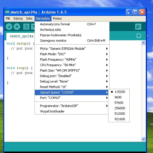

    I can't upload the program from the Arduino IDE.
    I have added a reset button, after resetting on the serial monitor only "bushes" pop up and nothing else. i have changed the speeds but also nothing helps.

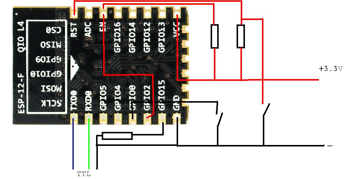

    I have connected like this:

    I did it like this:
    Unfortunately the same thing continues. :cry:

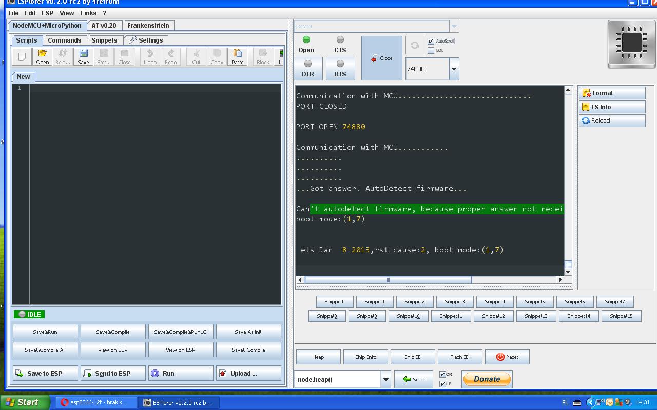

    On the Arduino IDE I have this message when sending the program.
    warning: espcomm_sync failed
    error: espcomm_open failed
    On Esplorer
    PORT OPEN 74880
    Communication with MCU...
    Got answer! AutoDetect firmware...
    Can't autodetect firmware, because proper answer not received.
    boot mode:( 3,6)
    ets Jan 8 2013,rst cause:2, boot mode:( 3,6)
    ets Jan 8 2013,rst cause:2, boot mode:( 1,6)
    mode:( 1,6) - is when I press reset when GIPO 0 - LOW
    mode:( 3,6) - is when I press reset when GIPO 0 - not connected

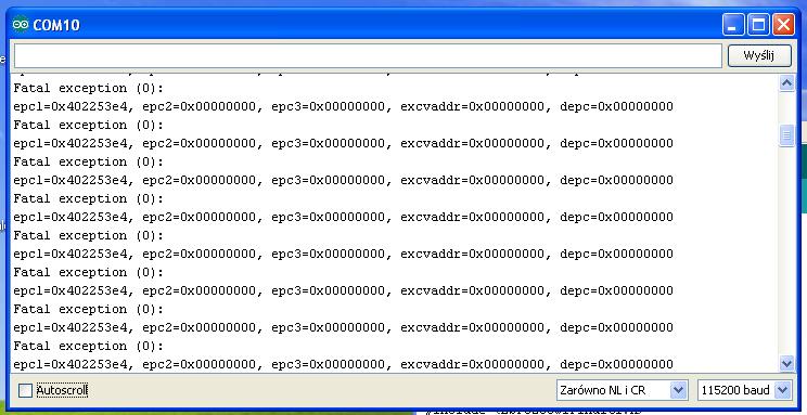

    I managed to get it working, the whole problem was with the power supply.
    I uploaded the program via the Arduino IDE.
    It worked for a day and after powering it off and powering it back on, it stopped working.
    I uploaded it again, but after starting it up I get this message on the serial monitor. esp8266-12f - no communication via UART despite correct connection
  • #11 15625520
    assist
    Posts: 23
    Hello, what are you powering the ESP from? It draws quite a lot of current on start up, maybe this is where the problem is?
    I had similar problems, the power supply (no name PRC) was the culprit.I swapped the power supply, added decoupling capacitors and it went:)
    greetings.

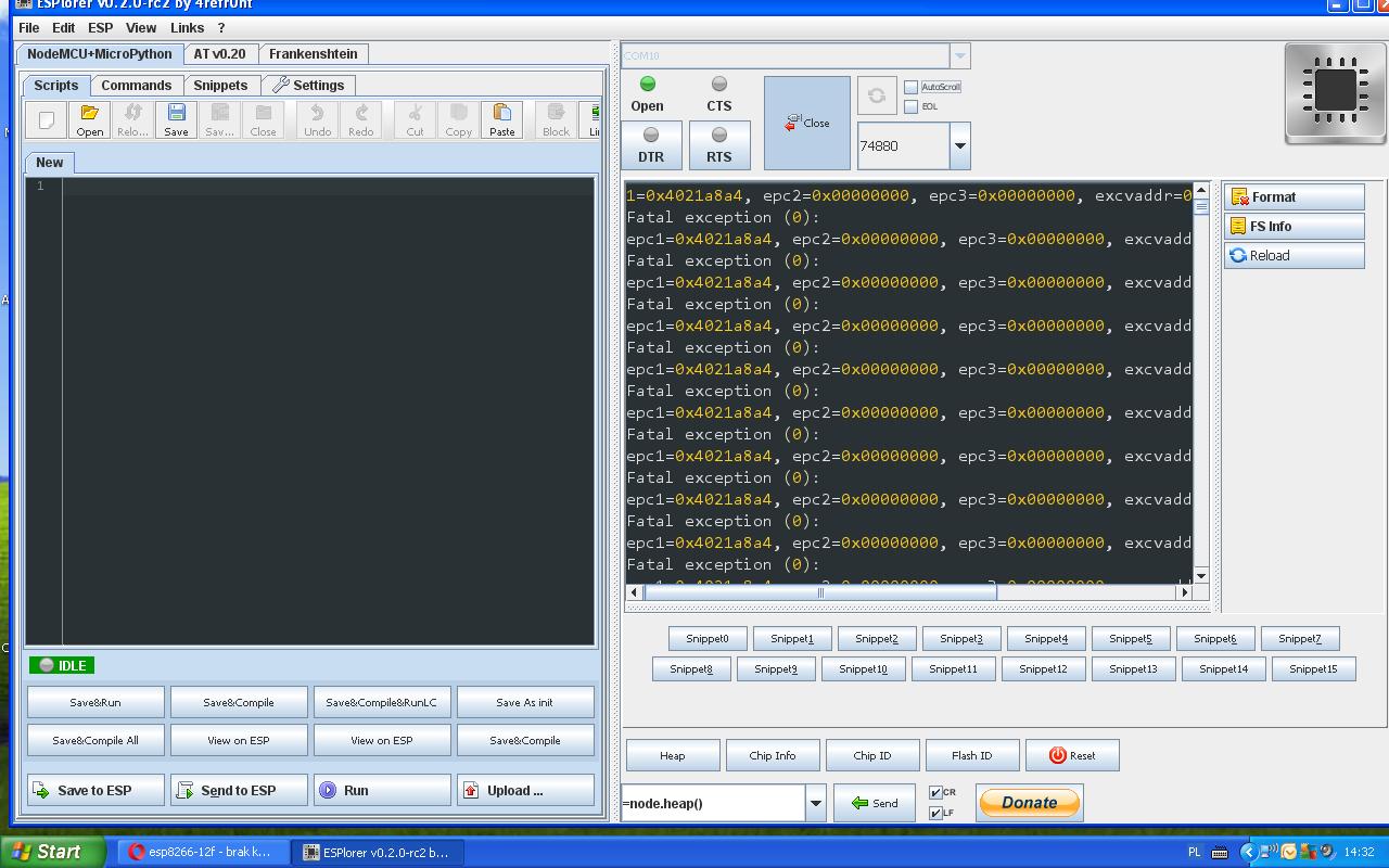

    oczkers wrote:
    Change the serial monitor speed to 74880 and reset esp - you will see logs of botting
    I cannot set this speed in the Arduino IDE. esp8266-12f - no communication via UART despite correct connection
    In ESPlorer I have given snapshots in the attachments.
    • esp8266-12f - no communication via UART despite correct connection besptol3.JPG (133.64 KB) You must be logged in to download this attachment.
    • esp8266-12f - no communication via UART despite correct connection besptol.JPG (132.94 KB) You must be logged in to download this attachment.
    • esp8266-12f - no communication via UART despite correct connection besptol2.JPG (165.04 KB) You must be logged in to download this attachment.

  • #19 15638718
    sebooool
    Posts: 11
    Or is it simply that the module is faulty?
    I have not been able to do anything with one module either.
  • #20 15642127
    globalinfo
    Posts: 430
    Rate: 30
    sebooool wrote:
    Maybe the module is just faulty?
    Well, I'm not sure if it is defective. The program loads, the messages also display to me, so the chip works, just something is wrong stored in memory.
    Maybe someone knows how to deal with this. :?: :D
