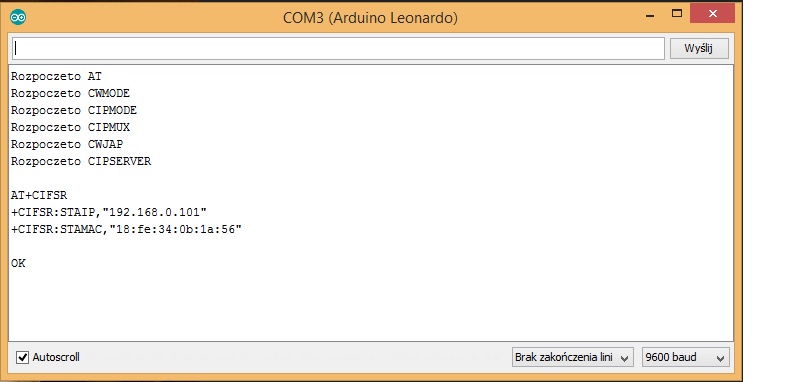

    Hi. I am working with a colleague in a team project and we are to make a communication via wi-fi with a flat control device. At the very beginning I would like to read the temperature from this system. I am in charge of writing the control application my colleague is in charge of the control system. My problem is that I cannot connect via the C# application to this server.
    Arduino code
    Code: C / C++
    [/code]
    C# code
    Code: C#
    After uploading to the Arduino that a friend lent me, the port monitor displays me something like this

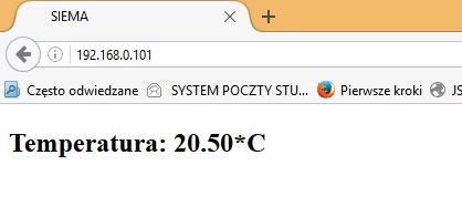

    In the browser I can see the result
