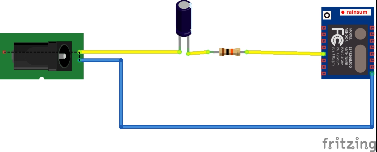

    Regarding your way of measuring the wavelength using a resistor and capacitor I have 2 questions:
    - is the microphone input enough? I have a laptop without a line input.
    - i have drawn out the circuit to make sure it is laid out correctly, can you confirm that it is ok? (there was no jack plug component available, so I added a socket instead)

  • #4 15828250
  • #5 15828298
    gnato
    Posts: 11
    More or less, that is, if I connect such a circuit I won't burn anything? :)
  • #6 15828308
  • #7 15834758

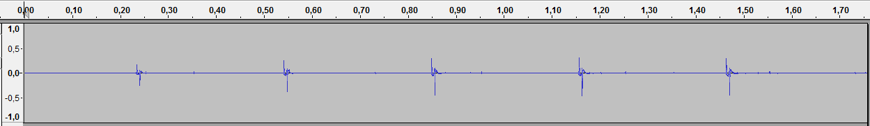

    The reading came out as follows:
    ESP8266 12e - How to connect the TOWER PRO MG90S servo correctly?

    gnato
    Posts: 11
    I recorded 2 files:
    1. alarm.wav - which is the result of calling a piece of code:
    Code: Lua
    2. pwm.wav - which is the result of the code piece:
    Code: Lua
    I think I've managed to capture the correct signal at some point (I've cut out the relevant bits). The only thing that puzzles me is why the signal wasn't recording all the way through. Is it a connection issue, or is it a matter of the esp somehow losing the set signal (which seems rather impossible to me, but as I'm a beginner I could probably be wrong).

    #11 15859259
