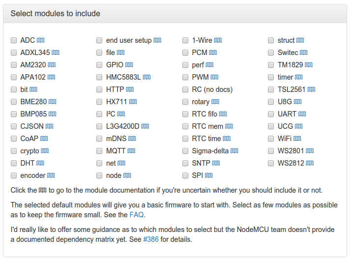

  • #13 15872877
    piterek-23
    Posts: 3321
    Help: 162
    Rate: 427
    piterek-23 wrote:
    Somewhere I saw a page where you can "build" your firmware, but now I can't find it.
    Got it... is HERE
    but what should I mark?
    [ESP8266] ESP8266 LUA - Problem sending full data to server
    piotr411 wrote:
    Instead of creating an array as you have now done, save it to "disk"
    This is what the code above is for
    This has already appealed to me, but I'm afraid I'm too thin for such "acrobatics" :(
    You are quick as lightning in your replies and read my mind :)
    #14 15872883
    piotr411
    Level 22  
    Posts: 483
    Help: 43
    Rate: 45
    SSL: false
    modules: file,gpio,http,i2c,net,node,rtcfifo,rtcmem,rtctime,tmr,uart,wifi
    in this configuration your program does not report problems after adding 10 variables, but every now and then it crashes for 2 minutes, something with the Timers you messed up
    File operations are child's play in LUA
    Almost identical to QBasic
    Here you have everything beautifully described about files, including simple examples
    http://nodemcu.readthedocs.io/en/master/en/modules/file/
