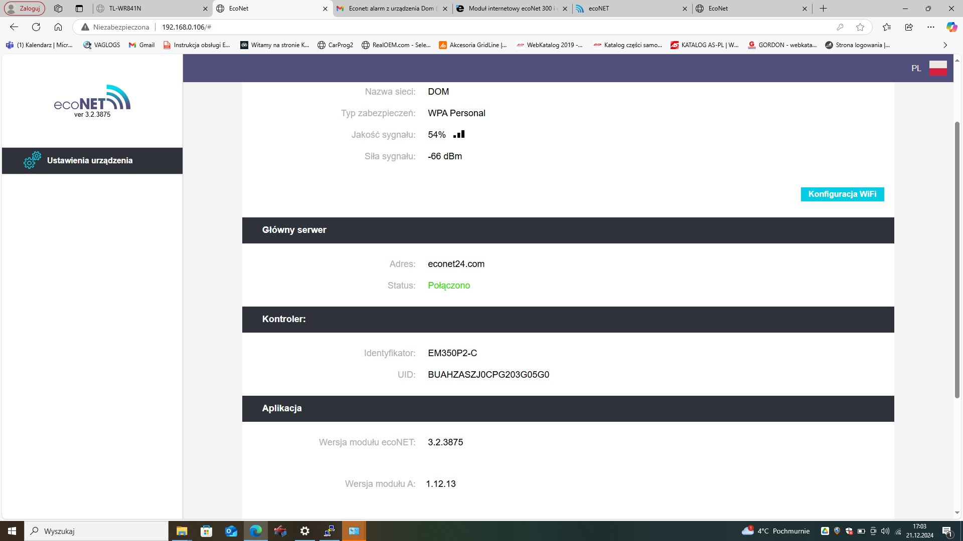

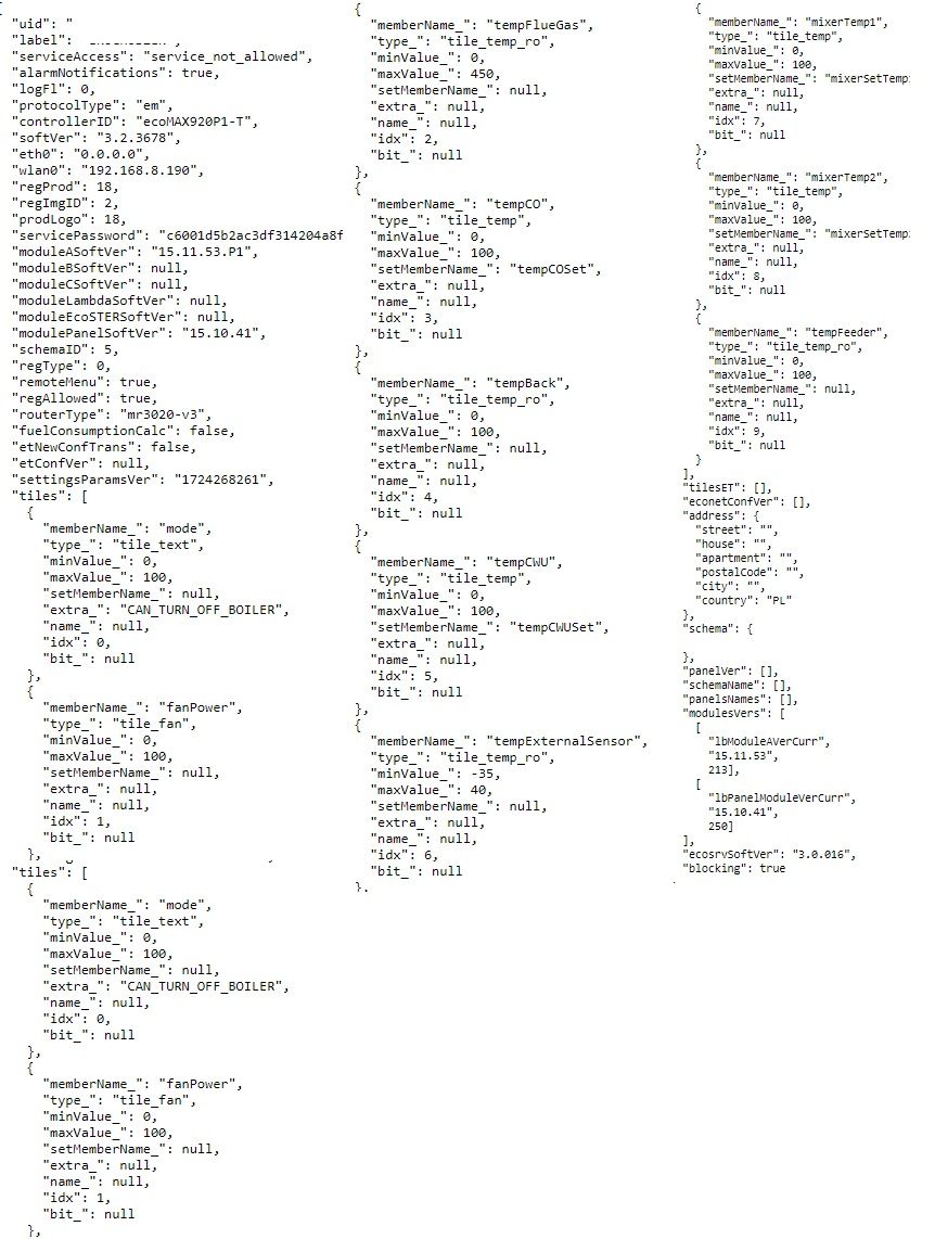

    @seba18 in post #482 you created a Plum .bin for direct install. It's the only image here that I've had any success with, however my Heat pump only seems to work with version 3678 and I think it's 3730 that you built into this version. Is there something else that you did to get this to work that is different from the WRT upgrade method?
    Unfortunately my heat pump was working well with 3678, but then I hit the upgrade button in econet, and it installed a later version. I've never been able to get back to a working version.
    I was naïve when I got my new heat pump, and automatically hit the "New software version available (3.2.3827)", and it's never worked since.

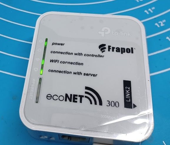

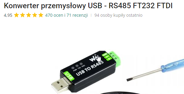

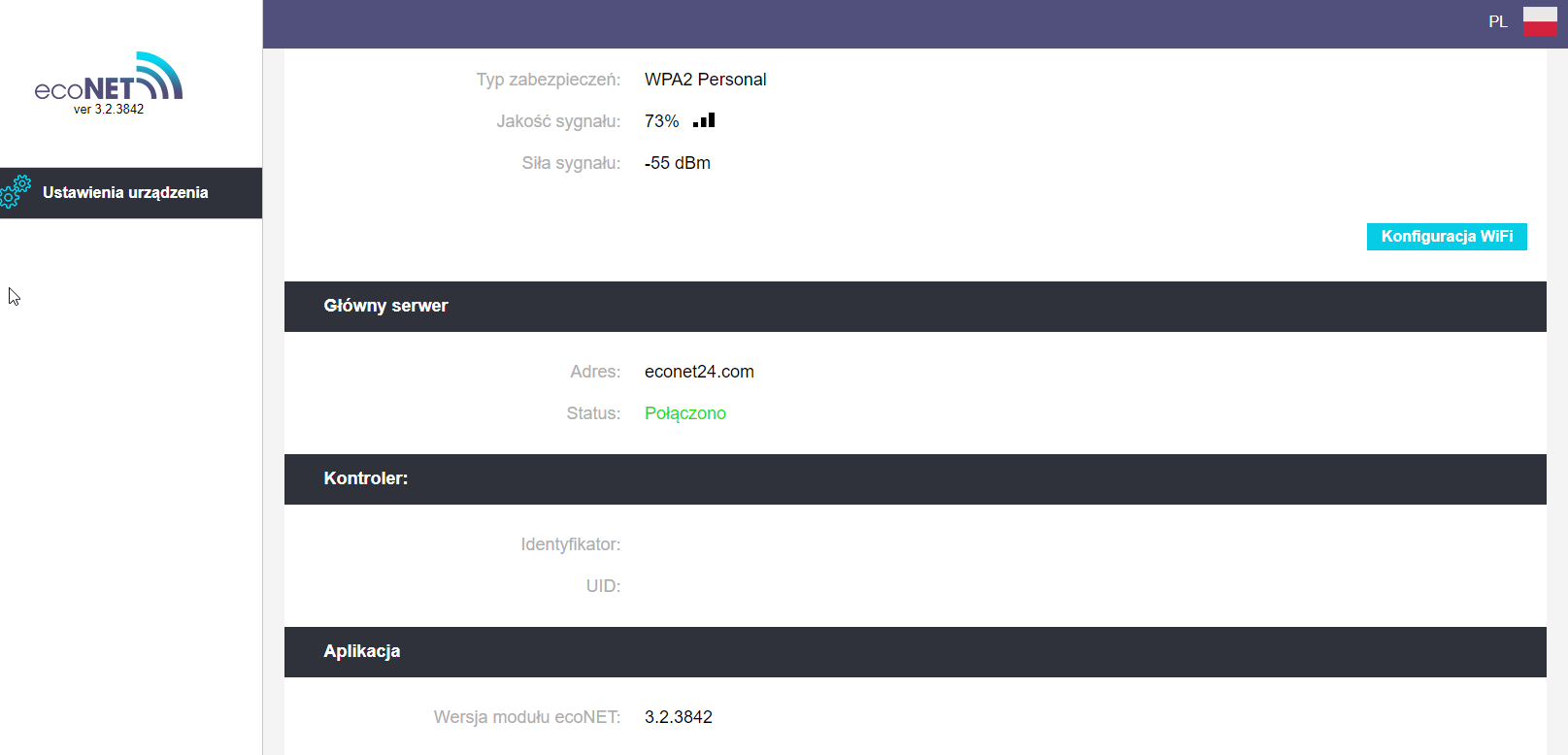

    I bought an econet300 as shown in the attached photo and USB TO RS485
    ecoNET 300 device by Frapol with three LED indicators on the casing showing connection status. USB to RS485 adapter with three indicator lights and screw terminals on a blue background.

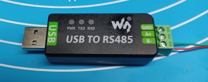

    USB to RS485 converter with screwdriver. .

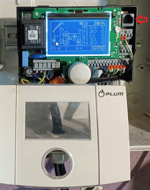

    I connected A and B- to the ecosol controller via RJ11.
    Plum controller with connected RJ11 cable, screen displays temperature parameters. .
    The green LED on the econet "connection with controller" blinked for a while, then went out.
    The browser does not show the ID or UID.
    ecoNET 3.2.3842 user interface showing server connection but no controller detection. .
    I tried swapping the A- wires with the B- wires, but it didn't do anything.
    What did I leave out ?
  • #516 21199485
    przemo_ns
    Posts: 58
    Rate: 17

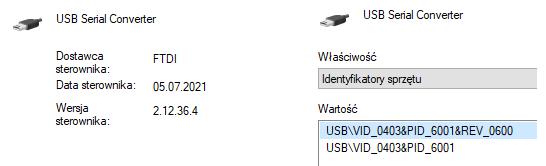

    Hook this converter up to the PC and give what vid and pid it has, something on the converter flashed as you had it plugged into the econet?
  • #517 21199879
    izumo
    Posts: 33
    VID_0403&PID_6001
    Screenshot showing information about a USB Serial Converter from FTDI.
    Only the TXD LED was flashing on the converter.
    Or maybe the econet also has to be PLUM and not FRAPOL ?
  • #518 21200578
    przemo_ns
    Posts: 58
    Rate: 17
    So, converter as it should be, plug it into some laptop instead of econet, fire up some serial port terminal and rip what comes in. Connection parameters: speed 115200, data bits 8, stop bits 1, parity none. I'm only surprised that it was flashing tx, as it should rather be flashing rx, with PLUMA the drivers are the masters on the bus.
  • #519 21200831
    izumo
    Posts: 33
    I used pins 2, 3 of the 4 pin RJ11 plug, assuming it would be RX TX. I couldn't actually find the RJ11 Ecolink2 pinout, so maybe my assumption is wrong and that's why I have a lack of communication.
    No communication at all, the terminal goes dead.
    I tried with GND pinned in, but also silence.

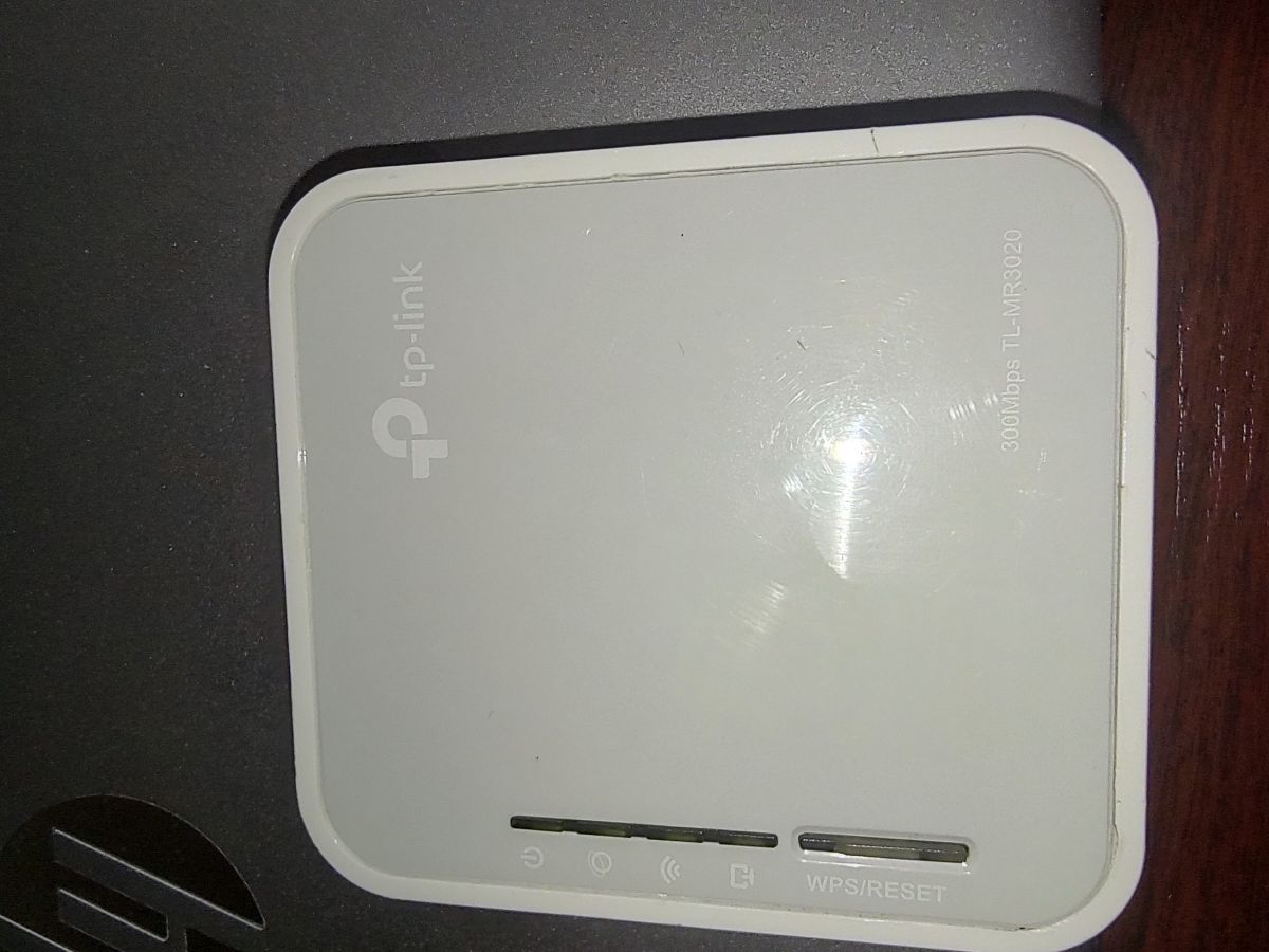

    I purchased a Tplink tl-mr3020 v3.2, then loaded the Open WRT and Econet 300 from one of the posts earlier onto it.
    I use DSD TECH USB to RJ12 6P4C RS232 SH-RJ12A serial cable with FTDI chip - ama***.co.uk/dp/B07R2L22GW to connect to the ecomax 360 controller for the KIPI burner.
    The LEDs on the Tplink show that it has a connection to the controller. Likewise the LEDs on the cable are blinking - mainly RX, but every now and then TX blinks. The econet GUI does not show the ID or UID of the controller, the burner controller does not show the econet information.
    Could I ask for advice if there is anything I can do to get the self-made econet to connect to the ecomax controller?

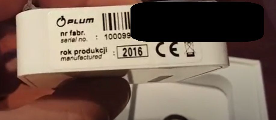

    Is there a serial number somewhere on the device that the manufacturer sticks on the device? I ask because I would like to use the old device (its serial and mac addresses) for the new router so that I have remote access to econet24
    At the moment I have managed to change the mac addresses from the old device :) but as above I do not know if the serial number is still checked somewhere

    Tomasz_192
    Posts: 14
    Hi, I have a question for you guys, after how long did it take for the module to start showing up in the app?
    I have a tp-link mr3020 made as my colleagues have done before and I am at the stage that the module has theoretically communication with the furnace, internet and servers but after creating an account the module does not show up in the app.
  • #537 21357661
    ravenn
    Posts: 319
    Help: 8
    Rate: 55
    Good morning to you.
    When I log in to econet via my local network, I can't see anything other than what is shown in the screenshot. On econet24.com it does not search for the controller.
    I have uploaded openwrt-ramips-mt76x8-tplink_tl-mr3020-v3-squashfs-tftp-recovery_ok
    and the bin from post #96.
    ecoNET settings screen showing WiFi connection and controller information.
    The controller is an ecomax350 as you can see it chats nicely with the econet, the burner is boiling.
    • Internet module ecoNet 300 and ecoLINK2 lokal.jpg (154.17 KB) You must be logged in to download this attachment.

    >>21359143 On the ecoNET module there is a sticker with a UID number, starting with 100....... (7 additional digits), which is what unlocks access to the base. Without this, no one is able to tell you, not even the manufacturer. Apparently every UID starts with 100 .... In PLUM no one adds them at the request of a single customer.
    Does anyone have knowledge where, after uploading the software to the MR-3020, the UID(PLUM's) is created or just stored somewhere in econet (something like it is in the picture)? If so, how to read it?
    We are talking here about the UID from the MR-3020, not the one from the furnace.
    Sticker with serial number on PLUM device; number starts with 100. .
