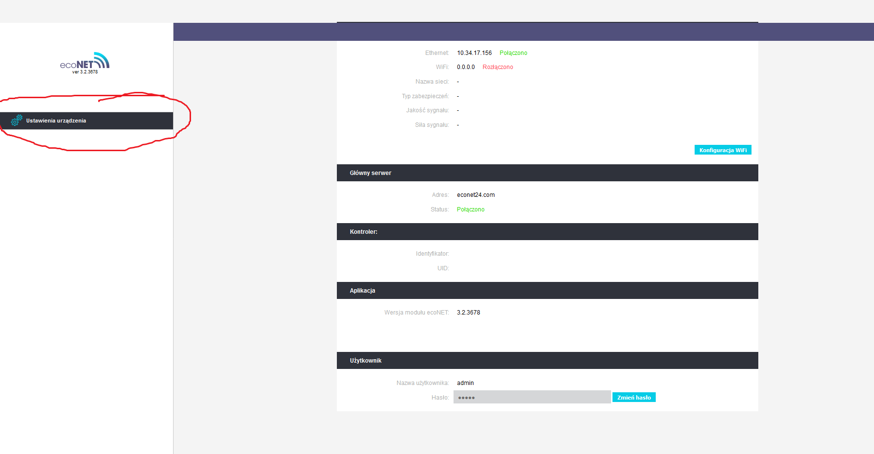

    In the end, I was able to connect the econet to the boiler, everything detected, but I have a problem with getting to the device after the spanking.
    When I click on these "Device settings" nothing happens, I can't enter it.
    Do you have that too?
    The picture is from an unconnected boiler, so don't pay attention to it.
    Normally the driver is connected and detected (there is info about the driver and UID)

    Yes, there's nothing going to do there

    Then I wonder how the original behaves?
