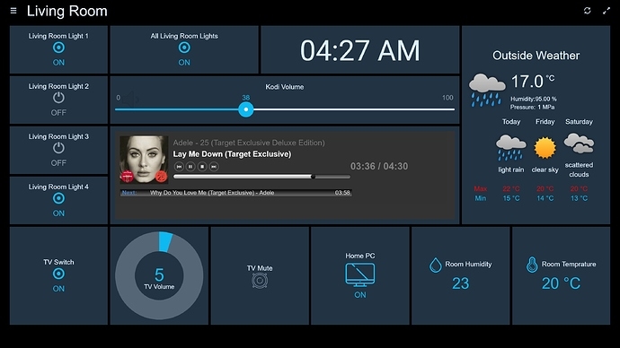

    I personally recommend a PLC for controlling sensitive circuits, and for integrating everything (air conditioners, multi-room audio, recuperation, boiler ipt) Openhab on RPI3 - www.openhab.org. I have had such an installation myself for 10 years and everything works just fine. For visualisation, e.g. imperihome Guide to choosing a smart building system using eHouse as an example .
    or built-in habpanel
    And also 3D visualisation
    https://community.openhab.org/t/proof-of-conc...-webgl-view-with-habpanel-sweet-home-3d/32995
    Openhab is free and supports most protocols from leading manufacturers.

    The eHouse Controllers and eHouse Server Pro can also be integrated with OpenHab, OpenRemote, Domoticz etc.
    It provides a number of methods for external integration (HTML REQUEST, MODBUS, TCP/IP Server, file system, etc.).
    eHouse Modbus integration .
    House HTML Request integration .
    As for the 3D and other visualisations there is one scowl.
    In a home comfort installation there may be several hundred smart points in the system (lighting points, sockets, inputs, outputs, etc).
    In the case of such visualisations, they are completely unreadable and non-functional.
    In the case of "block" installations - poor 1-2 points per room you can play around with "shadows", 3D etc.
    It is more functional to make a simple visualisation with a lot of points on one screen (at least for a floor or room).
    Otherwise, you would have to go through many screens to find out, for example, what is currently on or off
