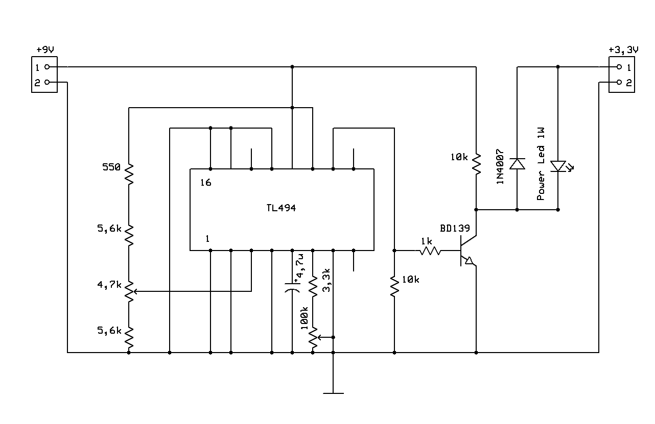

    Generator:
    The device uses a generator based on the TL494 chip. The structure includes an oscillator, the operating frequency of which depends on the value of RC elements on pins 5 and 6, and a comparator with emitter followers at the output. It is expanded with many other elements that give additional possibilities, but the designed device does not use any other than the previously mentioned. The principle of operation is typical. At the oscillator output, a sawtooth waveform is directed to the comparator input. The second input of the comparator is influenced by the control voltage (pin no.3). Depending on the value of the control voltage, there is a different actuation threshold of the comparator, the final effect of which is a square-wave output signal with an adjustable duty cycle (PWM). The drive voltage thus determines the pulse length in each period of the square wave output. With the help of resistors it is divided in such a way that the potentiometer changes the filling in the range from 5% to 95%. The frequency of the system can be changed smoothly in the range of 4-100Hz. The structure of the circuit includes a transistor at the comparator output, working as an emitter follower, which controls the BD139 executive transistor. A 1k resistor based on it causes the base current limitation, and 10k polarized one to ground, the other to the power supply plus, discharge parasitic capacitances, so that the waveforms based on the key and output are not distorted. The executive transistor works in a common emitter system. The 1N4007 diode at its output, connected in reverse, and in parallel to the operating LED, has negative pulses generated during the time when the transistor is not conducting.
    Schematic diagram of the generator:

    Sorry, there is something I don't understand. If a colleague wanted to build a non-contact tachometer, it was not easier to shine a laser on a glued reflection on a rotating element and count the reflected flashes through the phototransistor and the counter? So how do these types of tachometers work? I can't see the trigger system on the diagram, too, when working as a "car" strobe, the use of which is now pointless, in modern internal combustion engines with ECU? And the last thing - this type of LED used by Kolege as an illuminator has a lot light inertia Building a "fast" strobe on it is problematic to say the least.

    I used to use a simple strobe to set the ignition made of NE555 and a few white LEDs, it was used to set the ignition of mopeds where it was fine and it could be done quite well. The only drawback was the need to turn off the light due to the small amount of light from this toy.

    TL494 is probably an exaggeration. You can easily do it on the mentioned NE555 or one of Schmitt's goals. You don't actually see how the TL494 is synchronized.
    The frequency meter can be done on one microcontroller. The measurement will last as long as the signal period, and you don't need to wait a second or 10 when you want to be accurate to 0.1Hz.
    Why a power supply on operational amplifiers? No protection against short circuit, overload, overheating. Short circuit protection is one resistor and a diode! But why build stabilizers, the LM78xx could not be used?

    TL 494 is not synchronized, the measurement is made by using the strobe effect of standing still. You set the LED blinking frequency with the potentiometer until the marker on the flywheel illuminated by this LED stops moving and on the frequency meter you read the frequency of the generator, which is equal to revolutions per minute. The accuracy of the human eye, but in the automotive industry it is enough. You don't need lasers.
    For the LM78xx, as suggested by the microprocessor, the voltage difference (3V) is needed for proper operation. In this case, the supply of minimum 10V, stabilized voltage of 9V, the condition will not be met for 9V.

    R-MIK you are right, but the microprocessor is wrong. I was quietly hoping he would improve on LDO. And then I will say that the TL494 has an internal V-ref 5V PIN 14 stabilizer, and it can be powered from 7 to 40V - PIN12. So why the 9V?

    9V for the generator. The TL494 datasheet indicates the minimum recommended voltage of 7V. So it may not be 5V.
    Joker2: You didn't understand. The TL494 power supply is from 7V to 40V, so a stabilized 9V source is not needed because you assume the system will work in the range of 10-15V (automotive installation). You just feed it through a simple filter from the car's installation.
    In addition, the system has led out ext. stabilized source with a capacity of 10mA, it is enough as a reference voltage for frequency control, and as a reference voltage of stabilizer amplifiers, so TL413 will also be redundant and that's it.
    Correct the LED on the generator diagram. :idea:
    You're right. This would simplify the deal. Thank you for the substantive comment and pointing to the error in the diagram (I have already corrected it).

Why isn’t LED light-decay a problem below 100 Hz?
A white power LED’s rise/fall time is under 1 µs; at 100 Hz the pulse lasts 5 ms, so inertia is negligible. Users report clear freezing of a 3 600 rpm disc at 60 Hz [Elektroda, Joker2, post #16779482]
How do I convert the meter reading from hertz to RPM?
Multiply by 60. For example, 60 Hz equals 3 600 RPM. The author calibrated the drill test exactly this way [Elektroda, Joker2, post #16779482]
Can I trigger flashes directly from a spark-plug lead?
Yes. Couple the HV pulse through a capacitive probe or an off-the-shelf HT25 clip; clamp the amplitude to 5 V before the BD139 gate [Elektroda, Joker2, post #16779482]
What accuracy can I expect?
The AVT-2269 counter claims ±0.1 % + 1 digit. In practice, the quartz-derived 32.768 kHz clock held error under 0.05 % against a TCXO reference [Elektroda, Joker2, post #16773141]
Edge case: what happens if the counter sees more than 5 V?
If the supply creeps above 5.5 V, the counter latches and stops updating until power cycles—a known failure mode [Elektroda, Joker2, post #16773141]
Could a microcontroller replace the discrete counter?
Yes. One 8-bit MCU with a timer input measures frequency within one period, giving sub-0.1 Hz resolution instantly. It also shrinks PCB area and adds serial output [“AN2503—Timer Capture”, STMicro, 2022].
Why use operational-amplifier regulators instead of LM78xx?
The design needed 9 V with ≤1 V dropout. Standard LM7809 drops 2-3 V, failing on a 10.5 V battery. The op-amp feedback regulator holds rails tighter under LED current spikes [Elektroda, tomus2k, post #16774354]
How do I actually set ignition advance with this tool?
  1. Paint a 0° TDC and a 17° BTDC mark on the crank pulley.
  2. Clip the HT probe to cylinder-1 lead; aim the strobe at marks.
  3. Turn the distributor until the 17° mark freezes under the flash, then tighten it. Done – timing now matches 17° BTDC. "A three-minute tweak beats a roadside tow" [Elektroda, web69, post #16777172]
Does the circuit survive a direct LED short?
A fast-blow fuse in series with the 3.3 V rail limits damage; without it, BD139 and the LED can fail within milliseconds at 10 A fault current [Elektroda, Joker2, post #16774933]
Is a laser tachometer more accurate?
Commercial laser tachs resolve 0.05 % and work without reflective paint above 20 mm distance [Fluke, 2021]. However, the strobe costs under US $15 and suffices for non-ECU engines, as one user noted [Elektroda, Euzebiusz23091998, post #16773434]
Can I power everything from a single 5 V buck module?
Yes if you replace the TL494 with a rail-to-rail timer and drive the LED through a constant-current switch. Ensure at least 800 mA peak capacity to cover 300 mA LED plus inrush [Texas Instruments, 2023].
What duty-cycle range is safe for the LED?
Set duty between 5 % and 50 %. At 50 %, junction temperature remains below 80 °C on a 25 °C/W heatsink and 25 °C ambient [Cree, 2023].
How bright is a 1 W LED compared to a xenon strobe?
A 1 W LED delivers about 38 lm; a handheld xenon timing light emits 200–250 lm, five to six times brighter but needs bulky capacitors [“Automotive Xenon Timing Lights”, Bosch].
