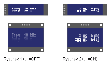

  • Układ działa także bez wykrytego OLED, a po starcie z J1 (FLIP) zwiera obraz o 180°; zasilanie może wynosić 2.7–5.5 V.

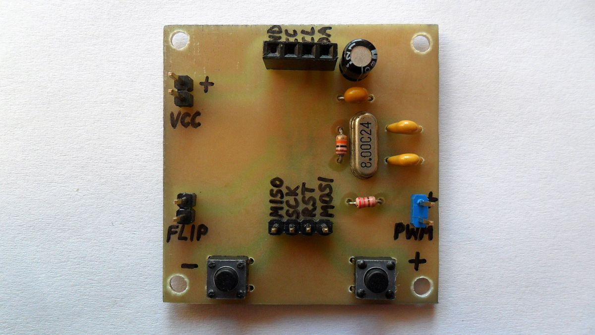

  • Simple PWM generator with OLED display on a circuit board.
    A simple PWM (Pulse-Width Modulation) generator built on an ATtiny24/44/84 microcontroller, supplied with stabilised voltage Vcc=2.7-5.5V (2.4-5.5V if using the "A"/"V" version of the microcontroller). Its output produces a rectangular signal with a selected fixed frequency of 1.25/10/80 kHz and a filling adjustable in the range 0-100%, in 1% steps. The parameters of the output signal are presented on a monochrome OLED display (SSD1306 controller, I2C bus), with a resolution of 128x32/128x64 pixels and address $78 ($3C)/$7A ($3D). I wrote the control program in assembler and it is identical for each of the microcontrollers mentioned.

    Two OLED screens displaying PWM parameters: one normally, the other rotated 180 degrees.

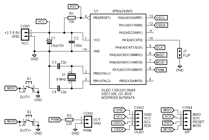

    Rate: 102
    It is not protected in any way against reverse connection of the Vcc supply voltage. Mistaking the polarity of this voltage will damage the microcontroller
    Then why not add at least a "one leg on plus" Schottky diode? The voltage drop is small and the whole circuit - saved. Or cut one of the power supply paths and solder such a diode there elegantly on the surface.

    >>21435861 With such a low supply it's a pity to lose that 0.3 - 0.5V rally so it's better to give a P-MOS on the supply, no voltage drop. If you don't know how to do it, just type in google : "reverse polarity protection mosfet" and look in the graphic, for this voltage you only need 1 element, it is important that it is low voltage/ logic-level For more current-hungry circuits I use for example the AO3413. Wholesale it costs pennies, in retail it doesn't make a tragedy either.
    Of course, I approve my own construction and these 3 fixed frequencies suggest a specific purpose, so it is possible to understand the construction of such a circuit, because otherwise, the cost of a ready-made one is a dozen or so zlotys (well, with shipping max 29 zlotys)

    It serves the same purpose as a generator with a million frequencies - its usefulness only depends on which specific frequencies the user needs. If someone just happens to need a PWM signal with a frequency of 1.25/10/80 kHz, then this generator is perfect for them ;) The output signal has pretty good performance. The oscilloscope shows steep slopes, a nominal fill value to 2 decimal places (the third digit changes) and an equally accurate frequency, which of course depends on the quartz resonator used.
    >>21435861 .
    As much as possible, a protection diode could be used, but I have dispensed with it precisely to avoid a voltage drop of more than 200mV, which can be important especially at low supply voltages. In the previous version, I used a low-voltage MOSFET transistor as protection - I have now omitted it to avoid complicating the circuit unnecessarily. I have assumed that it is not allowed to go wrong - after all, it's only two wires, what can go wrong? ;)

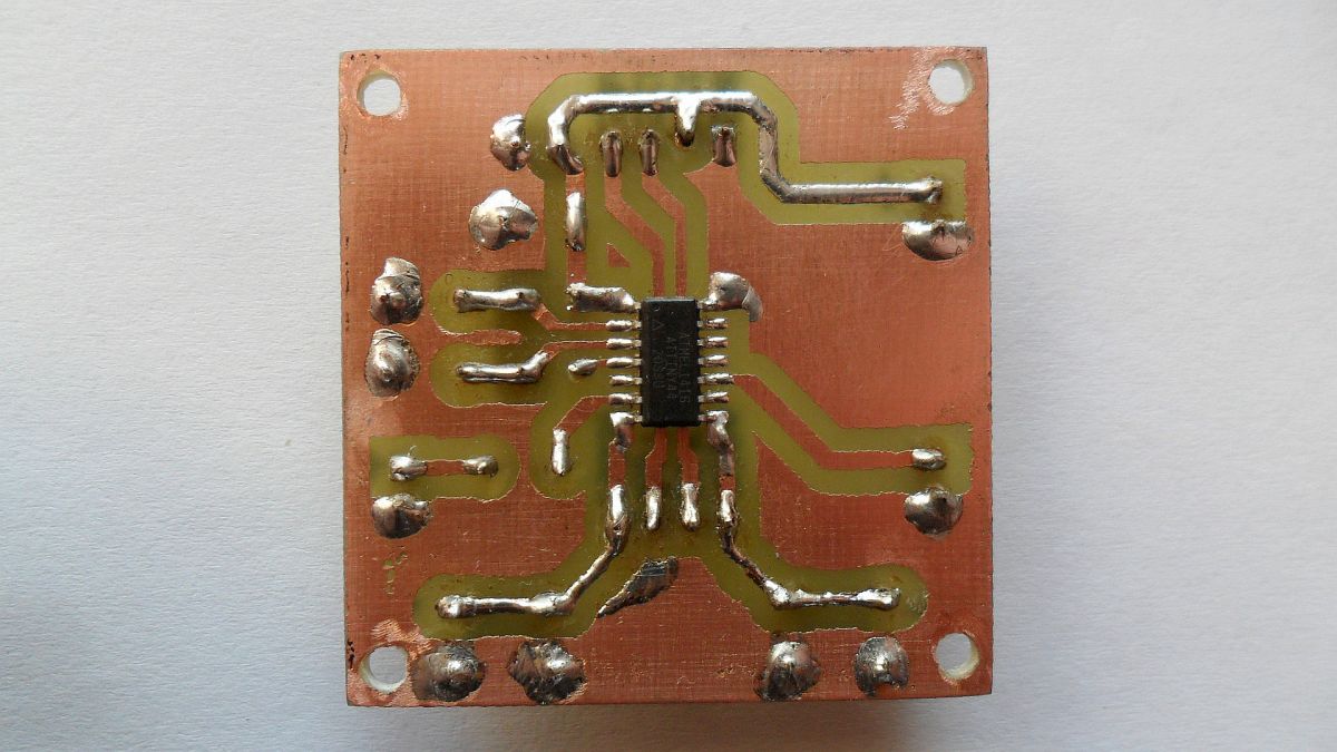

    I bow to those writing in assembler....
    I've been watching your projects for a while now. The boards look like they were made with a thermal transfer. And here is a "cosmetic" question. Why don't you print descriptions on the PCB side of the components? The look of the devices would certainly benefit.
  • Prototype PCB omits silkscreen to save time

    The plates look like they were done with a thermal transfer.
    I don't use thermal transfer, which would probably come out nicer, although it also depends on the quality of the toner. I use chemical transfer (cold) without using an iron, which I last held in my hands somewhere in my primary school days when I tried to iron clothes.
    Because I'm making one prototype board for myself and nice markings don't matter to me, but the time spent to make them does. It's quicker and easier to write the necessary markings with a marker pen, rather than messing around with an extra transfer that won't change anything about the performance of the device anyway.

    Why didn't you give some sort of voltage follower on the outputs?
    RomanWorkshop wrote:
    After any frequency change, the initial fill value of the signal is always 50% (regardless of the previous setting).
    That is, glitch. This is a feature of assembler programs - the authors don't want to correct them after a bout with the program, because then there is a good chance of a new one
    It is not protected in any way against reverse connection of the Vcc supply voltage. Mistaking the polarity of this voltage will damage the microcontroller.
    glitches.
    Why present an underdeveloped design?

    >>21437638 .
    Why didn't you give some voltage follower on the outputs?
    I don't need the output buffer.
    So glitch. It's a feature of assembler programs - authors don't want to fix them after fighting the program, because then there's a good chance of a new one
    Interesting theory, but completely wrong. It's not any glitch that needs correcting just that was my assumption, to be in the middle of the fill level adjustment range after a frequency change. In order for the initial fill value to be different or remain unchanged after a frequency change, you only need to modify or remove one 2-byte instruction (I encourage you to analyse the very short and simple program code).
    Writing programs in assembler is a struggle? For me it is sheer pleasure - creating new routines, fitting them into the overall code, or optimising them by even 2 bytes gives great satisfaction. In assembler you have full control and can change everything, almost like in the Matrix ;) .
    glitches.
    I don't need reverse polarity protection either.
    Why present an underdeveloped project?
    For me, this project is fully working and completed at this point, which does not mean that everyone will like the solutions I have adopted. Therefore, the project is made available with sources and anyone who sees something useful in it can change it to suit their needs.
    Still apropos of those recently popular glitches - the PWM signal is generated entirely in hardware by timer/counter TC0, which operates in "Fast PWM" mode. In this mode, double buffering of the OCR0x registers is active, which only allows their value to change when the counter reaches the top/bottom count value. This prevents asymmetrical PWM pulses of odd length from appearing on the output, so that the output signal is free of noise (glitches). Thank you for your attention.

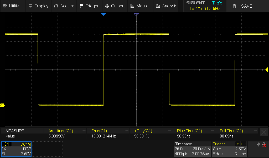

    Are you able to show off your oscilloscope measurement ? What is the actual signal at the given frequencies and pwm.
    As soon as I have time and still have the oscilloscope made available to me (Siglent SDS824X HD - nice equipment, but I have no comparison, e.g. with cheaper models), I will make measurements and screenshots as much as possible.
  • Measured 5.04 V PWM output with 90 ns edges

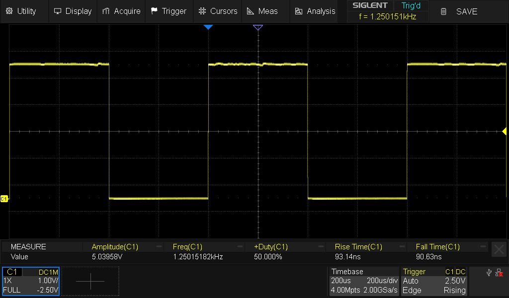

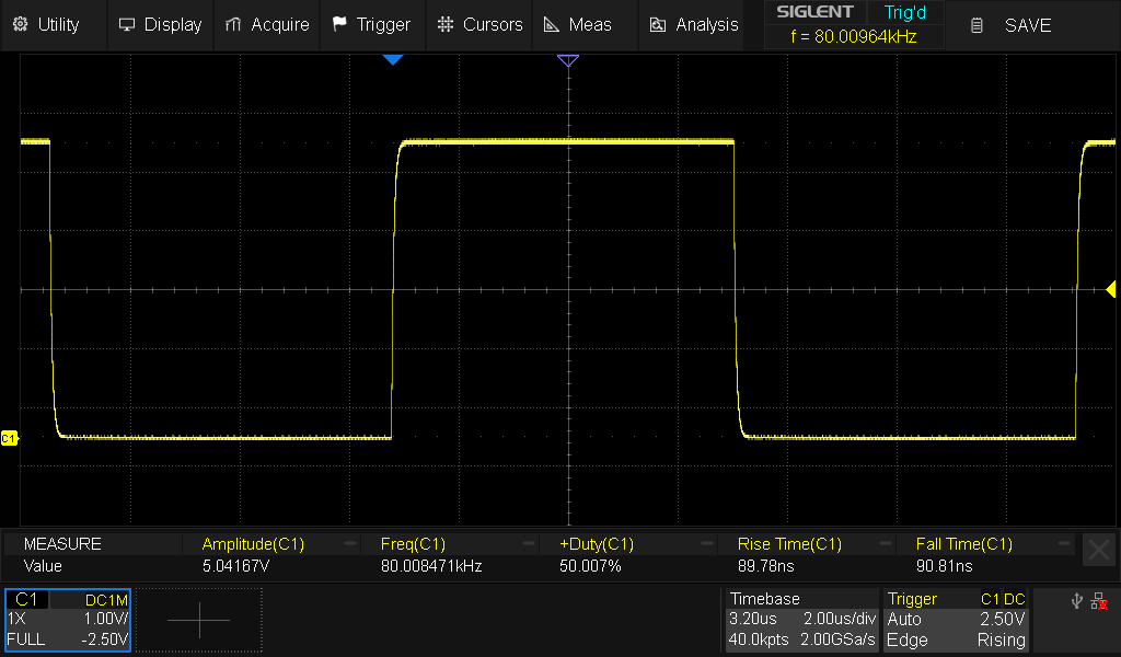

    >>21437830 .
    I took measurements of the output signal from a generator supplied with Vcc=5.0V, using a Siglent SDS824X HD oscilloscope (1x probe, 2GSa/s sampling). At each output frequency and when set to any fill level in the 1-99% range, the output signal had a uniform level of about 5.04V, a nominal fill/frequency value to 2 decimal places and similar rise/fall edge times of about 90ns.
    Square wave signal 5V on a Siglent SDS824X HD oscilloscope Oscilloscope screen showing a rectangular waveform with amplitude 5.03958 V and frequency 10.001214 kHz. Oscilloscope screen showing a square wave with amplitude 5.04167V, frequency 80.00964 kHz, with rise and fall times around 90 ns. .

Connect an SSD1306 OLED over I2C using GND, VCC, SCL, SDA in that exact module pin order. The project supports 128x32 and 128x64 pixel displays and checks addresses 0x3C and 0x3D. The board does not include pull-up resistors for the OLED I2C lines because the display module already contains them, and the minimum supply needed for the OLED itself is about 1.8 V at low brightness. [#21435356]
Why is a 128x64 SSD1306 OLED treated as 128x32 in this project, and why do blank horizontal lines appear on the display?
It happens because the software renders only a 128x32 image area even when a 128x64 module is attached. The designer states that a 128x64 display is treated as 128x32, so every second horizontal line stays blank. That creates 1-line horizontal gaps and makes the visible image appear stretched vertically instead of fully using the taller panel. [#21435356]
What happens if the OLED display is not detected at startup in this ATtiny24 PWM generator, and how can I troubleshoot it?
The generator still works normally without the OLED if startup detection fails. Check three things first: 1. confirm the OLED uses address 0x3C or 0x3D; 2. verify pin order is GND, VCC, SCL, SDA; 3. make sure the module provides I2C pull-ups, because this board does not. The thread also notes the generator searches for the display on 78h and then 7Ah, which correspond to those two 7-bit I2C addresses. [#21447109]
