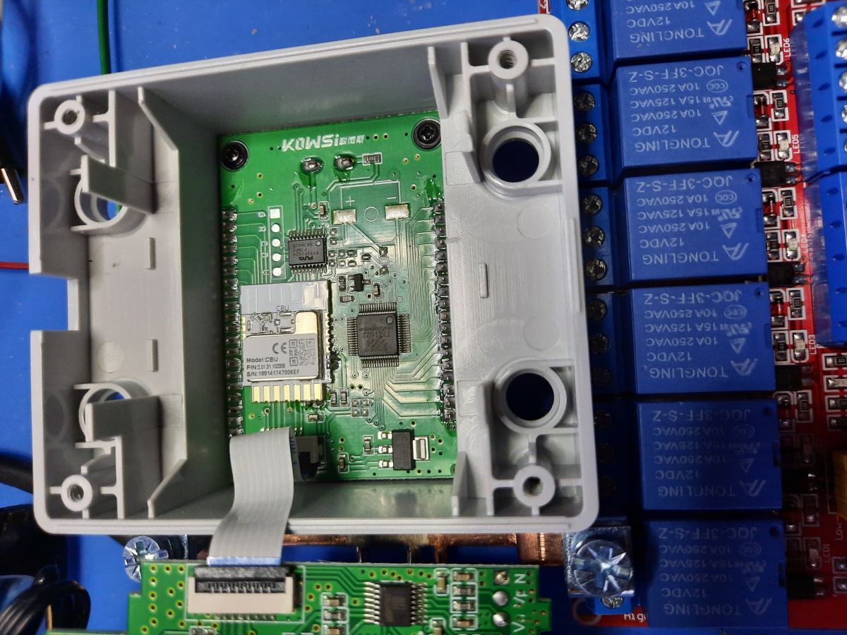

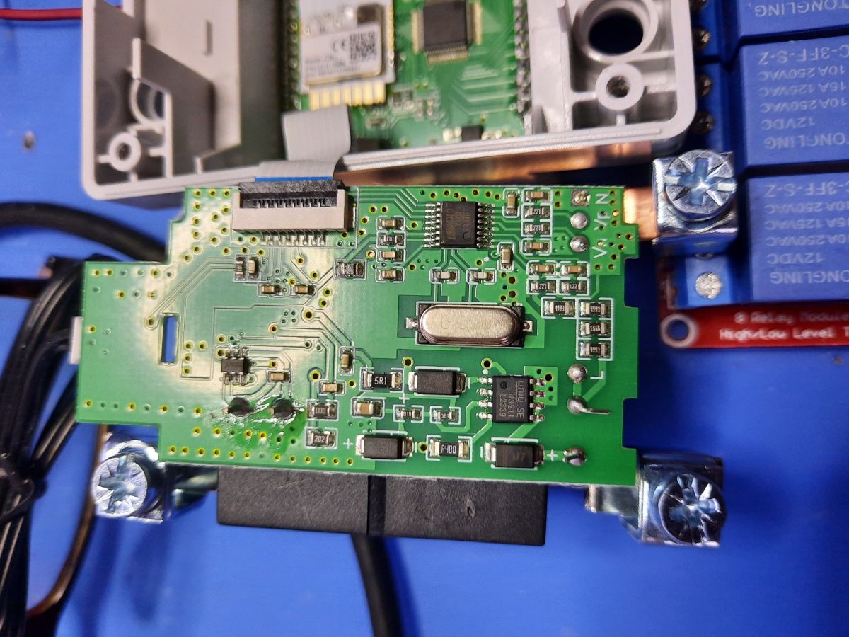

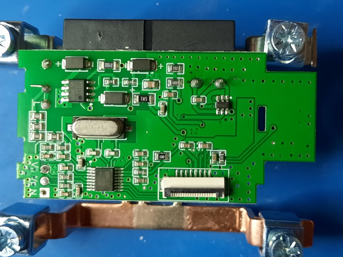

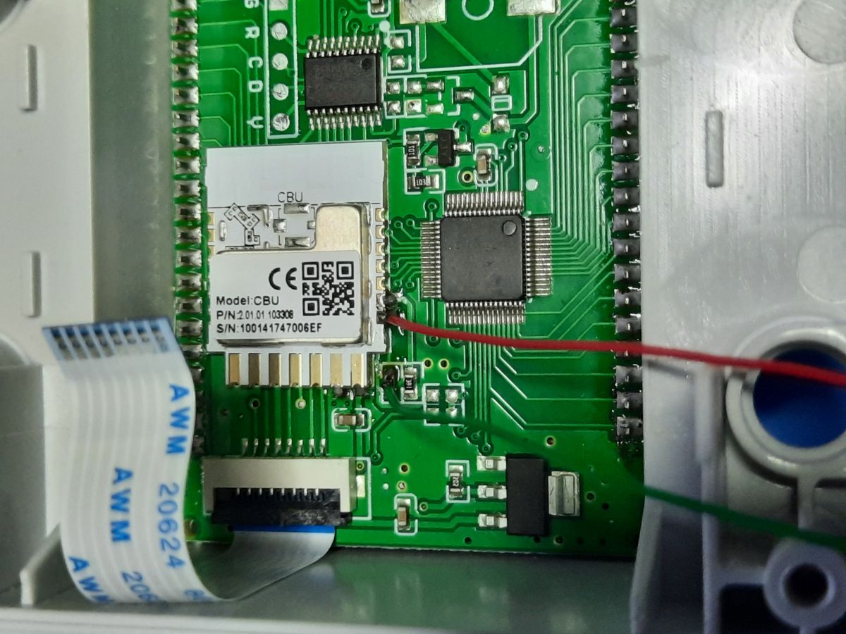

    Hi,
    This is my first post in the forum, so apologize if something is out of the rules.

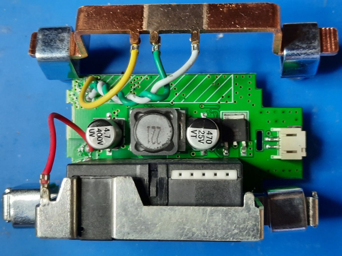

    Recently I bought one Power Meter KWS-302WF and didn't like the way it used to current measuring. So I dismantled the device to see if I'm able to change from shunt to transformer.
    This is the beginning of the story.

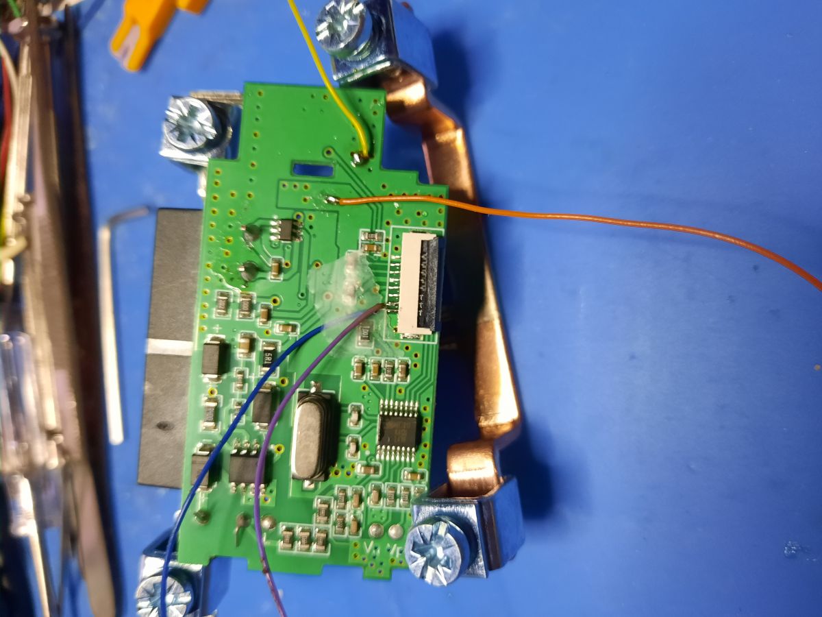

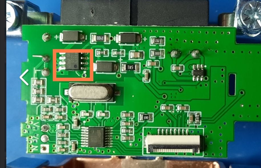

    I saw the measuring chip is an HT7017 from HitrendTech, which is handled by a PY32F002A, by it turn gives the commands to a TM1622 which handles the display.
    The WiFi chip is a CBU (BK7231N ?) connected to PY32F.
    I made some soldering work and intercepted the communications between the CBU and the PY32F (and also between this one and the HT7017).
    Following there are some photos and some files with the comm data.
    Let see if this will be useful to change the firmware in the CBU ...
    KWS-302WF power meter with digital display and Wi-Fi remote control feature.
    Close-up of the electronics inside a power meter, showing the CBU module and other components. Close-up of a disassembled KWS-302WF power meter with a visible circuit board. Photo of a disassembled KWS-302WF power meter revealing the circuit board and components. Circuit board of the KWS-302WF power meter with visible electronic components. The image shows an open KWS-302WF power meter with a visible circuit board and electronic components. Interior of the KWS-302WF power meter featuring visible integrated circuits and a CBU WiFi module.
    • comm between CBU to and from PY32F.zip (1.04 MB) You must be logged in to download this attachment.

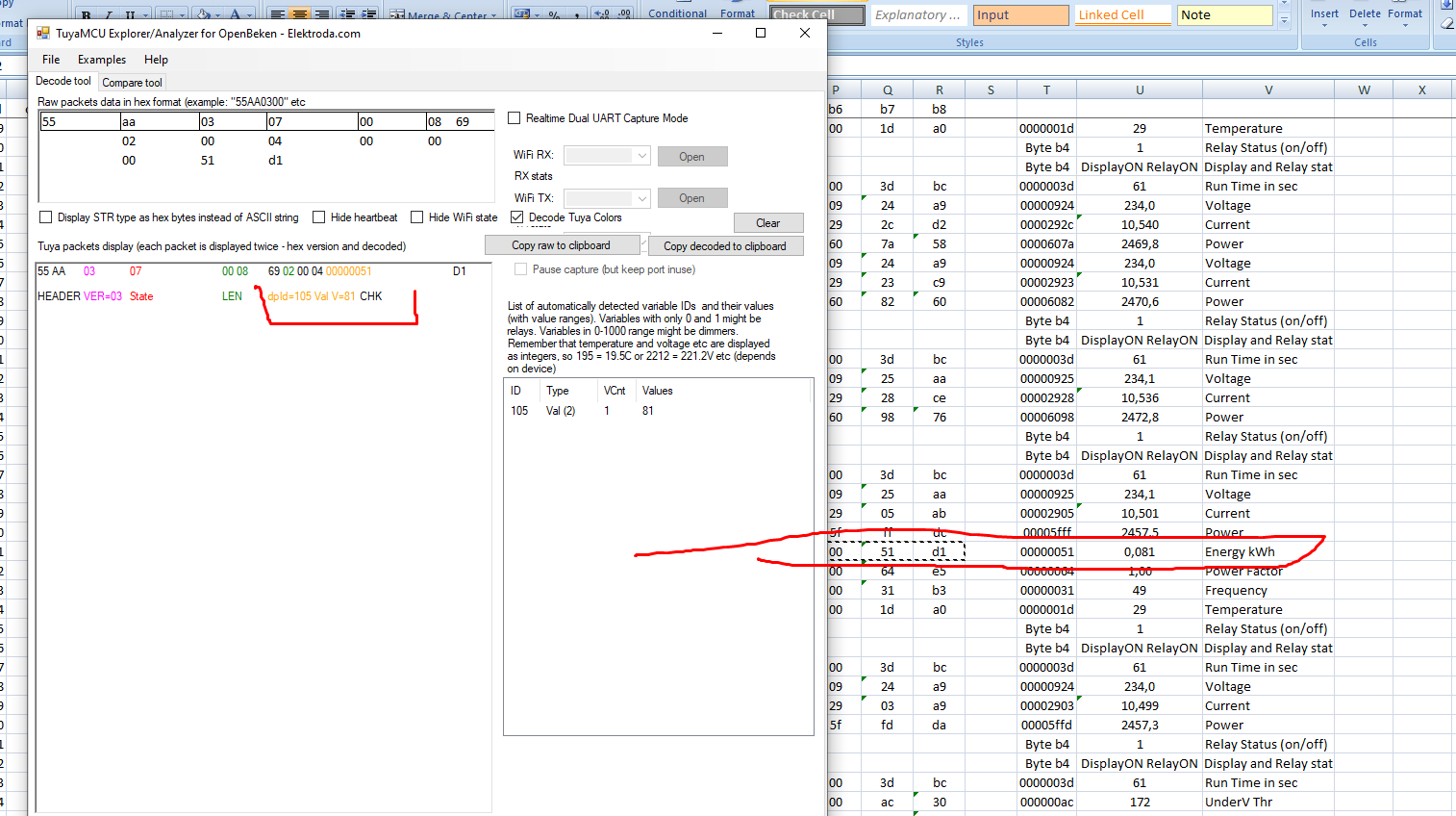

    This xlsx file is a very good and professional job. You've done it very well. It can certainly help. Your doc may seem to be missing the dpIDs, but I think you can use this tool for that:
    Screenshot of TuyaMCU Explorer/Analyzer tool and Excel spreadsheet.
    See: https://www.elektroda.com/rtvforum/topic3970199.html
    Then your data can be used to change CBU firmware, for details, see TuyaMCU guide:
    https://www.elektroda.com/rtvforum/topic4038151.html
    Was this captured at 9600 baud or 115200?
    Make sure to create 2MB flash backup and to read the TuyaMCU guide first to get some generic information.
    You can also check autoexec.bat samples here:
    Remember that you may need to sever UART connection in order to flash the device, because the same UART port which is used for flashing is also used for TuyaMCU communications.
    Here is our flasher:
    Regarding shunt change - this may be very hard because PY32F002A is in charge of most of the stuff. You would need to somehow change the firmware of PY32F002A I guess. PY32F002A is already reporting measurements to the WiFi module via UART, so I don't think you can apply shunt change on WiFi module. But you probably already know that...
    TM1622 is also very interesting for me, but again, in this case, TM1622 is handled by PY32F002A so you shouldn't worry about that. We're always changing just firmware of the WiFi module, not of the MCU. Still, OBK can already driver TM1650 and TM1637/TM1638 and similiar directly, so if there is a need, I could also get somehow a TM1622 driver working as well.
    Is your goal just a firmware change or do you also want to change that shunt?
  • HT7017 runs at 4800 bps, CBU at 115200 bps

    Lusant wrote:
    I explain why, I'm new in this stuff of HA and giving the firsts steps, so it is my "feeling" that this ID can be used to Tuya block my device ... sorry if this is a big mistake.
    Impossible. Once you flash OpenBeken, Tuya has no access at all.
    Lusant wrote:
    The communication between HT7017 and the PY32F is 4800 bps.
    The communication between CBU and the PY32F is 115200 bps
    By TuyaMCU communication we mean between WiFi module and MCU, so 115200. You will need to include it into your autoexec.bat . I hope you can read a bit more about autoexec.bat in the TuyaMCU guide I mentioned.

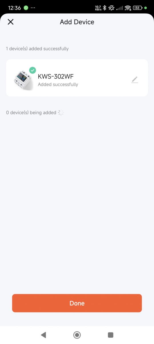

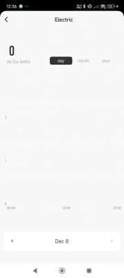

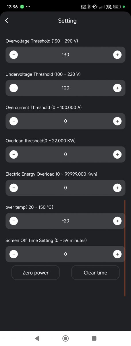

  • Firmware backup reveals Tuya device config and keys
    #9 21338456
    Posts: 5215
    Help: 448
    Rate: 917

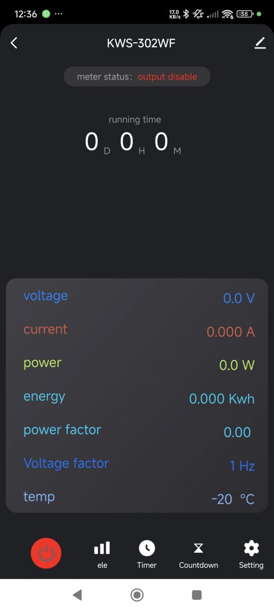

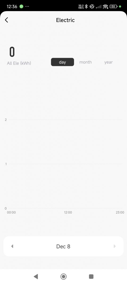

    @Lusant kindly sent me the firmware backup for sanitisation and info extraction. I attach the result of that for anyone's interest with this device.
    storage data:
    Tuya app paired images:
    Tuya app screen displaying the added device KWS-302WF. Settings screen of an app for managing an electrical device. Mobile app interface with a countdown timer setting. Tuya app screen with No timer data message and Add button. Tuya app screen displaying electric consumption with a zero reading. App screen showing the status of the KWS-302WF energy meter with output disabled.
    boot log:
    • readResult_BK7231N_QIO_kws302_2024-08-12-12-18-44.bin (2 MB) You must be logged in to download this attachment.

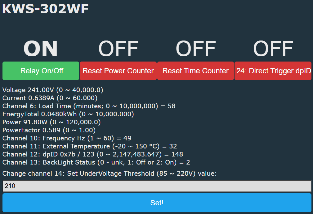

  • Demo autoexec.bat mapping for KWS-302WF channels
    #15 21348761
    Hypnotics
    Level 4  
    Posts: 8
    >>21347403 @p.kaczmarek2 my demo autoexec.bat file attached. check it thoroughly and guide me.
     startdriver tuyamcu
    startDriver NTP
    tuyaMcu_setBaudRate 115200
    // tuyaMcu_defWiFiState 4
    // Power On/Off dpID 16  - Channel 1
    setChannelType 1 toggle
    setChannelLabel 1 "On/Off"
    // linkTuyaMCUOutputToChannel dpId verType tgChannel
    linkTuyaMCUOutputToChannel 16 bool 1
    // channel types
    setChannelType 2 voltage_div10
    setChannelLabel 2 "Voltage"
    setChannelType 3 current_div1000
    setChannelLabel 3 "Current"
    setChannelType 4 power_div10
    setChannelLabel 4 "Power"
    setChannelType 5 ReadOnly
    setChannelLabel 5 "RunTime"
    setChannelType 6 EnergyTotal_kWh_div1000
    setChannelLabel 6 "Total Energy"
    setChannelType 7 ReadOnly
    setChannelLabel 7 "Power Factor"
    setChannelType 8 ReadOnly
    setChannelLabel 8 "Frequency"
    setChannelType 9 temperature
    setChannelLabel 9 "Temperature"
    // voltage
    linkTuyaMCUOutputToChannel 101 val 2
    // current
    linkTuyaMCUOutputToChannel 102 val 3
    // power
    linkTuyaMCUOutputToChannel 103 val 4
    // Runtime
    linkTuyaMCUOutputToChannel 104 val 5
    // power
    linkTuyaMCUOutputToChannel 105 val 6
    // power
    linkTuyaMCUOutputToChannel 106 val 7
    // power
    linkTuyaMCUOutputToChannel 107 val 8
    // power
    linkTuyaMCUOutputToChannel 108 val 9
    // NOTE: test code only so I can refresh quickly without restarting
    tuyaMcu_sendQueryState
  • #16 21348886
    Posts: 14763
    Rate: 12894
    So, are you able to control the relay? Is voltage properly displayed?
  • #17 21349683
    Hypnotics
    Level 4  
    Posts: 8
    >>21348886 Yes I can control the relay, and the voltage is shown properly as shown in the device screen. Help me with OVP OPP and other configurable parameter settings.

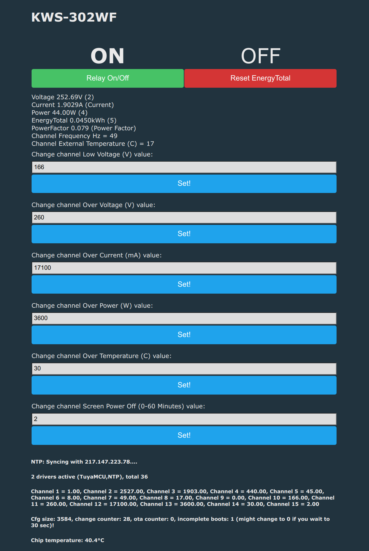

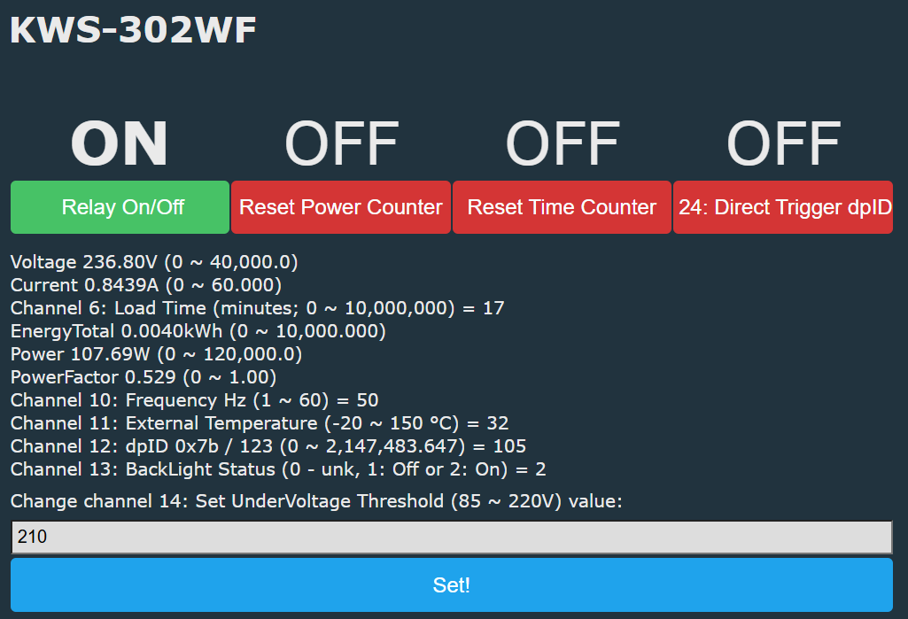

  • Frequency parsing missing decimal digit
    #18 21365074
    adolfotregosa
    Hi,
    Thank you for this project.
    I’d like to report that the parsing of the frequency value is incomplete, as it is missing the decimal part.
    Info:TuyaMCU:Received: 55 AA 03 07 00 08 6B 02 00 04 00 00 00 32 B4
    Info:TuyaMCU:ProcessIncoming[v=3]: cmd 7 (State) len 15
    Info:TuyaMCU:ParseState: id 107 type 2-val len 4
    Info:TuyaMCU:ParseState: int32 50
    As far as I can tell:
    32 = 50
    B4 = 180
    In this case, the decimal point is the "0" from 180, so the correct value should be 50.0Hz.
    Another example:
    Info:TuyaMCU:Received: 55 AA 03 07 00 08 6B 02 00 04 00 00 00 31 B3
    Info:TuyaMCU:ParseState: int32 49
    Here:
    31 = 49
    B3 = 179 = 9
    This corresponds to 49.9Hz.
    So the first number in decimal form from right to left is the missing decimal number.
    Thank you for looking into this!

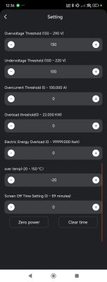

    Another observation is that OpenBK is missing a "push button" option. We currently only have a toggle, whereas some functions are a simple "press to clear" type of action. In my autoexec.bat it would be used for setChannelType 9. Is this possible to implement somehow?
    Control panel of the KWS-302WF device displaying various parameters and settings options.
    I've created a more comprehensive autoexec.bat for this device:
    autoexec.bat
    startdriver tuyamcu
    startDriver NTP
    setChannelLabel 1 " Relay On/Off"
    // Measurements
    // voltage
    //setChannelLabel 2 "Voltage"
    // current
    // power
    //setChannelLabel 4 "Power"
    // Total Energy kWh
    linkTuyaMCUOutputToChannel 105 val 5
    setChannelType 5 EnergyTotal_kWh_div1000
    //setChannelLabel 5 "Total Energy"
    // power factor
    linkTuyaMCUOutputToChannel 106 val 6
    setChannelType 6 PowerFactor_div100
    setChannelLabel 6 "Power Factor"
    // frequency
    linkTuyaMCUOutputToChannel 107 val 7
    setChannelLabel 7 "Frequency Hz"
    // external temperature
    linkTuyaMCUOutputToChannel 108 val 8
    setChannelLabel 8 "External Temperature (°C)"
    // Reset Total kWh
    linkTuyaMCUOutputToChannel 118 bool 9
    setChannelType 9 toggle
    setChannelLabel 9 "Reset EnergyTotal"
    // low voltage
    linkTuyaMCUOutputToChannel 109 val 10
    setChannelType 10 TextField
    setChannelLabel 10 "Low Voltage (V)"
    // over voltage
    linkTuyaMCUOutputToChannel 110 val 11
    setChannelType 11 TextField
    setChannelLabel 11 "Over Voltage (V)"
    // over current
    linkTuyaMCUOutputToChannel 111 val 12
    setChannelType 12 TextField
    setChannelLabel 12 "Over Current (mA)"
    // over power
    linkTuyaMCUOutputToChannel 114 val 13
    setChannelType 13 TextField
    setChannelLabel 13 "Over Power (W)"
    // over temperaure
    linkTuyaMCUOutputToChannel 115 val 14
    setChannelType 14 TextField
    setChannelLabel 14 "Over Temperature (°C)"
    // screen_poweroff
    linkTuyaMCUOutputToChannel 119 val 15
    setChannelType 15 TextField
    setChannelLabel 15 "Screen Power Off (0-60 Minutes)"

  • #23 21428074
    m_orkisz
    Close-up of a circuit board with a damaged component marked in a red square. .
    In my case the Wi-Fi stopped working and then the screen went out. On opening it up there is a faulty component - what is it and can it be purchased?
  • #24 21428393
    Posts: 5215
    Help: 448
    Rate: 917
    >>21366148
    @Hypnotics sorry I missed this. I don't know the answer though
  • #25 21527175
    Lusant
    Posts: 8
    >>21428074
    Maybe too late, but the chip is part of the power supply.
    There are some stores where you can buy it .. google for "uni u3211".
  • #26 21540511
    Posts: 14763
    Rate: 12894
    I'm attaching U3211 datasheet (chinese, but with schematics and some info in english):
    • uni-semic_1725427419000.pdf (791.83 KB) You must be logged in to download this attachment.

    #27 21614456
    DGAlexandru
    Posts: 7
    Hi,
    Thank you for sharing with the world all of your tests, results and tools :)
    I also have this device and want to make it better - it lacks at least the recovery time for Power On (this one should first disconnect the load at Power On, as it uses a latching relay, check the Voltage and only if it's in the configured range, command the relay to have the circuit closed), Under Voltage and Over Voltage.
    Here is my "contribution back":
    I had mine with MCU (PY32F002A) firmware version 0.1.17 (I think) and I saw that there is a newer version - 0.2.1.
    Before upgrading MCU firmware I connected a RS232 serial adapter to the serial communication between MCU and CBU to sniff the firmware download.
    Unfortunately I let it connected to RX line from the MCU to CBU.. so I only got the MCU answers to the CBU during the FW upgrade process.
    But, using this websites: Link and Link I quickly understood the communication between CBU and MCU and I built a Python script to emulate the MCU communication part.

  • Checksum byte mistaken for frequency decimal
    #28 21614509
    DGAlexandru
    Posts: 7
    adolfotregosa wrote:
    Hi,
    32 = 50
    B4 = 180
    Another example:
    Here:
    31 = 49
    B3 = 179 = 9
    Hi adolfotregosa,
    at first sight, I agreed with you, but having a closer look, I saw that you were misled by the last byte which is a checksum byte, not a "data" byte.
    55AA 03 07 0008 6B02000400000032 B4 translates to: Header, Communication Version, Command / Type of answer, Number of Data Bytes, DATA, Checksum
    Changing any byte before the Checksum one, will change the Checksum :)
    Checksum is the remainder of the division between the sum of all the bytes (before the checksum one) and 0x100 (256)
    So in your example:
    55 AA 03 07 08 6B 02 04 32 = 1B4
    0x1B4 % 0x100 = 0xB4
    (% is the sign usually used in programming = modulo operator; in math is written as "mod")
    I'll sniff some more the communication between CBU and MCU to see where this decimal is sent.

    #29 21617021
    DGAlexandru
    Posts: 7
    Hi,
    after 2 days of playing with KWS-302WF with OpenBeken running on CBU I created the following autoexec.bat file
    //Buttons
    // Relay On/Off dpID 0x10 = 16  - Channel 1
    // Reset Energy Counter kW/h dpID 0x76 = 118

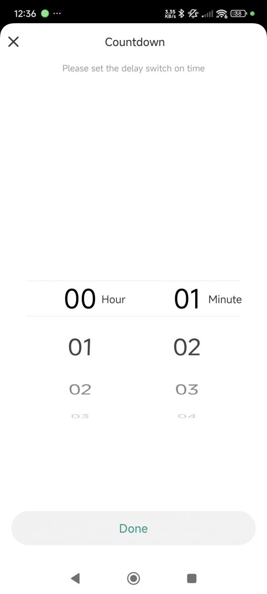

    //Set CountDown Timer dpID 0x79 = 121
    linkTuyaMCUOutputToChannel 121 val 21
    setChannelType 21 TextField
    setChannelLabel 21 "21: Set CountDown Time (60 ~ 86400 seconds)"

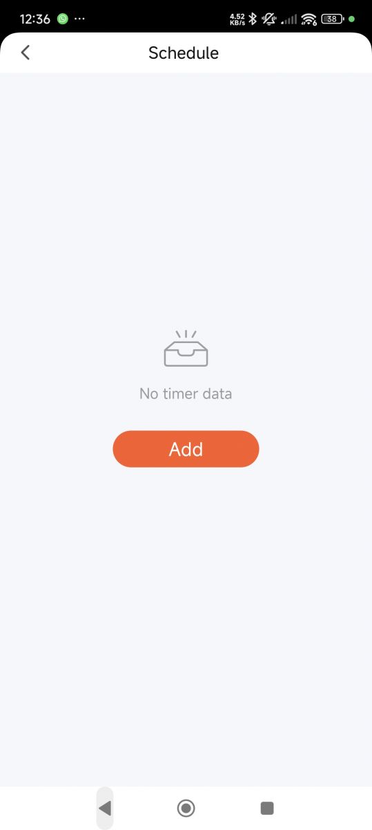

    //Relay Direct Trigger for schedule dpID 0x7a = 122
    linkTuyaMCUOutputToChannel 122 bool 24
    setChannelType 24 toggle
    setChannelLabel 24 "Relay trigg. dpID 0x7a / 112"
    (code is updated with the new findings - dpID 0x7b now is "decoded")
    Refrigerator load at rest
    KWS-302WF control panel with buttons and device measurement data
    Refrigerator load On - doing it's business :)
    OpenBeken KWS-302WF interface with measurement data and control buttons
    I've moved to the "short startup command" the MCU driver and the corresponding init settings:

    I've used the JSON extracted from the original firmware (divadiow added it first to this topic) to try to describe as best as I could the values.
    Still, there are 4 dpID that I couldn't figure what are used for / how are used:
    0x7b / 123 which can have a ReadOnly value between 0 and 2,147,483.647 (= 0x7FFF FFFF) = "Add Electricity" according to divadiow
    At the beginning, it had a value of 21; after hooking a big load (refrigerator) it started to grow. Resetting values, unplugging power or the load, didn't make it go back to that low value.
    Later Edit: this dpID stores the counter for Total Energy measured by the device since it was first used. The value can only be reset by holding + and - buttons on the device for 5s. THIS WILL RESET MCU to factory settings - you'll have default values for UnderVoltate, OverVoltage, OverTemperature and so on.
    dpID 0x70 / 112 which can have a Write value between 0 and 60,000, and according to the JSON, it should be configured with a step of 30 = "Poweroff Time" according to divadiow
    I've tried with many values, I didn't spot any change. Upon CBU reboot, this value goes back to 0.
    dpID 0x75 / 117 "can" (according to JSON) be set (write) to only 3 values: 0, 1 or 2 = "Power Down Memory" according to divadiow
    Tested all of them. Nothing found. Upon CBU reboot, this value goes back to 0.

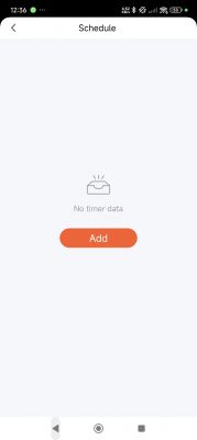

    dpID 0x7a / 112 is described as being "boolean" in JSON and also has the "trigger": "direct" tag, which is unique - it is configured only for this dpID in JSON.
    = "Switch" according to divadiow
    Using it as an On/OFF button I see it commands the Relay which is also controlled by dpID 0x10 / 16. The MCU responds back with updated status for dpID 0x10.
    Later Edit: This is used by the original app - in Smart Life you can create a schedule to control the Relay Status. Probably they wanted to use a different dpID for this command, to know, maybe, which process changed the relay status (last one).
    We really miss a new button type - one that doesn't change it's status (from Off to On / from Red to Green) for commands that are needed only with a value of 1, to trigger something, when the MCU won't update the status of those dpIDs, case in which the toggle button isn't good as it modifies the value that is going to send on next press, from 1 to 0, because now it thinks it's On and wants to make it Off on next press. This button can change it's color, at press time, but as soon as it isn't pressed anymore, it should get back to it's "Off" color.
    The 2 command that need this kind of button are:
    dpID 0x76 / 118 "Reset Power Counter"
    dpID 0x78 / 120 "Reset Time Counter"
    Wish you happy modding :)

    #30 21617063
    Lusant
    Posts: 8
    Such I remember, this one is the Running Time counter. This is wrong
    Also, I've found the attached text file (don't know where). With a smartphone and Google Translator from Pictures, you can find out what is the text in Mandarin.
    Regards.
    EDIT: Opps .. it's Energy Totalizer .. I think there is a second Totalizer which is only resetable with the buttons in the device (hold buttons + and - for 5 sec)

You can emulate the MCU side of TuyaMCU during boot and lie about the MCU version. 1. Sniff the CBU↔MCU boot exchange. 2. Reply to product-info with the same product key but a lower MCU version, such as changing 0.2.1 to 0.2.0. 3. Let the CBU request OTA with command 0x0A, then collect the 0x0B data blocks. One successful capture reported an MCU image size of 0x2F0C, which is 12,044 bytes. [#21614456]
12. Why does the frequency value from KWS-302WF dpID 107 appear without a decimal in OpenBeken logs, and is the last byte data or just a checksum?
The last byte in the shown TuyaMCU frame is a checksum, not the missing decimal digit. A later correction in the thread explained that a packet like 55 AA 03 07 0008 6B02000400000032 B4 contains data ending at 32, while B4 is the modulo-256 checksum. That means the “49.9 Hz from the last byte” interpretation was wrong. The decimal issue, if real, must come from another encoding path or later processing step, not from the checksum byte. [#21614509]

15. What is the faulty power-supply chip marked U3211 in the KWS-302WF, where can I buy it, and how do I confirm it is the reason Wi-Fi and the display stopped working?
U3211 is part of the KWS-302WF power supply, and the thread identifies it as the failed part when both Wi-Fi and the display died. A later reply also says you can find it by searching for “uni u3211”, and another post attached a U3211 datasheet. The practical confirmation path is visual failure first, then power-rail diagnosis around that supply stage, because loss of both the display and Wi-Fi points to a common supply fault rather than two independent logic failures. [#21527175]
