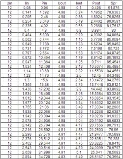

    The converter was tested with an artificial load for input voltages of 12 and 24 V and for output voltages of 5 V. During the tests, the voltages and currents on the input and output sides of the converter were measured, and the power and efficiency were calculated.
    Below I present the measurement results.
    Input voltage 12V, output voltage 5V:

    It can be seen that the efficiency of the converter depends on its supply voltage, in this case the lower the supply voltage, the higher the converter efficiency.
    When performing the above measurements on an artificial load, during the load change, I turned the load control encoder too much, which resulted in the load of the converter with a current of over 7A for a few seconds, which caused its damage. It was not accompanied by any special effects, just the blue LED on the converter board went out. In the idle state, the maximum output voltage after damage is about 1.5V, but after applying a load, the voltage at the output disappears. The XL4005 chip and the Schottky diode were damaged.

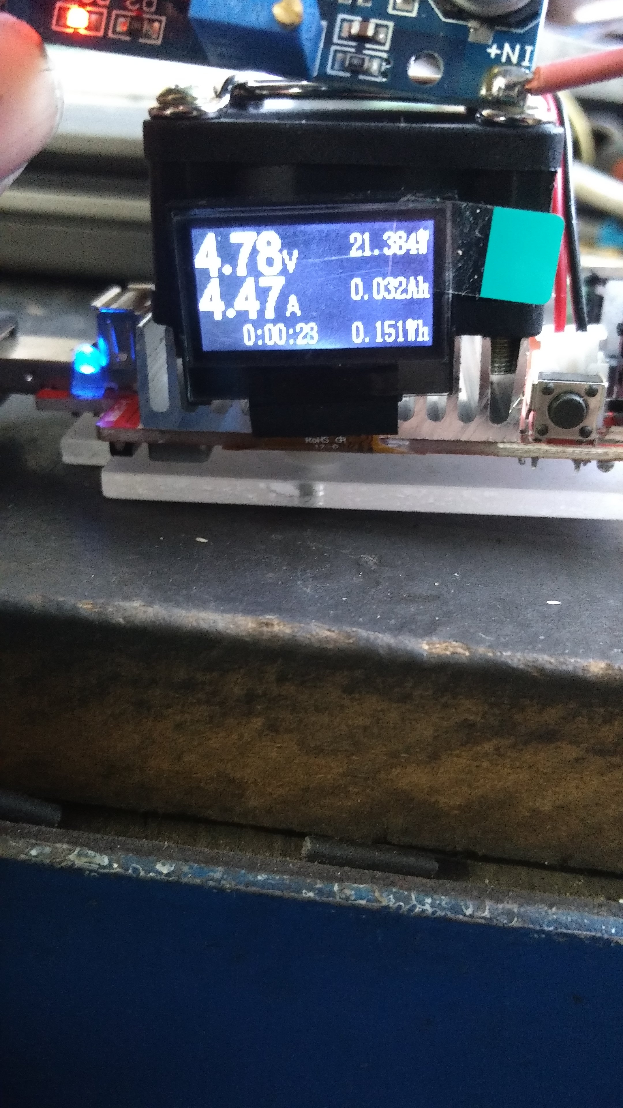

    It seems that somewhere like this inverter is in my place. It was supposed to power the phones, but it crumpled terribly with the load.
    Added after 8 [hours] 16 [minutes]:
    XL 4015E1
    Load as in the picture.
    The diode D1 gets warm the fastest, even hot. Then the choke and the circuit itself.
    Description of the step down converter based on the XL4005 Description of the step down converter based on the XL4005
    You would have to do a long test and put a heavier load.
