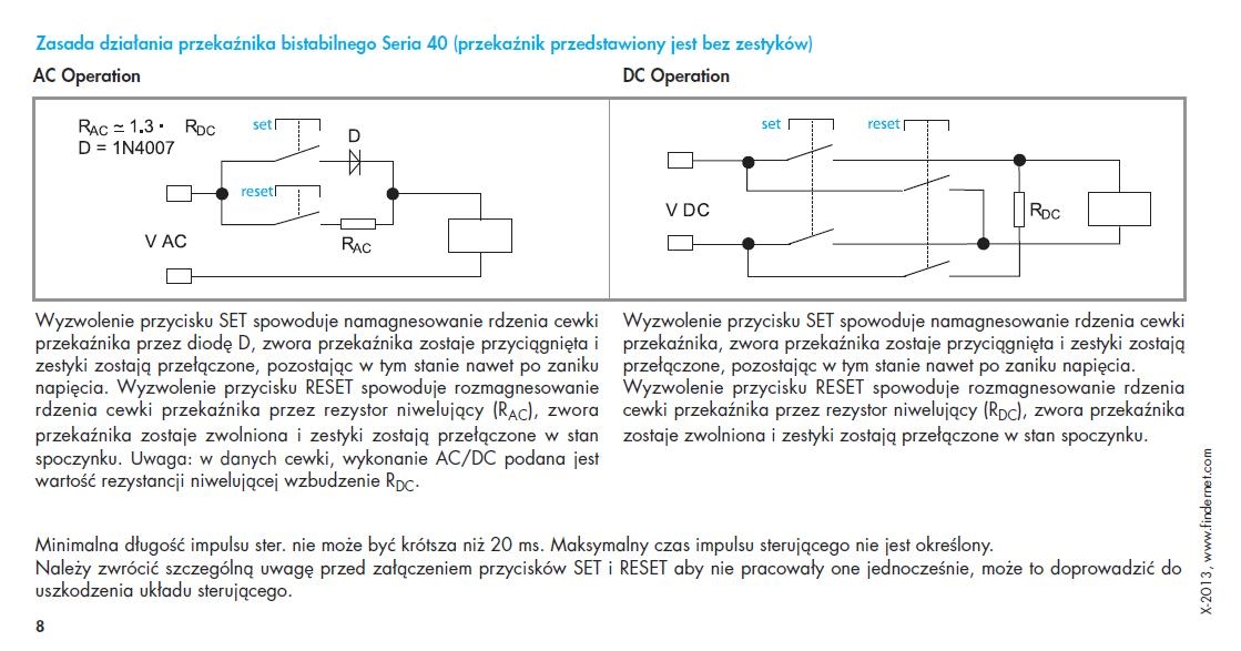

    Col. Christopher - you are writing about an INSTALLED bistable relay (in itself it has some "executive circuit" in the form of a relay/bistable relay and a state formation/memory circuit). However, the 'executive' component, i.e. a single or dual coil bistable relay, must have an external state formation circuit....
    The proposed Finder relay (40.52.6.024.0000) will not solve the problem by itself either - it needs separate set/reset contacts. Example from the instructions:
    How do I build a flip-flop for the RT424F24 bistable relay? .
    The best solution is to forgo the "cheap" solution and use branded solutions, e.g. https://www.fif.com.pl/przekazniki-bistabilne/719-przekaznik-bistabilny-bis-411-2z-24-v.html.
    Where you would use one pair of contacts to power the device/light and the other pair of contacts for PLC input for on/off detection.
