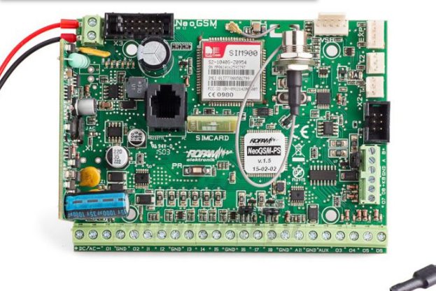

    Hello, I would like to join the topic because I also have a solenoid valve, but with 230V waste controlled by a relay, but in the event of a power failure - trouble, I control the output O3 low current, I was thinking of replacing it with a 4-wire 9-24V, 3-6 W, duration 10 seconds (power supply to the solenoid valve permanently and control is done by a second pair of wires without voltage) and somehow connect it to the power supply of the control panel, but I have no idea where to connect it. Neogsm control unit. Can it somehow be powered from the wires going to the battery there is 13.7V on them because I rather don't see where it could be powered(can it be?). The O1 and O2 12V 1 A outputs operate the beacon. The control would continue with output O3 but where would I get the power at the control panel to make it work in case of power failure?
    • Which ball valve control to choose for an alarm system? centrala neo.png (551.88 KB) You must be logged in to download this attachment.

    Welcome,
    vwszeldon wrote:
    I have a solenoid valve only that from waste to 230v controlled by a relay but in case of power failure= trouble
    Wouldn't it be sufficient to "plug in" in parallel to the solenoid valve an ordinary ball valve which would be opened manually in case of AC failure?

    Well, yes. The only problem is when you are in the shower and there is no one to open the valve. That is why I am looking for a better solution😃. But with this valve it is not so good either, that it needs 2 minutes to load, because it may not close and there is trouble again. Although there are hardly ever short-circuits...rather during a storm.

    Not the best, due to hydrodynamic impacts. It is better to use a ball valve either with a 24 VDC motor and some sort of battery backup, or with a 220 VDC motor, as these valves have the possibility of manual opening - a knob.
