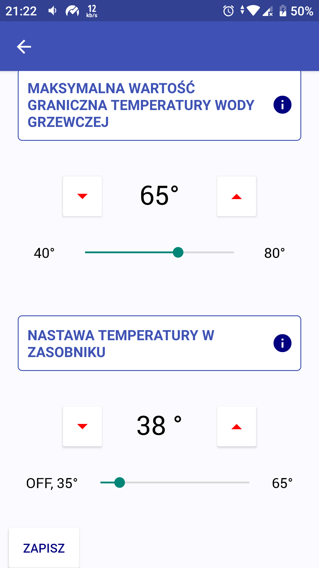

    lasekd , I have a few questions:
    1. Can service parameters be changed via ST-2801, eg P01, P02 ..?
    2. Have you reached it, is it possible to preview the modulation ..?
    3. Here is a somewhat lame question: when turning on the boiler b1 11 b2 11 IF 011 means the software version (i.e. 11 ..?)
  • #154 18956784
    Wojtermet25
    Level 30  
    Posts: 1061
    Help: 155
    Rate: 228
    1. No (at 99.99%)
    2. Shows, but some people have long delays, or the refresh rate is slower and don't know how much to report as there are large variations in modulation
    3. Yes (motherboard and display board software version) then IF then I don't know.

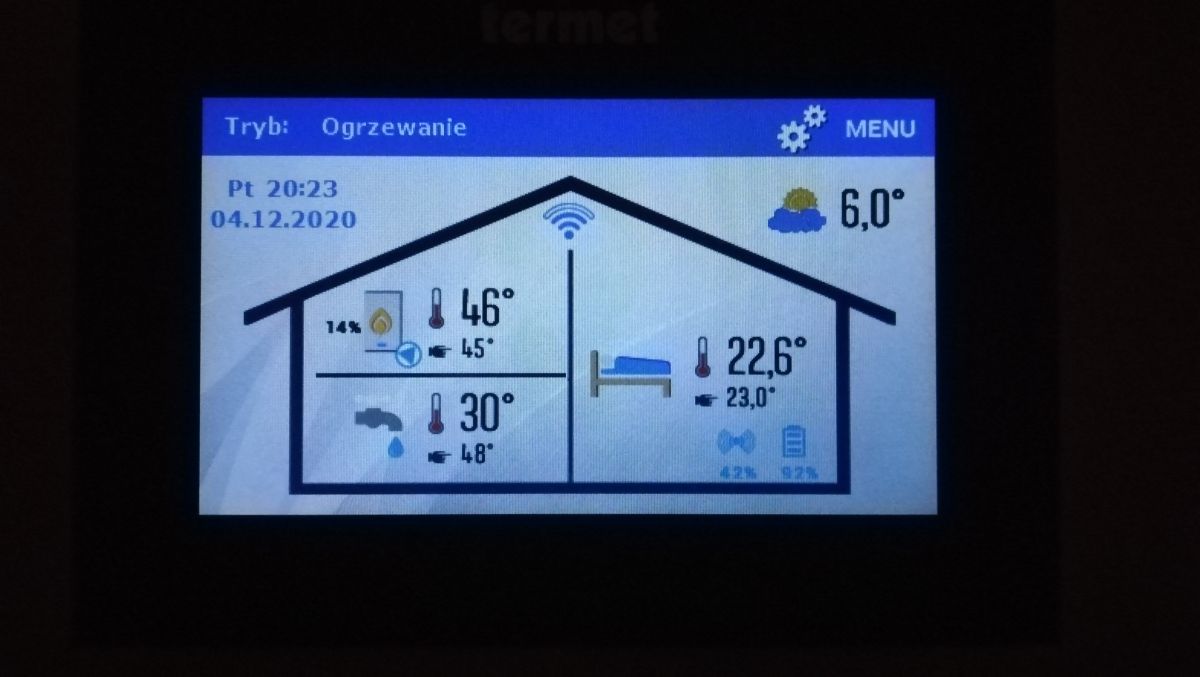

  • #155 19083246
    prezes_kk
    Posts: 17
    dacher wrote:
    You have to tire Tech? a bit
    By the way, I bought and installed the radio temperature sensor you wrote about - it works very well and finally I can change the room for measurements!
    I also have a Termet Gold Plus with a Tech ST-2801 WiFi controller with Termet branding and I wrote to Tech asking about connecting an external temperature sensor. Apparently it doesn't work with that. I wanted to ask if you have a driver in the Tech or Termet version and if the external sensor works because in fact the built-in sensor in the controller is very susceptible to temperature changes caused by backlighting

    Can you tell me what kind of sensor it is? Because Tech
    currently sells new ST-2801 WiFi regulators with a C-mini sensor.
  • #158 19083952
    lasekd
    Posts: 90
    Rate: 18
    I have just c mini

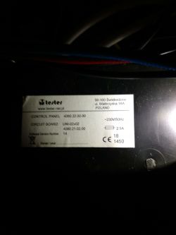

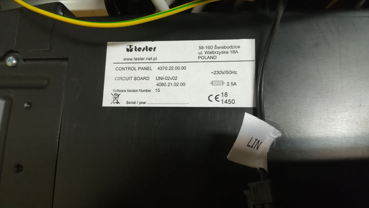

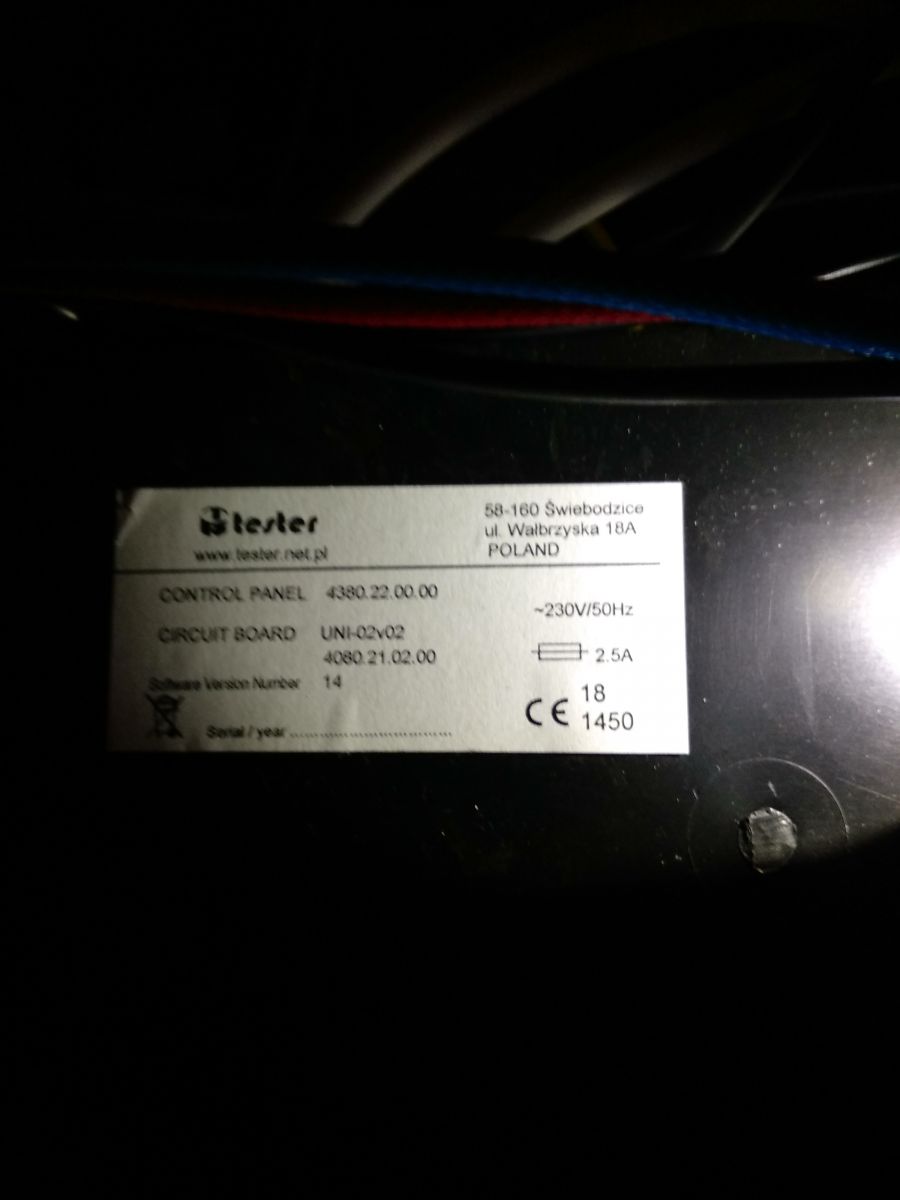

    Does anyone know what the newest Termet Gold Plus soft is? I currently have the b14 version - the boiler was bought in November 2019 (in the thread I read that there is a b15 version).
    What does the update process look like? Can it be ordered directly from the Tester or does it have to go through the Termet service?

  • #160 19084136
    bro2004
    Level 30  
    Posts: 980
    Help: 160
    Rate: 637
    It is impossible to update. Install new motherboard and display board.
    It is possible to update, you can even personally drive to the Tester company after prior telephone arrangement and they will do it while you wait, but both boards need to be reprogrammed.
    And the controller connected to Lin is a comfort module and is available in Termet and stores that sell it.

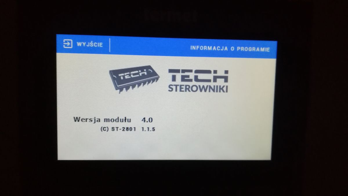

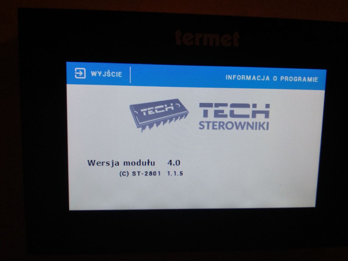

    Today the c-mini sensor has arrived for the Tech ST-2801 WiFi controller, but I can't adapt it.
    That is, in the menu, I choose the type of temperature sensor and give the option to register on the sensor
    I press the button on the back of the case. The red light blinks after several seconds
    I am getting information from the module that registration has failed. I'm afraid I have an old version too
    module. I have the following information in the module options:
    Termet ECOCONDENS GOLD PLUS + ROUND with Wi-Fi - Open-Therm - connected incorrec
    Can you check what version of the module you have? From what I saw in the photos you also have
    sensor with Termet branding.
  • #165 19090261
    maliniak80
    Posts: 287
    Rate: 377
    The boiler is working great, at least for now, as if I bought 4 bellows ago and a boiler from 2018 and you can see that the board with the new soft:

    So the version is the same. Maybe I'm doing something wrong? When should the button be pressed and how long should it be held?
    Maybe press the sensor first and then register in the controller?
  • #169 19090360
    maliniak80
    Posts: 287
    Rate: 377
    Menu- settings - sensor type, the bird should be on radio, then you click registration, such dots scroll, then you press the switch in c-mini and the registration should pop up successfully, click OK You press this switch only for a moment, do not hold :)
  • #170 19090364
    prezes_kk
    Posts: 17
    maliniak80 wrote:
    Menu - settings - sensor type, the bird should be on the radio, then you click registration, such dots scroll, then you press the switch in c-mini and registration should pop up successfully, click OK
    I do it too, but I have information that it failed :( Well, nothing probably sunk PLN 85
    I will try it again but I have already tried it a few times and nothing
    Edit:
    Managed to. I held this switch pressed for a long time and it was enough to press it briefly.

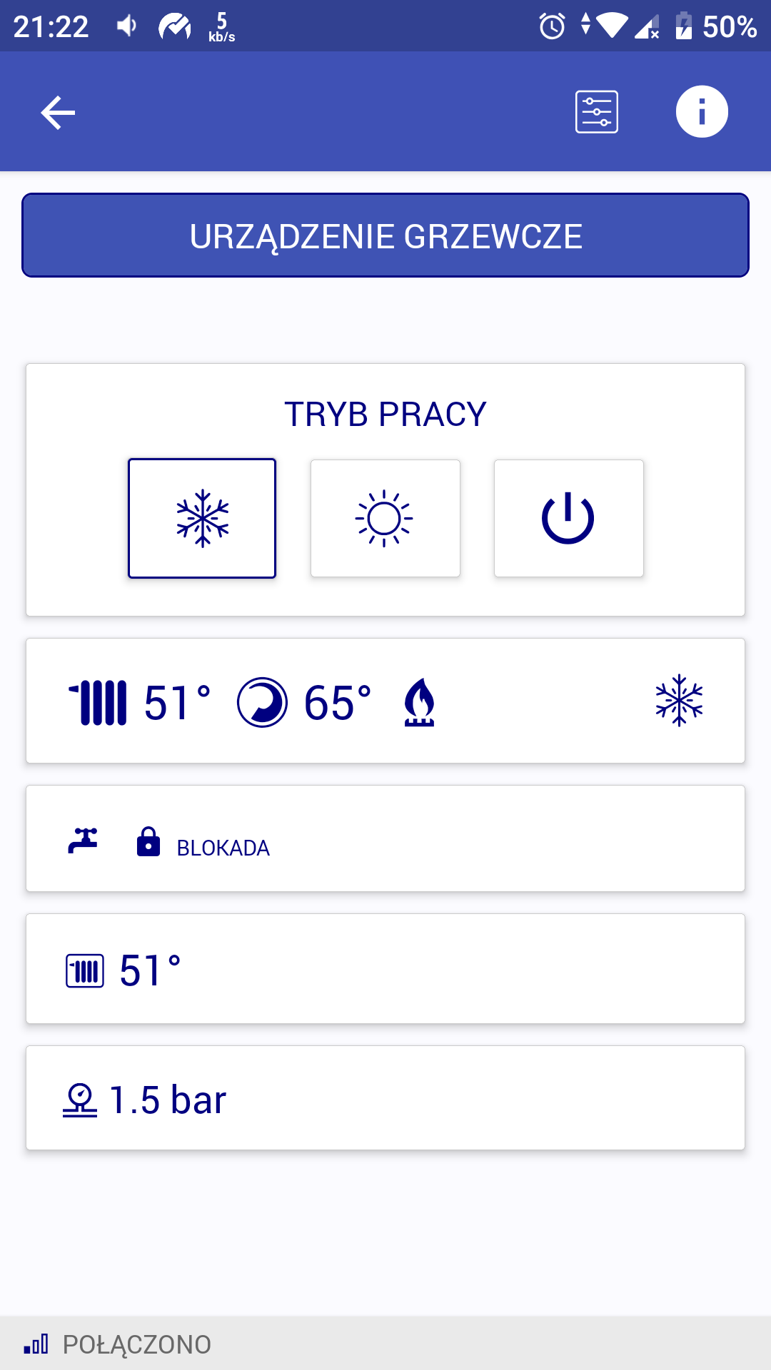

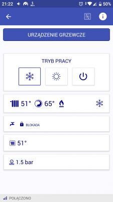

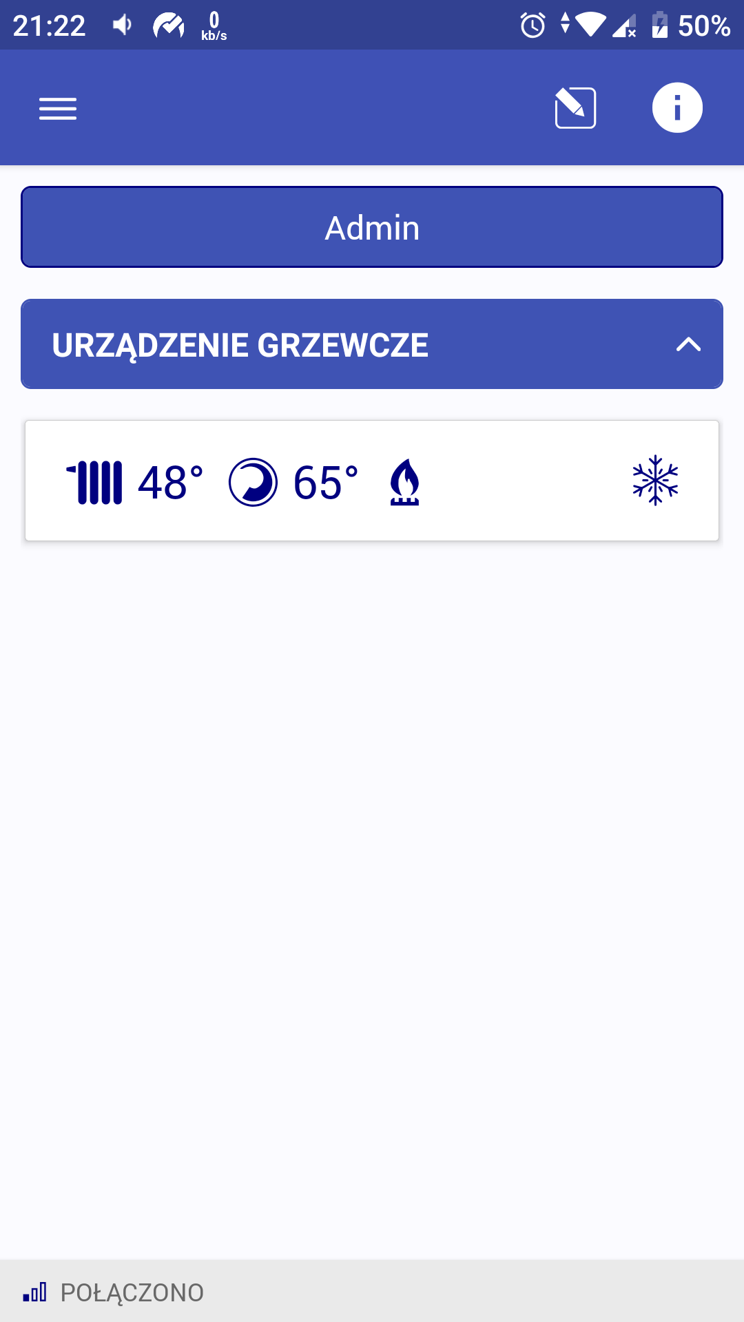

    I jerked off on this comfort module.
    Today I connected to the boiler. After configuring and switching to the "Gateway" mode
    because the stove options are controlled by Tech ST-2801 in a dedicated application, not much can be set,
    and not much information about the boiler can be read (compared to the information from Techa).
    I thought it would be possible to read the data P1 to Px and possibly change it.
    I'm a bit disappointed.
