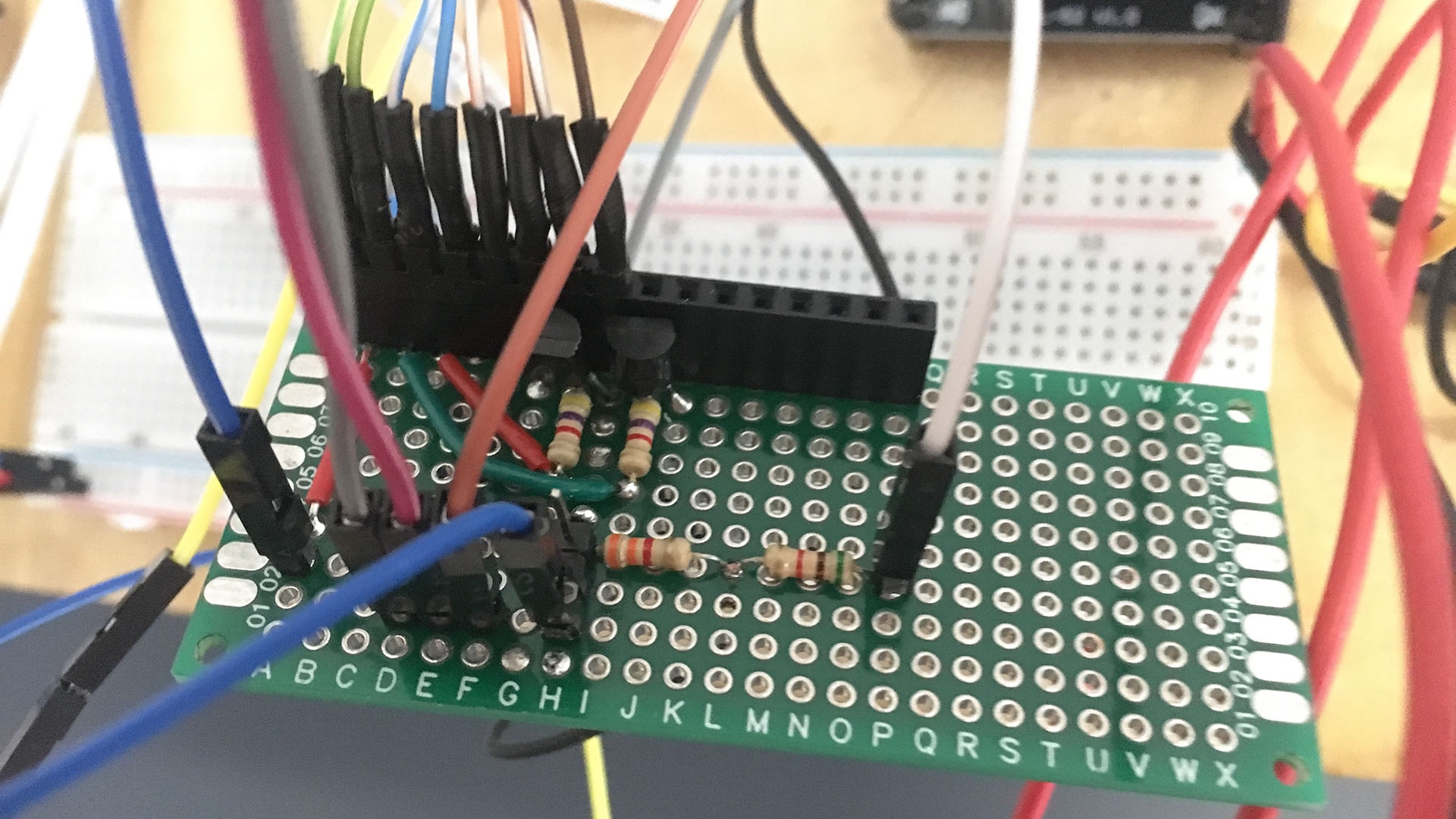

    Hello!
    During the renovation of the living room, I came up with the idea to hide the projector and screen for the projector in the suspended ceiling (or more precisely in the decorative band under the LED lighting). One button activating the projector was supposed to turn a seemingly ordinary living room into a cinema room ...
    The design is based on 15cm drawer guides with full extension. The guides must be mounted parallel to each other in all planes. The structure of profiles for GK frames does not facilitate their calibration. I think it would be easier with a wooden structure.
    Projector elevator and Arduino controls
    The motor rotates a threaded rod on which two lines are wound on the left and right side. I secured the place where the lines are wound with reinforced tape. The cables run through pulleys and are then attached to the moving part of the lift with cable ties. You can easily adjust the left-right tilt with the bands. In addition, they are the weakest elements, so if the lines are pulled in further than expected, the bands will break without damaging the structure.
    The manual control of the elevator is carried out on the car window switch directly on the engine circuit. Thanks to this, in the event of problems with automation, it is possible to raise or lower the lift manually. The upper limit switch in position (NC) closes the motor circuit when the elevator has not reached the upper position. Otherwise, the circuit is open and the motor cannot run in that direction. The limit switch is moved by a piece of profiled plywood with which you can adjust the upper position of the lift. The lower position of the lift is always the same - all guides are fully extended and slack. As a result, the projector is always in the same position when it is turned on.
    Projector elevator and Arduino controls Projector elevator and Arduino controls
    Automatic control is carried out on two relays controlled from the microcontroller. When the projector is started, voltage is applied to the 12V trigger output. After breaking with resistors to ~ 5V it goes to Arduino. The signal from the limit switch, when the elevator has not reached the upper position (NO), is sent to the microcontroller (short circuit to ground). When the projector's status changes, one or the other relay is activated for a specified period of time. If for some reason the Arduino starts up, when the elevator has not reached the top position and the projector is turned on, the elevator will not be lowered. Arduino also controls the projection screen.
    Projector elevator and Arduino controls Projector elevator and Arduino controls Projector elevator and Arduino controls
    The elevator does not cause any problems so far. I also plan to add a 12V 2A fuse, which in theory should burn out when the engine is too heavily loaded. Optionally, you could add a lower limit switch somewhere on the moving element of the elevator.

    The question is, do you have an emergency patent for opening when the engine is damaged? I am asking because I had such a case with a client and it was terrible to get to fix it.

    Arduino boards (clones) have one drawback ... Built-in AMS1117-5.0 stabilizer. When the power goes from Vin (eg 12 V), it is enough to short +5 V with GND on such a board for a fraction of a second for the stabilizer to explode - at the same time giving the full voltage of the DC power supply (12 V) to +5 V. 100% repeatability.
    The design is very nice, but to be honest, I would be afraid to connect the wires to the microcontroller without any optoisolation - a few surges from the light switch or nearby lightning shots - and the microcontroller is hanging. I have a 12 V LED lighting control project on the table, the connected cables are maybe 6 meters in total - they catch everything that happens, and the effects are interesting - and this is the microcontroller suspended, and it works in a slowdown (seriously - if someone told me, that an ordinary ATmega8 can run in "SlowMotion" (until reset) after the usual overvoltage induction in the sensor cable - I wouldn't believe it - but still!).
    Is Watchdog enabled in the Arduino program code?

    Hello. A super useful project, but I have one caveat. Namely, not a very good choice of the drive because, as the colleague mentioned above, in the event of a drive failure, getting to the projector involves cutting the plates. The solution would be a sunroof drive because most of such drives have an emergency manual drive using an Allen key and an additional plus that they immediately have a drum with a rope.
    Earlier there was the original, but I lost the stabilizer and UART, eventually it will probably return there. Thank you for your valuable advice, I will observe the action and, if necessary, think about optoisolation. I will also read about Watchdog, because at the moment I have no idea what we're talking about.

    Nice idea - nightmare execution. In addition, a microcontroller in this design is needed like a watch fountain. Instead of a twine winding motor, it was possible to use a small trapezoidal screw straight from the CNC in the scissor lift system.

    In my opinion, it is a strong exaggeration to squeeze such an expensive and powerful computer into something like this, as well (or actually better, because more resistant to failure and interference) it would work based on two switches, two relays, two diodes and a transistor (optional, if the projector's output will not pull two relays).
    Also, the wiper motor is exaggerated here if the projector weighs less than 40 kg, but I understand that it was at hand for free.
    The ties in the form of fuses ... I think they would break last :D It takes a lot of strength to break it off.
    Manually rotating the wiper motor in an emergency situation - even without a brake, hard, and with shorted leads you need about 10Nm to turn it at least slowly.

    rs6000 wrote:
    What computer are you writing about? after all, it is an ordinary arduino for a few $, paradoxically, it will be cheaper than the analog system mentioned above, and more simply
    And what is arduino on the board, what is the program written for, not a computer? :D And how would adruino + the rest of the device be cheaper and easier than the rest of the device? Two relays, limit switches, two diodes - everything is used, there is only a transistor and a resistor with a total value of PLN 0.15 and only if the projector's output does not pull the relays, as it has the capacity of these several hundred mA, it does not even need to be.
    Something like this should be enough (I don't have an eagle on hand, so I scribbled in paint):

    But I guess you haven't read my post, my friend knows how to program, he wrote a simple code, he wanted to give arduino this, is there a problem with that? ;) then why do you prove the superiority of your solution? Or maybe my colleague was not talking about low cost because it is not always the most important thing? ;)
    So approach it ;)
    Greetings

    I do not defend, but I state that the same functionality and greater reliability can be achieved in a much simpler way :)
    Low cost and simplicity are always an advantage as we get the same effect.

    In my house there are more microprocessors than relays and limit switches, so if you take into account the unit cost, it would definitely be cheaper for me to do such a project on some uc ;)
    A decent relay can cost a lot more than uc + mosfet, and if we secure the system properly, it will work just as reliably. Additionally, the expansion will not be a problem and will generate lower costs.
    We can think here for hours, and it is still about scientific values and having fun, and not producing a device for mass production where every penny counts
  • #30 17463906
    nanab
    Posts: 1092
    Help: 90
    Rate: 239
    Only (as I have been repeating for a few posts) the computer does not exclude relays and limit switches :D They are still used in this design. Only in my diagram the limit switch should be slightly larger (50gr more expensive) by using a much too large motor, but you can move them to the relays (adding one transistor and resistor) and the problem disappears. Reliability with avr will always be lower, and it is not without reason that they are not used in e.g. military equipment.
