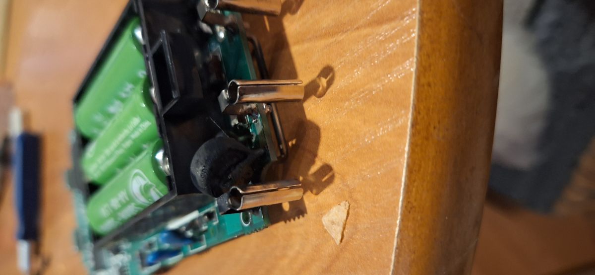

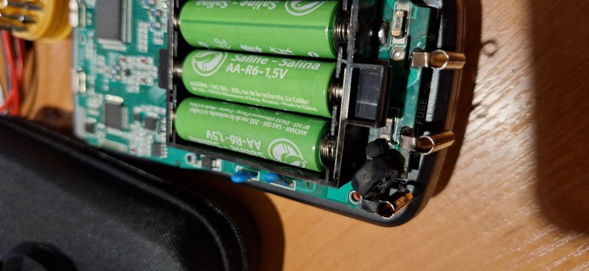

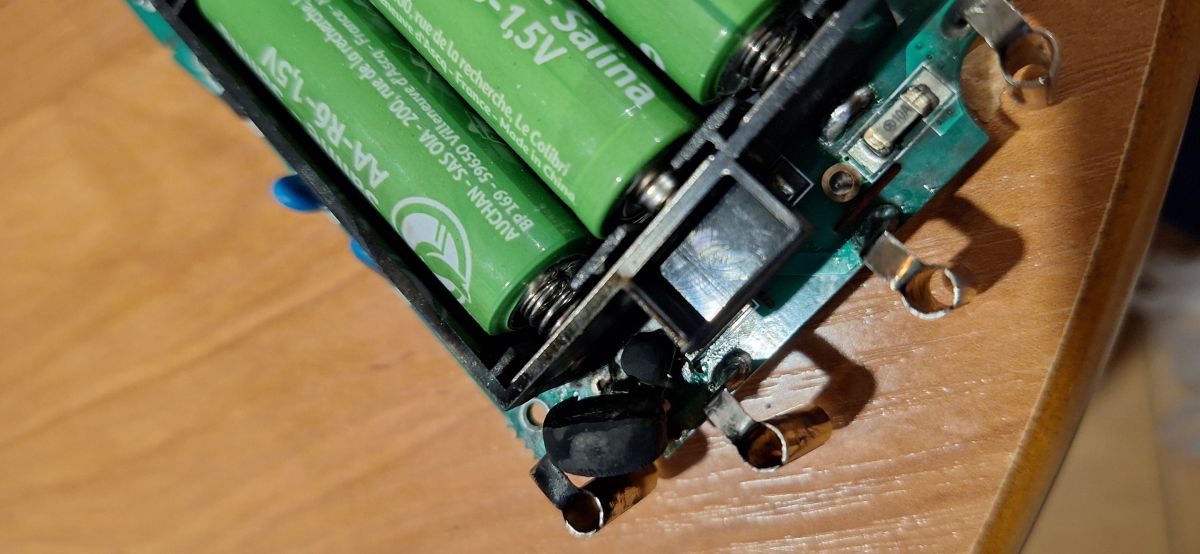

    What kind of veristo you can give and maybe the one at the back would work too MT8206 meter
    MUSTOOL MT8206 - Graphic Multimeter
    Added after 1 [hour] 39 [minutes]:
    >>18075818 can you specify which territory it is and the other one behind it
    MUSTOOL MT8206 - Graphic Multimeter .
