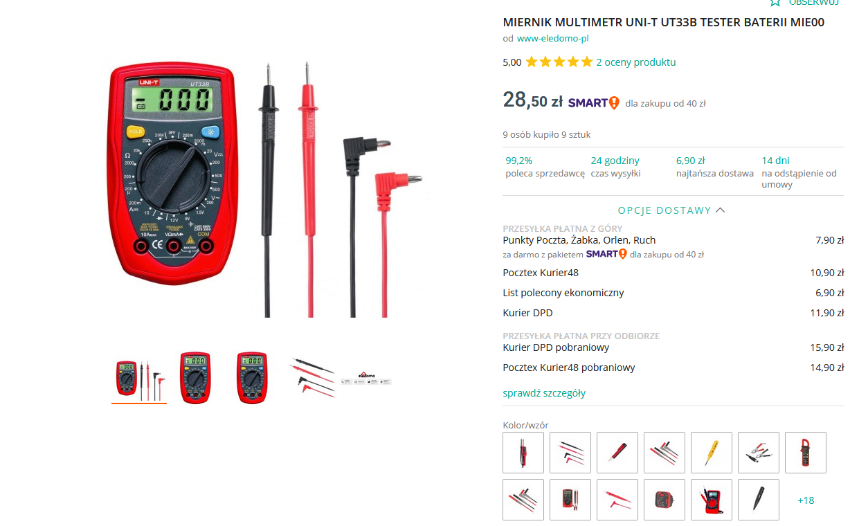

    At the beginning, a curiosity about the price. Well, brothers from China, you can buy such a multimeter for $ 14.99, which today translates into almost fifty-seven Polish zlotys :shocked!:
    UNI-T UT33B - "Cheap / Dear" - multimeter with backlight and HOLD func
    While on Allegro, you can buy it for less than 30 zlotys, including shipping.
    However, if you need several pieces, you can buy five pieces for the same price on Aliexpress :crazyeyes: You should add shipping costs of $ 8.88, which is thirty-three zlotys with pennies, so it comes out for a total of less than twelve zlotys per item :) .

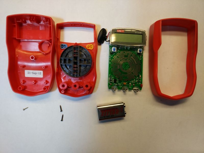

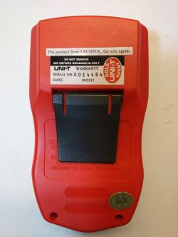

    I received the meter, "bare", but as you can see in the screenshots, the set includes only test leads, which I do not miss.

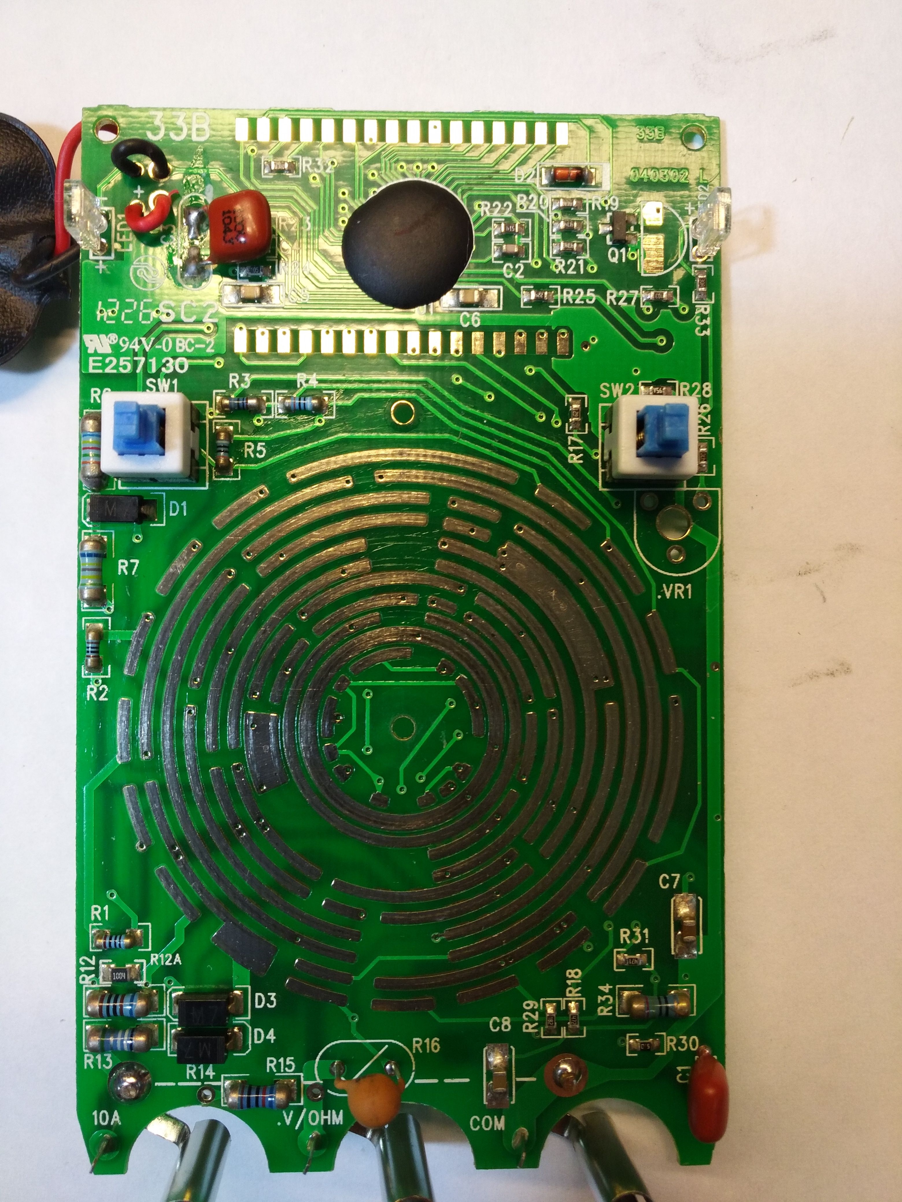

    See how this multimeter looks like. I also did not fail to look inside.
    UNI-T UT33B - "Cheap / Dear" - multimeter with backlight and HOLD func UNI-T UT33B - "Cheap / Dear" - multimeter with backlight and HOLD func UNI-T UT33B - "Cheap / Dear" - multimeter with backlight and HOLD func

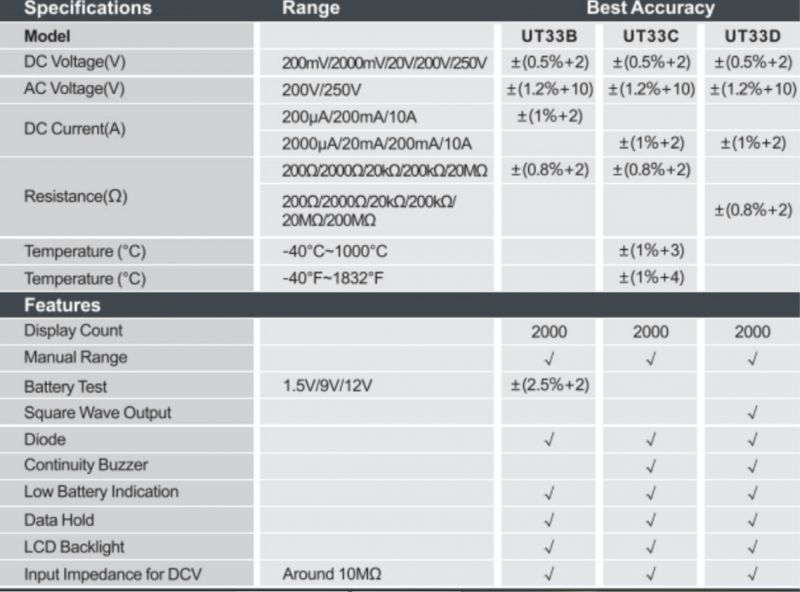

    But let's start from the beginning, that is with the technical data and specifications:
    Model: UT33B
    DC Voltage (V): 200mV, 2000mV, 20V, 200V +- (0.5% + 2) / 500V +- (0.8% + 2)
    AC Voltage (V): 200V / 500V +- (1.2% + 10)
    DC Current (A): 200uA +- (1% + 2) / 200mA +- (1.2 + 2) / 10A +- (2% + 5)
    Resistance (? ;) : 200? +- (0.8% + 5) / 2000?, 20K?, 200K? +- (0.8% + 2) / 20M? +- (1% + 5)
    Battery test: 1.5V, 9V, 12V
    I have no idea why the manufacturer wasted three "fields on the selector" and put these battery tests, not only that the results are the same as in the 20VDC range, but according to the table below, the accuracy is worse than in the 20VDC range.

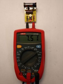

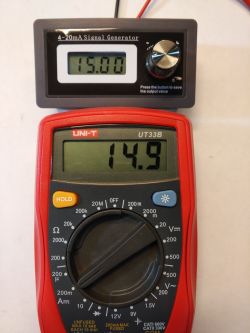

    I started my tests by measuring the current. The already known current source (5-20mA) was used as a reference. Well, we have a problem at the beginning. In the mile ampere range, it looked like this.
    UNI-T UT33B - "Cheap / Dear" - multimeter with backlight and HOLD func UNI-T UT33B - "Cheap / Dear" - multimeter with backlight and HOLD func UNI-T UT33B - "Cheap / Dear" - multimeter with backlight and HOLD func UNI-T UT33B - "Cheap / Dear" - multimeter with backlight and HOLD func
    As you can see, failure all along. So let's see if it happened. suitable for something in the 10A range.
    It's much better here. I do not exclude that my copy is damaged (in the range of 200mA), after all, I received it as used, from a person for whom it is a device straight from space.

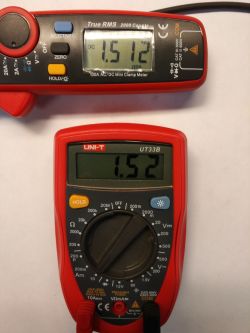

    So let's check how it works in the measurement of DC voltage. The reference voltage you already know will be used for the test.
    It is not bad here, for a measure of this class, the results are absolutely correct.

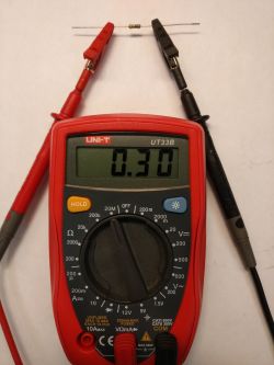

    And it's time to move on to the resistance measurement tests. Here, I will use a recently purchased set of nine resistors with a tolerance of 0.1% (zero point one percent).
    I have no objections here.

    I decided to add here the results of additional tests / measurements that I did on your requests.
    I have retested and return my honor. The milliammeter is working properly.

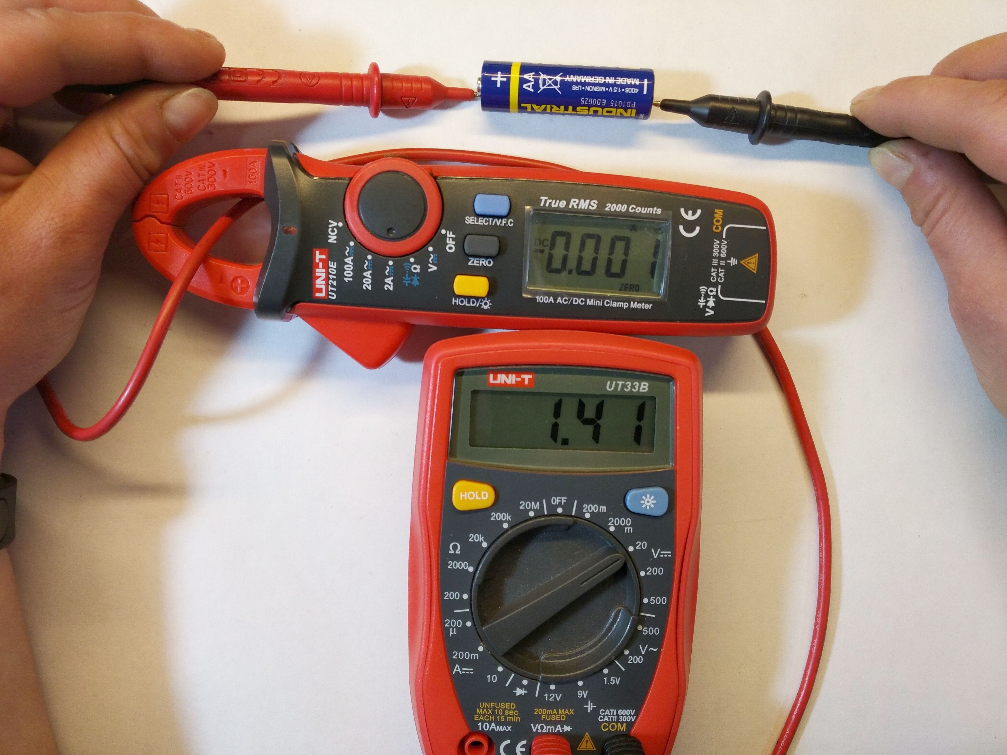

    And another test ...
    Well, you learn all your life. As I said, I had not dealt with a battery test in a multimeter before and for this the previous measurement, in which I used a fully charged 1.2V battery, was incorrect.
    It turns out that, as you thought, the meter introduces a load on the battery test range. I am enclosing new tests on used batteries.
    12V battery
    9V battery
    1.5V battery
    tytka wrote:
    When measuring in the 1.5V range, it is about 21.5mA
    Well, how he shot the face :D .
    As you can see in the photos above, in the case of used batteries, the measurement result in the 20V range is different than in the range dedicated to a specific battery.
    However, I still feel that this feature is unnecessary.

    Hello dear colleagues. I noticed in the photos that my dear CMS colleague was testing the ammeter with the 200mA range on, and the cable was connected to the 10A connector, this is a wrong connection. The cable must then be connected to the universal (middle) input. The 10A connector is only for the 10A range. This is the standard of cheap multimeters.
    As for the meter itself in a housing of this size, 4 models are available. Although they are suitable for basic measurements.
  • #4 17755107
    CMS
    Posts: 8468
    Help: 258
    Rate: 2603
    Congratulations on your perceptiveness. 500 points flies to you.
    I did make a mistake. This happens when you write three articles about three multimeters at once.
    I'll do a retest tomorrow.

    This multimeter does not have the most important function a multimeter can have. HE HAS NO "Beep" (beep, buzzer, buzzer).
    There is a version with the letter "D" (UT33D) - and this one has a "pipczyk" function and a generator output (probably 50Hz, rarely useful in my opinion, but it is). It costs about PLN 35-40 in PL, so probably similar to "B". I agree that 1.5 / 9 / 12V cell measurement "ranges" are pointless. If I had to choose, it would be obvious which one.
    I have been using the UT33D for a few weeks, and I must say that in typical workshop applications, for quick checking of "transitions" (buzzers), voltages, semiconductor junctions or resistance "it works". I even notice that I use the Protek 506 or DT-9929 more willingly than. And this is due to its small dimensions, it simply takes up less space on the table ;-) Well, and in case I write this: erroneous rapid annihilation, the pain in the pocket is much smaller ;-)

  • #15 17756422
    Gouwomb
    And could I ask you to check:
    does the "battery tester" function burden the battery with some resistance?
    Measuring the battery voltage with a voltmeter says nothing about discharge when this is open circuit.
    What else under load.
  • #16 17756426
    But maybe it's not just a measurement, but maybe there is some load there to take e.g. 10mA from the battery
    therefore 3 ranges, because for each resistor a different resistor, then this measurement makes sense.

  • #18 17756482

    I would treat it as a warning, attention rather than rebuke. To be honest, I did not even know that there are different versions of this measure (I got mine from my employer, I didn't even investigate).
    However, if in version "B" the battery measurement is combined with (some? What?) Load, it would make sense. Although I believe the "buzzer" function is used much more often in workshop practice, it is more useful. Well, unless someone is measuring piles of cells non-stop ;-)
    The best I think would be to present the entire series from A to D, but I understand that the electrode tests are privately sponsored ;-)
    Here on the quick I found this meter on Aliexpress:
    https://www.aliexpress.com/item/2018-Digital-...erature-tester-with-LCD/32950508687.html?spm= 2114.search0104.3.59.280b6c23ybmuSo & ws_ab_test = searchweb0_0, searchweb201602_2_10065_10068_319_317_10696_10084_453_10083_454_10618_10304_10307_10820_10821_10301_537_536_10902_10843_10059_10884_10887_321_322_10103, searchweb201603_57, ppcSwitch_0 & algo_expid = 4c44ab18-d4f1-479d-A177-fe91c2d83a20-8 & algo_pvid = 4c44ab18-d4f1-479d-A177-fe91c2d83a20 & transAbTest = ae803_3
    I can see on the quick:
    A (the most expensive) - has NCV measurement, also has a buzzer
    B - described in this article
    C - temperature measurement (probe included), buzzer
    D - presented in the photo

    The "A" version (the most expensive), has automatic range swap and 4 full digits on the display (ranges seem to be up to 4000, not 1999).

    tytka wrote:
    Therefore, what is stated in the thread, that the readings are the same, is doubtful to me and I believe that it should be checked.
    I checked on a fully charged NiMh battery. Tomorrow I will do a comparative test on the 20V range and on battery tests. I will especially buy used batteries. I have not had such a function in any multimeter before and I do not exclude that you may be right.

    tytka wrote:
    The "A" version (the most expensive) has automatic range change and 4 full digits on the display
    You're right. However, in my defense - I just looked at the photos appearing at the top of the page when choosing the version ("color" / price), and here "A" in this store looks like this:
    On the other hand, after scrolling a bit below, in the common photo there is the whole "UT33" series and there you can see that "A" actually has an automatic range change, more digits, even a capacitance measurement (ranges from 2nF to 2mF according to the table on the page). Normally full of grazing ;-)
    In addition, I can now see that the link I have provided is for the "+" series. It probably differs from the previous one powered by two 1.5V AAA batteries:

    CMS wrote:
    @CMS - see with a milliammeter if there is any significant current consumption when measuring the battery. Essential - at a level greater than uA or nA ;-)
  • #23 17756881
    CMS
    Posts: 8468
    Help: 258
    Rate: 2603
    Tomorrow I will do additional tests and present the results. However, regardless of the results, I still find the "battery test" feature quite redundant.
    I also. When testing the battery, I look more closely to how much the short-circuit current drops and the possible voltage drop immediately after measuring the current. For example, a new 1.5 V AAA battery can have a short-circuit current of 3-5 A, while if the short-circuit current drops to 0.5 A and the voltage drops below 1 V, the battery is dead.
