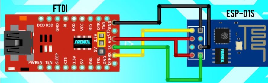

    Hey, I'm completely green when it comes to microcontrollers, so forgive me if I'm doing something obvious wrong or asking the wrong questions.
    I have an ESP-01 (S I think) and an FTDI adapter connected like this:
    Diagram showing ESP-01S connection with FTDI adapter
    Because what I want to upload will later connect to my smarthome, I want to use ESPHome Flasher (which underneath uses esptool.py) to generate and upload the binaries based on the .yaml file.
    Compilation succeeds, unfortunately during upload I get this error:
    ERROR Running command failed: Failed to connect to ESP8266: No serial data received.
    For troubleshooting steps visit: https://docs.espressif.com/projects/esptool/en/latest/troubleshooting.html
    ERROR Please try running esptool.py --before default_reset --after hard_reset --baud 9600 --port COM5 --chip esp8266 write_flash -z --flash_size detect 0x0 '.esphomebuildsensor.pioenvsensorfirmware.bin' locally.
    Using direct esptool.py returns me:
    A fatal error occurred: Failed to connect to ESP8266: Timed out waiting for packet header
    Am I doing something wrong, or is my ESP faulty?

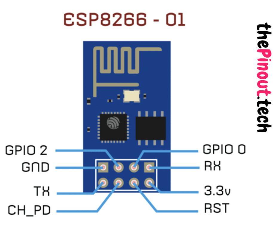

    There is no need to connect that extra VCC under the CH_PD/EN pin just power on VCC . And if I see correctly you have swapped TX with RX.
    Pin diagram of the ESP8266-01 module with labels. .

    TX from one to RX of the other, so I guess it's ok
    With this CH_PD you were right
    I already know what I did wrong.... the board has the pins on the other side so I had everything the other way around :D .

    1. removed the connection to the CH_PD
    2. flipped the board over ;) .
