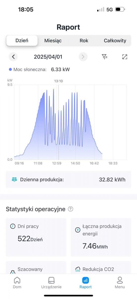

    I have some rather strange readings from a Softa 8.8 KTLX G3 inverter
    In full sunlight
    Screenshot of an app displaying energy production report from Soft 8.8 KTLX G3 inverter, showing irregular readings. .
    Anyone encountered a similar problem?
  • #1697 21503767
    Janusz_kk
    Posts: 5831
    Help: 224
    Rate: 1465
    Of course, you have competitors who also want to feed energy back into the grid from PV.
  • #1698 21538187
    prose
    Level 36  
    Posts: 3035
    Help: 173
    Rate: 850
    @Janusz_kk It's not a competition because the inverter doesn't switch off just the power drops.
  • #1699 21538190
    ja_pizgam
    Posts: 111
    Rate: 7
    @prose well because that's how most have it in the software now, they first drop the power to keep going, it's better because it can go back to full power at any time and in the case of a reset it's more than 1min lost to switch on, test and start working.
  • #1700 21538463
    Janusz_kk
    Posts: 5831
    Help: 224
    Rate: 1465
    prose wrote:
    This is not a competition because the inverter does not switch off only the power drops.
    Well unfortunately it shuts down and then it can't turn on because if the voltage is close to 253V it won't turn on, I know because I have watched it, sometimes such interruptions last half an hour or more.

    #1710 21879801
    maniakalny
    Posts: 25
    also depends, because there is such a thing as a voltage range for the full power mppt, the bigger the inverter, the bigger the voltage range -
    if you give 10 panels 500W 36Vx14A, you have 360V on the string
    if you give 15 panels 335W 36Vx9.5A, you have 540V on the string
    despite the same wattage of the panels, the second option will work better, because it is within the range of the optimum voltage
    that's why i'm telling you
    2 years I had 2 strings of 8 panels each - total I almost never saw above 9kW production, usually 8.5-8.8 max) this gave a current of 12.5 max 13A
    as I have now done one string, meaning I have a higher voltage x2 which is within the optimum, suddenly I have peaks under 10kW and a DC current around 14A
