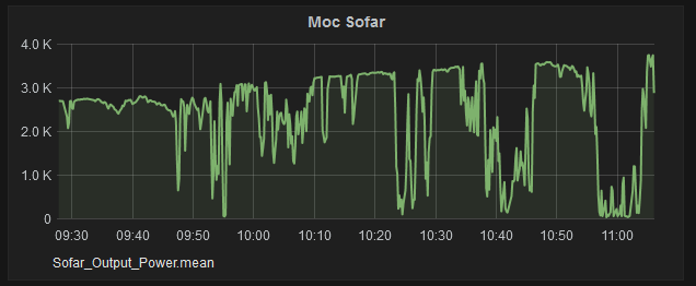

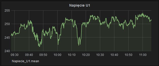

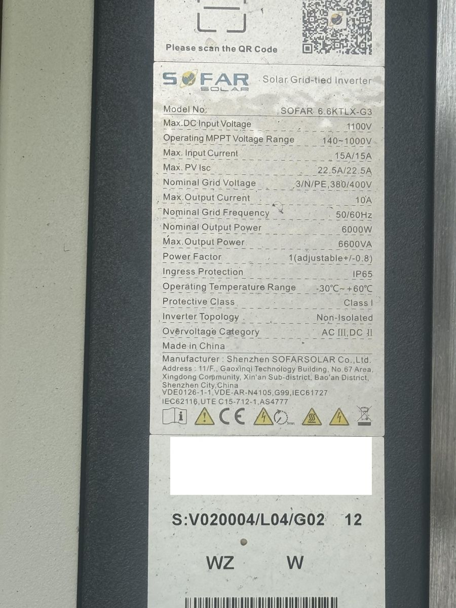

    kolavb
    Good afternoon,
    I have a question. Does the new software for the inverter 6.6KTLX-G3 introduce a change which gives the possibility of enabling active power curve adjustment in the options? (Reactive power curve adjustment)?
    The Fox inverter has something like this which, in the event of a voltage surge in the mains, allows continuous current production at a reduced value (cuts production e.g. from 3.5kW to 2.0kW) and thus does not switch off.
    I have such a problem that my inverter at high voltages in the network simply gives an error GRID OVP and shuts down, so at that time does not produce energy....
    One installation on Fox (4.5kWp) produces up to 25kW per day and the other 5.35kWp on Sofar only does 16kW under the same lighting conditions.... which is a big loss.
    How can this be remedied? Nameplate of the SOFAR 6.6KTLX-G3 inverter. .
  • #1632 21071913
    shogun
    Posts: 37
    @kolavb You need to run the P(U) function on G3. This can be done with the instructions on priv.
    for me it then looks like in the attached screenshots around hr. 11
    Voltage U1 chart in the time range from 9:30 to 11:00.
    Sofar power chart with a green line showing variability over time from 9:30 to 11:00.
  • #1633 21071987

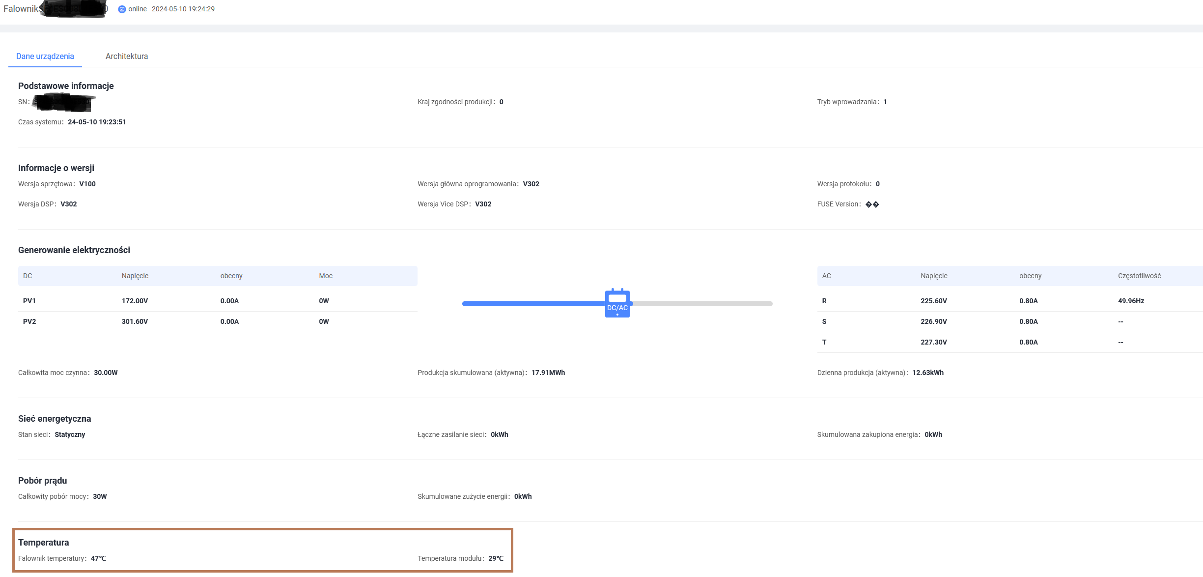

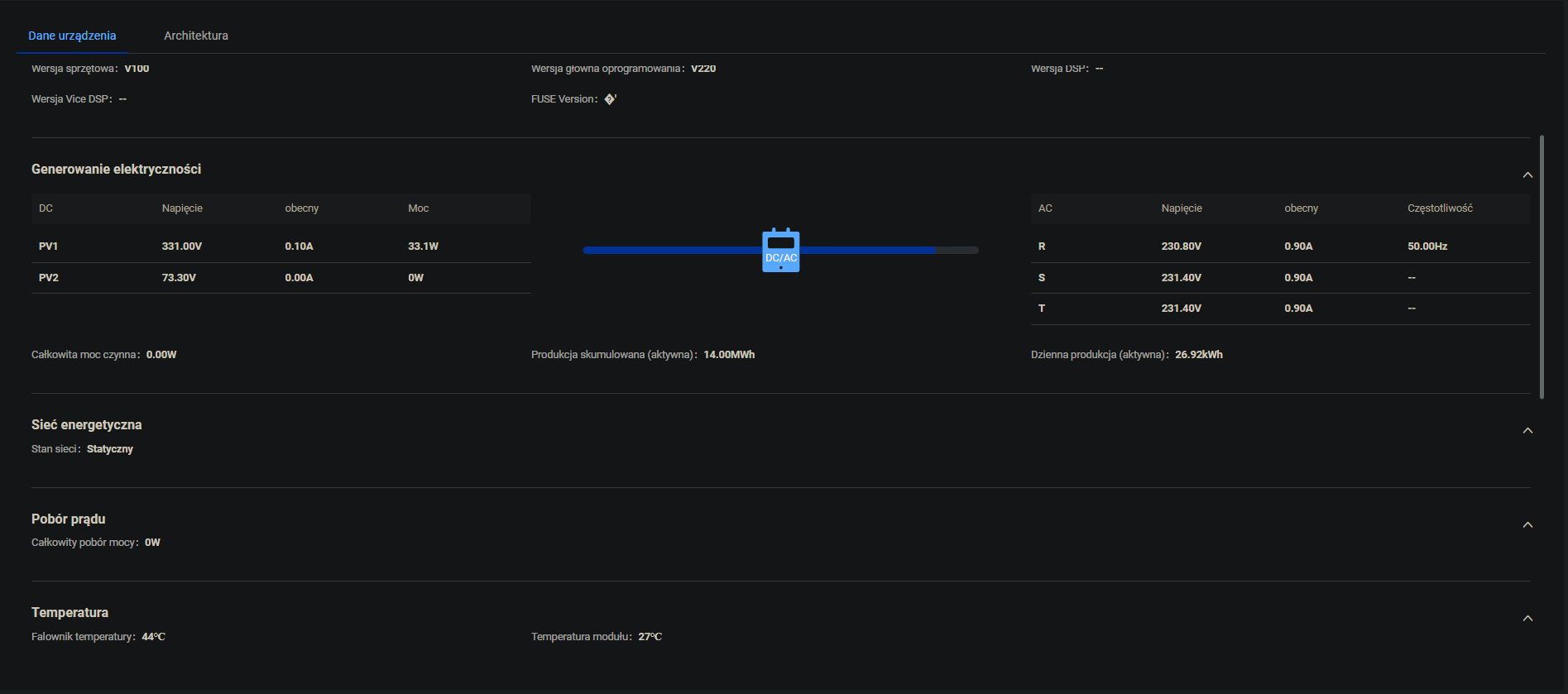

    zdziseek
    Posts: 11
    Yesterday I noticed that in both the mobile app and the Solarman website, even after downloading the inverter log in Excel, there is no temperature value given. Up until about a week ago, all three of these "sites" were displaying two values from the temp sensors.
    Can you check with yourselves if you still have the temp displayed?
    At my Sofar Solar 8.8 ktlx g3.
  • #1637 21076551
    LordZiemniak
    Posts: 158
    Help: 8
    Rate: 51
    temperature tab has evaporated :D
    I checked on a dozen installations and this temperature tab is not there :D
  • #1638 21076567
    zdziseek
    Posts: 11
    Holy crap. Exactly, there is no whole tab with the temp. And on the page, when you type in the settings to display in the graph also no, I think it used to be called Single plate temperature.
    But you reassured me that this is not only my problem.
    Btw, could you also send me instructions on how to enable this function in the menu when the voltage is too high?

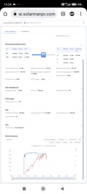

  • #1640 21080812
    zdziseek
    Posts: 11
    Today, it doesn't even display reactive power, in fact half the data has disappeared.

    Rate: 51
    I confirm, appropriate setting of this p(u) in my case does the job :D voltage as it was is too high, but the inverter works, fact with less power but it works :) the difference is significant in production, the only thing left for me is to torment Tauron to bring it to order.

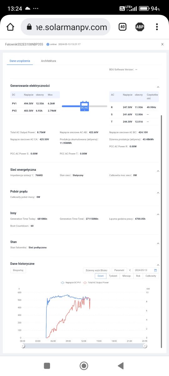

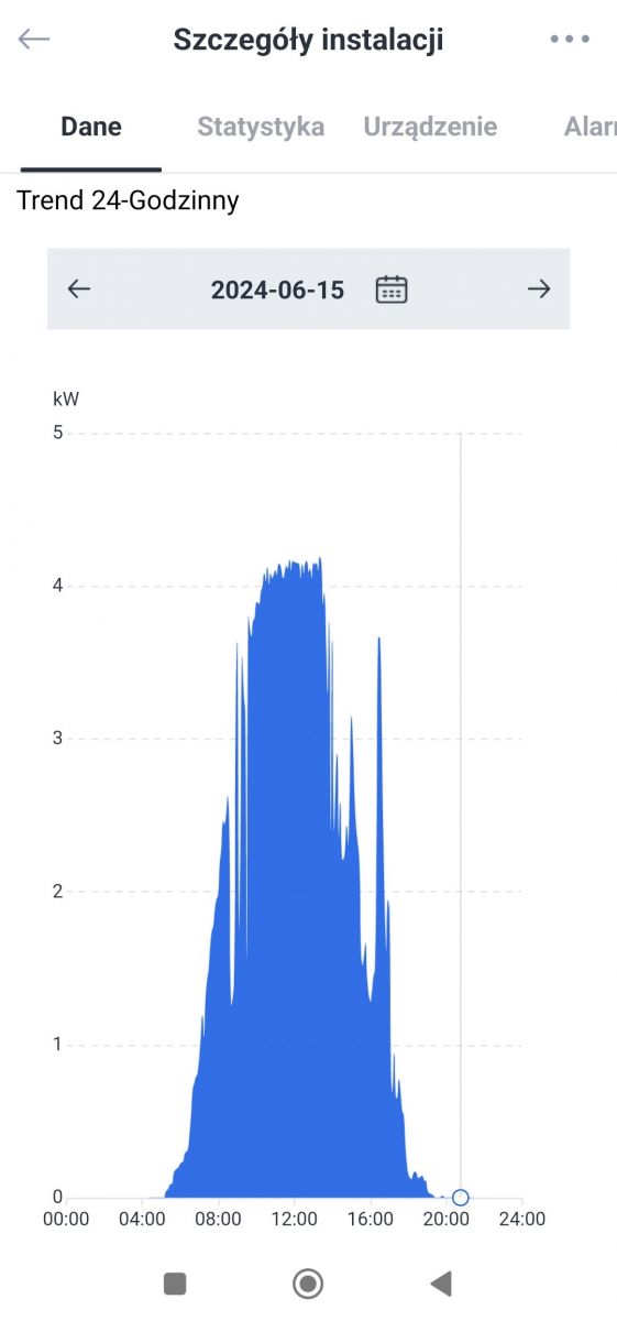

  • #1648 21123271
    dark1309
    Posts: 6
    Sofar Solar 5.5KTL-X 3-phase inverter
    JA SOLAR 420 JAM54S30-HC GR BF 420W panels 13 pieces
    1 -STRING 7 panels 31.80Vx7=222.7V (2.94KW)
    2 -STRING 6 panels 31.80Vx6=190.8V (2.52KW)
    Open circuit voltage (Voc) 37,58V
    Max. power voltage (Vmp) 31.80V
    Biggest sun at 11-13 I give 4.2KW, shouldn't it be 5KW? Maybe convert to 1 String?
    Ground mounted photovoltaic on a rack
    I would be grateful for an answer
    Graph of energy production from a photovoltaic installation on 2024-06-15.
  • #1649 21123306
    k_pec
    Posts: 1772
    Help: 271
    Rate: 560
    @dark1309
    [letter:4807666891] 1. Catalogued minimum DC input voltage for max power from mppt is 240V, so you have too low string voltages, which can probably reduce the power extracted from the panels by some percentage.
    2. In panels you have about 5.4kWp according to STC, which means in practice in the middle of summer some 4.5...4.9kW in real life, depending on weather conditions.When you add up one with the other these 4.2kW seem to be justified.
    I would try a one string connection to start with, if possible. Optimal inverter operating conditions are specified for a string voltage of 650V
  • #1650 21123336
    dark1309
    Posts: 6
    It is possible to pin on 1 String. Thanks for the answer.
