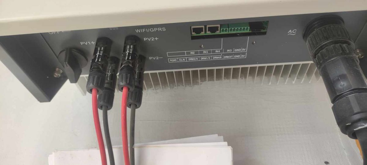

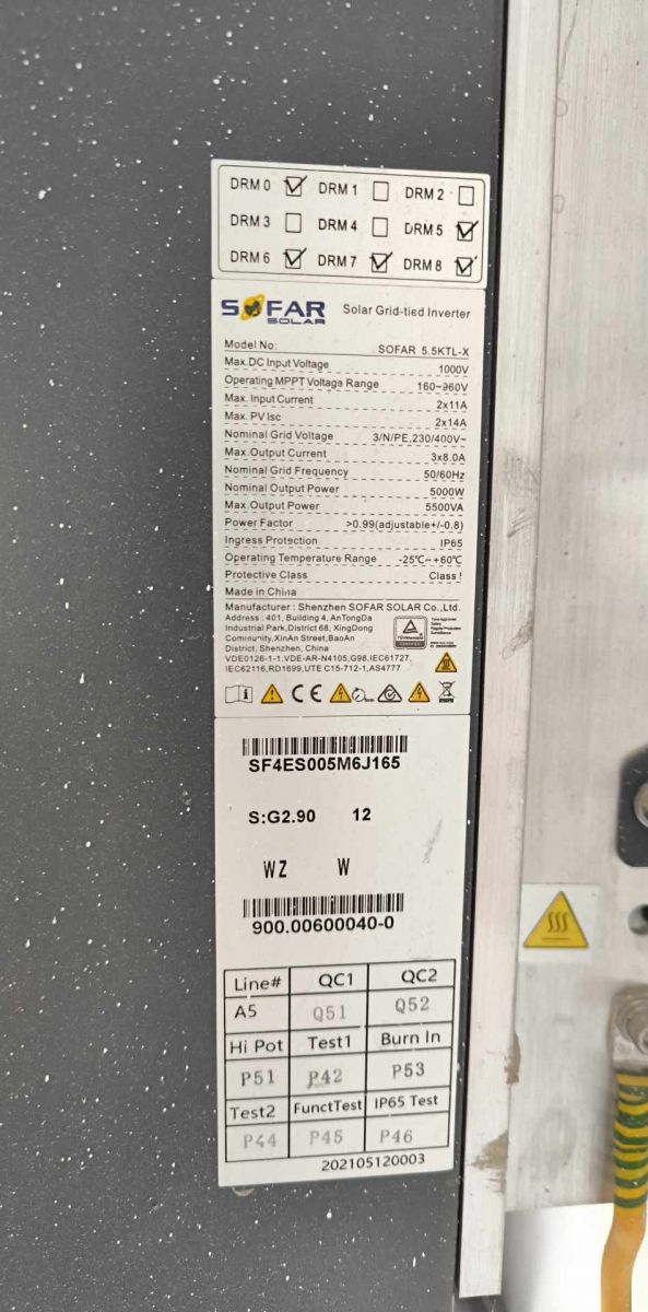

    Get more specific. Which generation of Sofar? The G2 has a maximum current of 11A and the panels 13A. So if the panels are all on the same azimuth and it's G2 then it pays to give them on one string, but split into two MPPTs. At G3 too because of the voltage.
  • #1652 21124470
    dark1309
    Posts: 6
    SOFAR 5.5KTL-X G2. All panels are at the same azimuth
  • #1653 21124491
    xury
    Automation specialist
    Posts: 7078
    Help: 878
    Rate: 1494
    So as I wrote. Do the whole thing on one, and at the inverter itself split into two MPPTs. Then, at maximum operation, the current will go equally 6.5A to both inputs.
    When operating the whole on one input, the maximum current from the string is 11A. That is a loss of about a kilowatt of power.
  • #1654 21125390
    dark1309
    Posts: 6
    ok, I will
    Added after 35 [minutes]:
    In the inverter I have to change to INPUT MODE --> EQUAL?
  • #1655 21125470
    xury
    Posts: 7078
    Help: 878
    Rate: 1494
    Yes, you need to change.

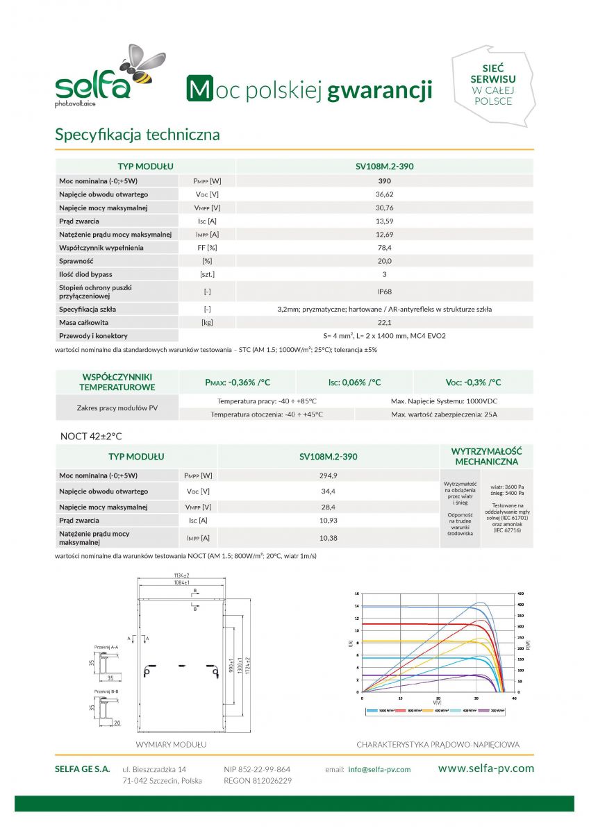

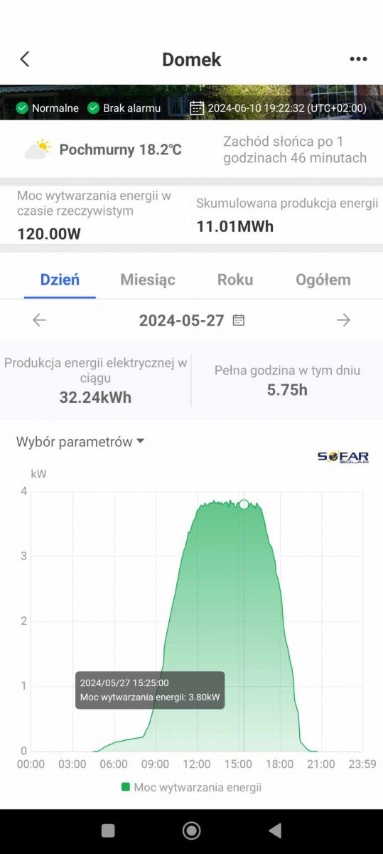

    #1656 21132874
    plm132
    Posts: 21
    Hi. Patient Sofar 5.5 KTL-X, Selfa panels 14 pcs each 390 Wp (5.5 kWp) all facing south-west at 215 degrees, roof pitch 45°, and production reaches 4 kW, or 70% of installed power. Panels connected 7 at a time and pulled everything under the inverter and connected under 2 MPPT. I attach the photos. And now how to bite it to increase the production. Sofar Solar 5.5 KTL-X inverter label with technical specifications. Technical specifications of Selfa SV108M.2-390 solar panels. Screenshot of an app monitoring solar energy production, showing a power graph and other data. Interior of an electrical box with wiring and fuses. View of inverter connectors with PV cables and communication ports connected. .
  • Possible inverter limiting and 45° tilt losses
    #1657 21132958
    k_pec
    Posts: 1772
    Help: 271
    Rate: 562
    plm132 wrote:
    And now how to bite it to increase production.
    It looks like something is limiting (flattening out) your production around 4kW. Don't you have some kind of production limiting done - P(U) functions, Q(U) or something else?
    But that's a detail, because you still have a reduced production in relation to that number of kWp, because:[letter:6602667d3e]-When the panels are tilted at 45°, the panels produce about 12...15% less power than at the optimum tilt for June.
    - The panel's 390Wp output is, and yes it is, but for laboratory STC conditions. In the real world, by contrast, one is closer to NOCT conditions, i.e. 295Wp of power. You can take a safe 0.9 STC power for your estimates.Adding up, you have about twenty, twenty-something per cent legitimate power shortfall. The remaining shortfall is that flattening seen in the graph.
  • #1658 21133001
    faradek
    Posts: 400
    Help: 56
    Rate: 109
    >>21132874 Panels badly matched to inverter. The inverter has a maximum of 11A per single MPPT input and the panels at maximum power give a current of 12.69A. The inverter accepts 11A and hence the clipping on the graph.
    In my opinion, you should connect all the panels in series i.e. create one string and plug them in parallel under the two MPPTs.
  • Low string voltage likely limiting MPPT operation

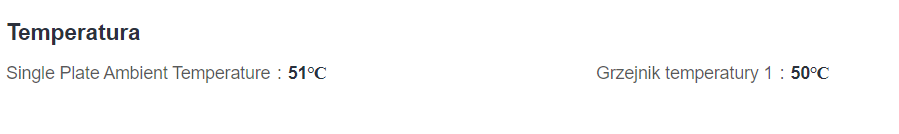

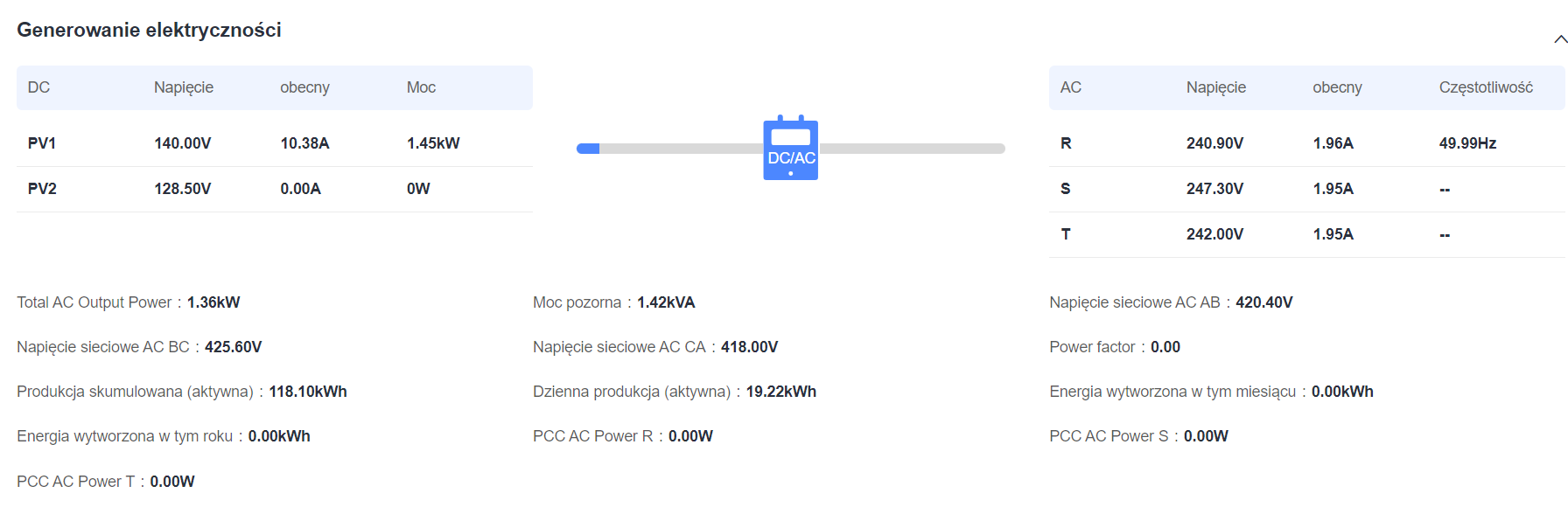

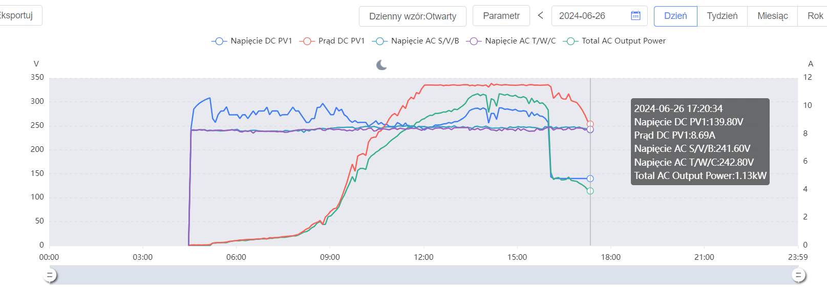

    #1662 21133304
    ICEMANIK
    Posts: 71
    Hello, is such a sharp drop in the power of the installation on a warm cloudless day normal?
    Installation new, today the first cloudless and warm day about 30st.
    Sofar 4.4KTL-G3 inverter, 1string with a nominal power of 4kw (9x445W ENCOR EC445-450-10R-108FB)
    Graph showing changes in voltage and current in a photovoltaic installation throughout the day. Screenshot of data from the Sofar 4.4KTL-G3 inverter showing electricity generation parameters. Screenshot of data from the Sofar 4.4KTL-G3 inverter showing electricity generation parameters.
    Screenshot of inverter temperature data showing ambient temperature at 51°C and radiator temperature at 50°C.
    And also a data dump from the inverter:
    • 2024-06-26 FalownikSS2ES144PCC011Raport (1).xlsx (78.37 KB) You must be logged in to download this attachment.
  • #1663 21133378
    Wawrzyniec
    Posts: 4005
    Help: 392
    Rate: 1075
    ICEMANIK wrote:
    Is such a sharp drop in the power of the installation on a warm cloudless day normal
    If the voltage dropped so sharply then the power must have dropped as well. Something obscured the sun and that was that.

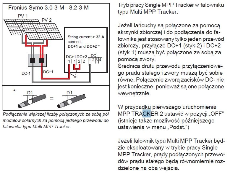

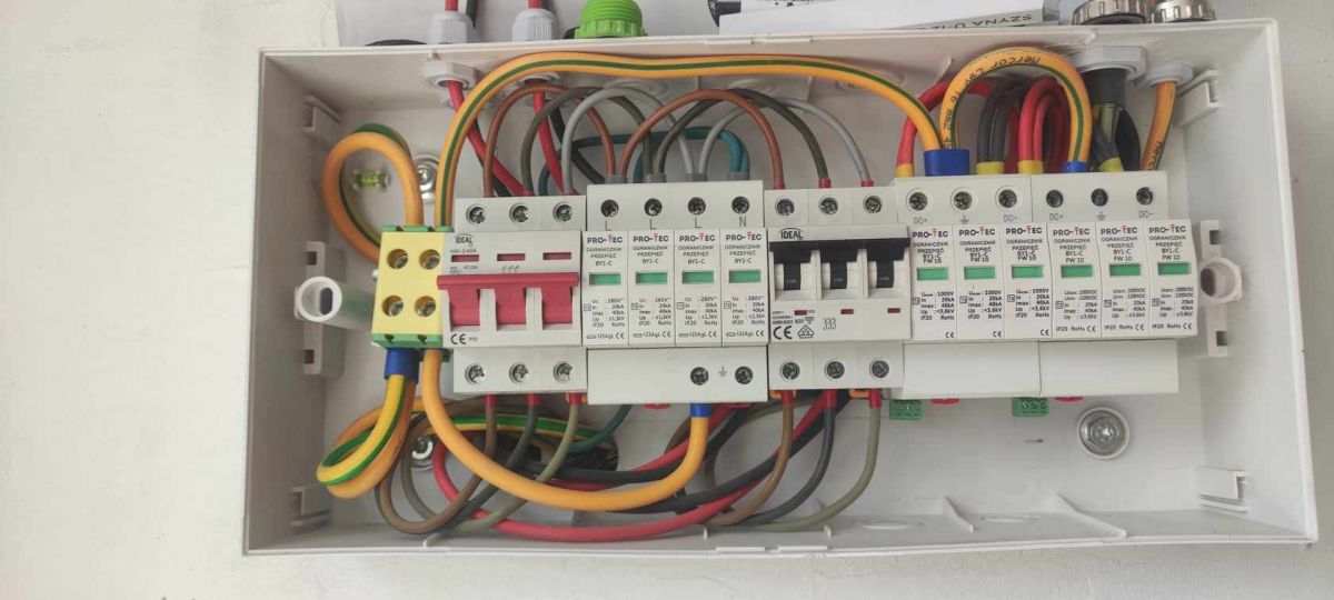

  • Single string in parallel across both MPPTs
    #1665 21133537
    plm132
    Posts: 21
    Janusz_kk wrote:
    In my opinion, you should connect all the panels in series i.e. create one string and plug them in parallel under two MPPT.
    Exactly, it was completely pointless to split them into 2 strings, one string and the inputs in parallel in the setup and it will be fine.
    So do it like this? Diagram of connections for solar modules with the Fronius Symo 3.0-3-M to 8.2-3-M inverter.
  • #1666 21133555
    Janusz_kk
    Posts: 5831
    Help: 224
    Rate: 1465
    NO, it is still a parallel connection, you have to connect them in series in the box at the solar, that is, from string 1 the red one to the inverter and you connect the black one with the red one from the second string, the black one from the second string to the inverter. In the inverter, in the settings, you select not two separate strings but a parallel connection of the inputs and that's it.
  • Series wiring required before one MPPT input
    #1667 21134199
    plm132
    Posts: 21
    Janusz_kk wrote:
    NO, it's still a parallel connection, you have to connect them in series in the box at the solar panels, that is from string 1 the red to the inverter and you connect the black to the red from the other string, the black from the other to the inverter. In the inverter in the settings you select not two separate strings but a parallel connection of the inputs and that's it[/quote].
    And this is plugged into one MPPT?
