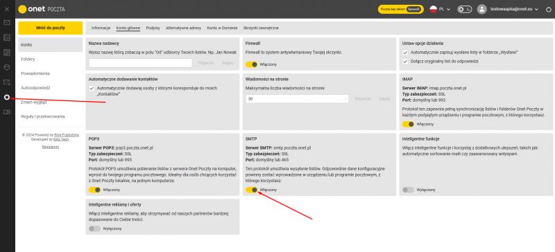

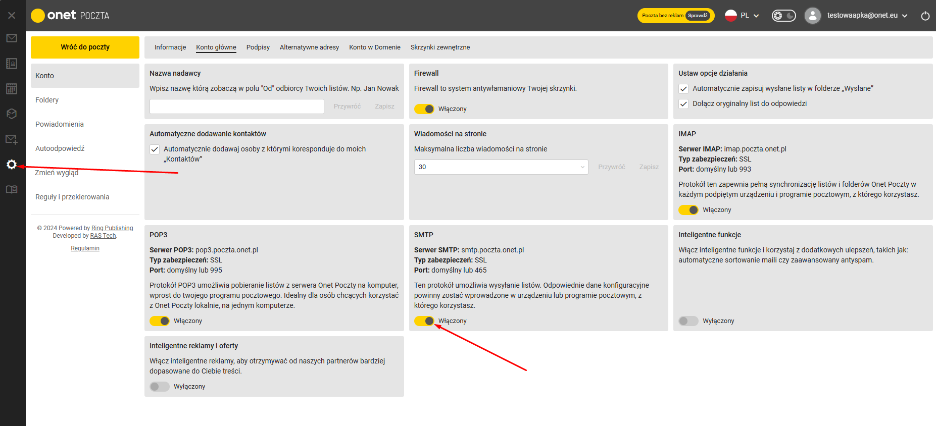

    1. Find your SMTP data .
    Depending on the mailbox you have, this process may vary slightly. At my OneT, they are in the settings. There you also have to enable SMTP first:
    Screenshot of Onet mail settings with SMTP option highlighted. .
    Save:
    Serwer SMTP: smtp.poczta.onet.pl
    Typ zabezpieczeń: SSL
    Port: domyślny lub 465
    We will still need our email and password.

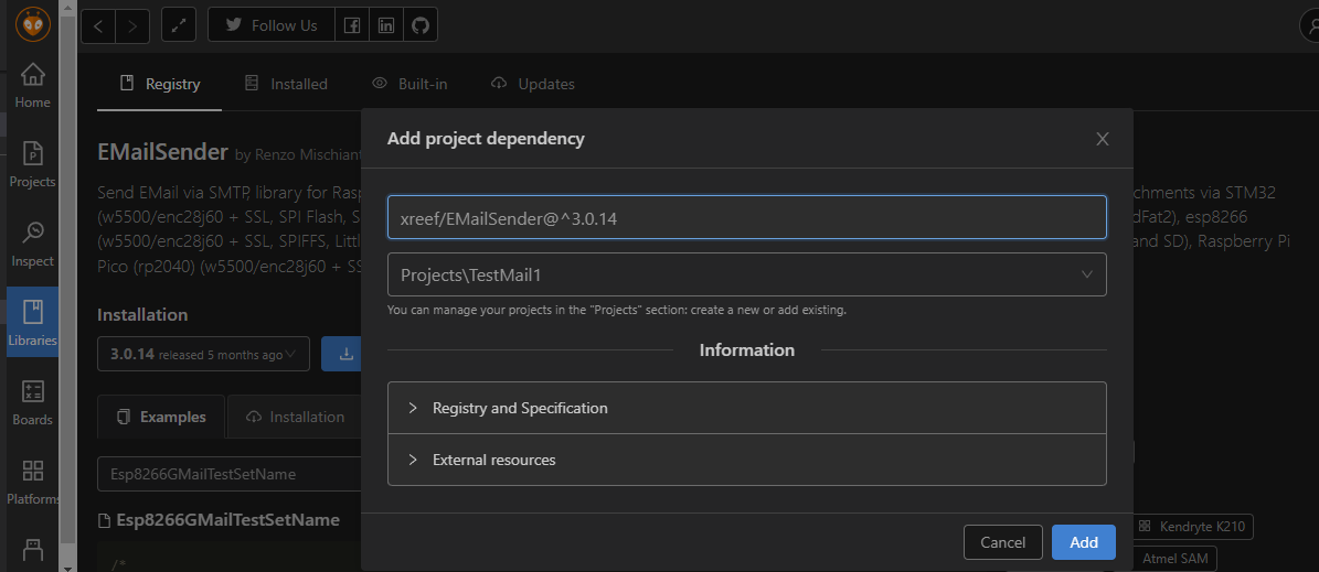

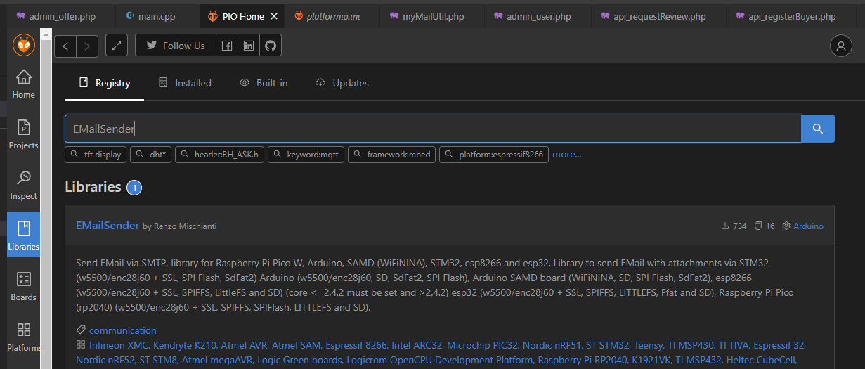

    3. Download the EmailSender library .
    The EMailSender library by Renzo Mischianti allows you to conveniently send emails via SMTP on multiple platforms.
    Screenshot from PlatformIO showing search results for the EMailSender library. .
    Documentation:
    https://www.arduino.cc/reference/en/libraries/emailsender/
    We add the library to our project via PlatformIO:
    Adding project dependency in PlatformIO. .
    Once added, all you need to do is run the example code, I've included an example from the library author below (I've only added the port space).

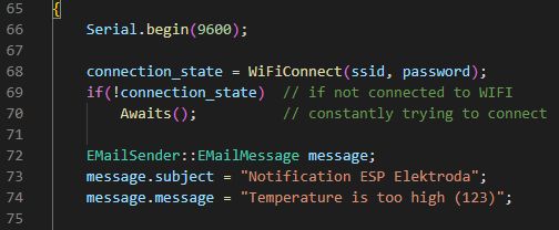

    4. Run the example code .
    Complete the data in the code:
    - SMTP server
    - our email and its password
    - our SSID and WiFi password
    - target email
    The data to be completed starts with "YOUR_" in this code.
    Code: C / C++
    Still worth completing the message:
    A portion of C++ source code for a program on ESP8266 sending emails. .

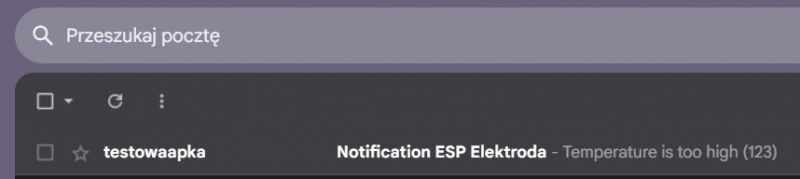

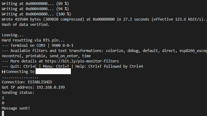

    We complete, upload and:
    Console showing the process of connecting to WiFi and sending an email. .

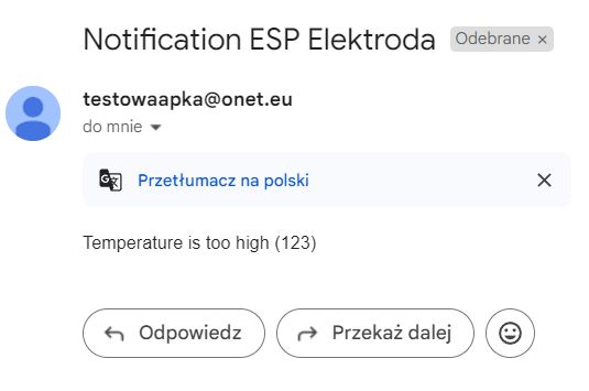

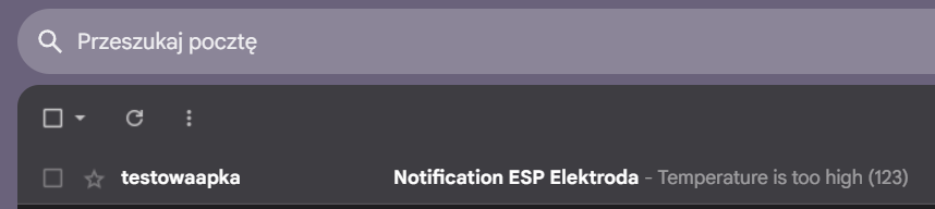

    Success:
    Inbox view with an email notification from a test application. .
    Email has been successfully sent.
    Email notification with the subject Notification ESP Elektroda and a message about high temperature. .
