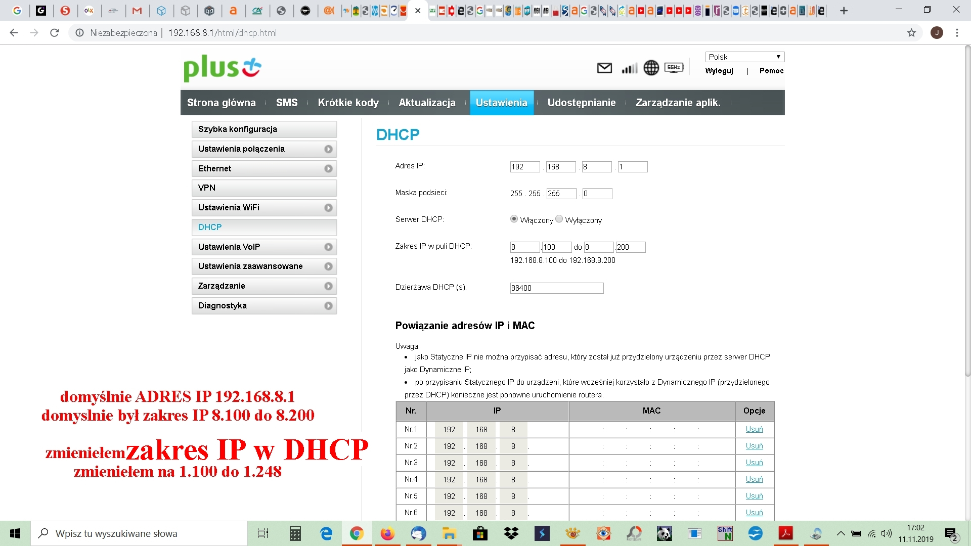

    This is my question regarding the default IP address of the CCU3, as the PBX was not seen at all on my home network.
    Unfortunately, my home router (it's a popular Huawei B525 and LTE access from Plus) has default settings in DHCP from 192.168.8.100 to 192.168.8.200, and factory settings after connecting and running the netfinder program showed the PBX address 192.168.1.107, so I changed the settings in the B525, as shown in the screenshot below, and here the problems began...
    Installing the XML API patch on Homematic CCU3 for TinyMatic - how to do it? [img-0].
    CCU3 connects ok on 192.168.1.107, but:
    - Net on the laptop has started to work strangely, badly, there are frequent interruptions, lags, problems with sending/receiving emails, refreshing pages etc. - e.g. I can't add a photo to a post the first time, etc. etc.
    - messages like "site unreachable" Connection has been reset. - need to refresh
    -The access to the wireless thermostat controlled by wifi( controls the gas boiler) has stopped working, the thermostat is connected to the wifi network, but I have a message that it is "offline"
    - From my mobile phone ( although it is correctly connected to the wifi network) I cannot
    send any e-mail, I have tried from several e-mail accounts
    Should I therefore return to the factory settings of the B525 router and change ( force manually ?) the default address of the CCU so that it fits into the pool set by the router ?
    greetings!

Keep your router’s DHCP as is. Set CCU3 to obtain an IP via DHCP, then either assign a DHCP reservation or set a static IP outside the DHCP pool (e.g., 192.168.8.99). This preserves stable routing. [Elektroda, Anonymous, post #18287439]
I changed my B525 DHCP range and my network went unstable. How do I recover?
Revert the router to its prior DHCP settings. Before doing that, switch CCU3 to DHCP to avoid lockout. Then either reserve a DHCP IP for CCU3 or set a static address outside the pool. [Elektroda, Anonymous, post #18287439]
