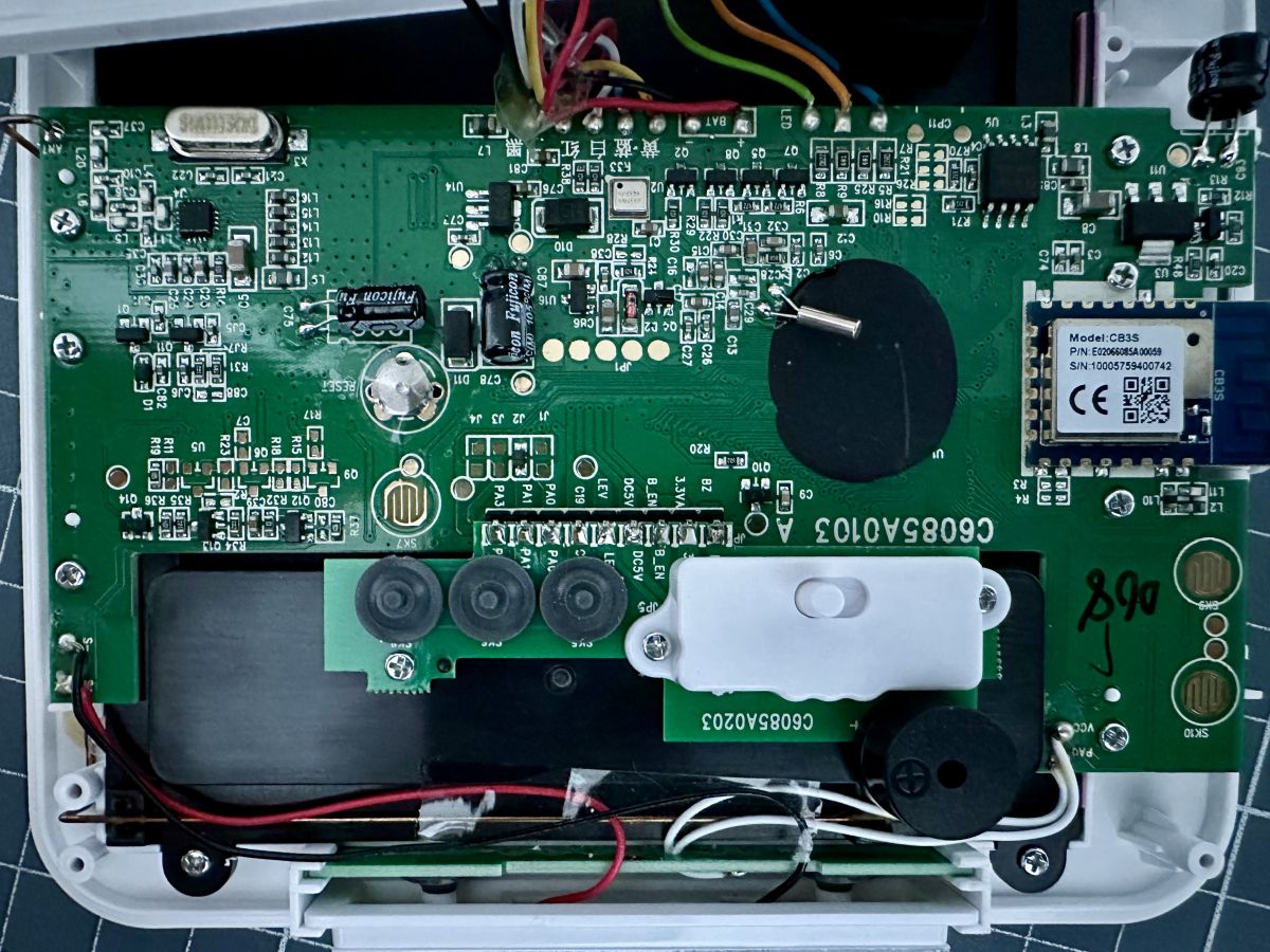

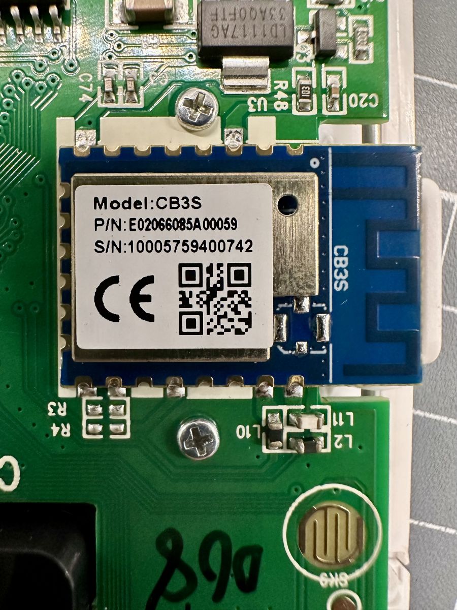

    Digital weather station with an anemometer and color display.
    Actually using it with LocalTuya on Home Assistant but fed up with the cloud thing and the poor WiFi implementation (disconnects too regularly) so I opened it up and saw a CB3S chip.
    I'm used to flashing things but I don't know where to start, I can't find this product in the database.
    Here are some pics from the inside:
    CB3S module on a circuit board. Photo of a circuit board with a visible CB3S chip and other electronic components.
    Help will be gladly appreciated ^^

    Hello, can you provide some more information, is this a battery powered device?
    This station is most likely using TuyaMCU, so first step would be TuyaMCU flashing, setup and configuration guide - configure dpIDs for Home Assistant

    LennVilardi
    It's not a battery powered device, it has its own power supply which outputs 5V 1A. The battery, a CR2032, is only for backup.
    It has a screen and the smart app says that it has an MCU module in v1.0.
    The dpIDs seem to be:
    I don't find the MCU on the board to sever the connection between them. What will be the easiest way to flash it?
    Thanks for putting me in the way ^^

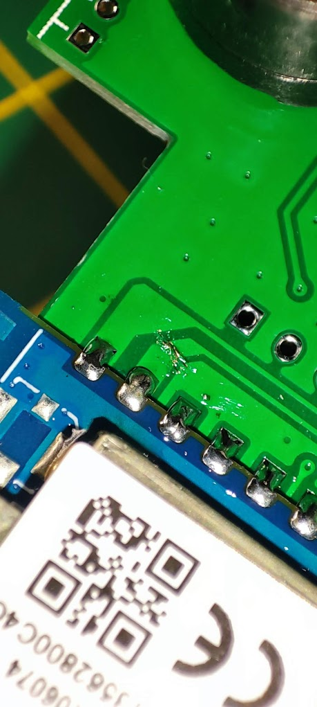

    First of all, a big thank you for all your help so far—it’s been invaluable and has allowed me to make great progress.
    I finally took the plunge: I desoldered the board, flashed the firmware, and had to desolder it again (turns out I entered the wrong Wi-Fi password 🙃). Unfortunately, I couldn’t get the board into safe mode, even after multiple attempts at unplugging and replugging the power.
    Now, I’m stuck on the next step: converting the DPIDs I retrieved from my weather station into usable MQTT data for Home Assistant. Based on what I’ve gathered and the examples I’ve studied, here’s the configuration file I plan to use:
